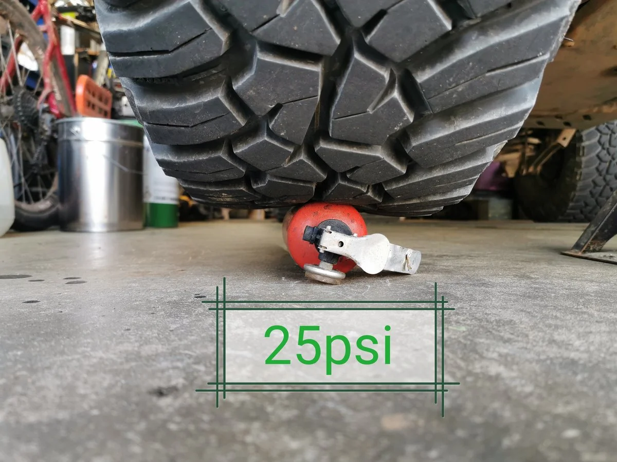

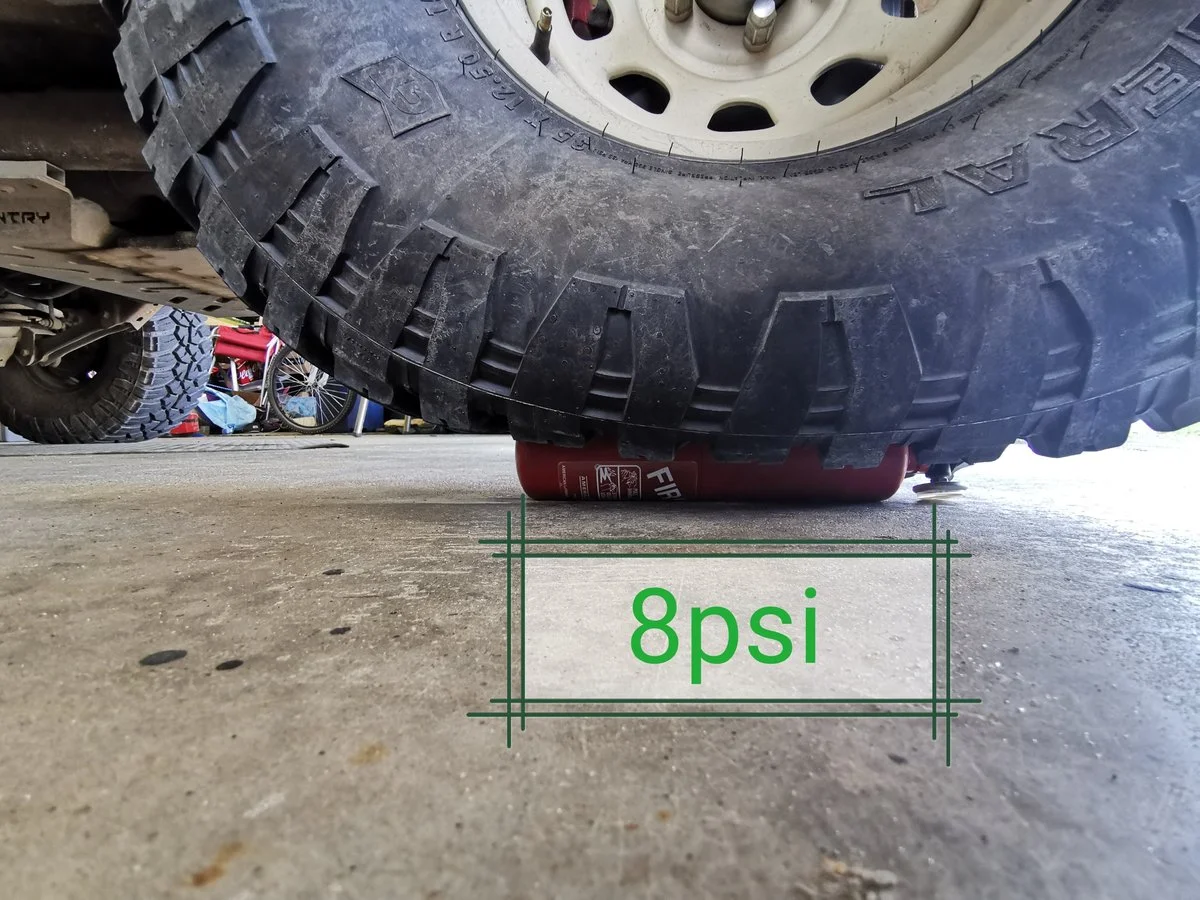

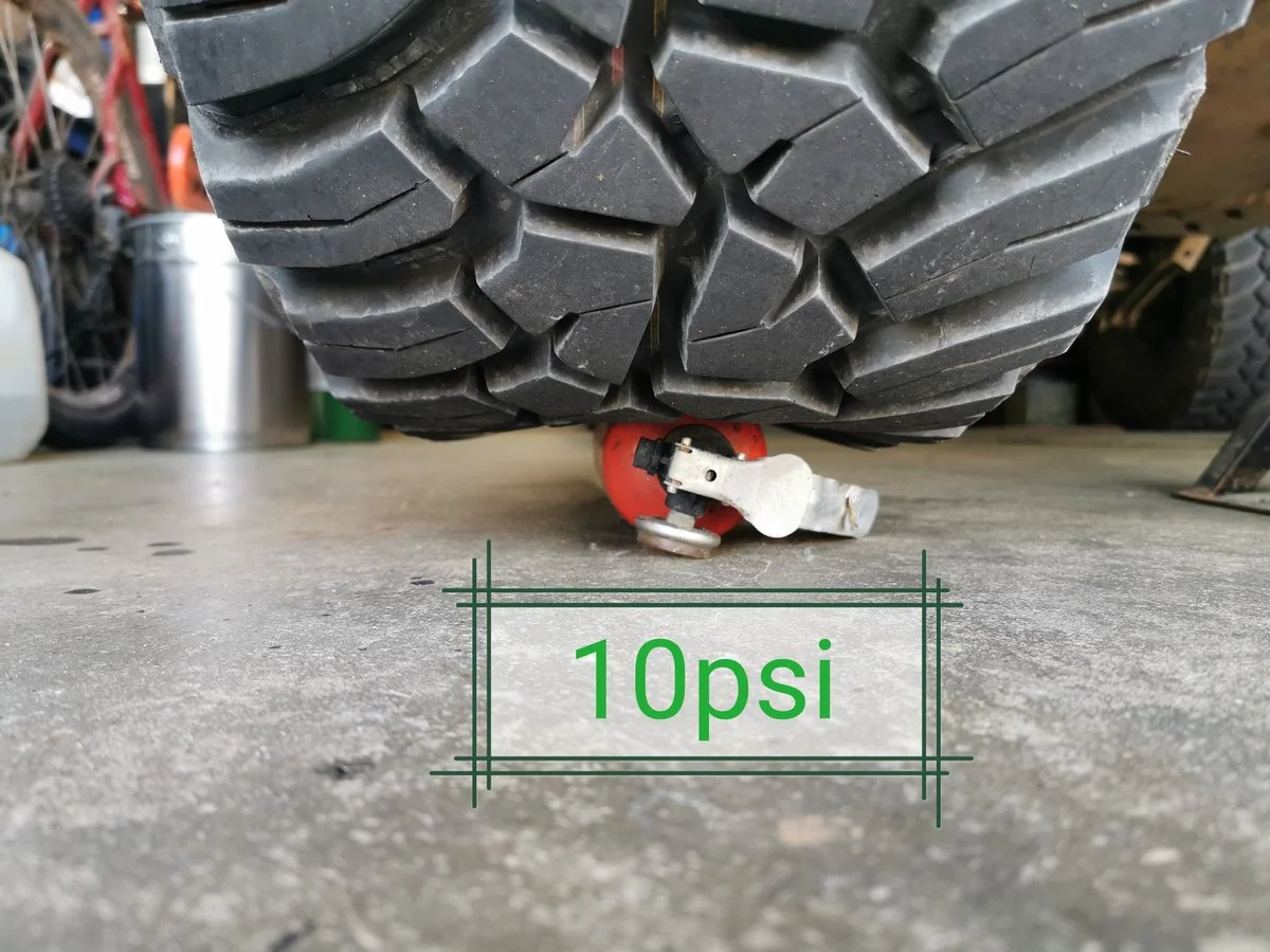

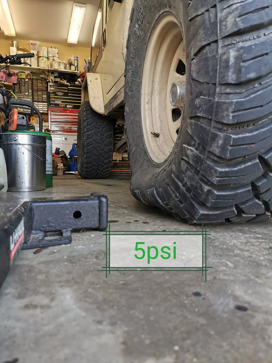

I typically run mine at 8 sometimes 10 psi. The biggest beginner mistake is being afraid to air down enough. If you're not below 15 psi you're not really aired down.
Look at the footprint size difference here. Bigger footprint = increased traction.
Now did you actually make this poster ? if so it very well shows the difference

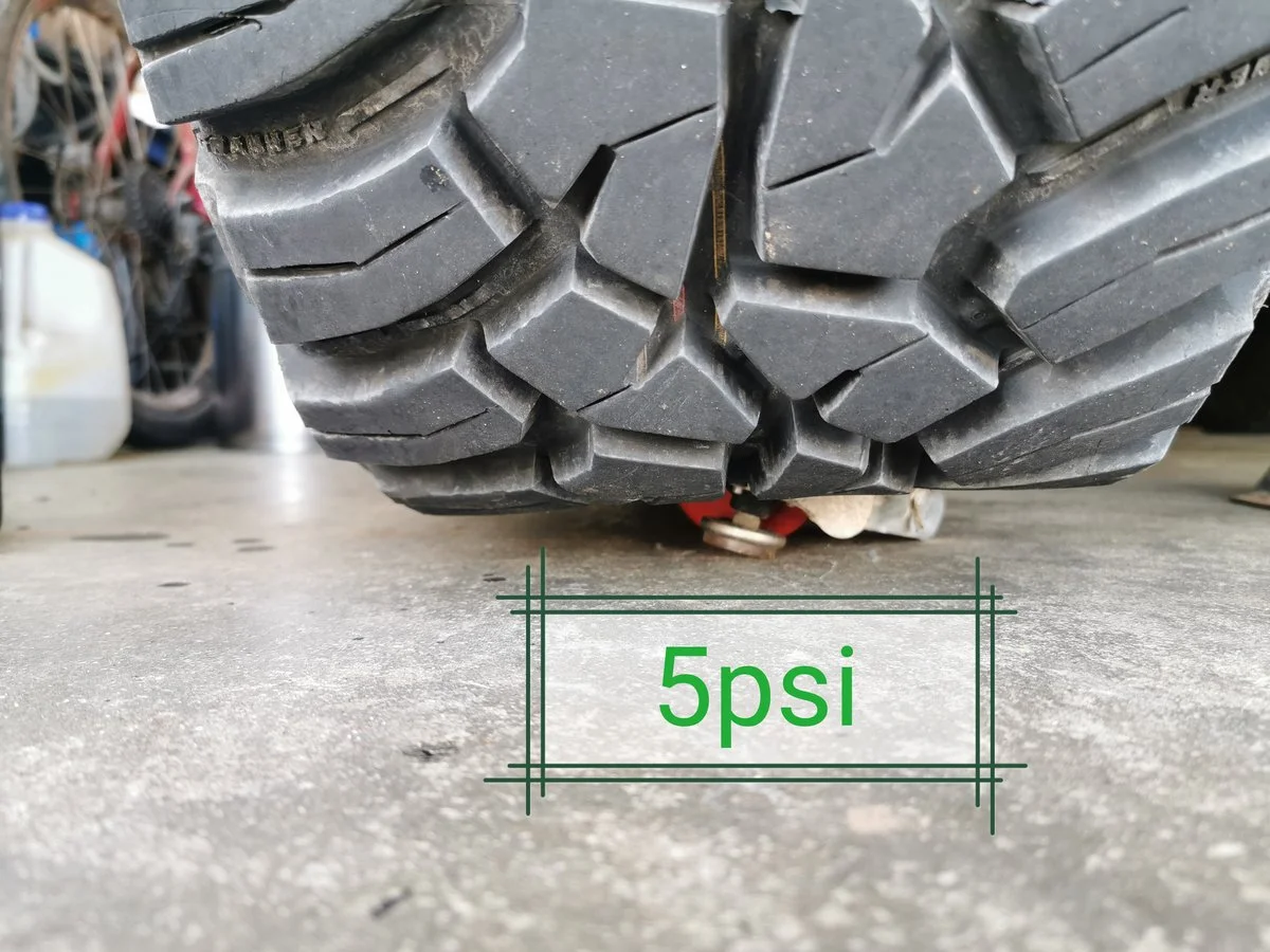

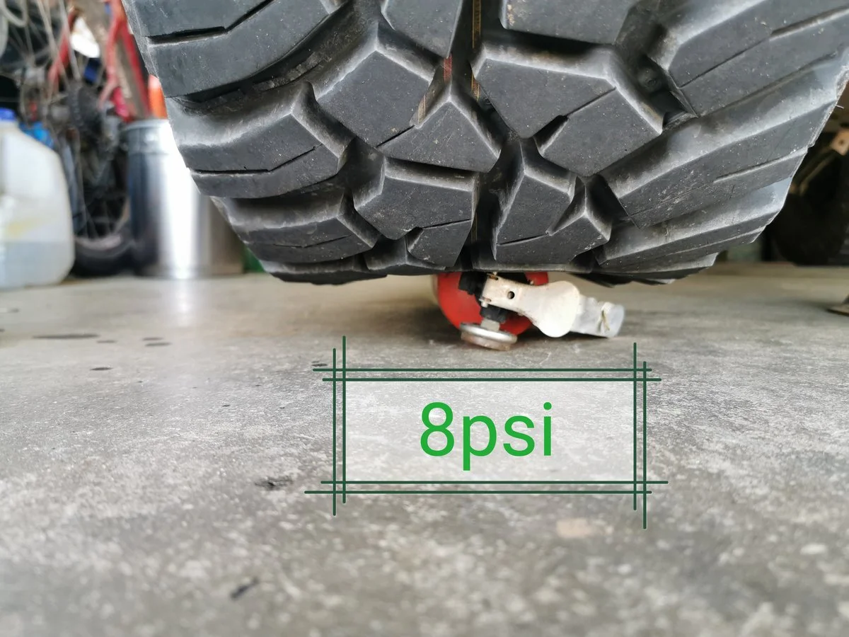

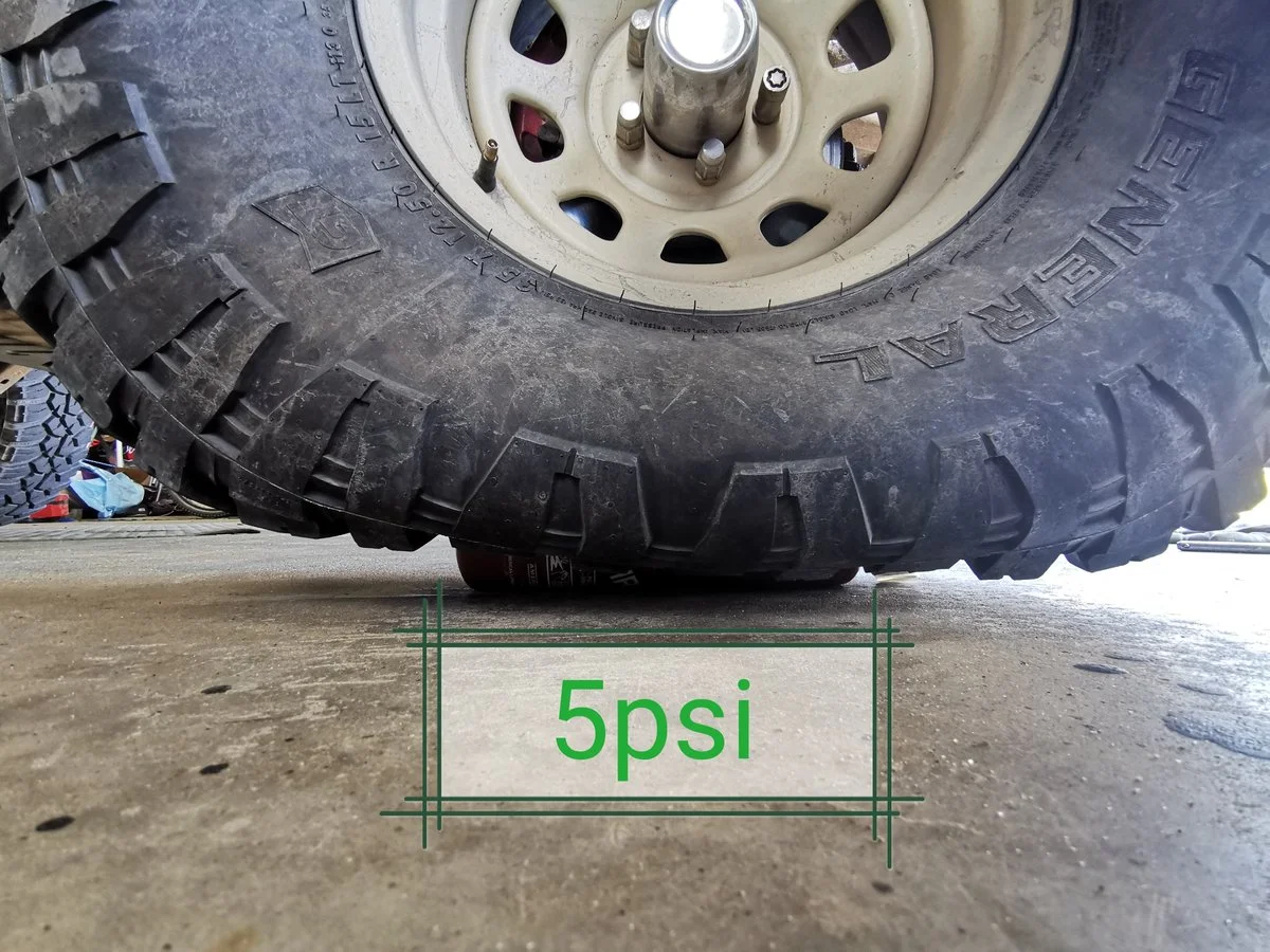

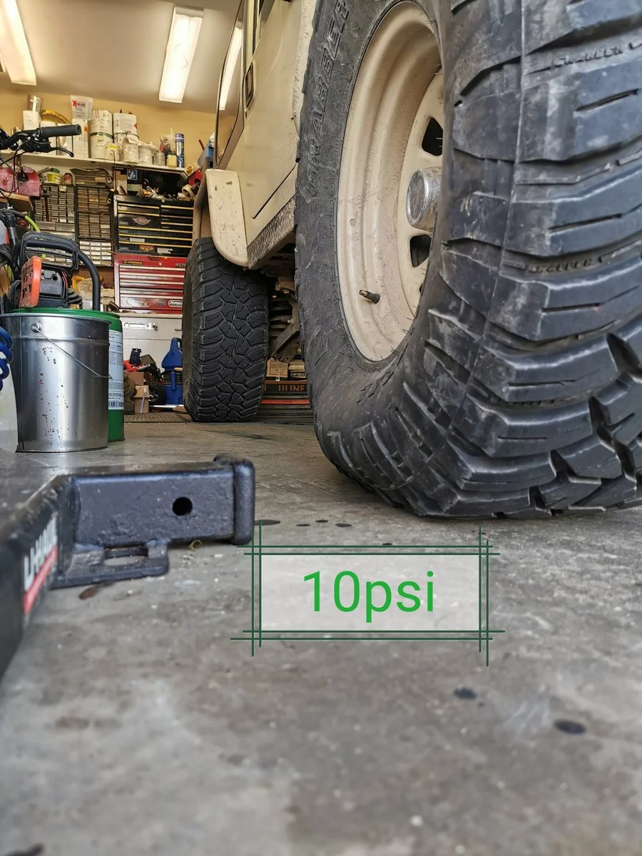

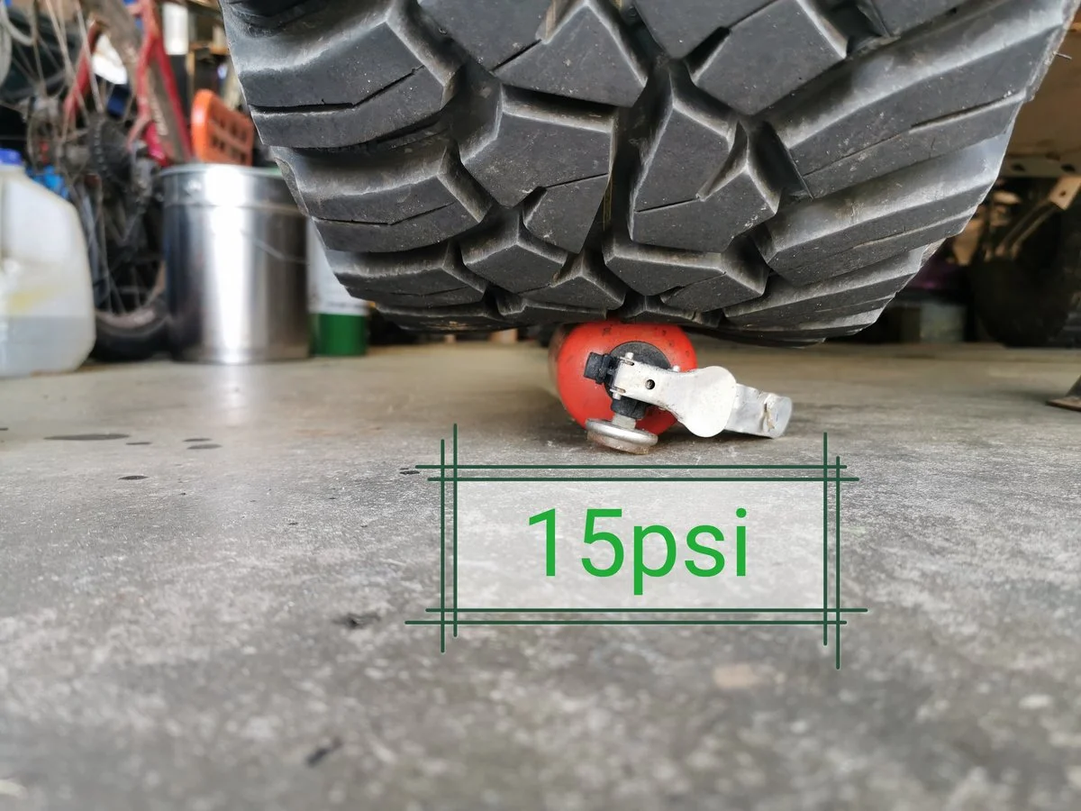

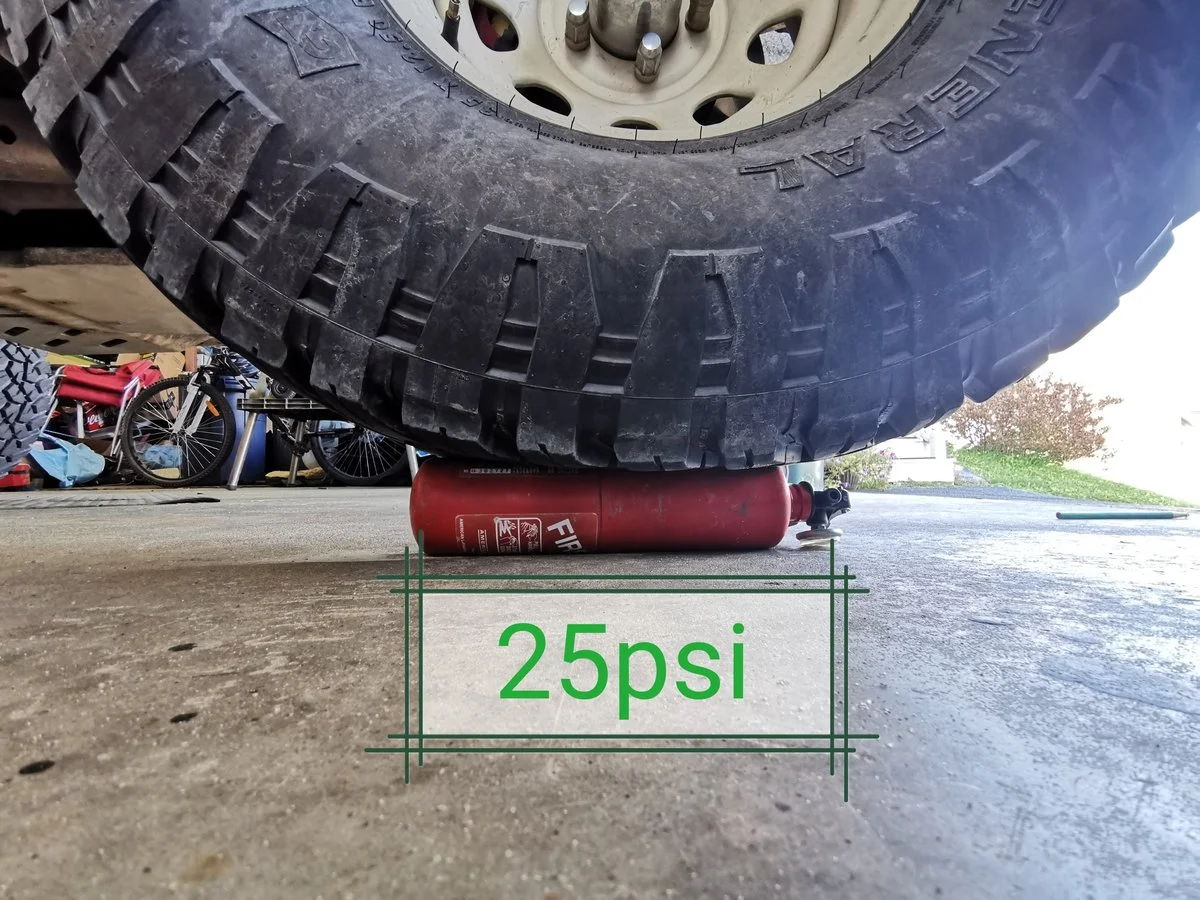

It would be cool if somebody could post up pics of a decent sized tire wrapping around an obstacle when aired down vs the same tire at street pressure on the same obstacle.

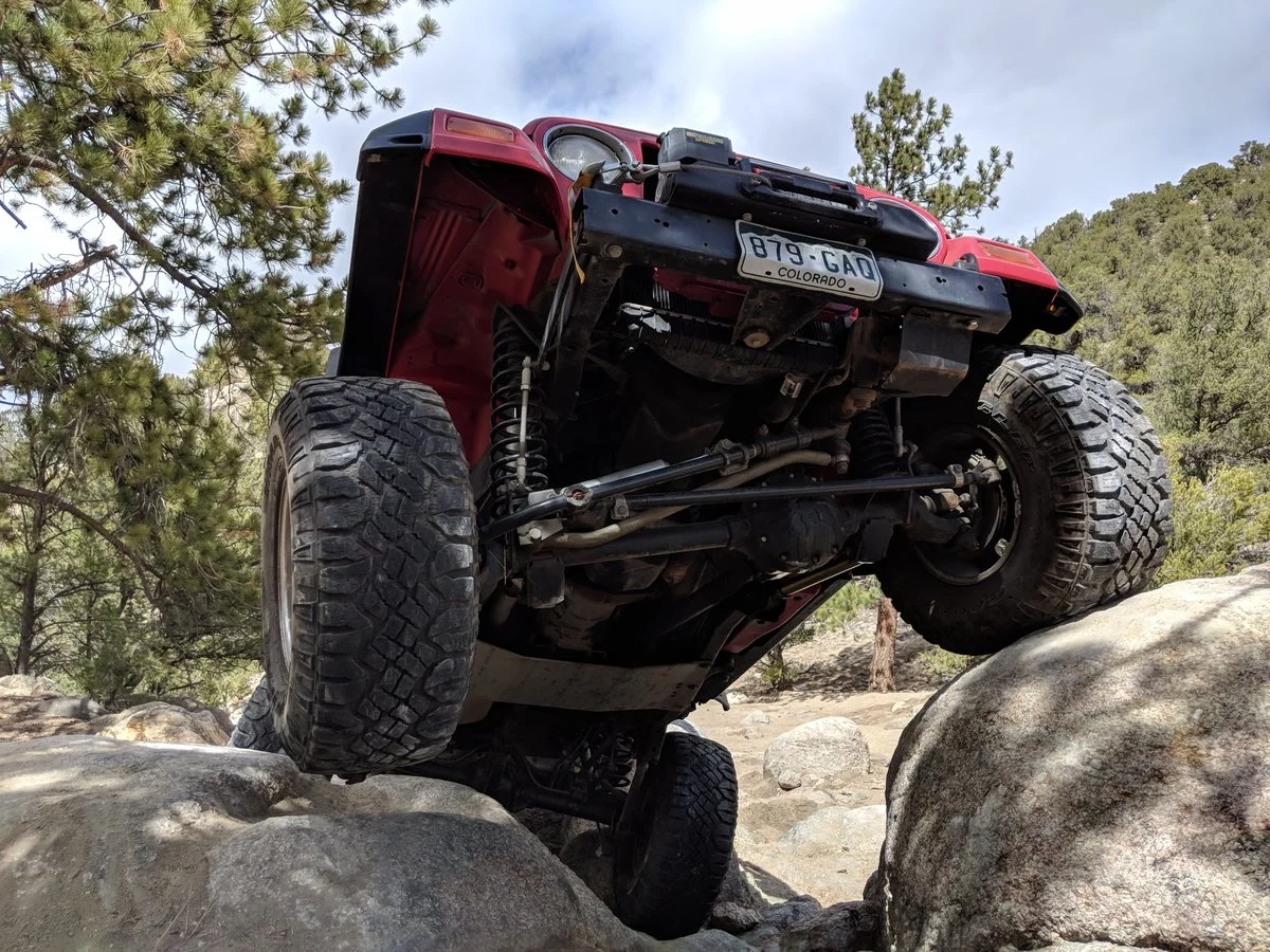

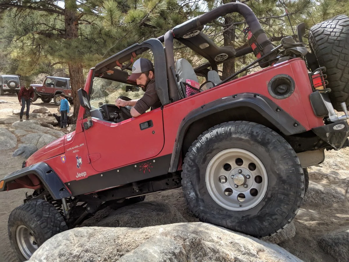

Dont have a street pressure but here are 33s at 8 psi

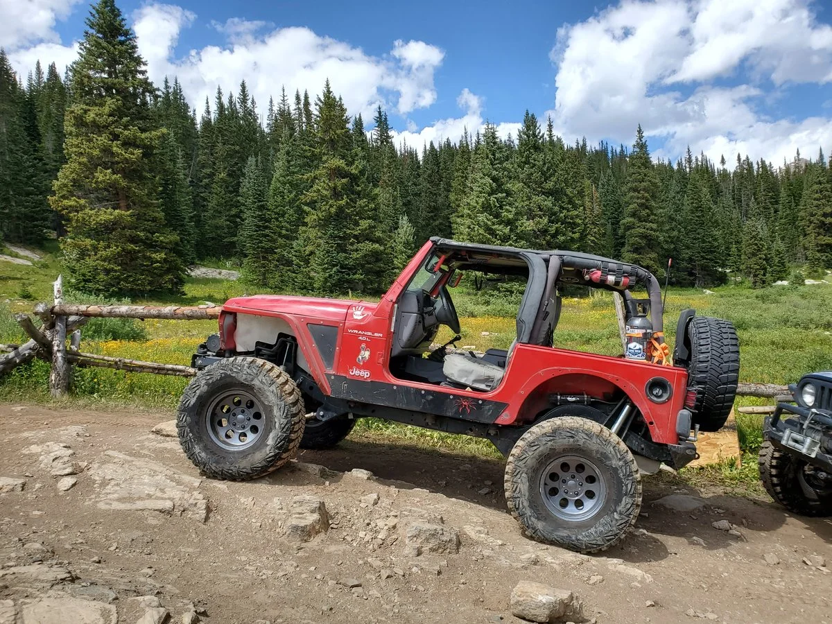

Here are my 35s at 8psi just sitting. The rear is forming nicely
