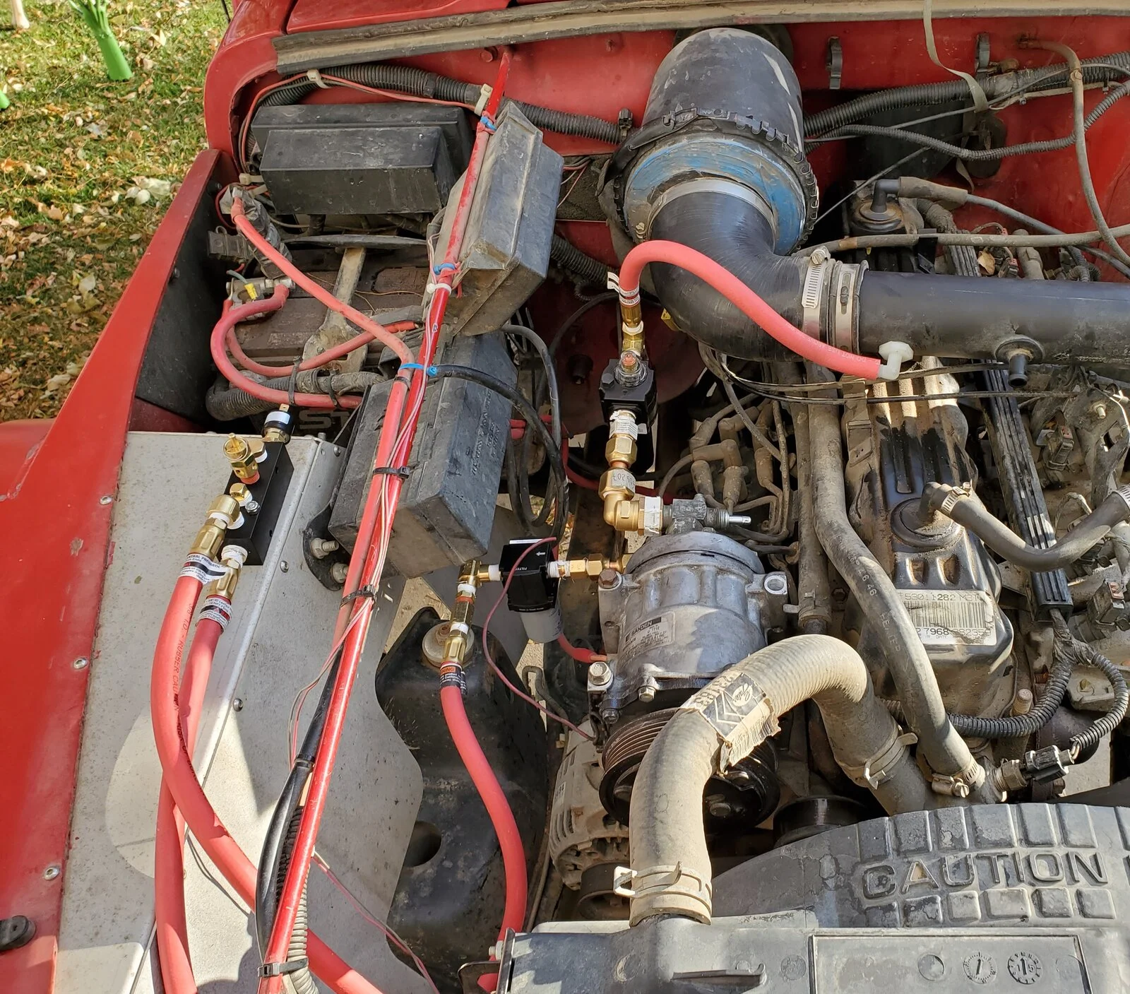

I had CO2 for a number of years. It was pretty convienent but I was getting to the point of spending $60 +/year filling it up. And when its out of CO2, its out. I've had to ask for fill ups numerous times. I've since gone to a Sanden AC compressor for OBA. Endless air and fast fill times. Minimal maintenance as far as oiling goes. IIRC I am into this OBA setup for $300 which has long paid for itself already.

By "AC" he means it's actually an Air Conditioning compressor that has an attachment on the back to turn it into an Air Compressor.

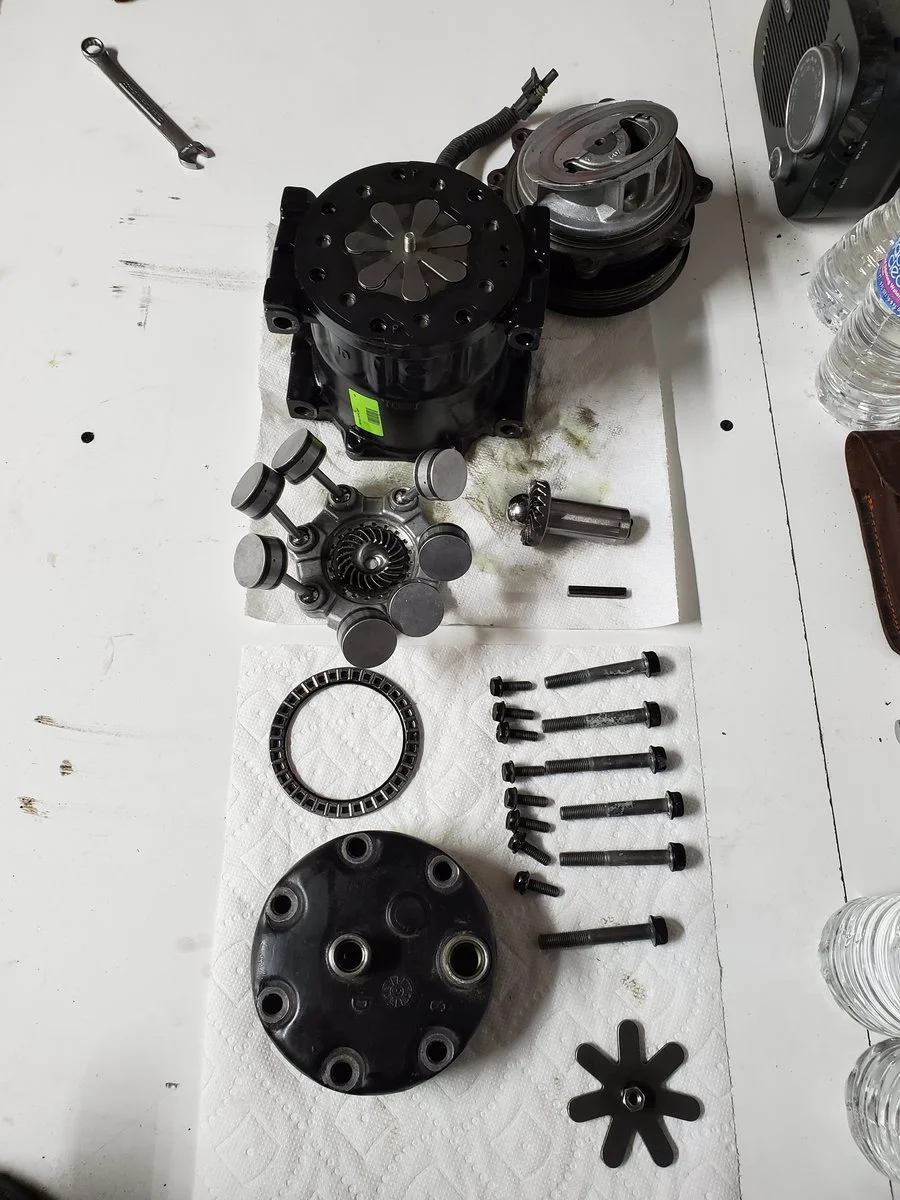

so? Is the Sanden AC compressor an AC unit? House current? If so, what converter is used?

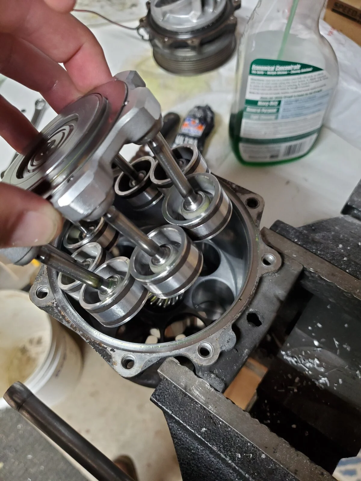

Just the compressor. It sucks air thru the intake, enters an oiler, gets pumped thru the compressor, discharges and captures any oil mist thru a filter. A little wobble disc rotates when the clutch is engaged, which drives the air thru the discharge port
