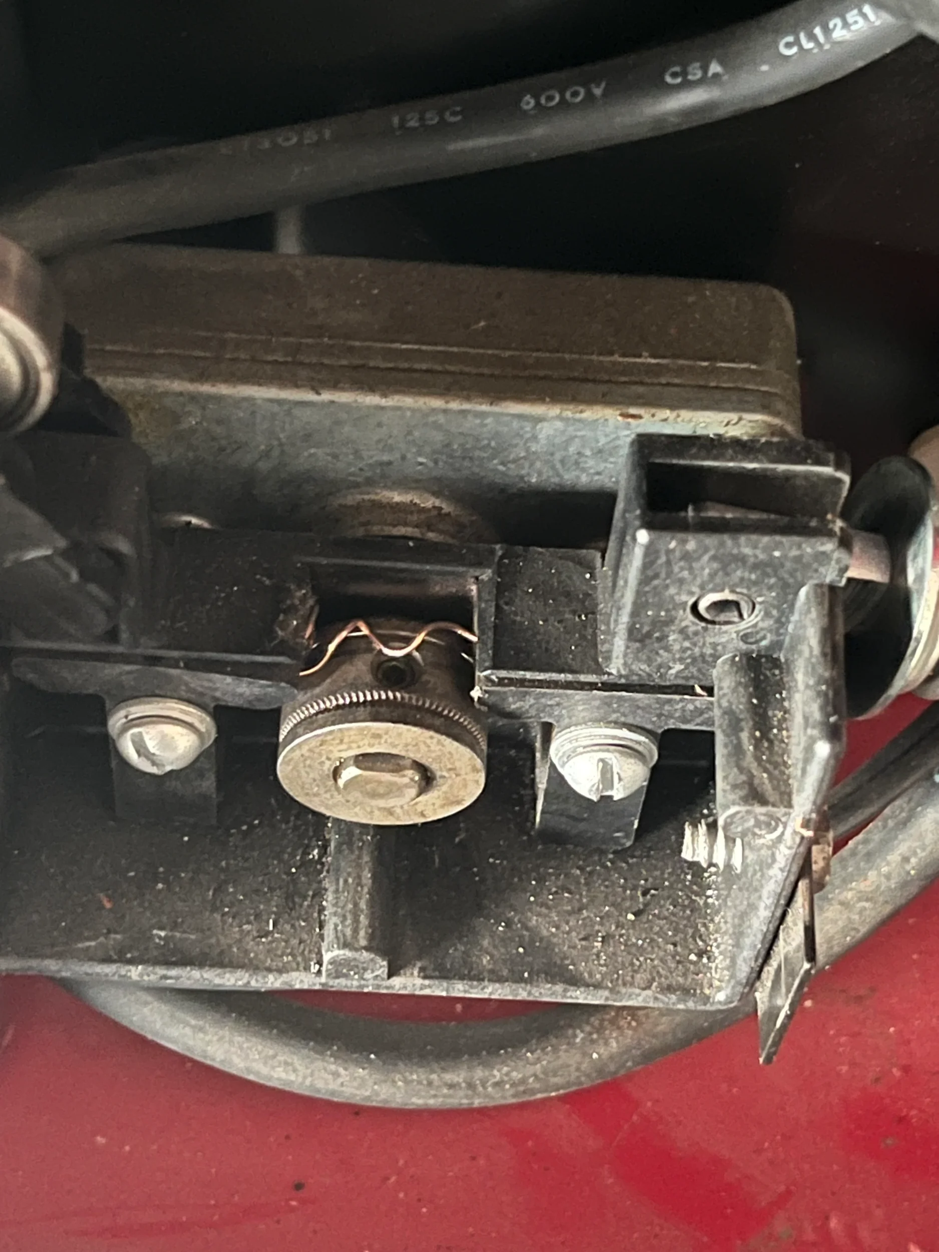

Bird-nesting can be very frustrating to deal with because there are many causes, but you're on the right track. It happens when the resistance to flow through the liner is so high that the wire isn't stiff enough when pushed against it. Ideas to investigate:
- Check all your gun parts for damage that will "pinch the wire." As MtPockets noted, replace those parts as necessary.
- Are you using flux-core or solid wire? For flux-core, use the knurled groove and for solid, use the v-groove.
- Make sure you don't have so much tension on the upper roller that it's crushing the wire (it is possible to have too much tension.) Crushed wire gets wider and can be pinched downstream. This isn't likely to be a problem with solid steel wire, though.
- Make sure that your spool tension is just enough to prevent free-wheeling, but not overly tight.
- On my Miller, the end of the liner projects to the pinch point of the rollers inside a conical plastic holder. That holder's position is adjustable, and I always try to get it as close to the pinch point as possible. With smaller wire (.023"), this can make a huge difference because is so easily bent. Here's a drawing showing what I mean:
