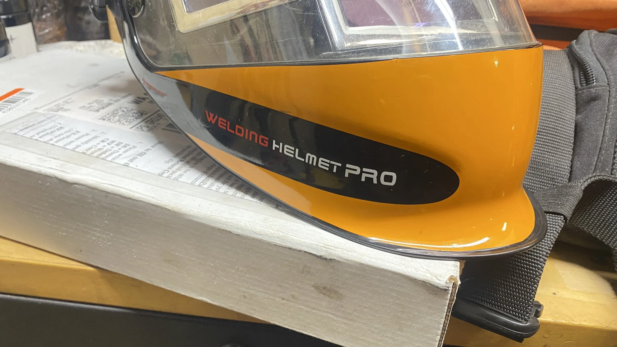

Is this welding helmet any good? YesWelder Welding Helmet Pro. I’ve had times when I had difficulty seeing my welds, so I usually put light on it, which is a pain.

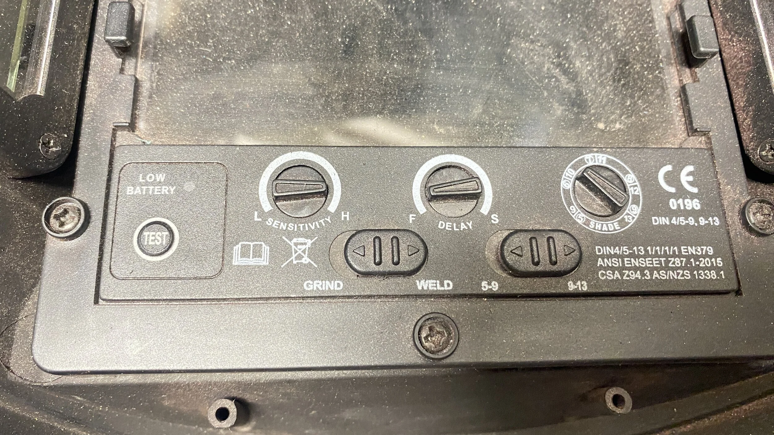

What about these settings. Should I turn the shade down? And what’s the slider in the bottom right?
I'm not familiar with that specific hood, but I've heard good reviews about YesWelder products.
The slider on the bottom right changes the shade range from 5-9 to 9-13. Sensitivity refers to the degree of light required to engage the shade: the brighter the light, the darker the shade. Delay refers to the speed at which the shade engages once light is detected.

Thanks for the explanation of these settings. I’ll fiddle around and see if I can improve my ability to see.
You could try a lower shade setting but I don't recommend going below a 10 for a long period of time. It could be that the lens itself needs to be cleaned with some wipes designed for glasses. Also don't forget to clean the lens on the inside. Welding outside or in poor lighting conditions can also affect your vision.
