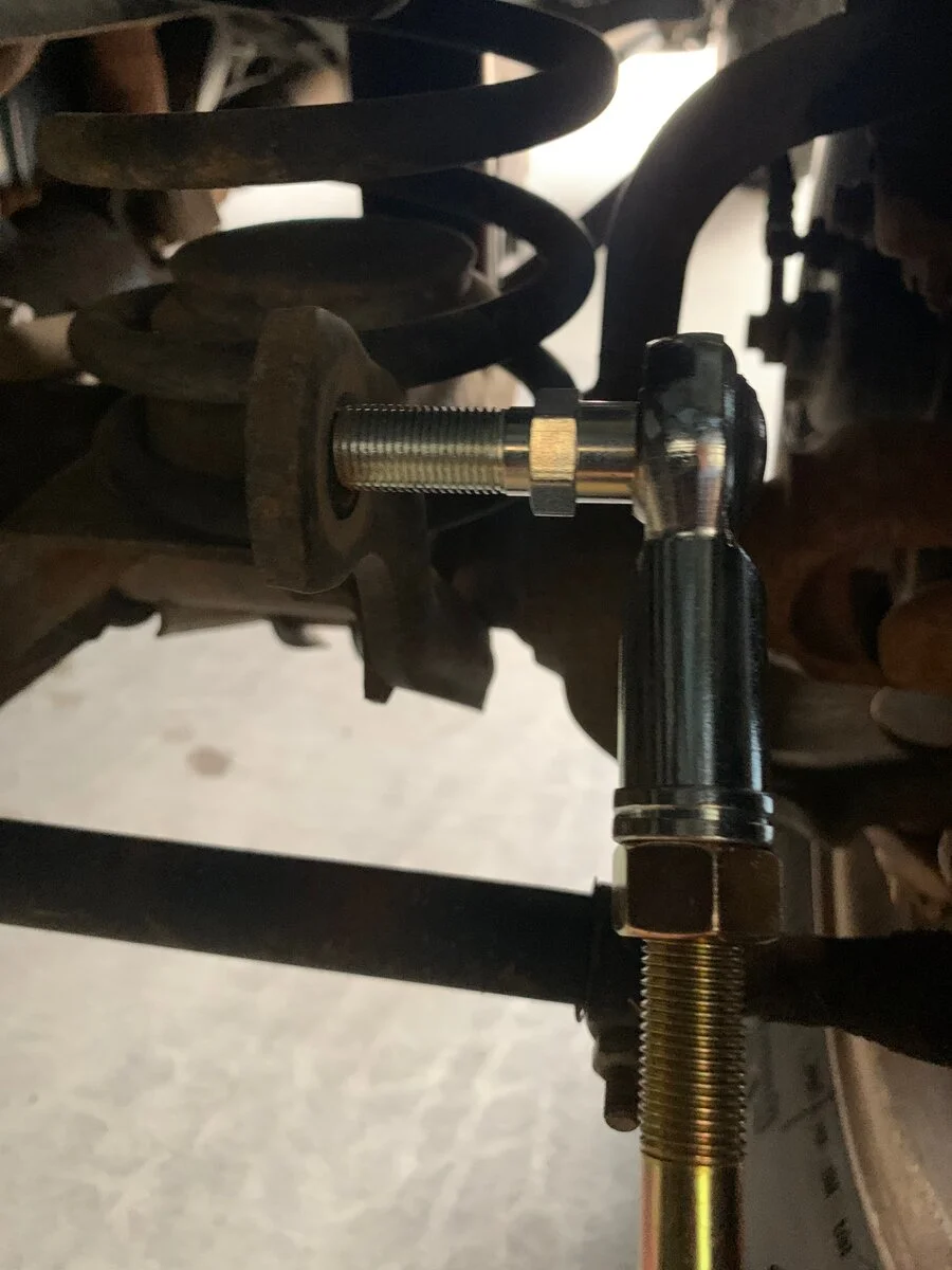

Anyone ever run into this issue when installing their RockJock Antirock?
How much material did your 1/2" drill bit remove? Were you just basically clearing the holes out or were they originally a different size entirely? I could maybe see a small small difference, but would be surprised by a large one.
It didn't remove tons of material, but it removed enough to have me thinking there is no way those holes were ever 1/2" to begin with.
I thought the stock size was a 12mm, not a 1/2" (can't really remember, been years since I messed with it). Maybe some holes are slightly bigger on some TJ's. Judging by other tolerances seen around the TJ, I wouldn't be surprised.
Here's the factory bolt next to the heim joint:
The factory bolt measures almost exactly 12mm on my digital micrometer.
The heim is closer to 13mm.
