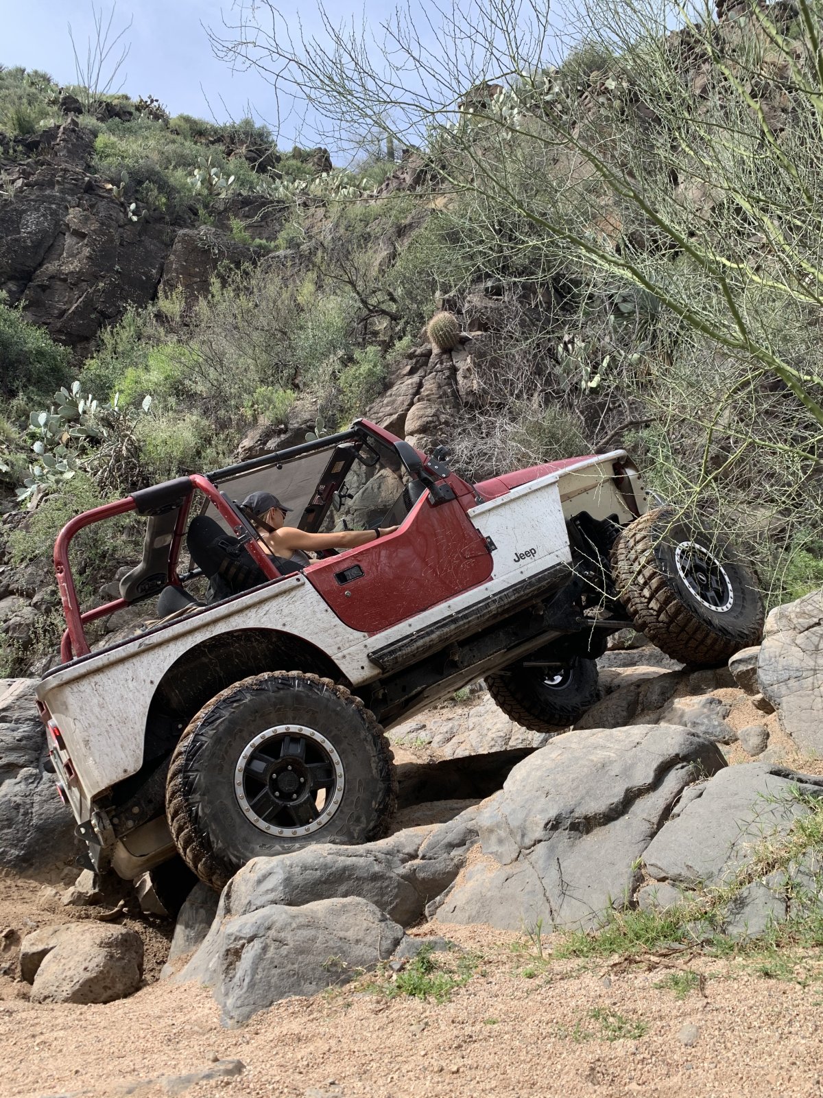

Went wheeling today for my dads birthday. Brought my wife and my stepmom out on a mild but very fun and scenic trail that goes through a forest out to a lake where we had a little picnic.
