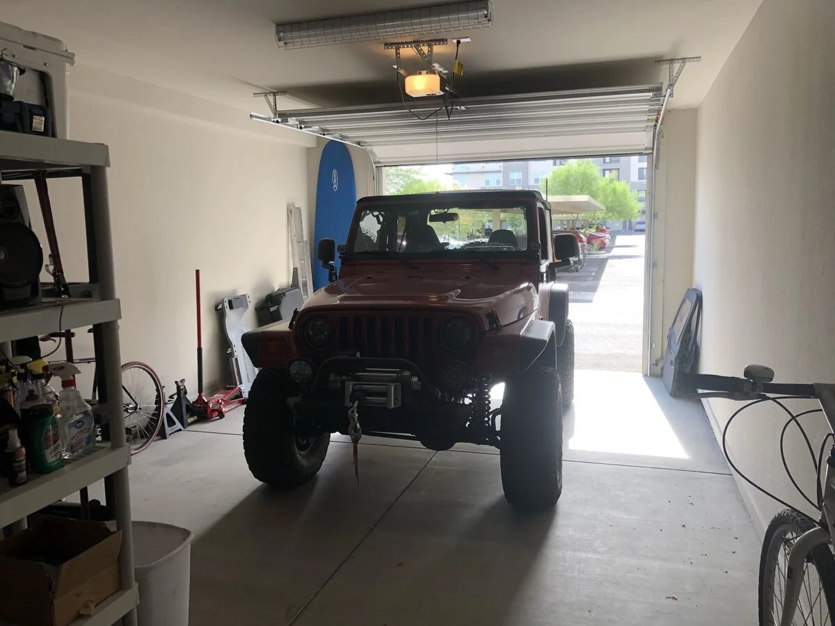

Life mod today! Got me a new garage! Can’t believe I’ve been doing everything in a single car garage up to this point

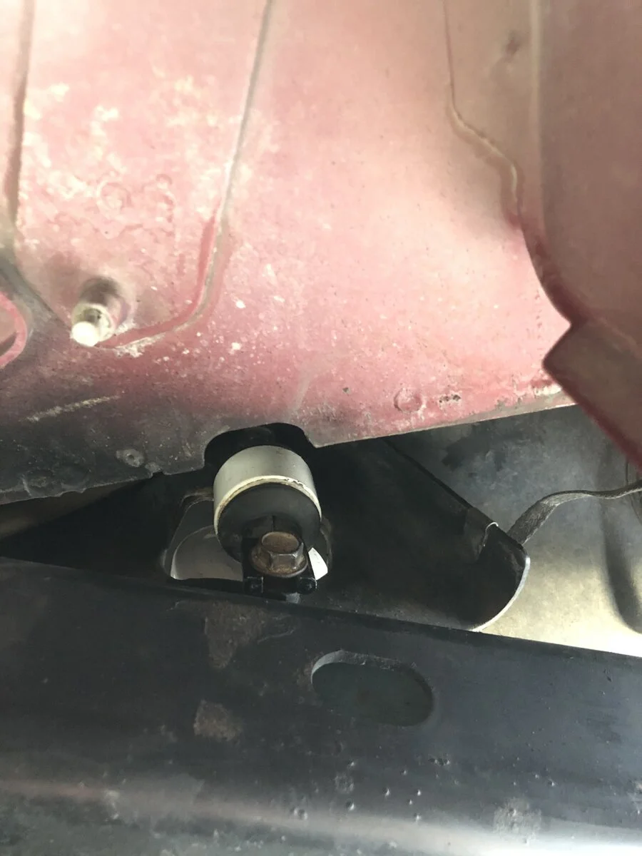

For those wondering I was able to remove just shy of an inch of bumpstop extension with this mounting position. Just trying to make @jjvw proud with ghetto bump removal mods.
Anything to make the shocks fit and work better. Are the uppers through bolted or are they relying on the tack welded nuts?
In heaven with all this room to work now .
The bar pin is resting on the welded nut and the bolts are going down through the nut now instead of up

Add another nut on the opposite side if you have enough thread length. Otherwise you’re relying on tack welds to hold your shock in place 👍🏼
No it was just a theme in @jjvw s build thread that he was ghetto rigging his mounts to change shock travel
There was a thread within the last couple weeks. The big flaw in that one was reusing the welded nuts from above. Other concerns are making sure the shock body doesn't interfere with the frame or with the crossmember itself. As with anything like this, the axle needs to be cycled without springs to see what is going on.
The flaw with mine or the other thread?
I will definitely do that. I may get some longer bolts
Most definitely with the other guy. ;)
The bolted connection needs to pass through the crossmember. The factory welded nuts, at best and if they are kept, become a spacer.
