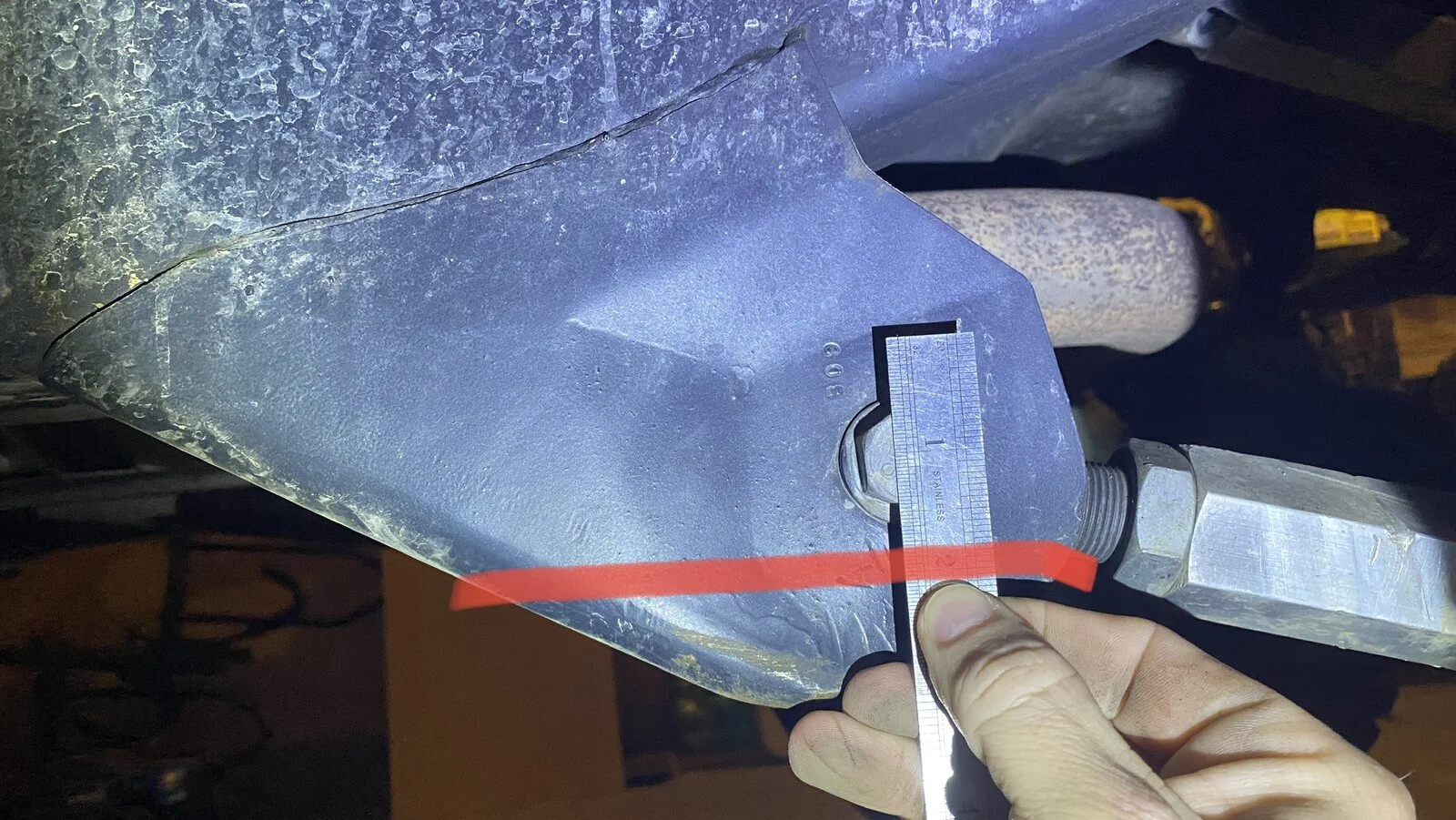

Boxing in lower control arm mount
That really weakens the mount. Are you sure you want that?
If @JMT were to cut as described and then plate the bottom of the mount, would he regain most (if not all) of the strength lost? Obviously the plate would need to account for the range of motion of the arm.
Reactions: JMT
