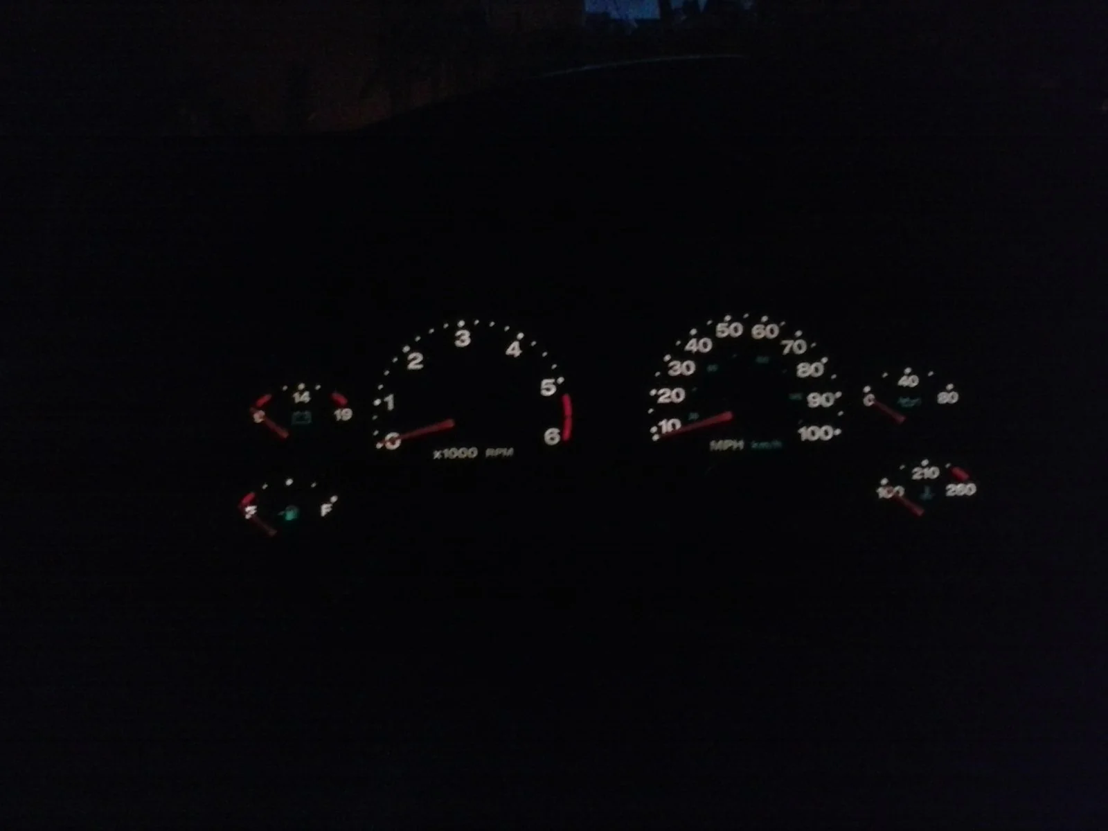

I installed some cheap ebay ones today. http://rover.ebay.com/rover/1/711-5...0001&campid=5337789113&icep_item=322580654861

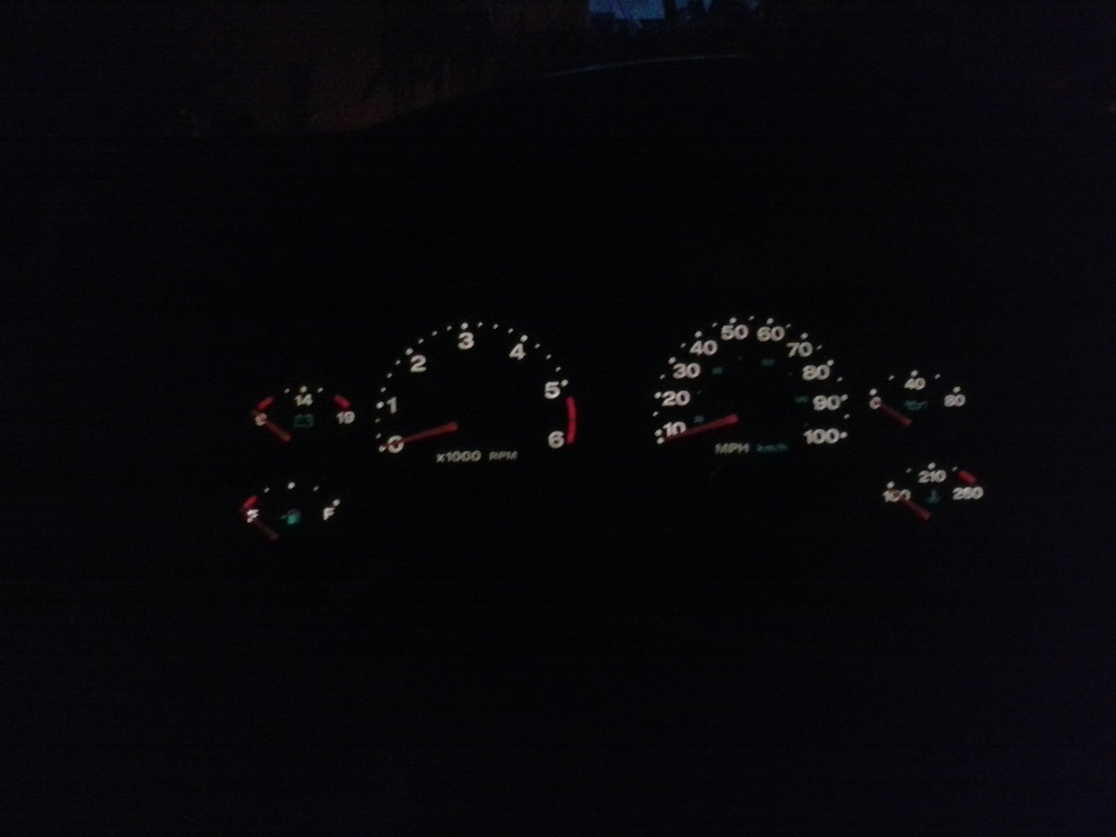

Before

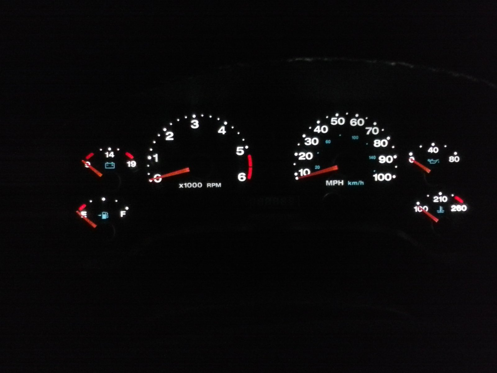

After
There dimmable and for 2 bucks-why not.

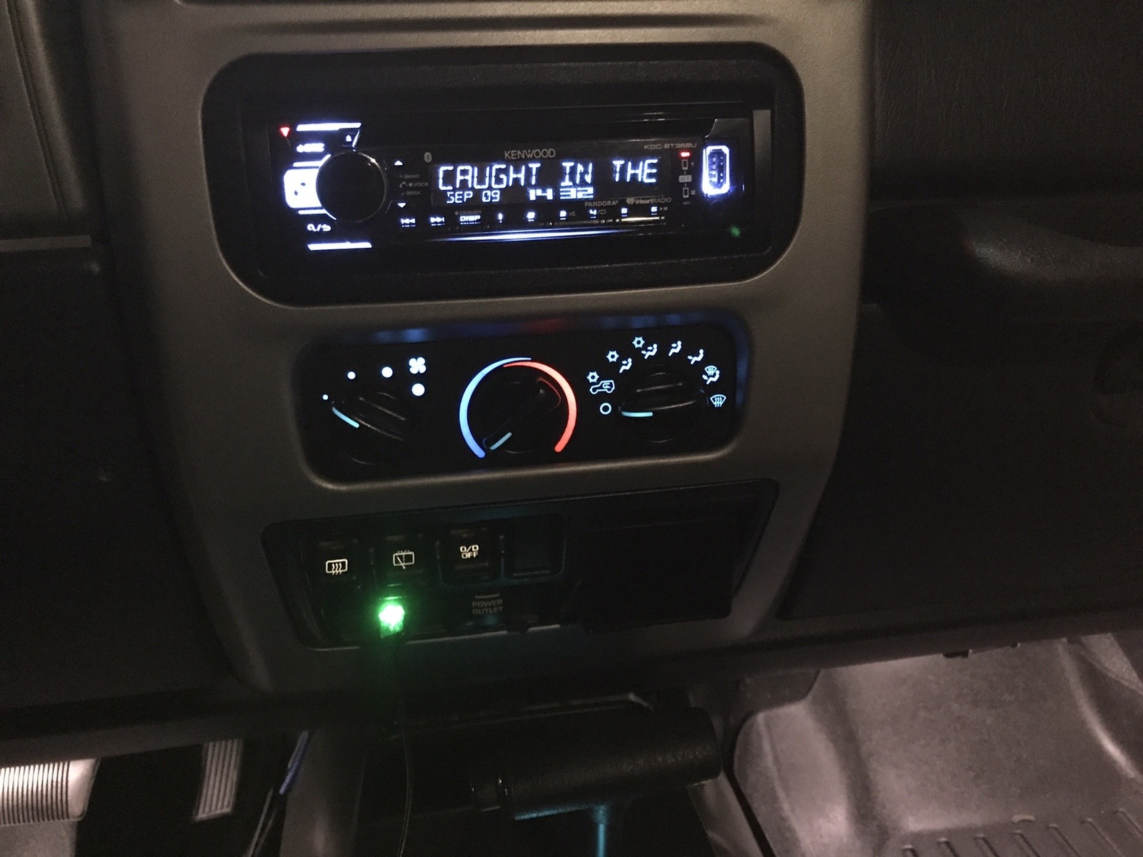

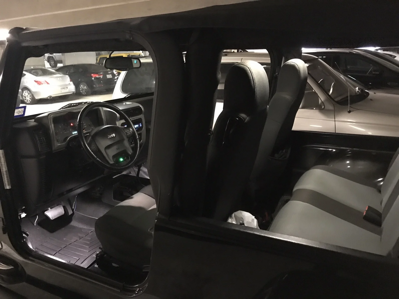

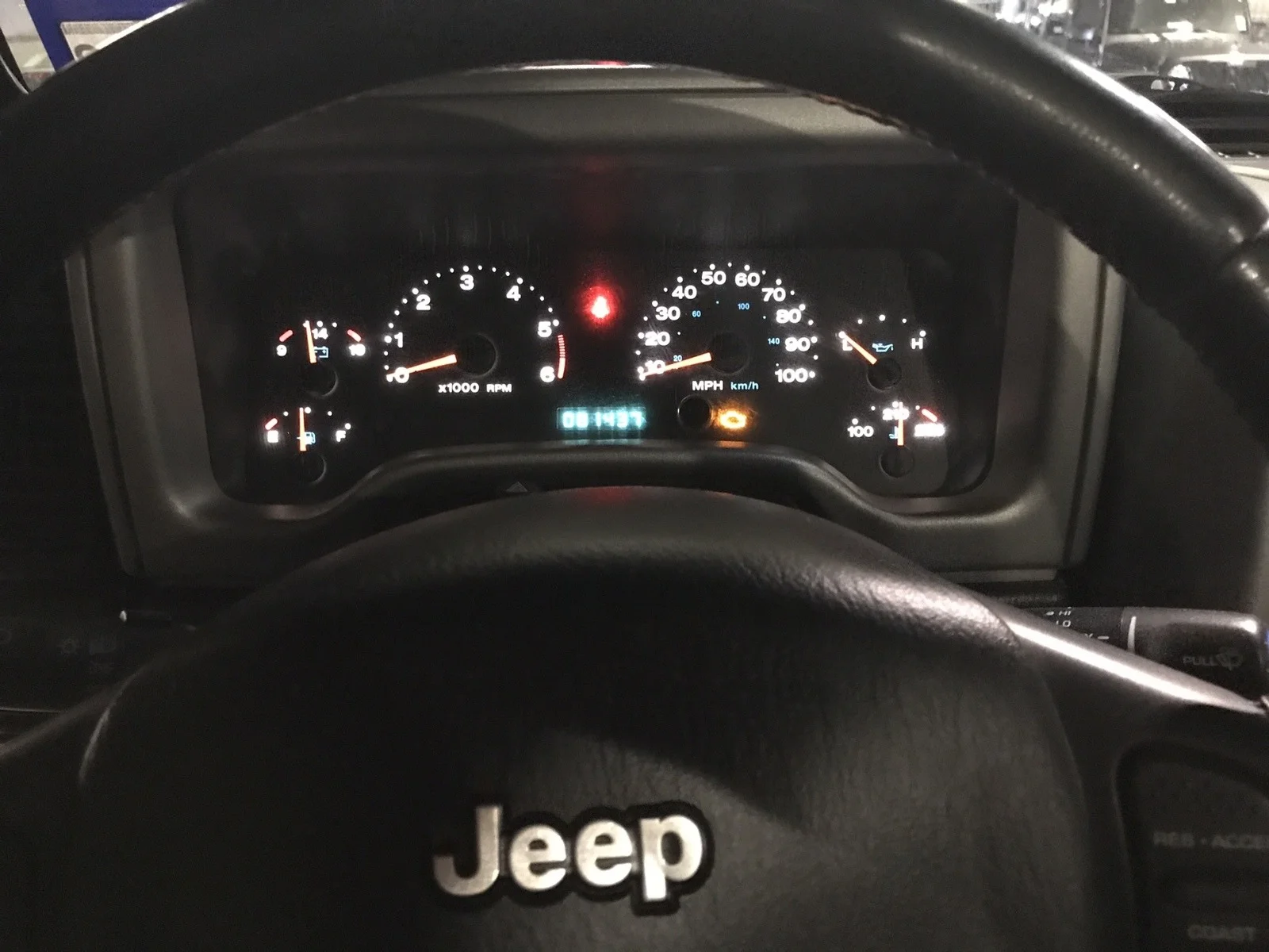

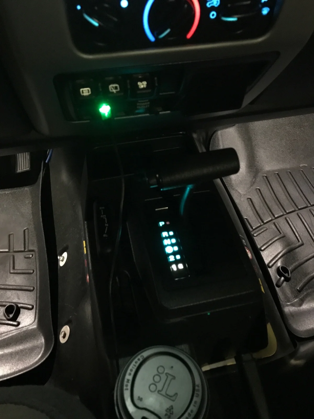

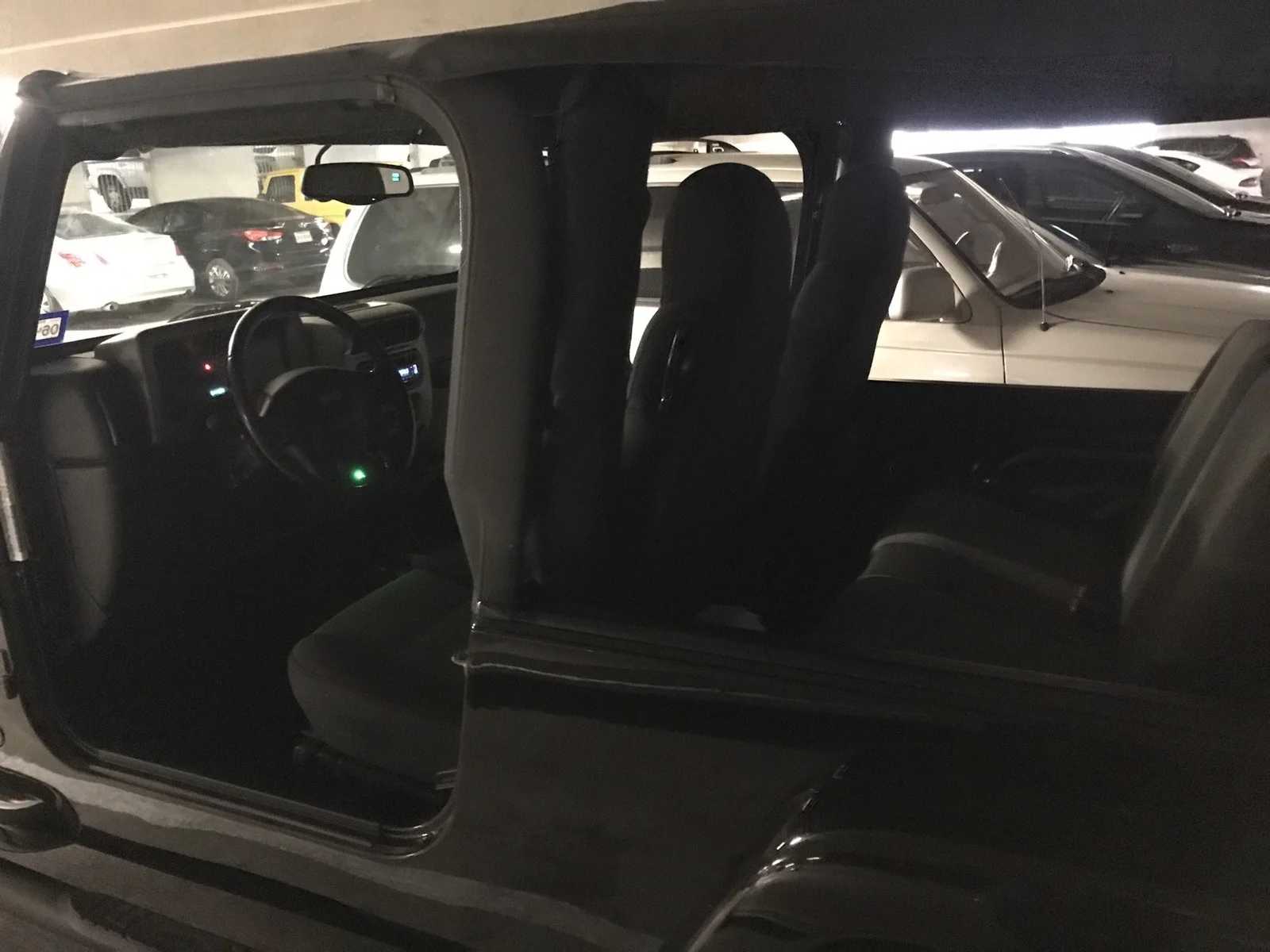

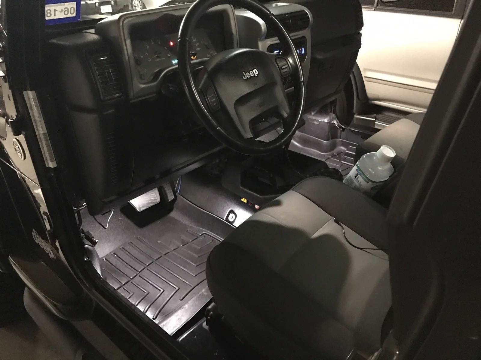

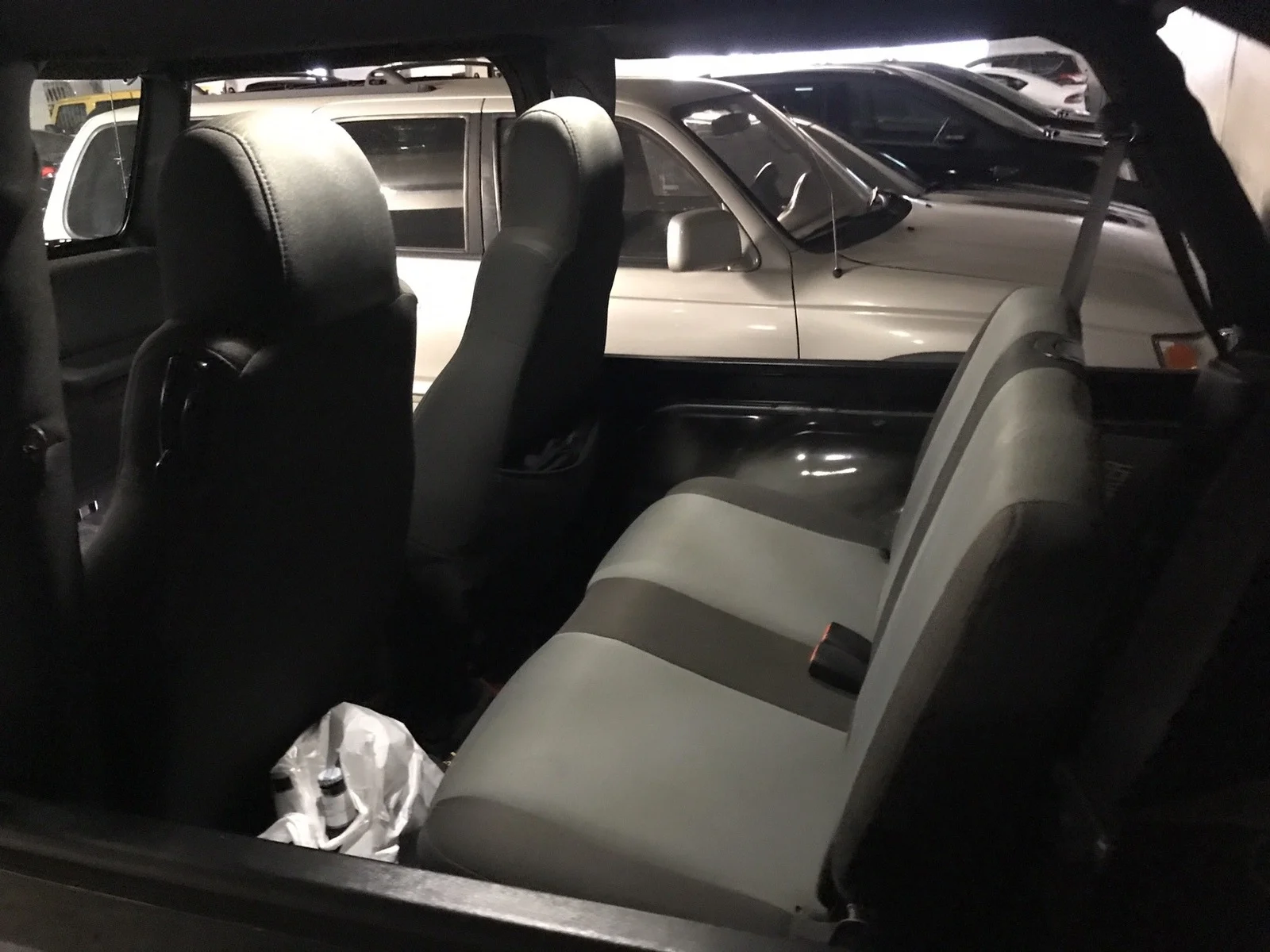

I did a full LED interior swap using LEDs from superbrightleds.com. I did all the accessory lighting, cluster lights, HVAC lights, and tranny light. Everything was plug 'n play. Hardest part was just taking apart the dash which I just watched youtube videos for. It is a night and day difference from the old incandescent bulbs. Im planning on doing all exterior lights next.

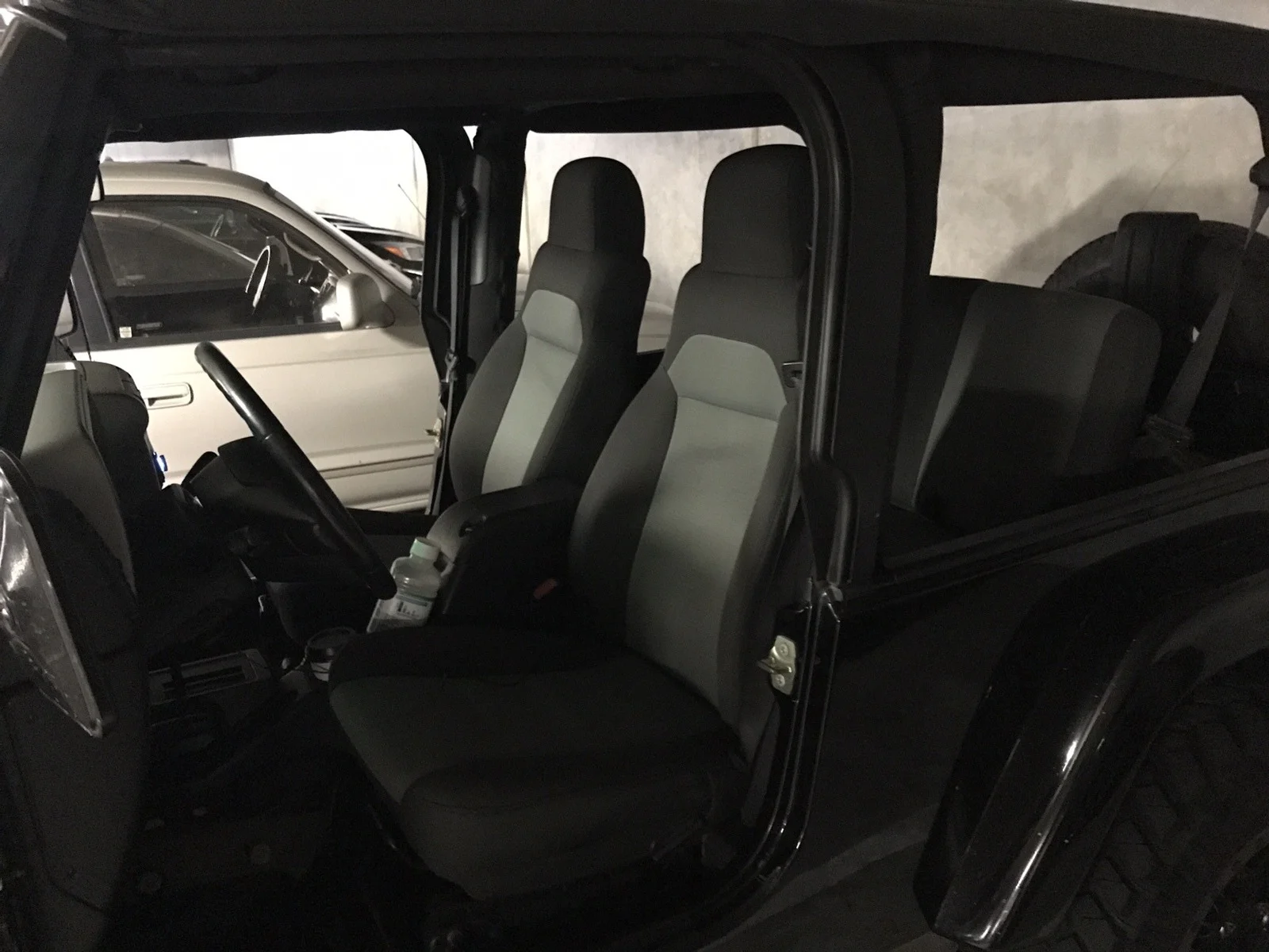

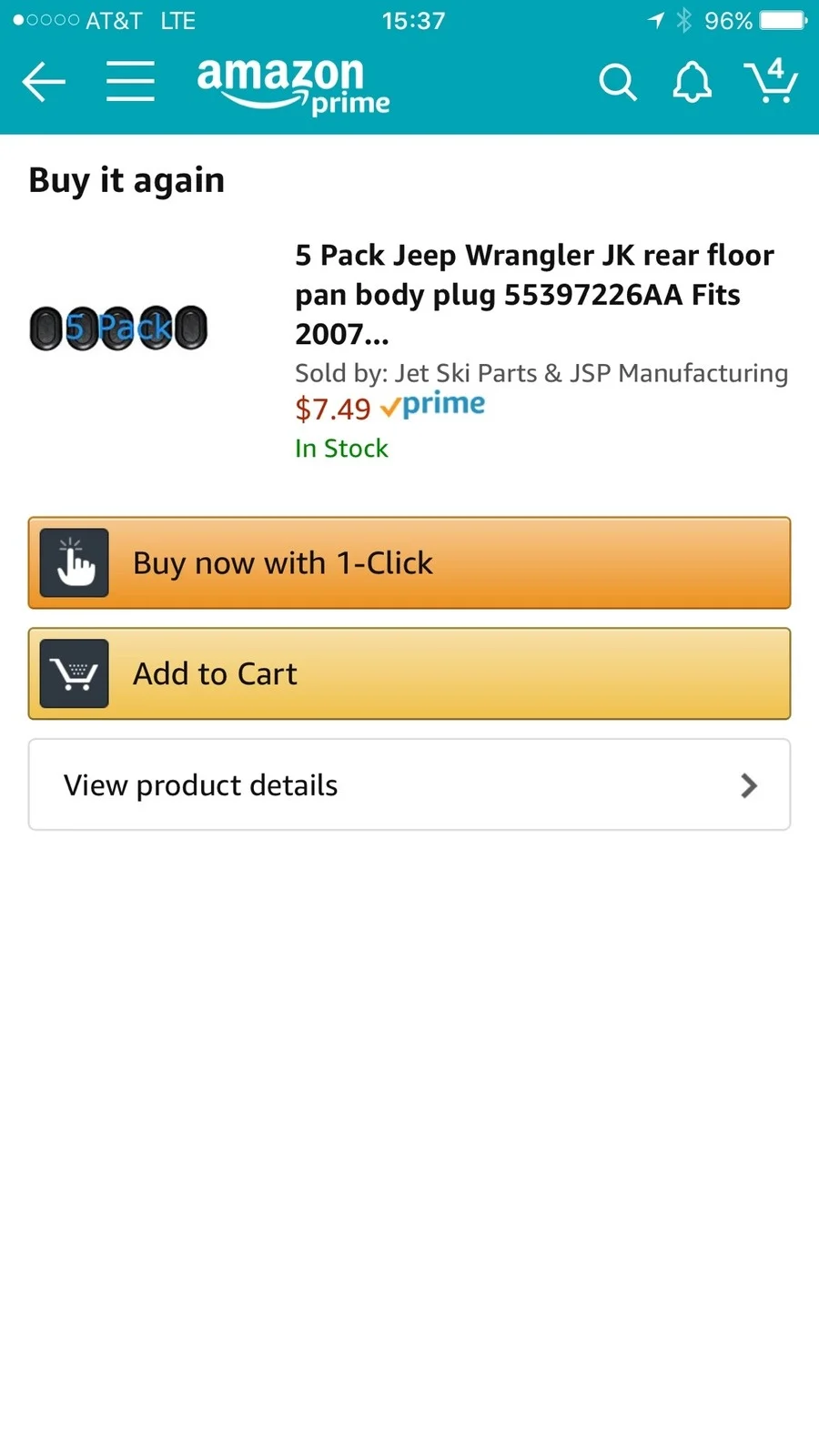

I also removed my carpet. Since the top/doors are always off in Tx and it has gotten caught in the rain a few times. I removed the "semi-permanent" floor plugs and ordered the rubber JK plugs off amazon (5 for like $8 or something) and replaced all my drain plugs so everything is easily removable and drains easily

That makes a huge difference. Looks great.
If they are anything like mine they do last well and you can get a variety of colours. You just need to take out your dial cluster and surround which is held in with about 4 screws then it just pops out..the bulbs is a simple pull out the old and pop in the new...20 mins and your done. (did the centre around the temp gauges too)

Those look awesome! You have a list of bulb numbers?

Did you use those to replace the oval plugs that are glued in from the factory? If so, do you have a link to the plug you used?
Yep, used a screwdriver and scraper to pry them up and remove the rubber seal. Then put these in. They are a direct fit replacement. My LJ needed i think 8 total.

That is fantastic, I removed the carpet from mine and like to use a hose just to clean the interior floor. These will be great, thanks!
