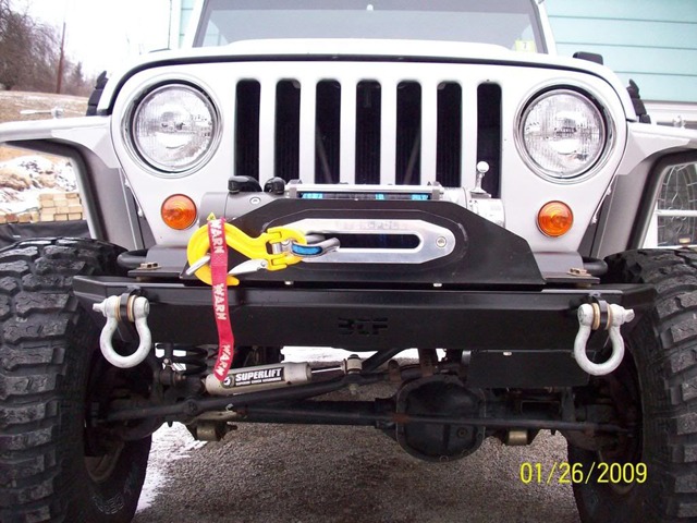

If I said 3 1/16" somewhere please give me a link to that post so I can go back to correct it. I just double-checked the hole my JK signals are in to make sure and it's definitely 3 1/8".
It's easily done with nothing more than a 3 1/8" steel hole saw and a pair of JK turn signal enclosures, I did mine years ago. JK front turn signal enclosures fit the 3 1/8" hole perfectly. The TJ's front turn signal bulb enclosures fit the JK turn signal enclosures perfectly.
If you get serious and are ready to do this, I have a few additional tidbits to make the mounting of the JK enclosures easy so they don't require anything additional to old them in place. The enclosures can be made to twist-lock into place with no extra hardware required.
These photos are from my previous TJ but I did the same thing on my current TJ.
View attachment 61816View attachment 61806 View attachment 61807

I added a 4th photo to my post back on the first page. You can see the notches I added to the hole so the bulb enclosure ribs can slide through them. The 3 notches are clocked 10-15 degrees from straight up as discussed above.

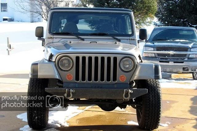

Couple photos I've saved off the web...
That looks perfect. The proportions are right on. It looks like it came from the factory that way. This is exactly how I would like mine to look.

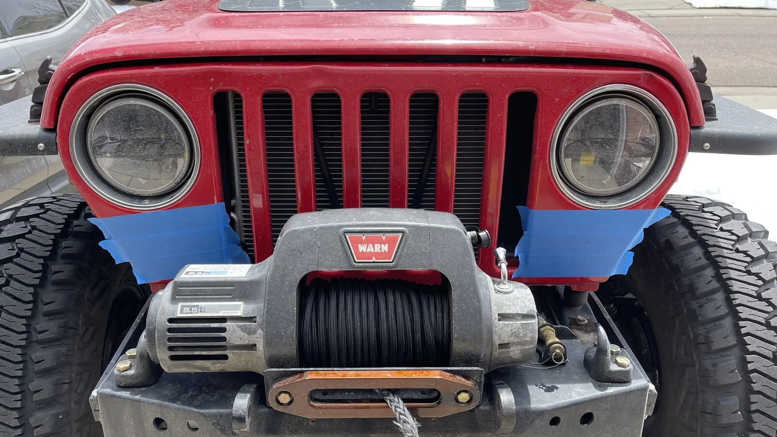

Use lots of tape to sketch things out over and over!
