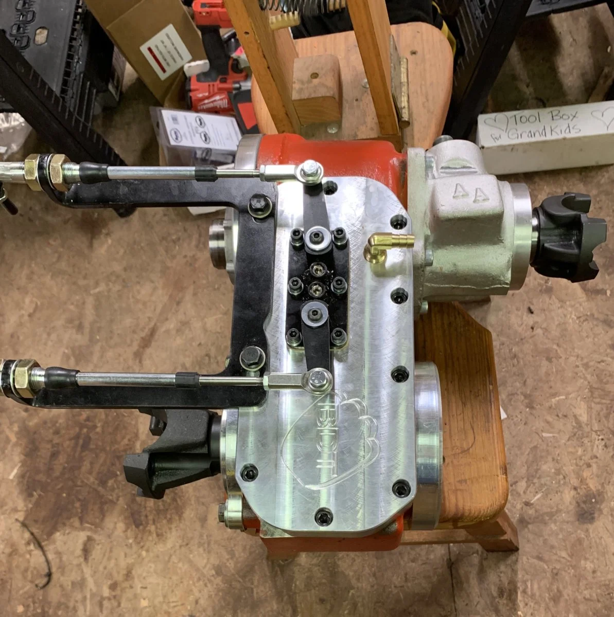

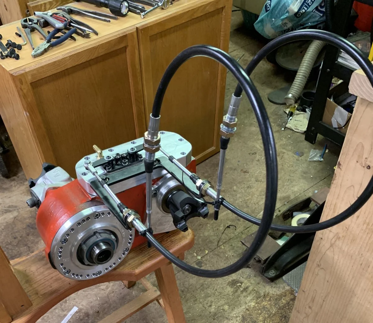

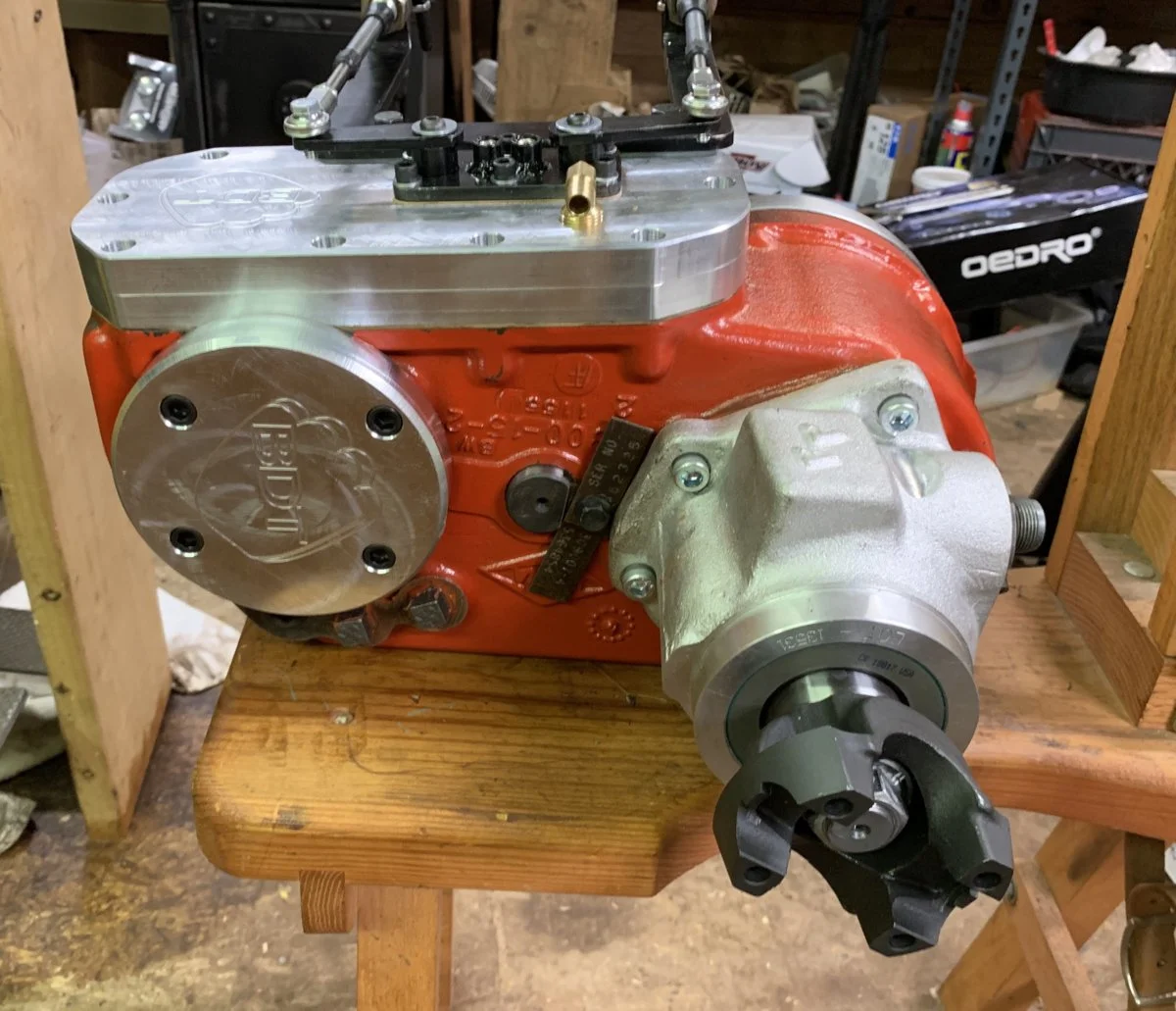

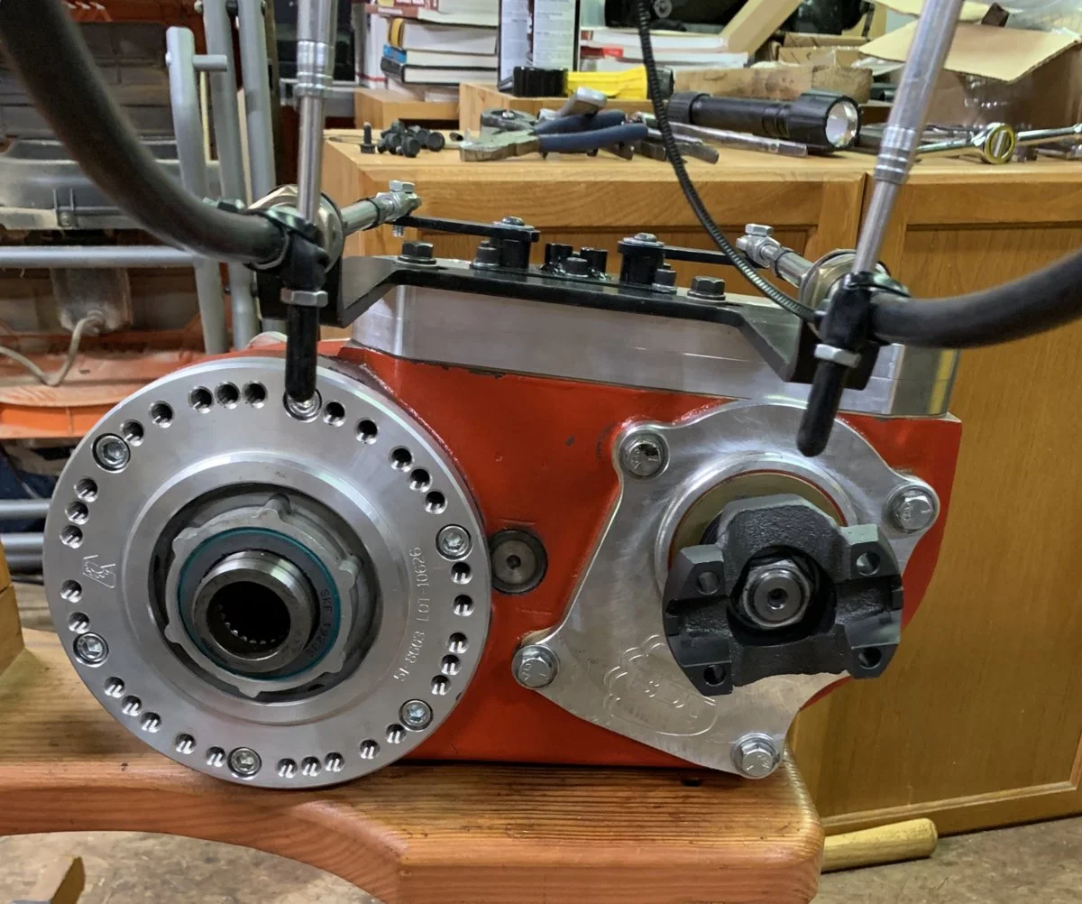

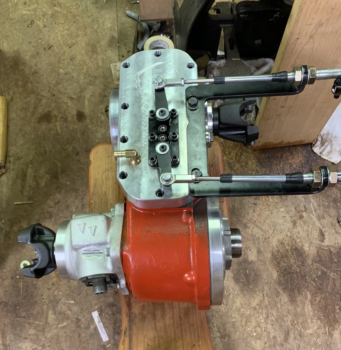

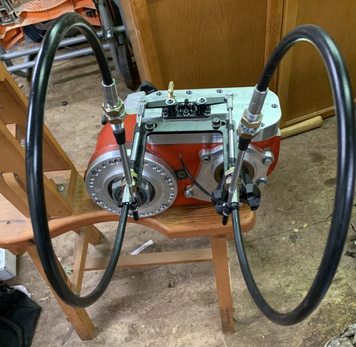

Build notes.
The Dana 300 tear down was fairly simple following this youtube and sister reassembly .
To prevent leaking of the leaky Dana 300. I tapped the shifter tube holes 1/2 NPT and installed NPT plugs along with silicone. The Behemoth front output shaft cover plugged the fwd shifter holes. All new bearings came with the LOMAX, plus 32 spline output shafts preventing the need to buy and replace. I did replace the idler gear shaft and needle bearings 19.99 from Moog.
I will be attaching a clear tube from the bottom of the rear output shaft case breather to the top breather wit a T fitting then vent it up and over the frame. This will give me a site tube to visually inspect the oil quantity in the 300.
