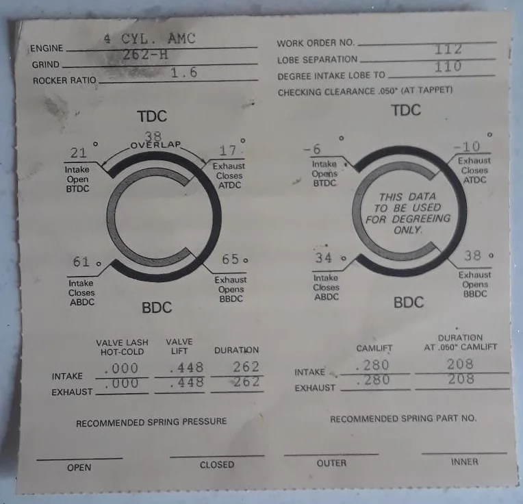

I've only put about 35 miles on the new engine (been working a lot). So far everything seems fine - good oil pressure, idles nicely, is peppy, etc. I'm trying to drive it easy around town to get it broken in properly. The original engine always ran well and the Jeep was kinda "peppy" when driving around town (and when not towing my lil' trailer) right up until it decided to implode. I never had any issues with the 2.5; I just didn't expect it to be a rocket ship so I just went with the flow.
They put an RV cam in the Titan engine. It is custom ground for Titan by Schneider Racing Cams, and I am under the impression after talking with Titan that this is a mild cam. I understand the principles behind cam-talk, but I don't know what the factory specs are for the 2.5's cam. This is what came with the engine's paperwork:
If anyone is fluent in cam-speak and wants to fill us in on what these numbers mean (in relation to the factory cam) please go for it.
Late reply to this as I'm not any where near a wizard about this stuff. Maybe this will help? Hope all is going well with the new engine.
https://www.motortrend.com/news/read-camshaft-specs-engine-masters-ep-19/
