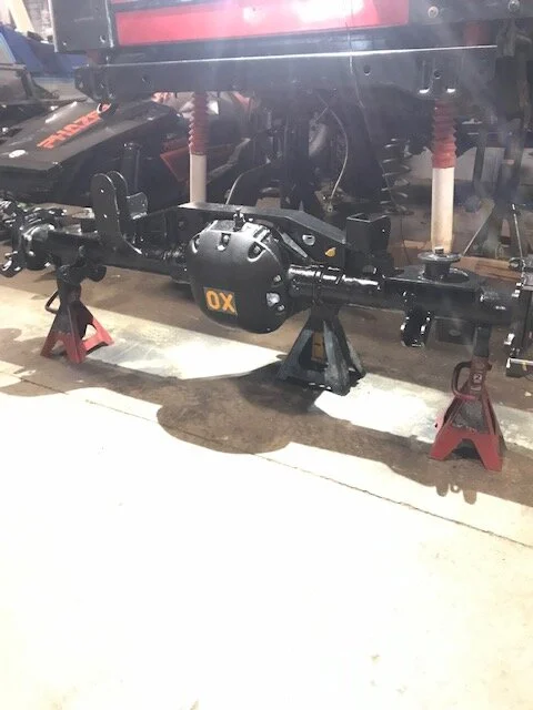

Here is my 8.8. Very rewarding project, been running it for years with ZERO issues. This isnt for everyone, either is spending thousands on a 44. There will be an argument on the differential being offset. I wouldnt steer you away from it.
