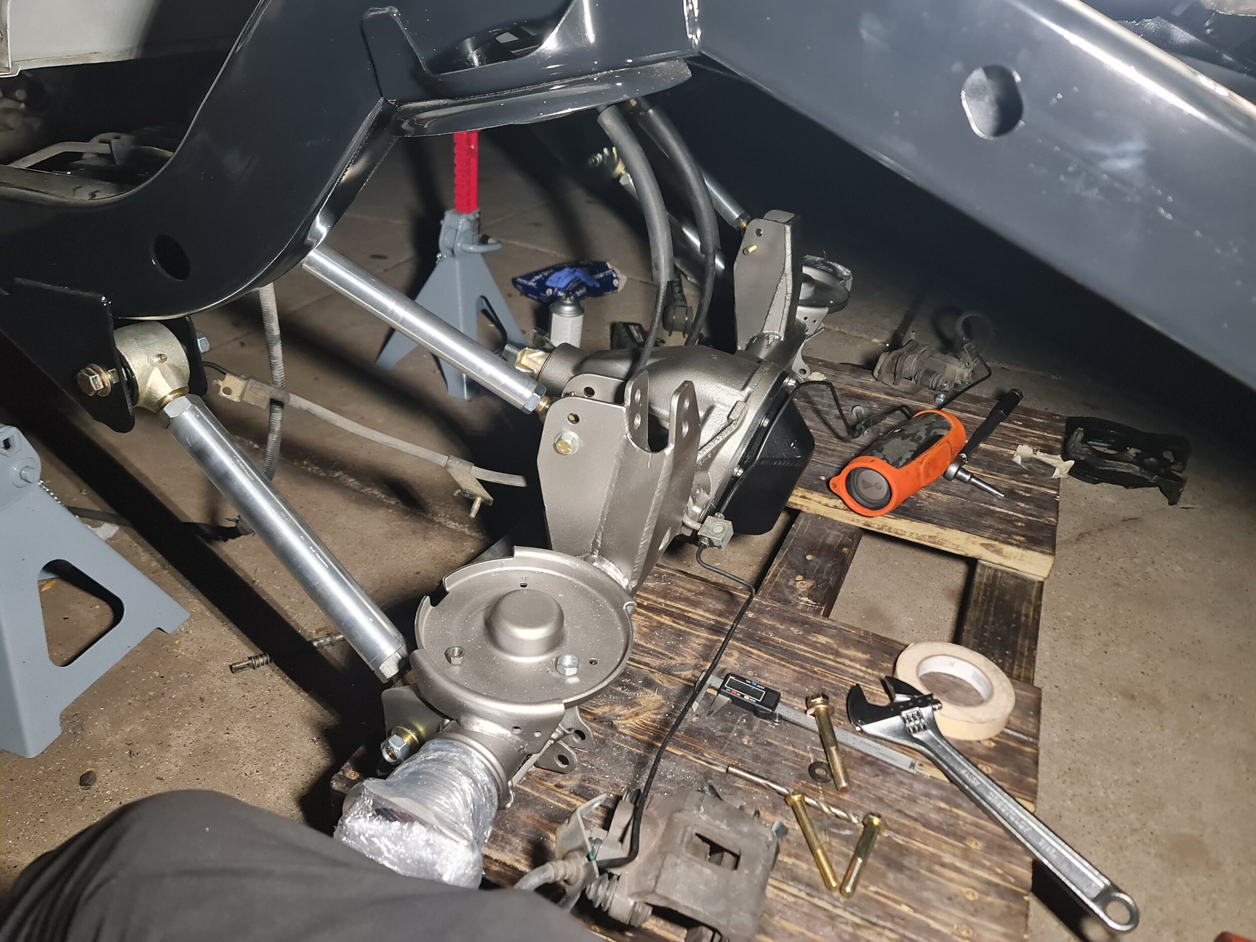

Parts I have in hand:
*Currie ford 9" housing for a 67-70 Mustang Only "dilemma" is that the bare housing from Flange to flange is 54" the stock Tj 44 housing is closer to 55.25 Ish inches or so
*Currie nodular 3rd member,I just need to regear it to 4.56
*Currie cut to fit shafts
*4 piston wilwood brake setup
My goals: Id like to add coilovers at some point maybe? and I've read that having a wider axle would make it easier to package! I also have a Dana HP44 from a 78 ford I'd like to do one day,So I may need to get an even wider axle but then it'll look goofy with the current front axle being stock width (I'd kinda hate to run big spacers to match my rear if I did go extra wide in the back)
In reality: I may just send it and use what I got and do small wheel spacers to match the factory Tj width. because I may do a whole new housing when the time comes for the Hp44 swap upfront AND ā€Šregardless i still have to build my Hp30 so I'm gonna have to put my dreams aside and rock what I got āœŠšŸ¼

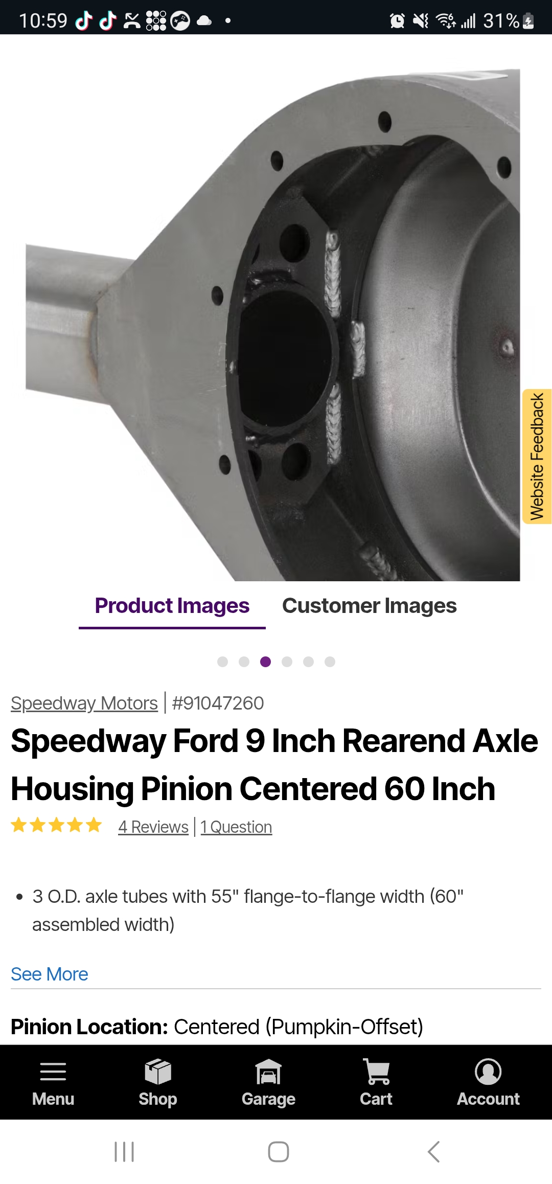

But I was also thinking of doing a speedway ford 9" housing that'll Essentially match the tj width (WMS) Plus it has internal gusseting if that really matters? But we're talking about an inch here really on WMS between the current housing setup I got Vs a stock Tj Dana 44. Part of me wants to ball out and go with Richmond axle housing (it looks like a currie F9 housing) But this endeavor alone is a stretch

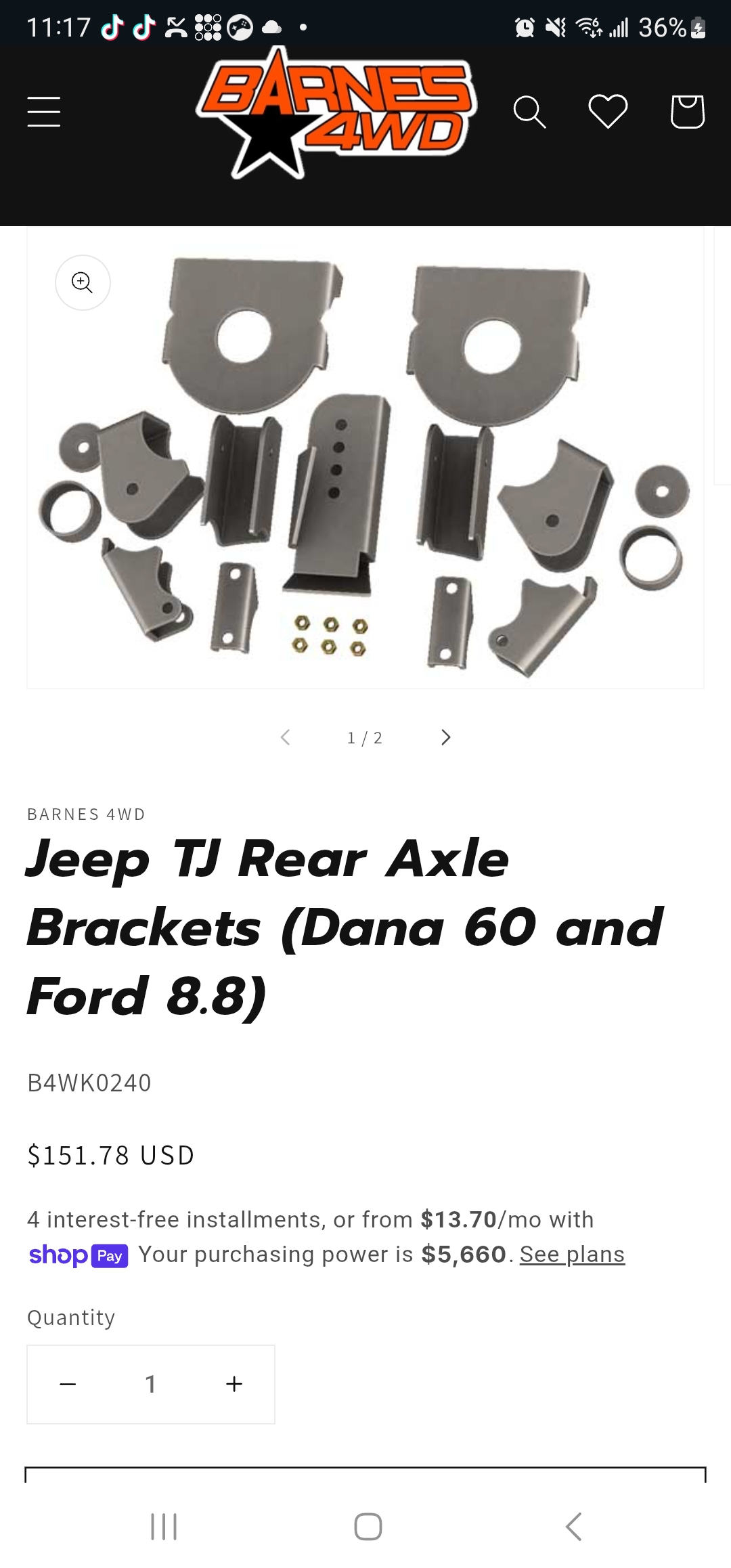

For brackets I was thinking about barnes,I like the Jeeps West brackets and the handling gain from em is something to consider (for me&the difference it made in my jeep) But these brackets are cheap
Thoughts ? Ideas? Threats šŸ˜†?I dunno
This axle after me doing the Jeeps West brackets didn't last so long,It was nice...I enjoyed it
Edit- While I'm at it im gonna correct the upper spring perches too,I have a kit from genright I got for cheap
I'm gonna have to assemble this current housing to see what the pinion offset is gonna be like
Plus I'm want to see what the actual WMS width will be with My wilwood kit,I'm saying this because it has some decently thick spacers that may possibly put me where I'd like to be WMS wise

Biggest issue I see with that speedway housing is the thickness of the axle tube.

That's one of the first things I'd be wondering about. A street car housing, especially for something like a pony car, will probably be built with fairly thin material, and not built for the abrasive environment of dragging across rocks.

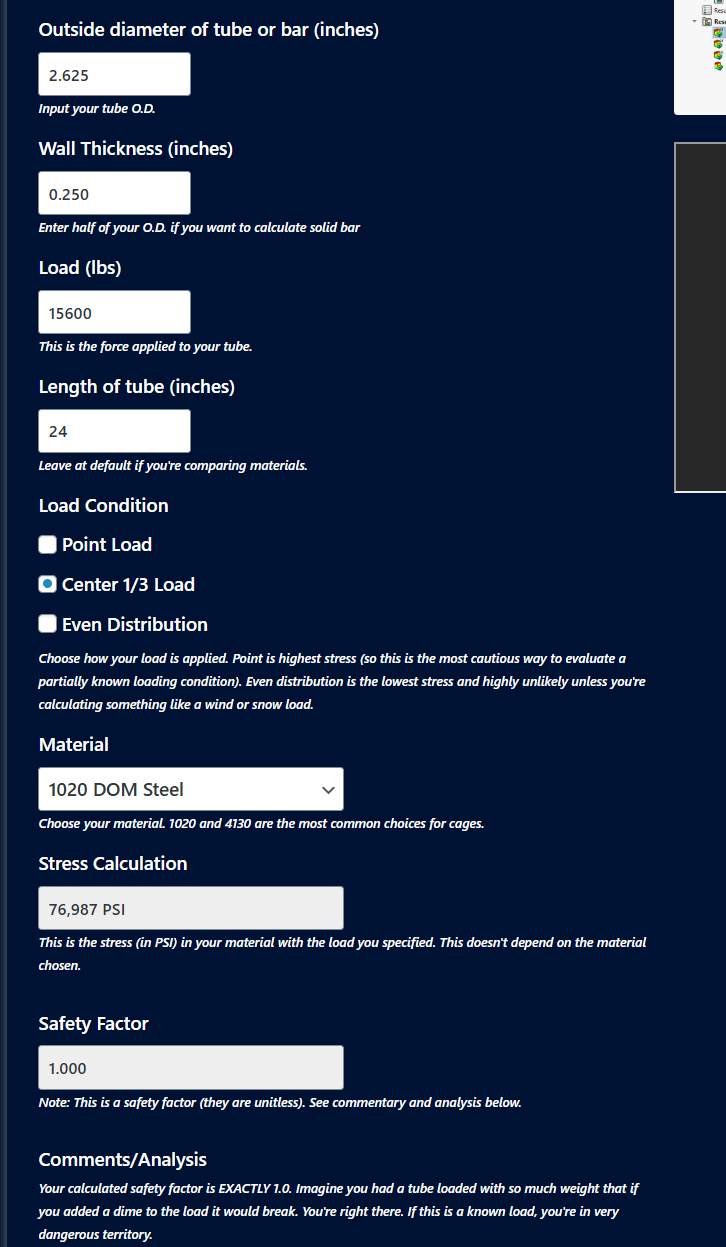

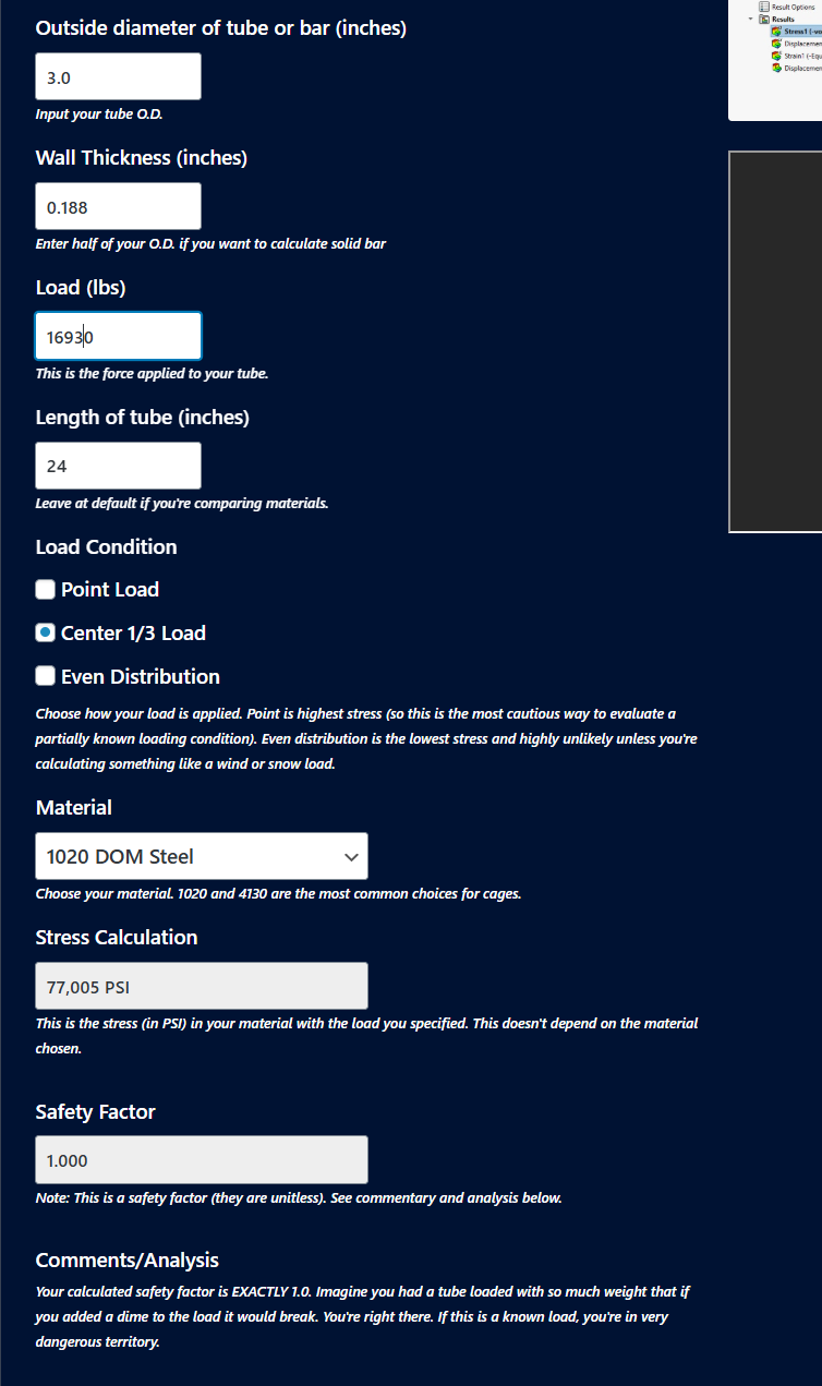

But with the tubes having a larger 3" diameter at 3/16ths thick wouldn't it be just as strong or stronger than my stock Dana 44 housing? The tubes on that thing are small compared to the ford 9" I got

With my current mustang housing coming in with larger 3" tubes granted it has 3/16" thick tubes while the Dana 44 comes with 1/4" tubes IIRC.
Wouldn't it be just as strong if not stronger simply due to the larger diameter of the tube even if it's a 3/16ths walled tube ?

As long as I'm not in that consensus, it's all good. I prefer not to guess. The larger diameter thinner wall tube is actually more resistant to bending forces by over a 1000 lbs. all other things being equal load wise.
