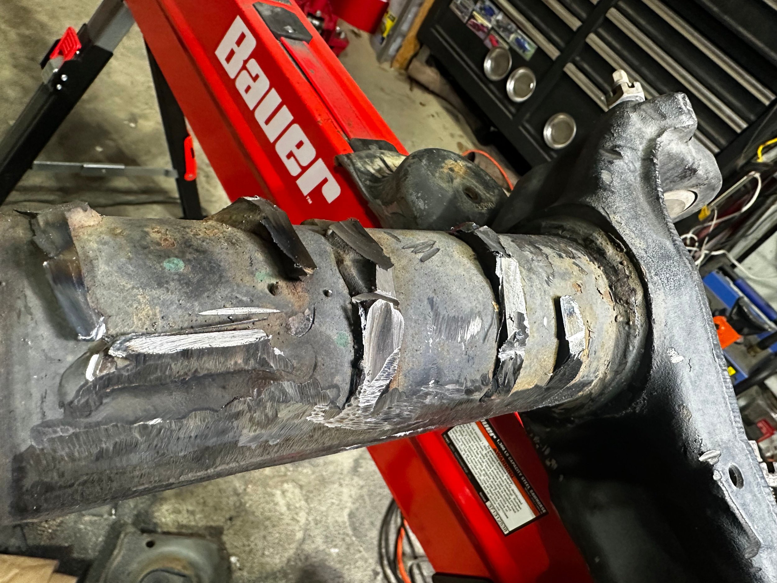

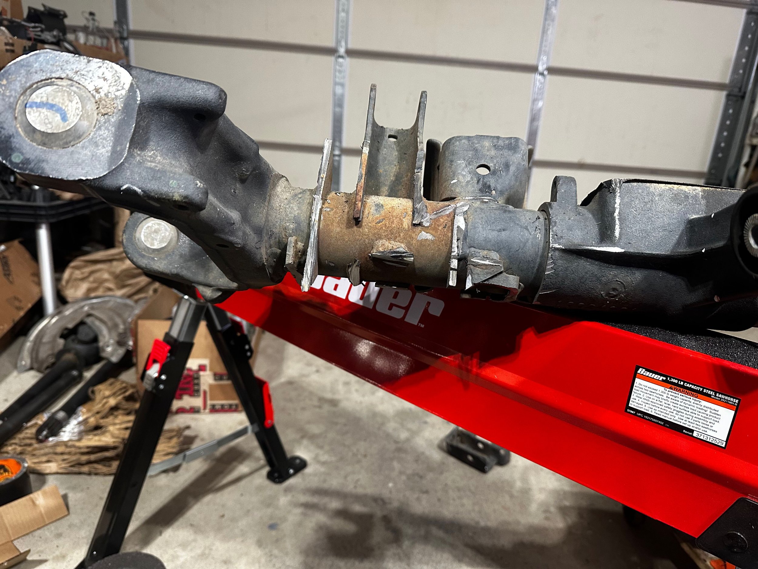

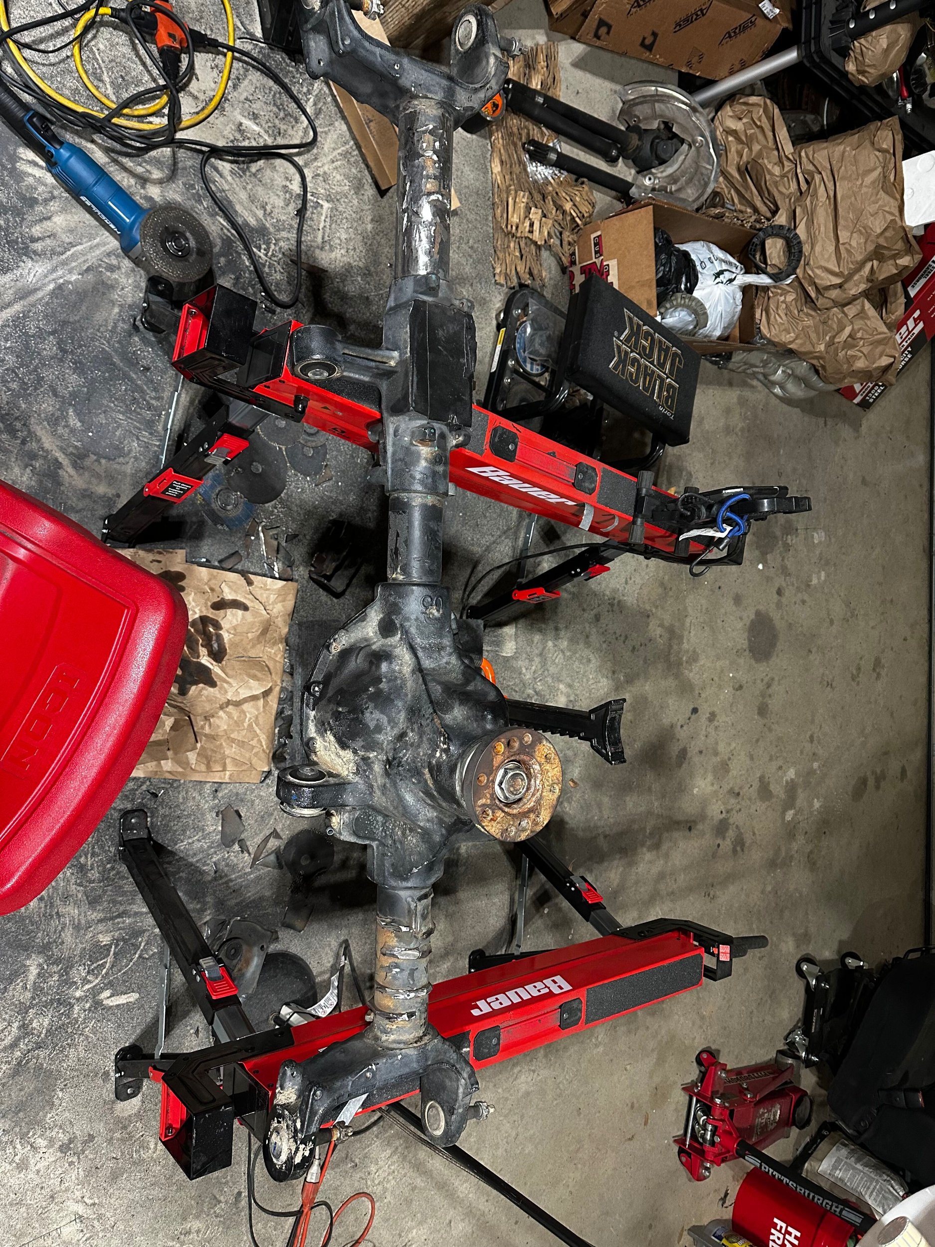

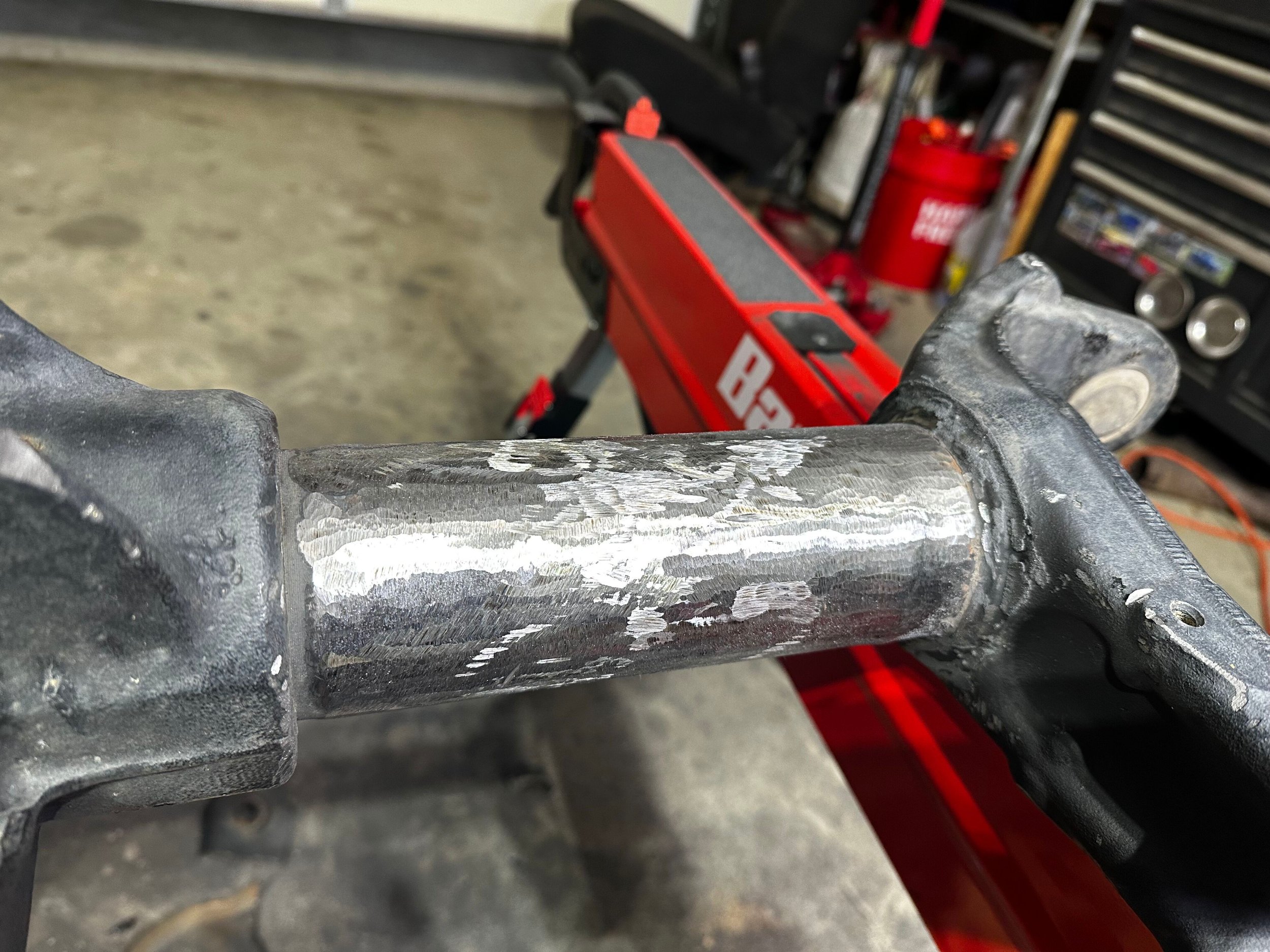

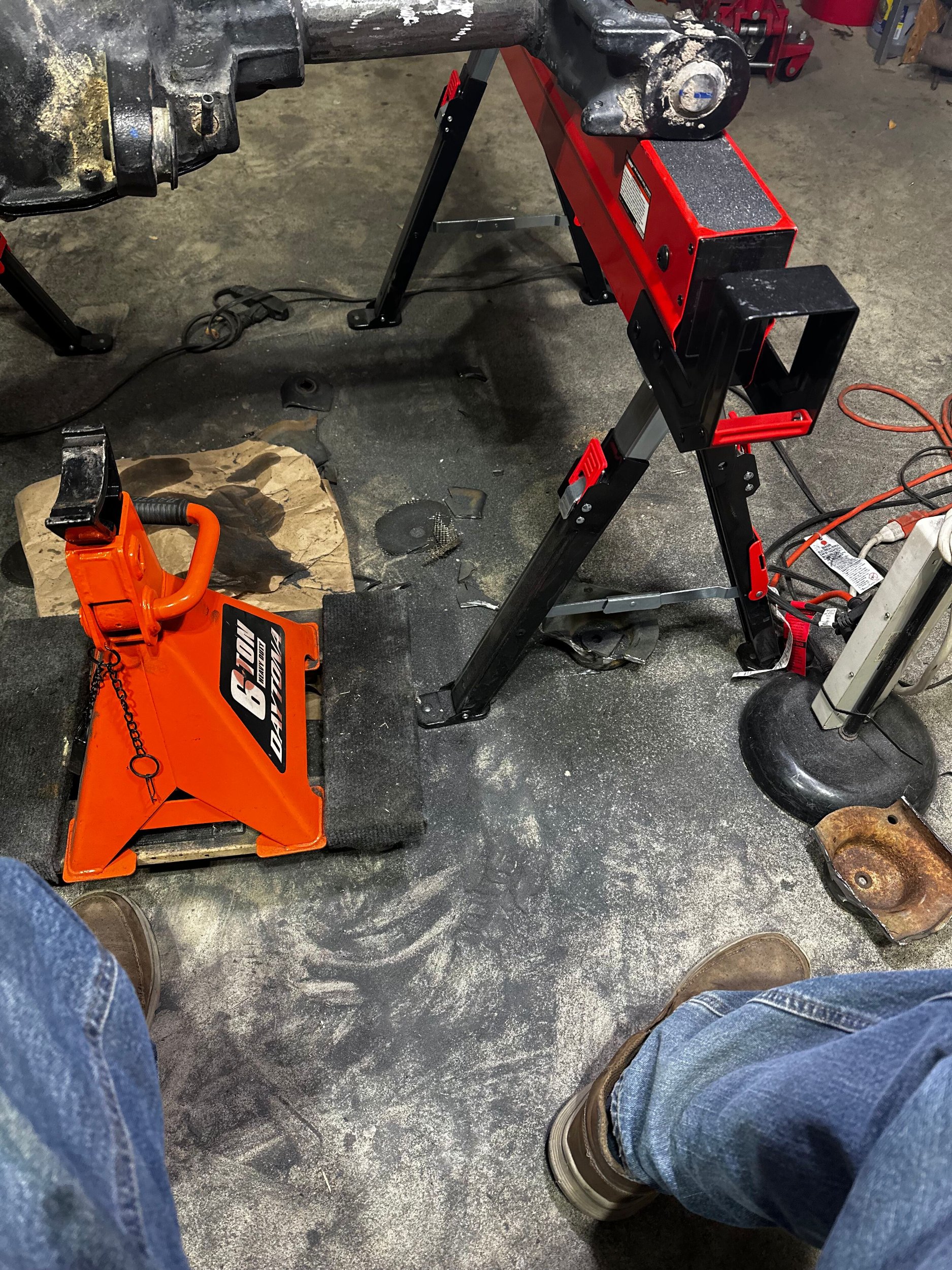

Gettin' stuff done... lots of cuttin' and a grindin' and a grindin' and cuttin'.
One thing I did learn this weekend, the Artec JL JT to TJ swap truss doesn't keep the forward 1-1/2 spring perch location that the stock JL axles have (centered on the axle). It put's it back in the stock TJ location (1-1/2" forward of the axle center) which was a huge disappointment to me. I'm going to give them a call today and see if they have a coil perch bracket that centers it.

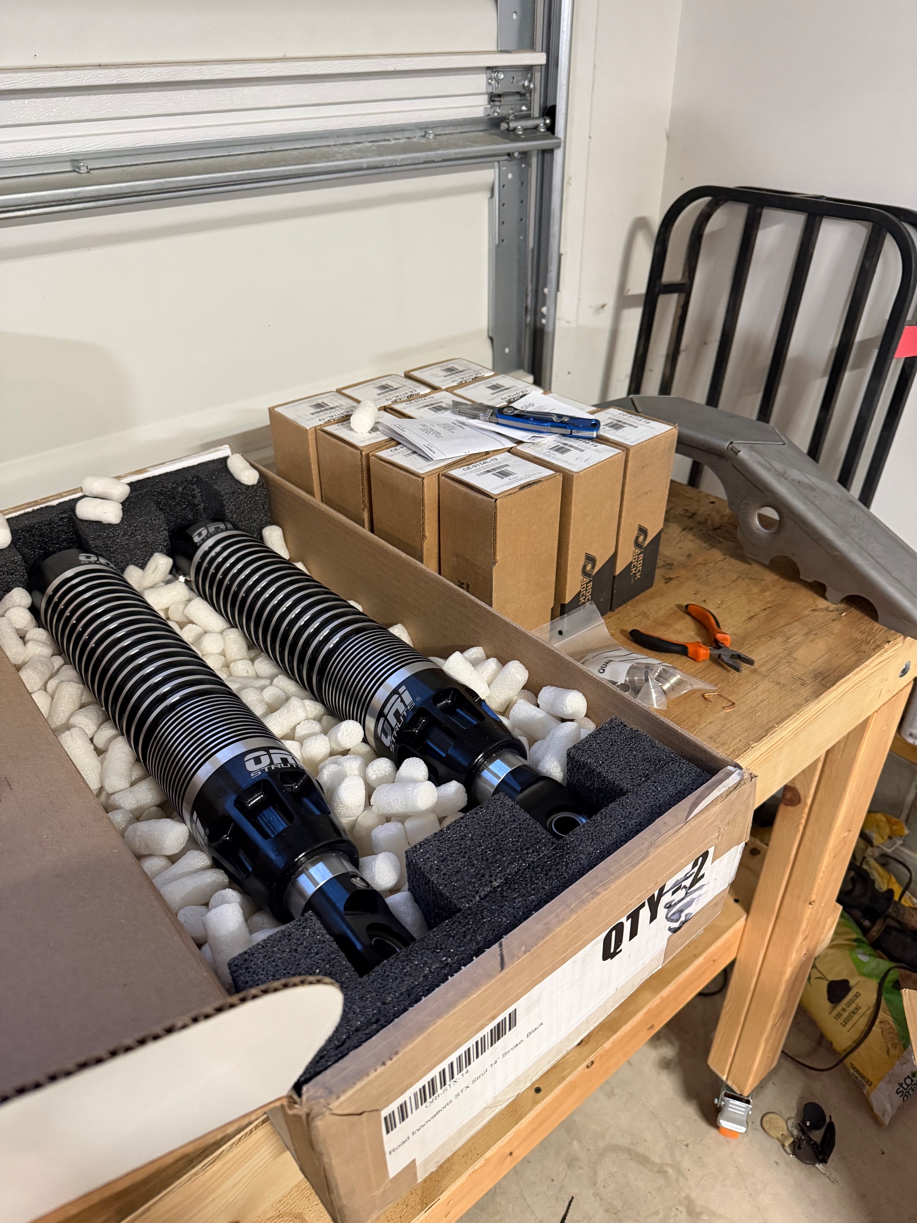

@Rickstar321, do you plan to do a 3 link front on the axle? If so, do you plan to use the upper casting on the front pumpkin? I’m kind of thinking this will be the route I’ll go. And this showed up today! Pretty excited to unbox it tomorrow.
Yup, just ordered these. I figure it will be stronger and more cost effective than buying/fabing some type of over the diff truss.
