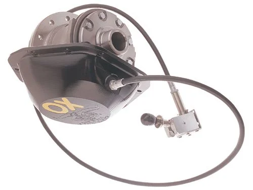

He's got OX locker, so he's stuck with the enormous cover.

And the diff covers are large, but not nearly as large on the 30s as that image above. I think that's a previous generation locker as well which were larger.

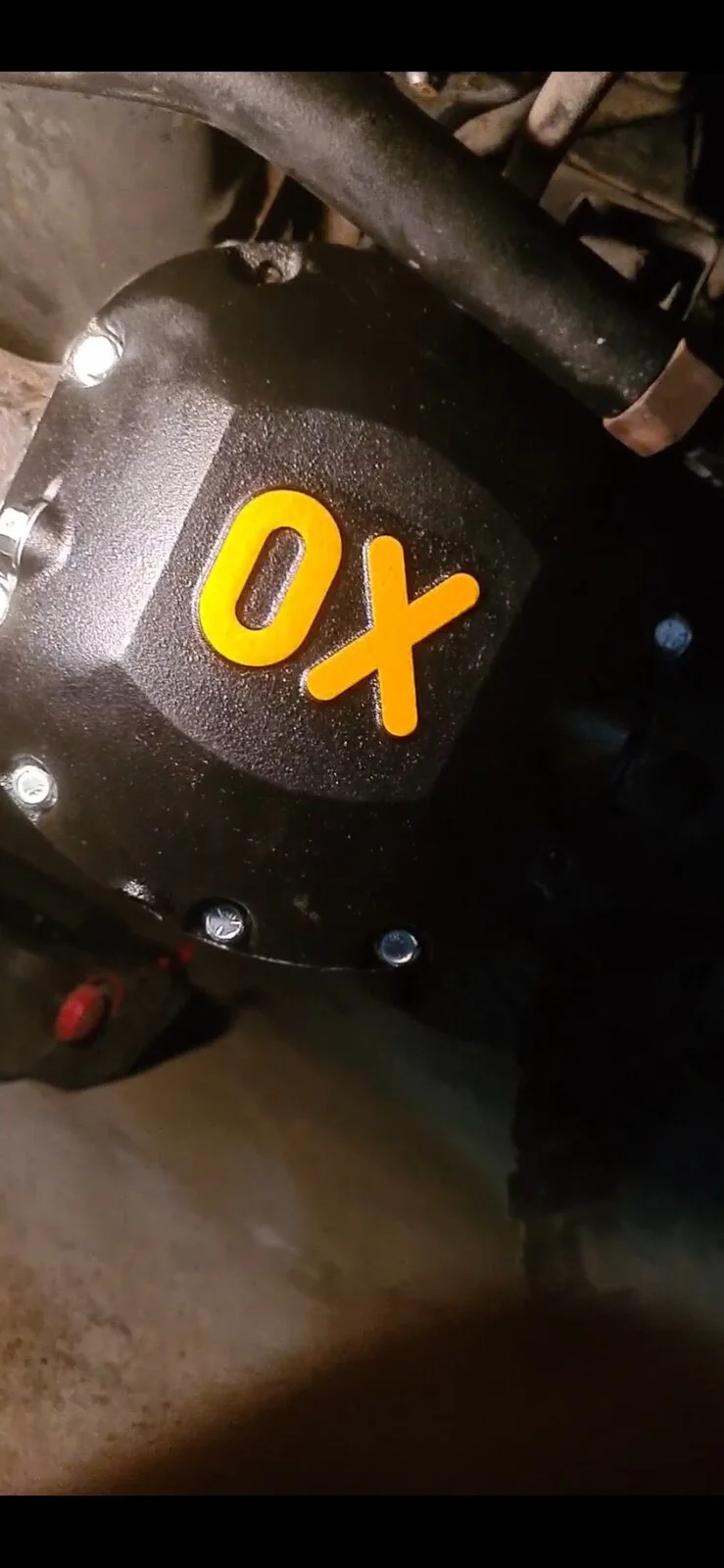

Digging back through my photos from install, here's the current gen OX on my Dana 30.
Note the really close trackbar.
Note the massive diff cover. A LCOG build is for those who aren't aware of the position they can put their jeep into. Its an ill-conceived concept.
But since you have the locker, and the cover. I'd suggest getting a decent set of quality control arms so you can position the axle where it needs to be rather than cut up the steering. You'd be doing more than modifying the track bar, you're also moving the mount. @jjvw has done this, and its no easy feat, especially if you are doing it only to clear a massive cover.
You definitely must lift it asap, get adjustable front control arms and move the axle where it needs to be. 33’s on no lift is a no go. Your CoG will be fine. Any other route is a sequence of compromises and bad choices.
You missing a bolt at the top of the diff cover? Which track bar do you have?
Picture was from install about a year ago. It's not missing any bolts. I just don't have any recent pictures.

Good question. Could the whole issue be fixed more easily with a better track bar shape? (maybe the currie/rock jock bar?)
Just the stock track bar. Could just heat it with a torch and bend it out of the way.
Problem solved.
