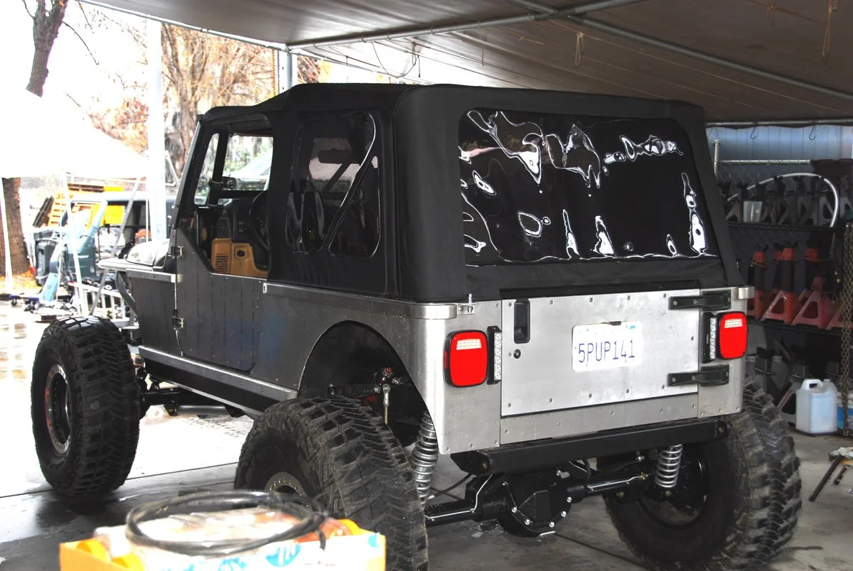

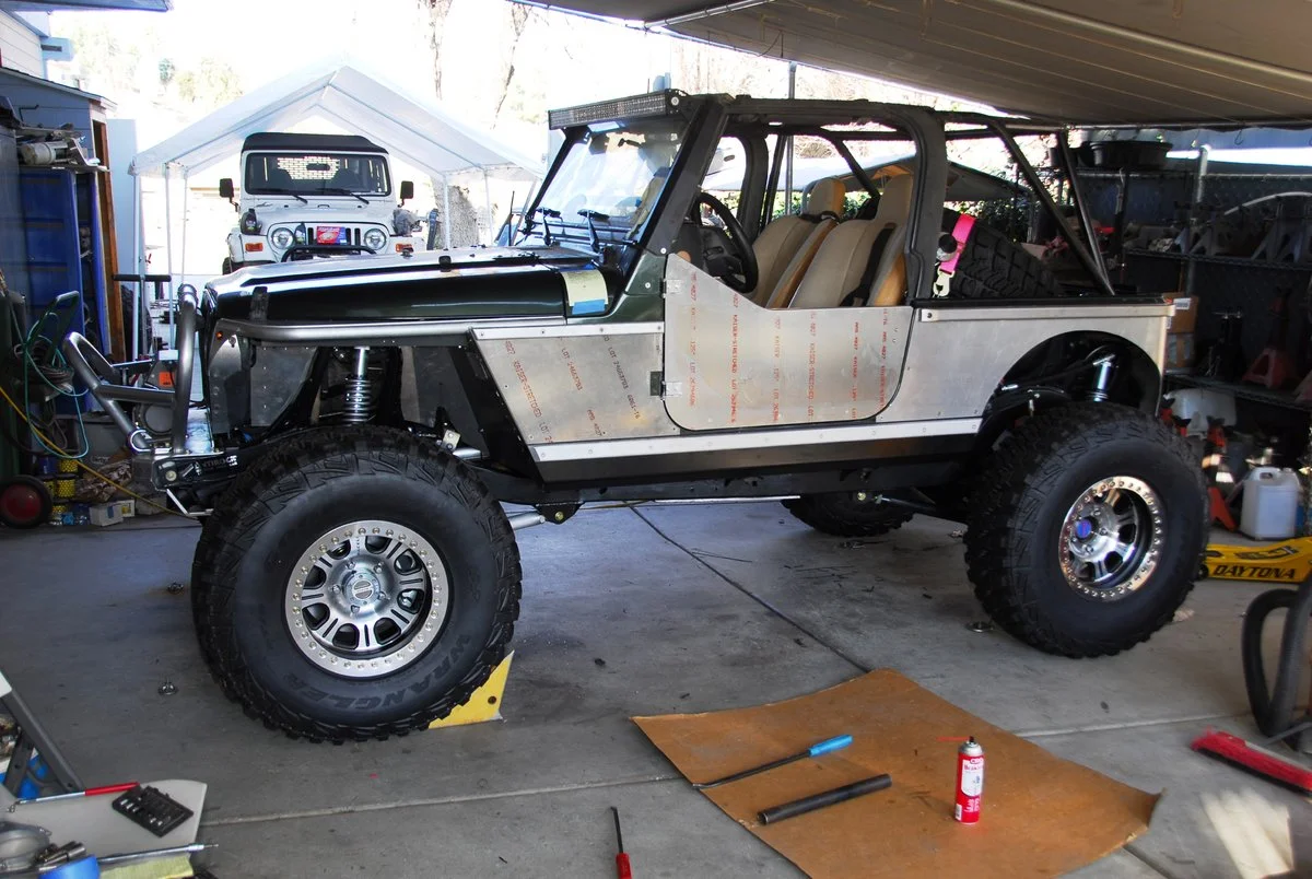

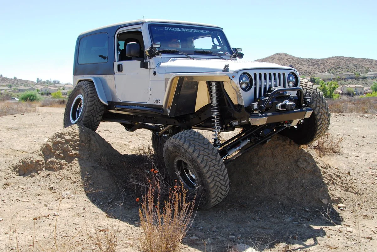

Depends on the build, what you are after. I can get 104" in the TJ tub and chassis without butchering the rear corner panel so it still looks like a TJ from the back. That also eliminates the TJU overhang that you would have with the same wheelbase on that platform. I can do 114" in the TJU with a gas tank under the rig with a RJ 60 and 40" tires.
TJ at 104 on 37's.
TJ at 104 on 37's.
View attachment 120859View attachment 120860
Are those the rock jock 44s?
