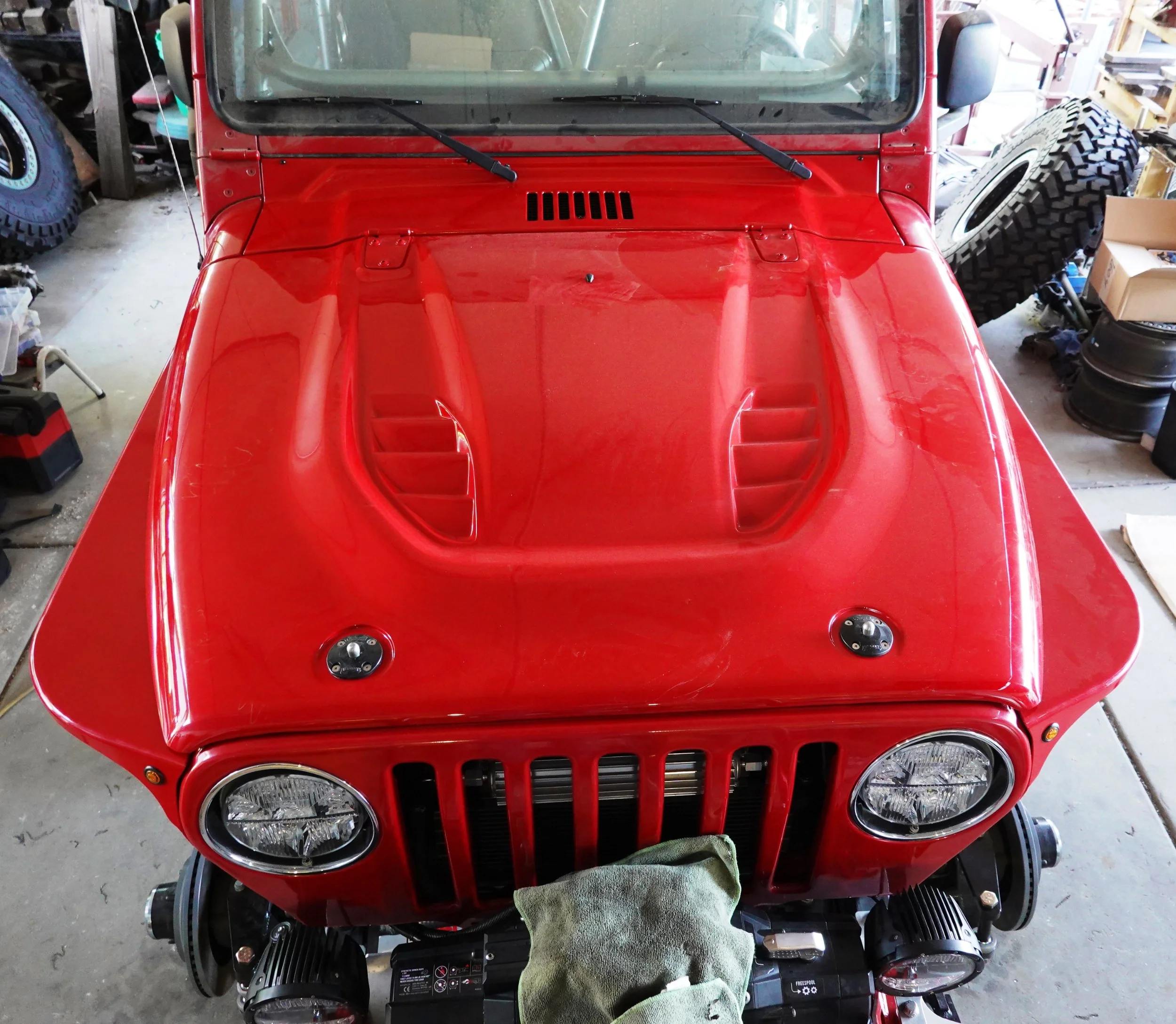

IIRC, you used Rustoleum Sunrise Red?
That was a couple years before. It was ok, but what you see in the pic is after I got a bit more serious and got a color match by a local auto paint supply shop. It’s GM 74U Victory Red. Likely something extremely close to the Flag Red Blaine posted.

Cowl is PC Flag Red
Grill shell is PC Flag Red
Fenders are the same.
Tub is OEM original paint.
Hood is color matched to the cowl. Okay, not great.
Inner fenders are Hydro Red textured.
If you like that red and I do, then the overall effect is fairly stunning.
