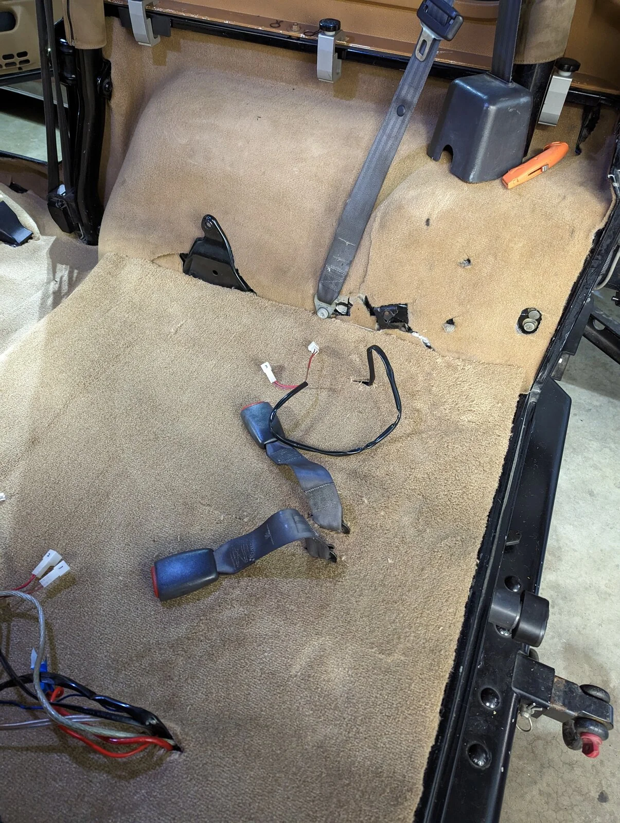

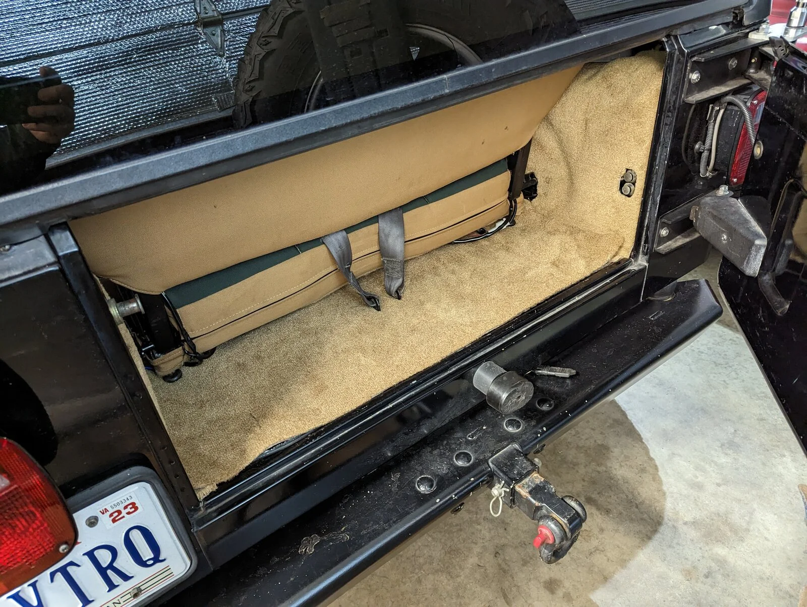

Pics 4&5 have the new cargo floor carpet installed. #4 has new carpet over the wheel well as well. #5 still had the OEM carpet over the wheel well.

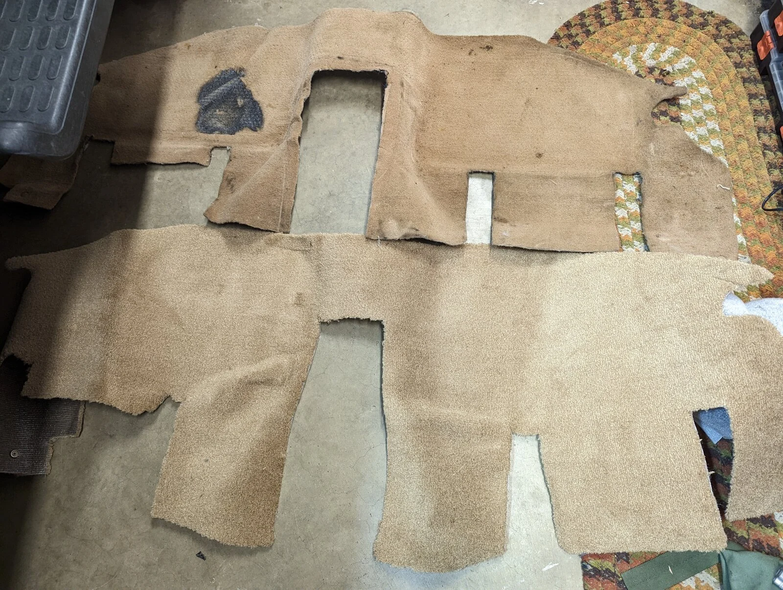

I finally got my medium doeskin carpet in. I think it's about at close as you can get for 97-98 tan carpet. I wish I would have gotten mass backed now. This stuff is lighter (not thinner) than factory carpet.

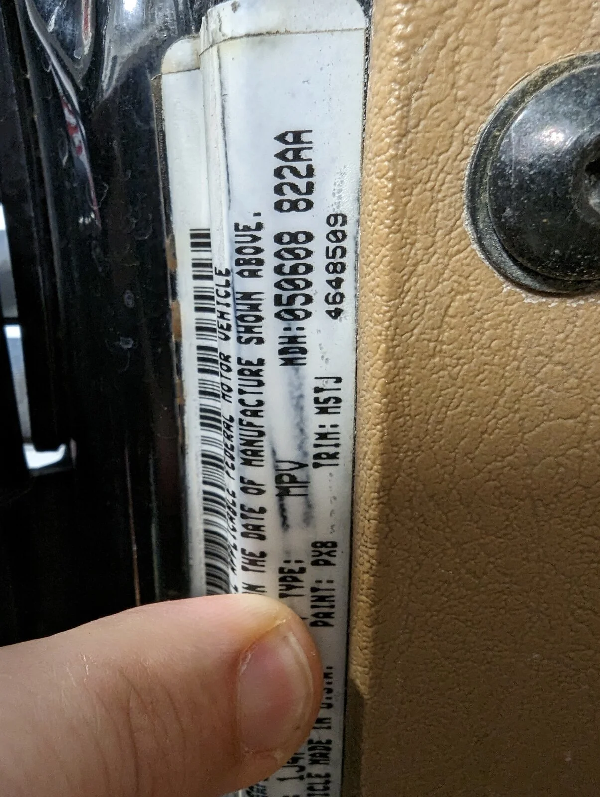

I think we discussed this on another thread about paint-matching, but remind me what your interior code is?
