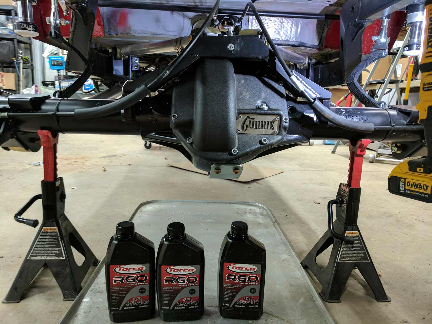

The tag that came with the axle lists that it takes either 2.5qts or 3qts of diff fluid depending on if it has inner-seals. I tried 3qts which brought the level right up to the top of the filler, so I sucked out half a quart and figure the rear diff takes 2.5qts of non-synthetic conventional oil.
A while back Currie did tests and found conventional oil cools the gears much better than synthetic. Ever since then they require it in their housings.
