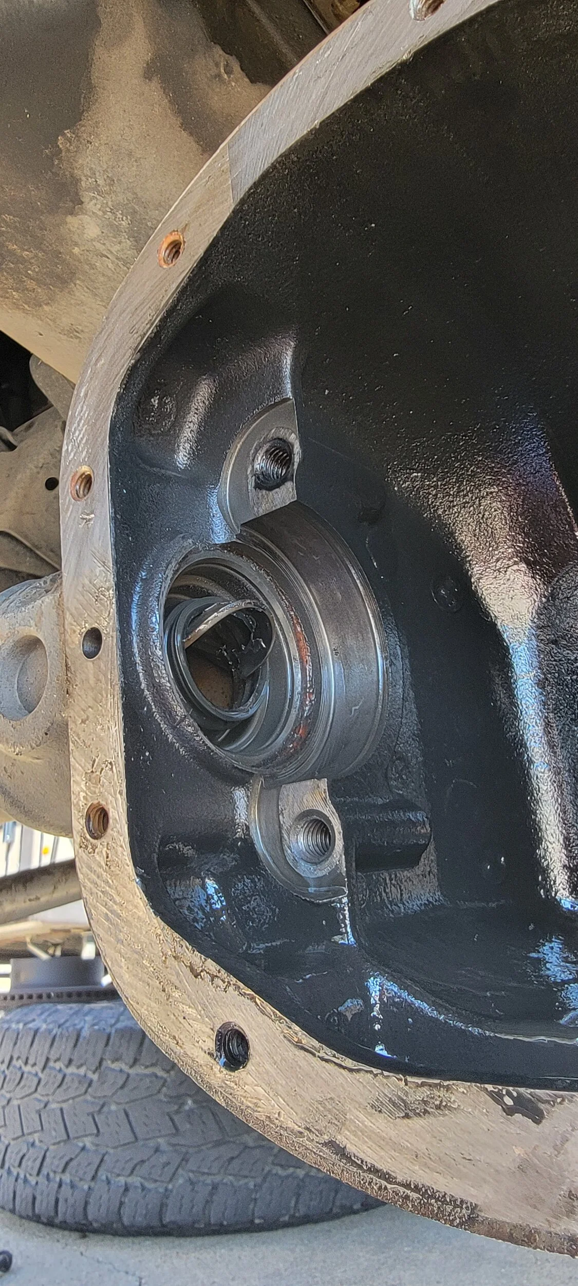

In a couple of posts people were asking about the plastic alignment rings on the axle. I would recommend removing them. I did ball joint a few months ago and left them on. We'll this weekend I noticed a large puddle of gear oil under passenger tire. When I pulled the carrier out the ring was stuck in the seal.
