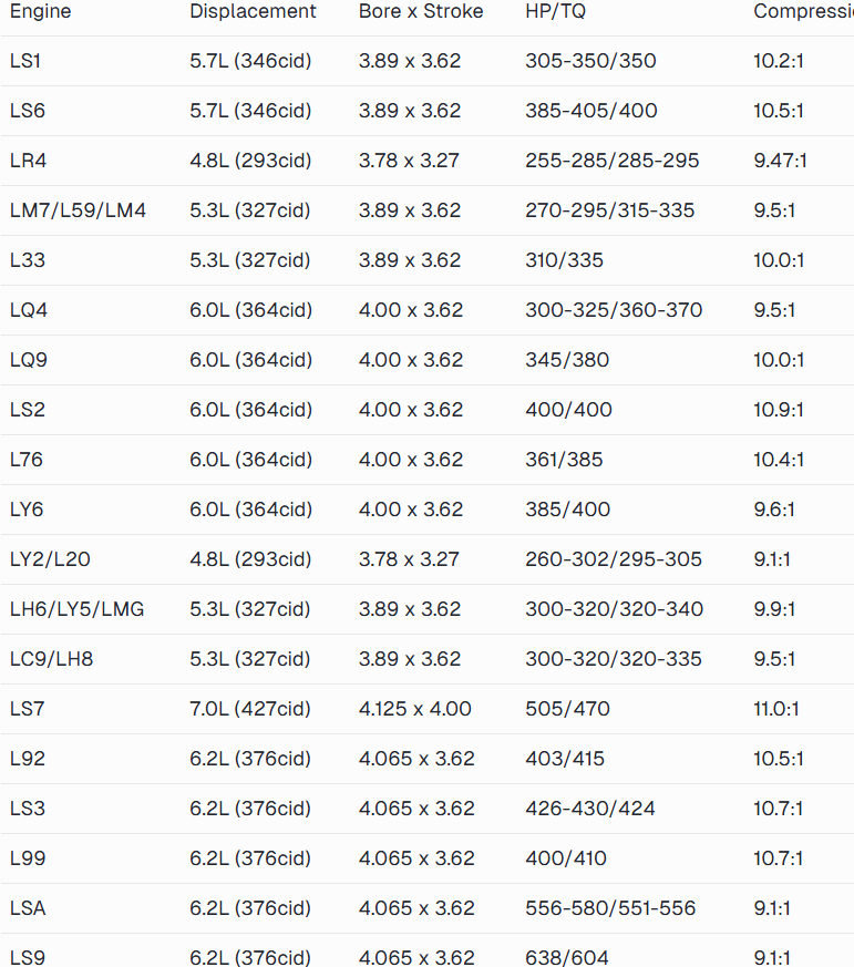

The Ultimate Pickers’ Guide to LS Engines

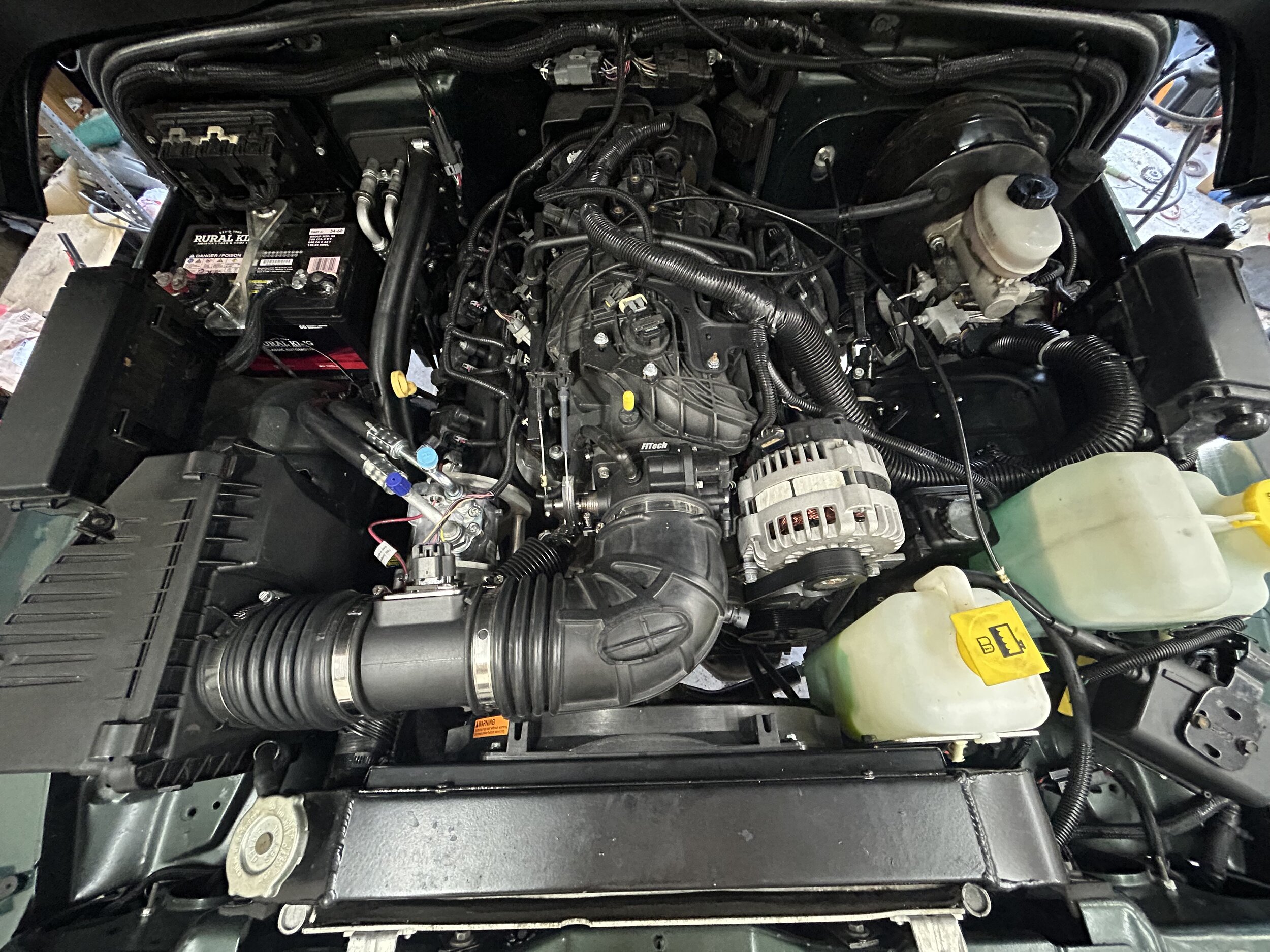

Will add pictures, typed this on my computer and all my photos are on my phone so ill go back and edit them in. I will also be adding info as subjects come up and I do more of these.
So you want to go to the dark side discombobulate your TJ and throw a LS motor in your rig? Well its not that difficult and I am going to try and best explain how to do it. Most of my knowledge comes from my personal daily driver 2000 Jeep Wrangler that I have put on roughly 30k miles in the almost 3 years I have had this finished this swap. On this TJ, it has a 5.3 LM7 from a 01 Silverado but I had backed it both with the original NV3550 that I probably broke at 175k miles and now currently one of the brand new AX15 transmissions with 2 different adapter. I also had 2 different EFI systems, Terminator X Max and stock DIY standalone. This could be almost entirely a bolt on swap with little cutting and fabrication needed if you buy the right parts.

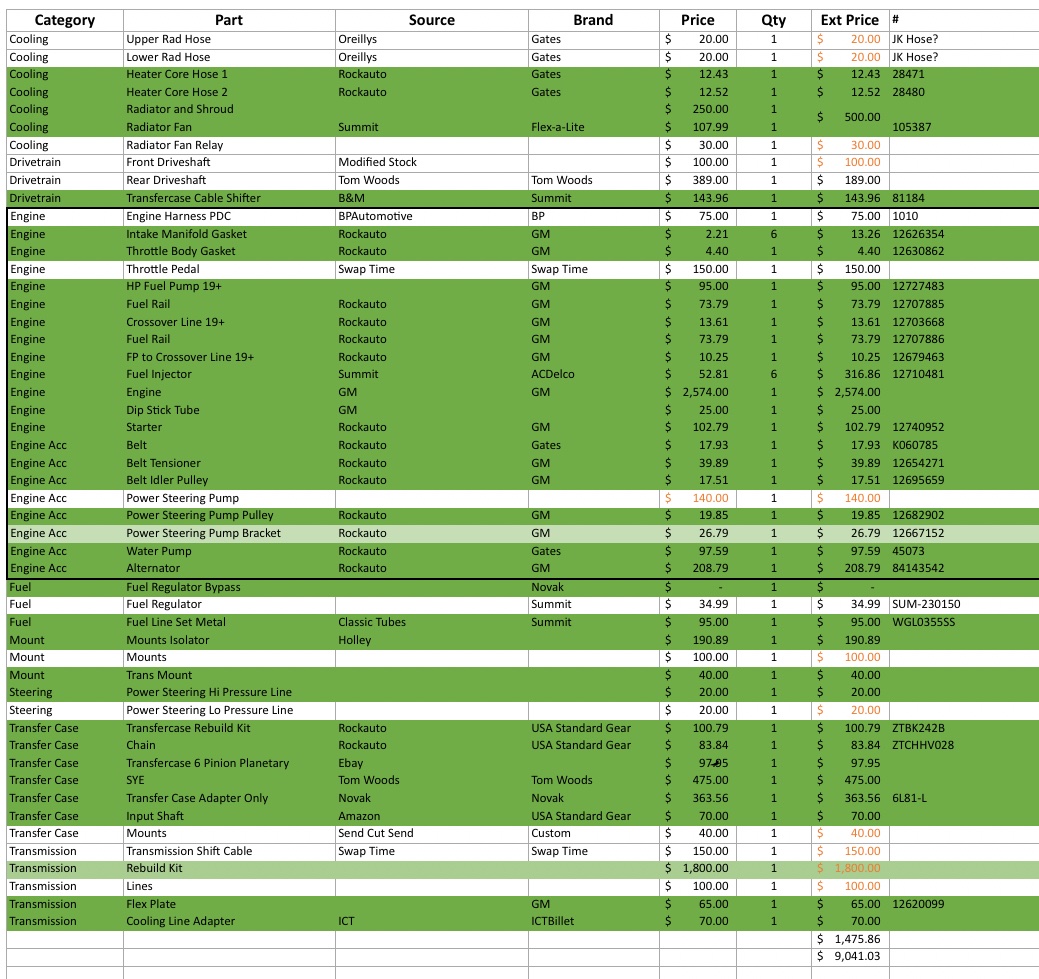

Thats a tough question, but for me, the biggest regret would be sticking with the Jeep manual or the axle gearing I picked. And it only comes down to to go anywhere cool is a good chunk of highway driving, and 5th gear with 3.73 and 32s revs way higher than needed. I used to have 3.08 before the axle swap with the LS and when swapping in a Dana 44 with 3.73, I did not feel like I gained any power and only lost fuel mileage and made more noise.
As far as money invested, I think I was closer to $5-6k with a rebuilt engine but not including the suspension and axles. But this was mostly all purchased in 2020-21 and I doubt any of what I bought got cheaper.
On my current project doing a LV1 4.3, 6L80, NP242J swap I think I will be closer to $10-11k. But I bought a brand new engine from GM, the 6L80 core was free from partouts, all new GM parts for the trans including a new case and a free transfercase. But I also need to make my own accessory brackets and engine mounts as nothing really exists on the market for what I need. There is quite a bit more I probably do not have on the list and I have quite a bit in tools I need to source for rebuilding the 6L80. The attached spreadsheet are parts I have been buying over the last year so its a little more current pricing.
