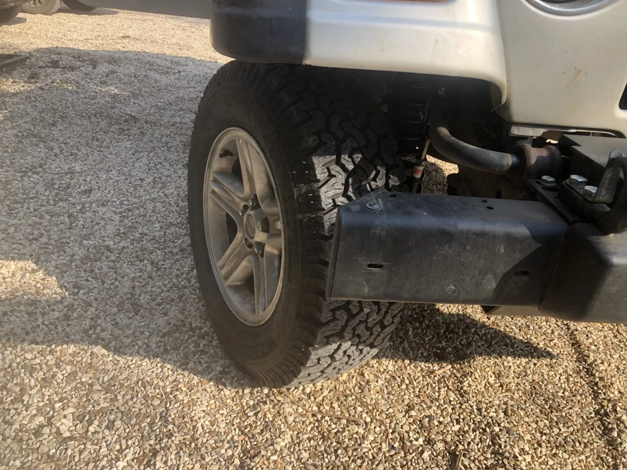

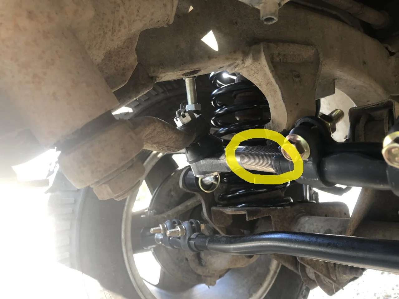

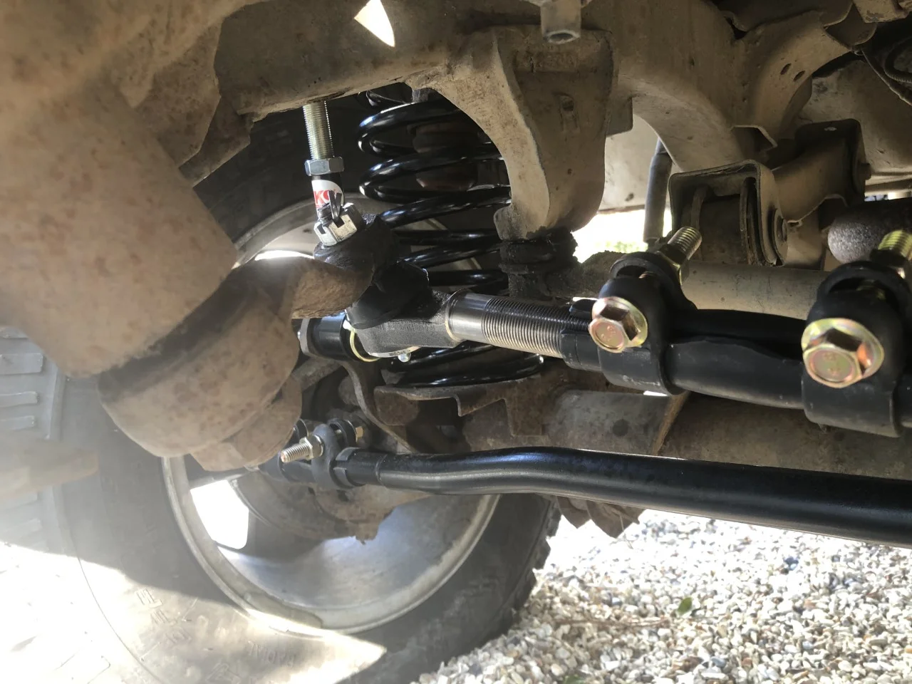

Thanks, forget the second comment about the wheel being upside down at straight, got that wrong. Pictures as requested...
Thanks in advance for any input.
The TRE on the pitman arm is way to far out. You must have not had the steering wheel straight. That pitman arm should be straighter when the wheels are straight.

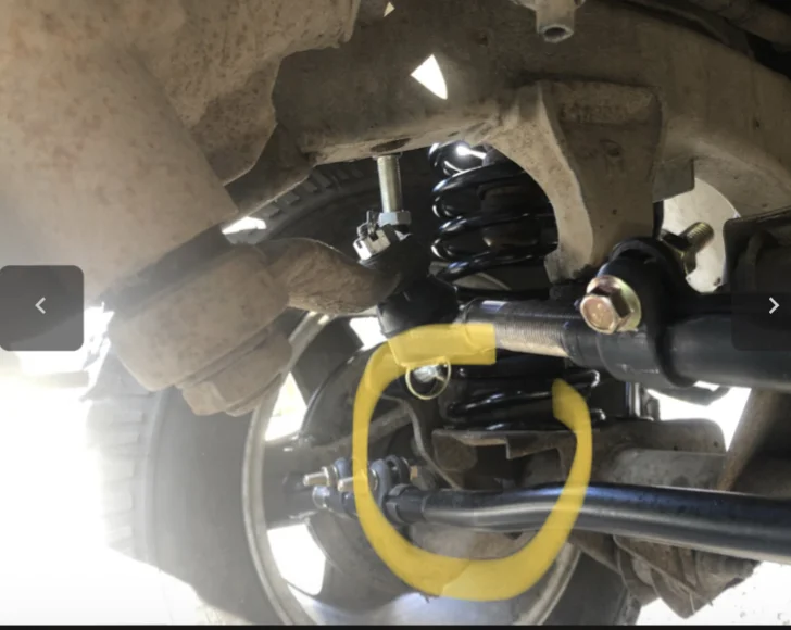

Also the tie rod is contacting the bottom of the coil bucket at the sway bar link in this picture. The curve should be the other direction.
