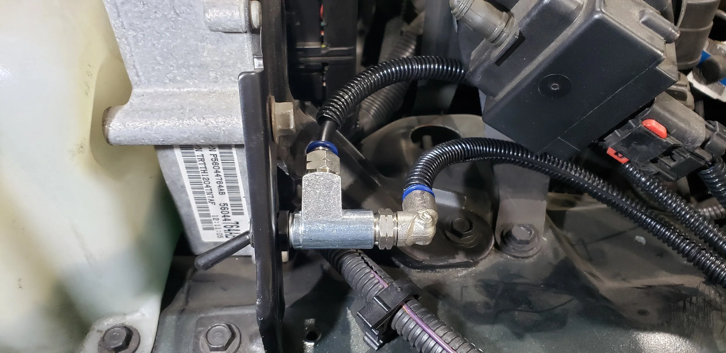

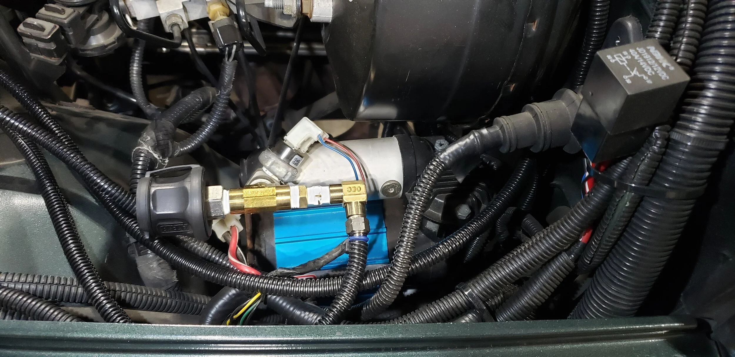

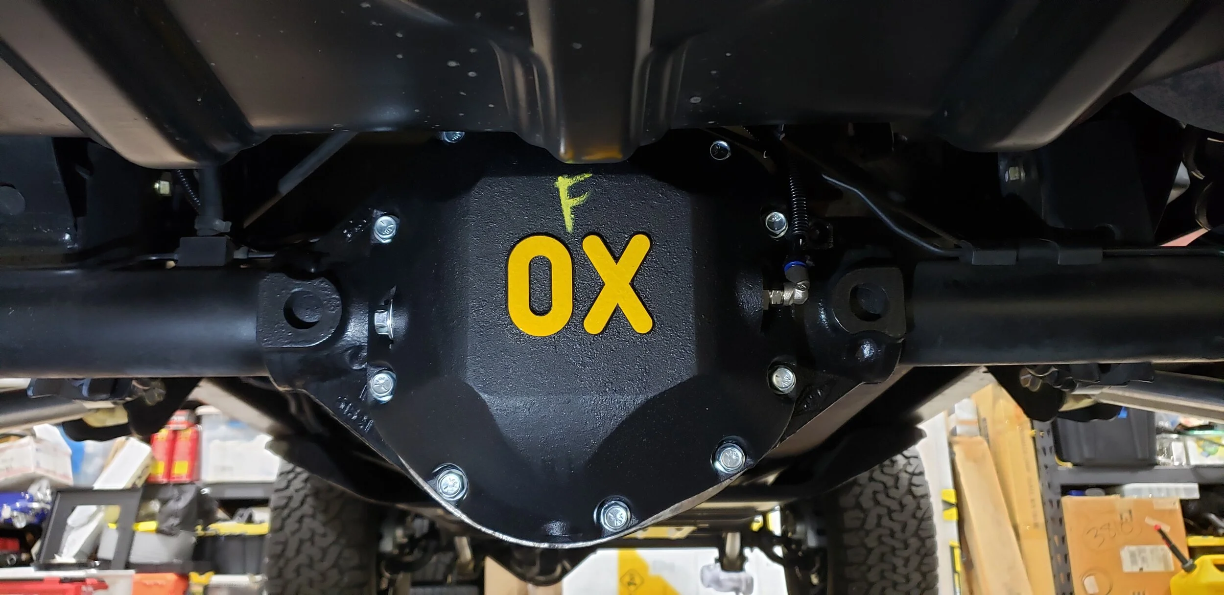

Rear OX locker is plumbed in. I split the compressor, so the locker can be switched out when I need the compressor for airing tires.

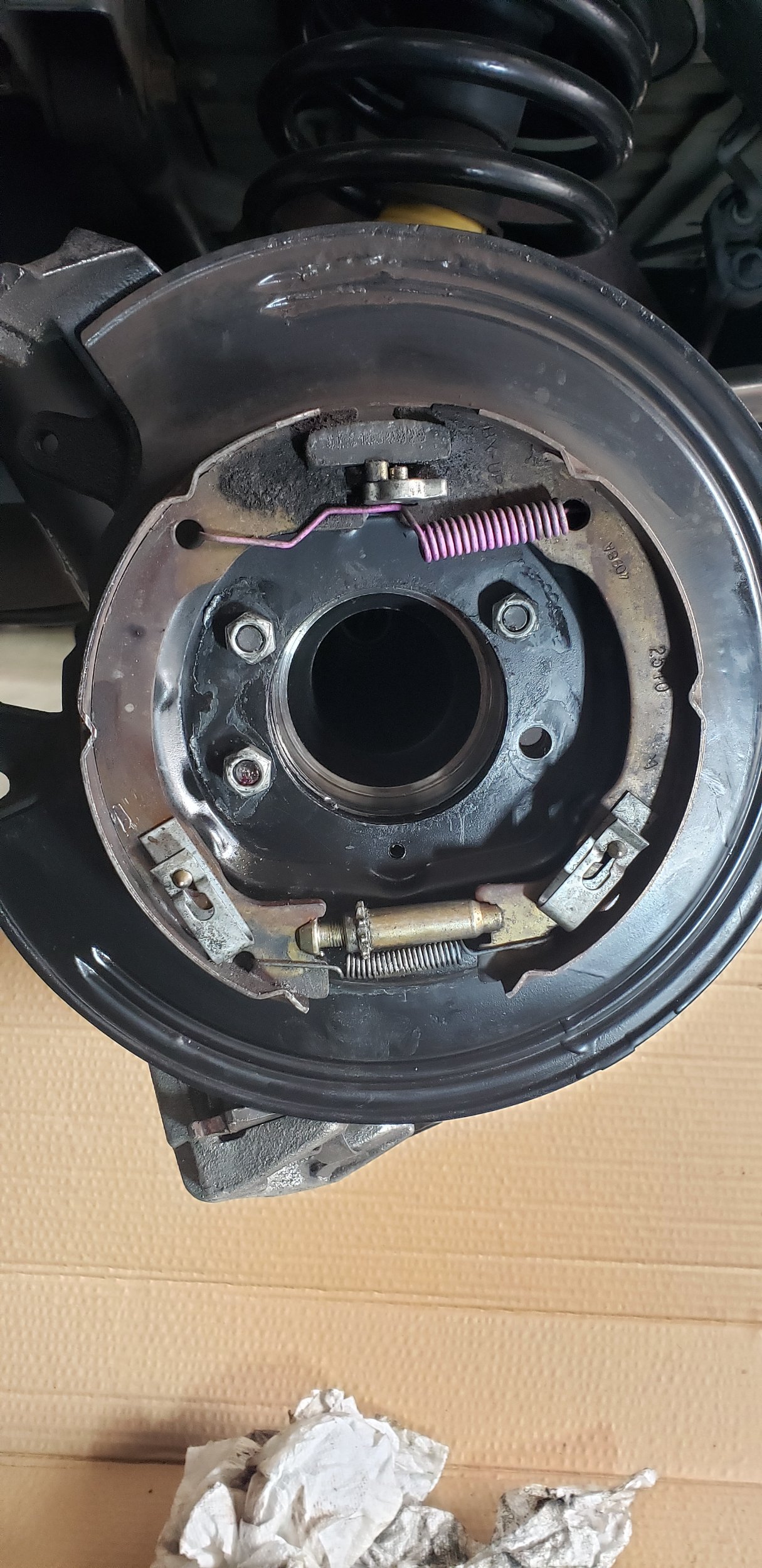

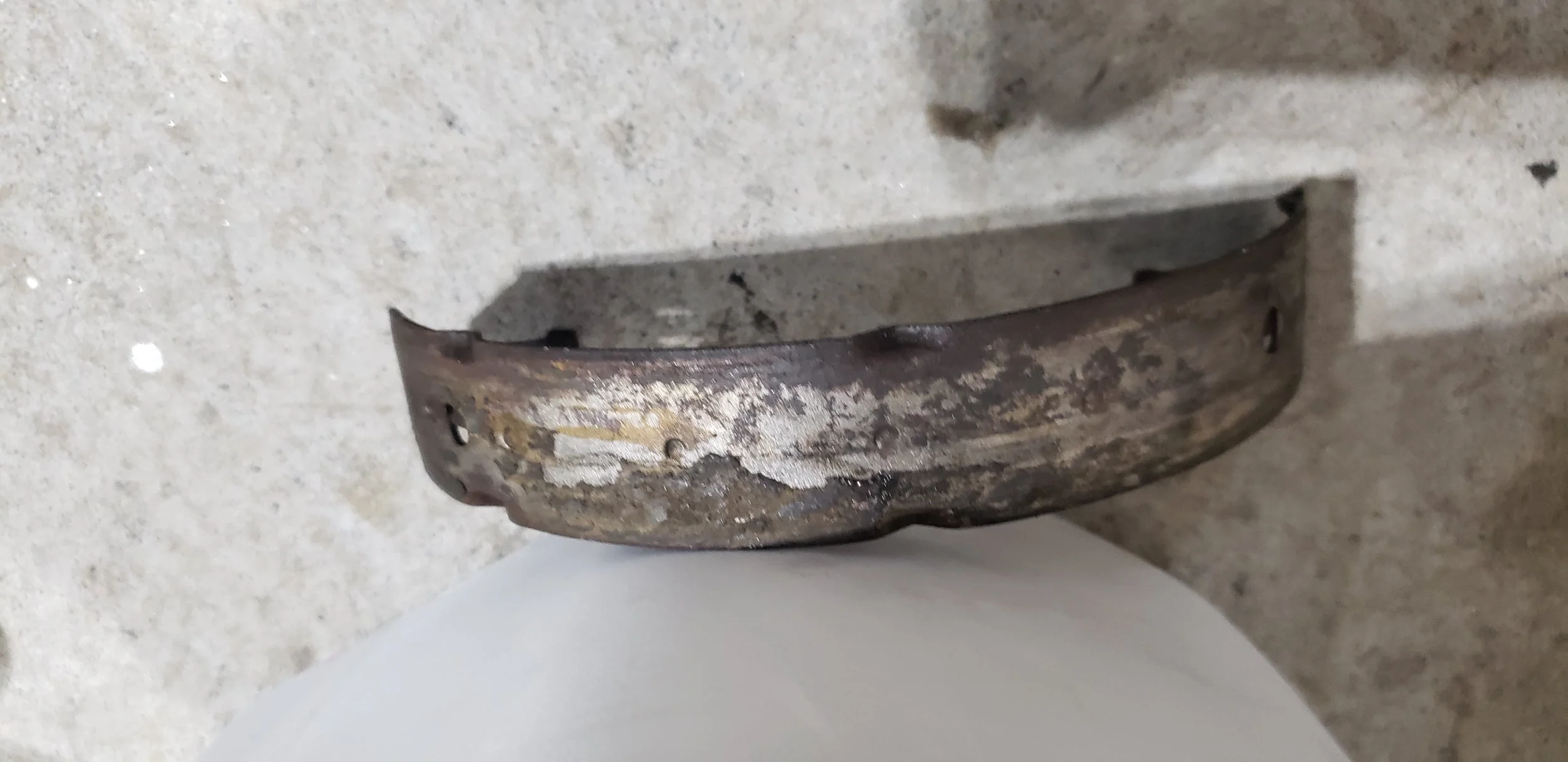

For the RR side, if the parking brake pads were dragging and creating heat, I wouldn't be surprise if that led to the seal deforming and failing. Not saying it was dragging, but that seems like a potential cause.
What came out of the inside of the rotor when you removed them? Dust, pad fragments? Were they new with the regear and/or did they have good pad material left at that time?
Can't say why the LR then failed so could be a bad batch of seals and the parking brake pads aren't related.
Both parking brake shoe sets were replaced just before the re-gear. The LR was like new, but the RR was completely gone. The strange thing was there were no fragments whatsoever left.
