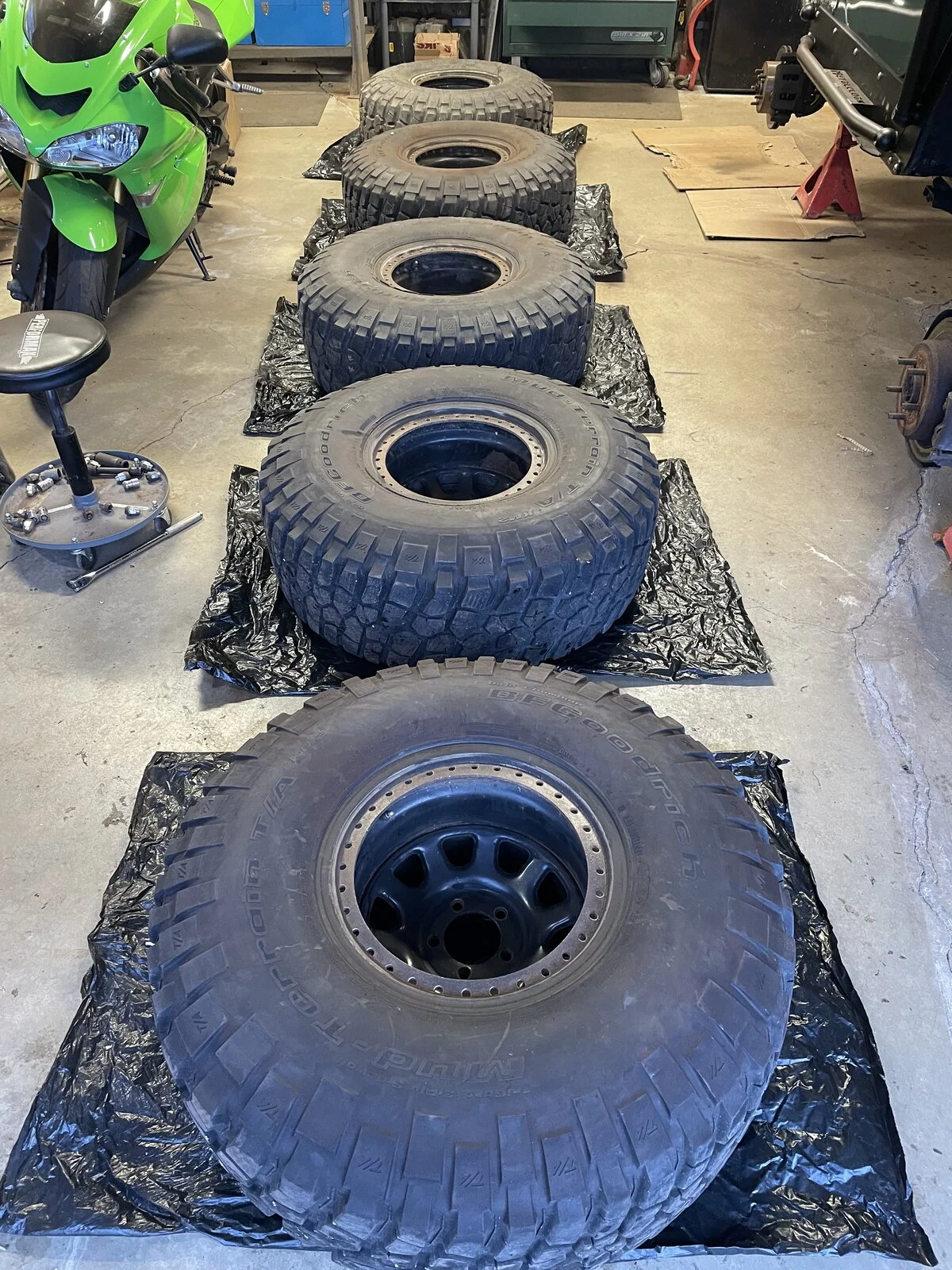

When I rolled them back in, I put each wheel on a black plastic bag where they will remain until I finish reassembly.

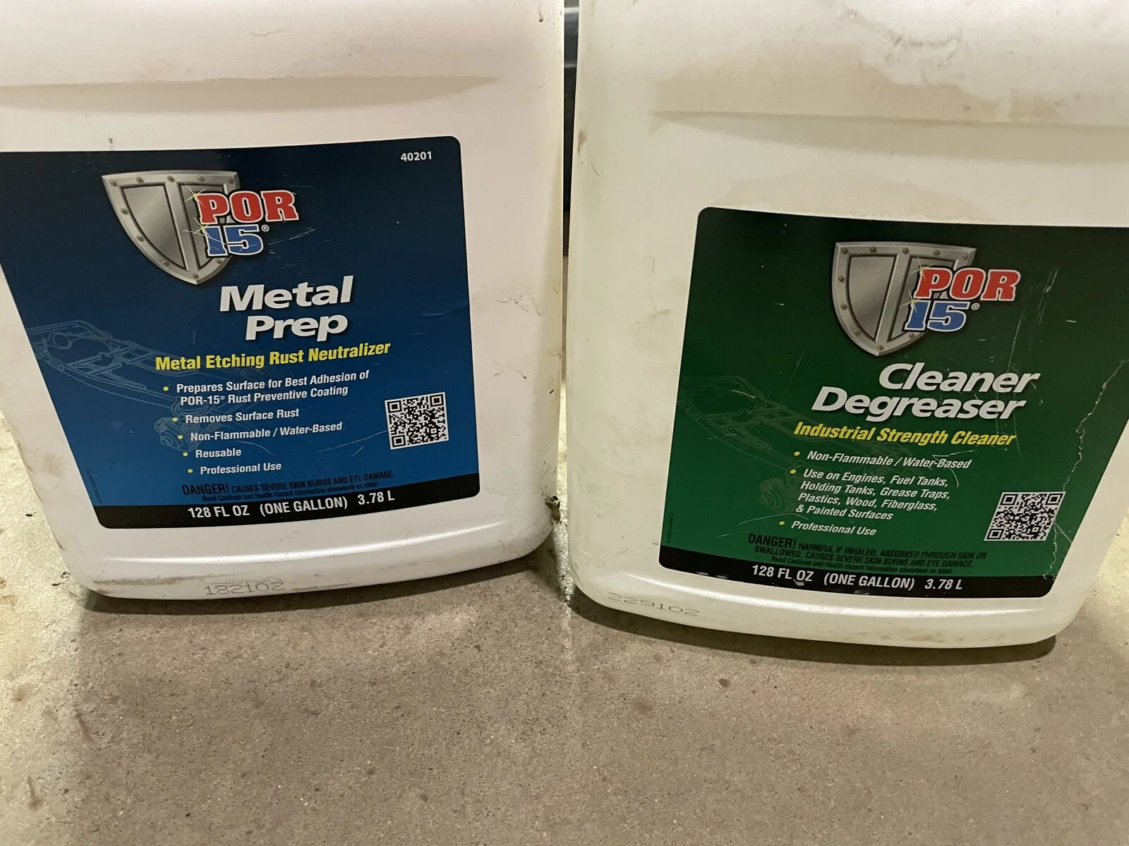

I followed the two step cleaning and prep process that is recommended by POR15. First was a spray down and sponge bath with POR15 cleaner/degreaser, and that was follow up with the POR15 metal prep product. This is suppose to neutralize the rust and etch any bare metal in preparation for paint. (or in this case, the actual POR15 rust coating) Each of these processes were followed up with a thorough rinsing with clean water, and they were allowed to dry overnight after the metal prep.

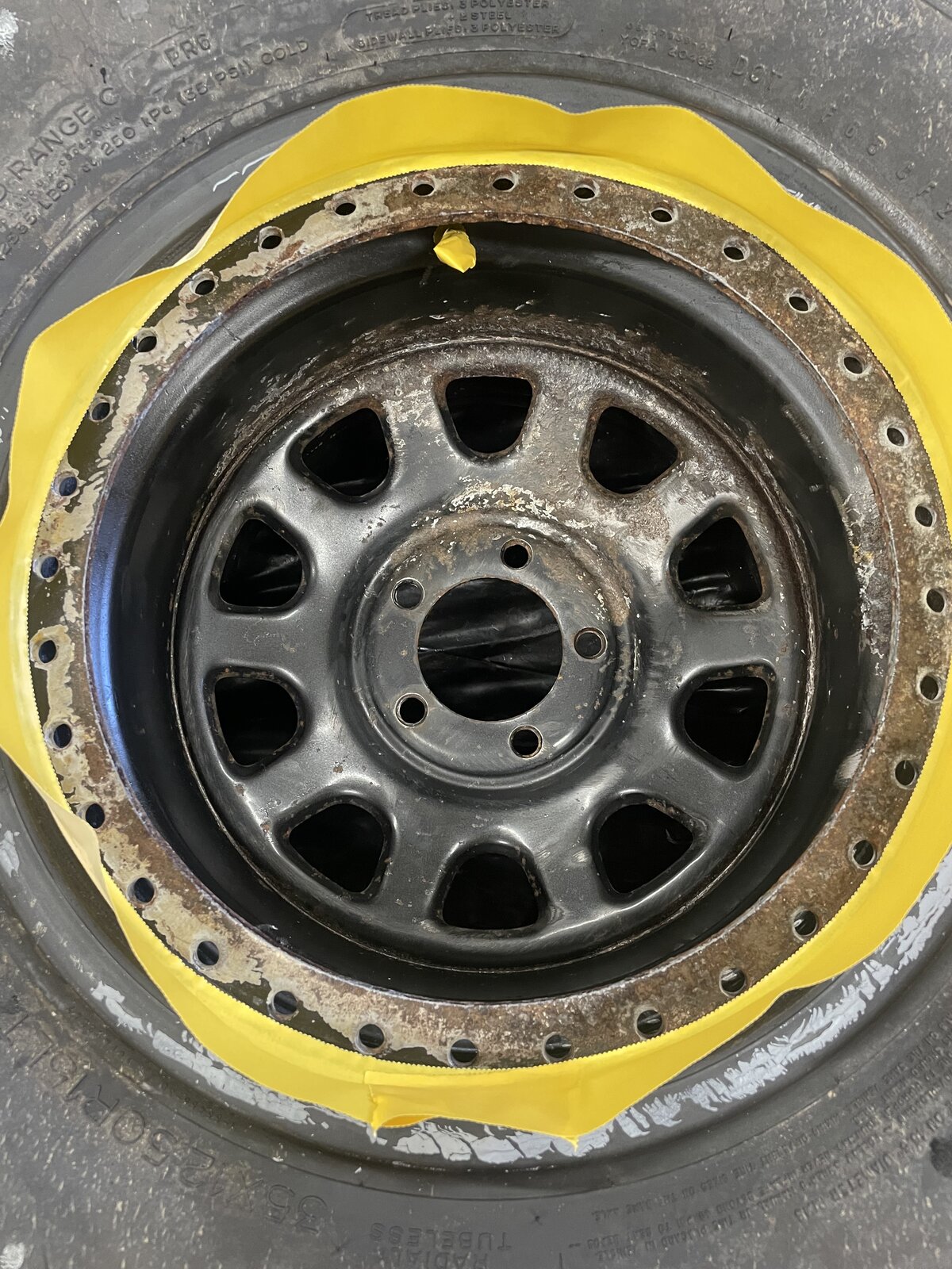

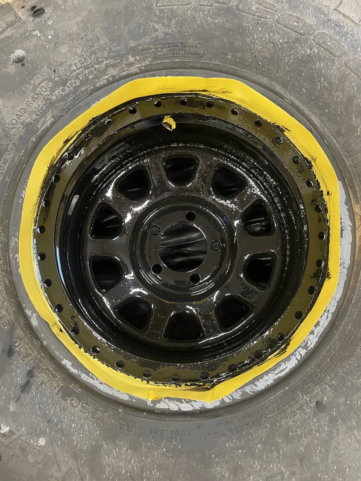

The next morning, I started kind of early because I wanted to get four coats on before I went to bed that night. I started with taping off the tires and valve stems.

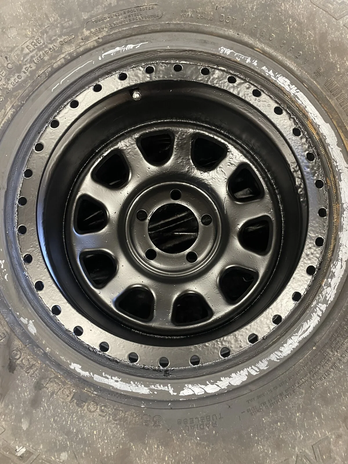

In the end, I did two coats of POR15 and two coats of the POR15 top coat in Chassis Black color. I waiting four hours between applications, and probably could have gone a touch shorter between the top coat applications. You will see in the after photo, that this process did not produce back to original smoothness, but that is purely because I didn't want to sand the metal smooth.
These next three photos show my wheel that was in the worst condition in the following three stages:
1) After clean-up and paint prep. Ready for first coat
2) After first application of POR15. That stuff is super shiny, and it stay shiny if you don't top coat it. ***It also has to be top coated if it will be in direct sunlight***
3) After the topcoat has dried.

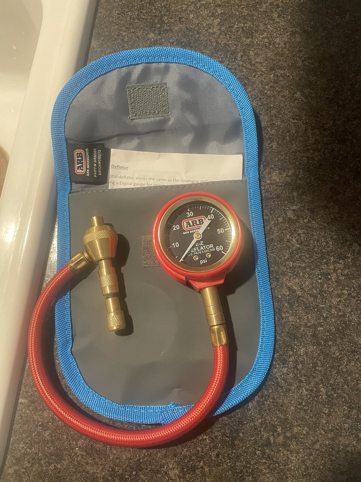

ARB ARB505 Deflator Kit:
https://www.amazon.com/gp/product/B004LQCDOA/?tag=wranglerorg-20

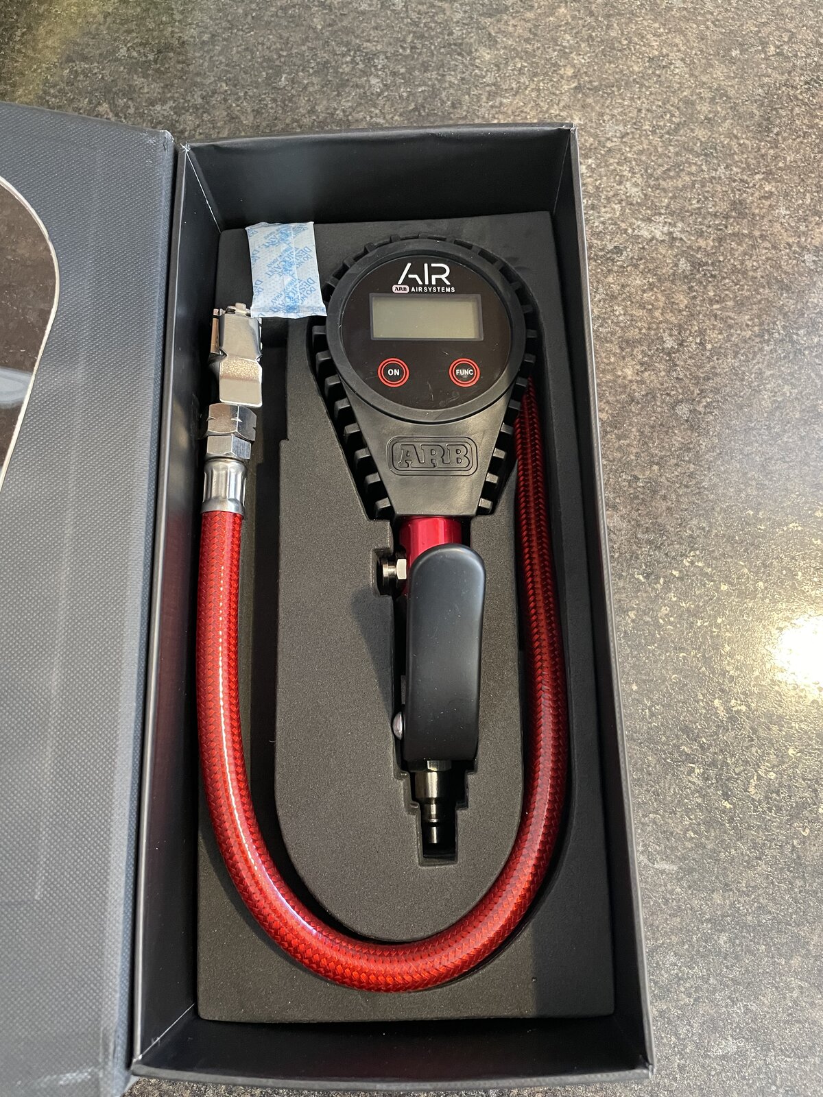

ARB ARB601 Digital Tire Pressure Gauge Inflator/Deflator:
https://www.amazon.com/gp/product/B073RS57L5/?tag=wranglerorg-20
