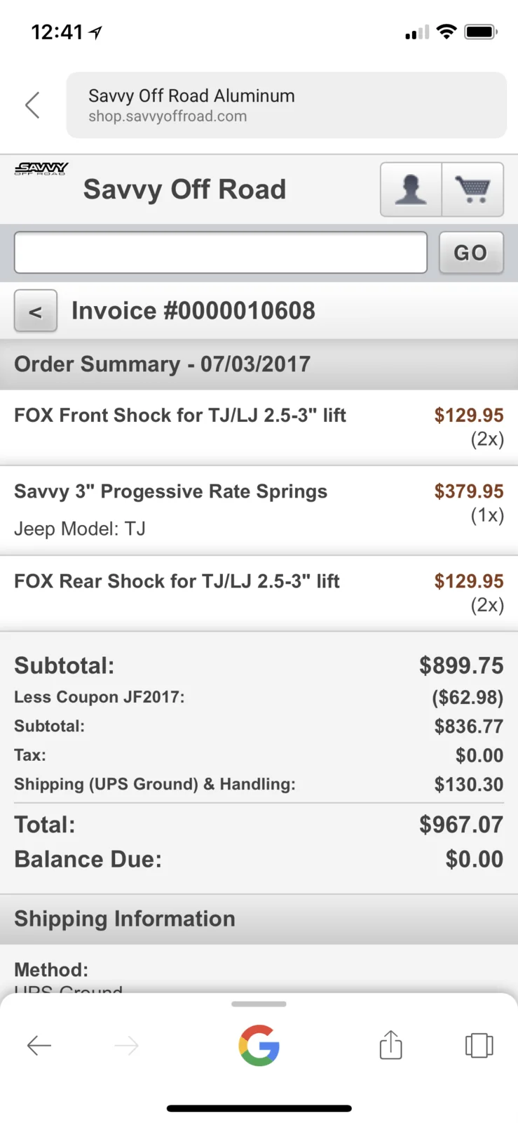

Thank you! I have emailed Gerald, just pulled up my original invoice to ensure I purchased the right shocks:
Quite a bit more dough spent than I thought I did. Hopefully Gerald will be able to help out via email. Playing the waiting game now.

Your invoice doesn't list the part #'s of the shocks, so not even sure how you'd know if you have the correct shocks or not. Hopefully Gerald will shed some light.

I called Katie at savvy offroad and she said I need to get the part numbers off the shock body that are located “somewhere”. A quick once over while it being on my vehicle led to no identifying numbers. She said if no part number is present on the shock then i will need to pull the shocks and take measurements. God dangit wish I did this while it was in the bay. Guess tomorrow morning I’m gonna pull a front shock in the parking lot and call back with the measurements. She seemed to reassure me that if it is the wrong part number swapping them out wouldn’t be an issue. If this is the case, really not looking forward to pulling the springs again for bumpstops though.. ugh. Gonna setup my CB today so it will be ready for the trail ride saturday. More to come.
