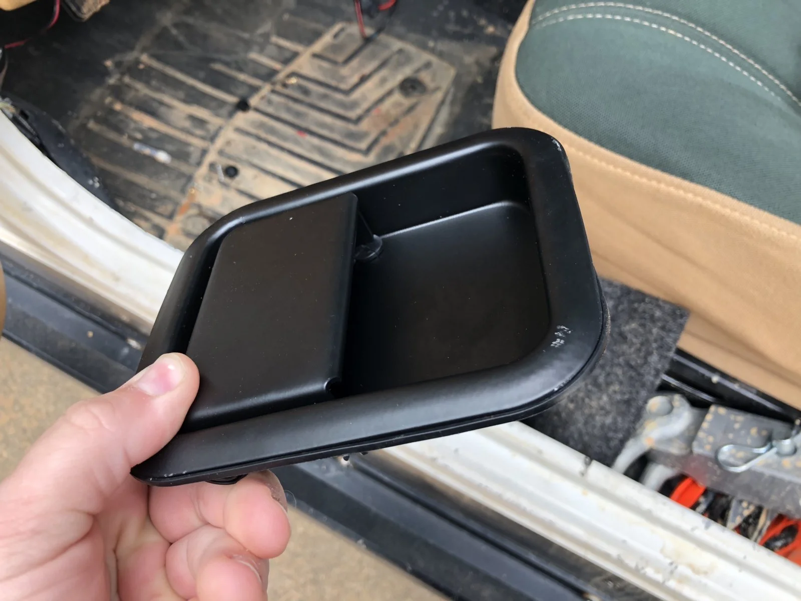

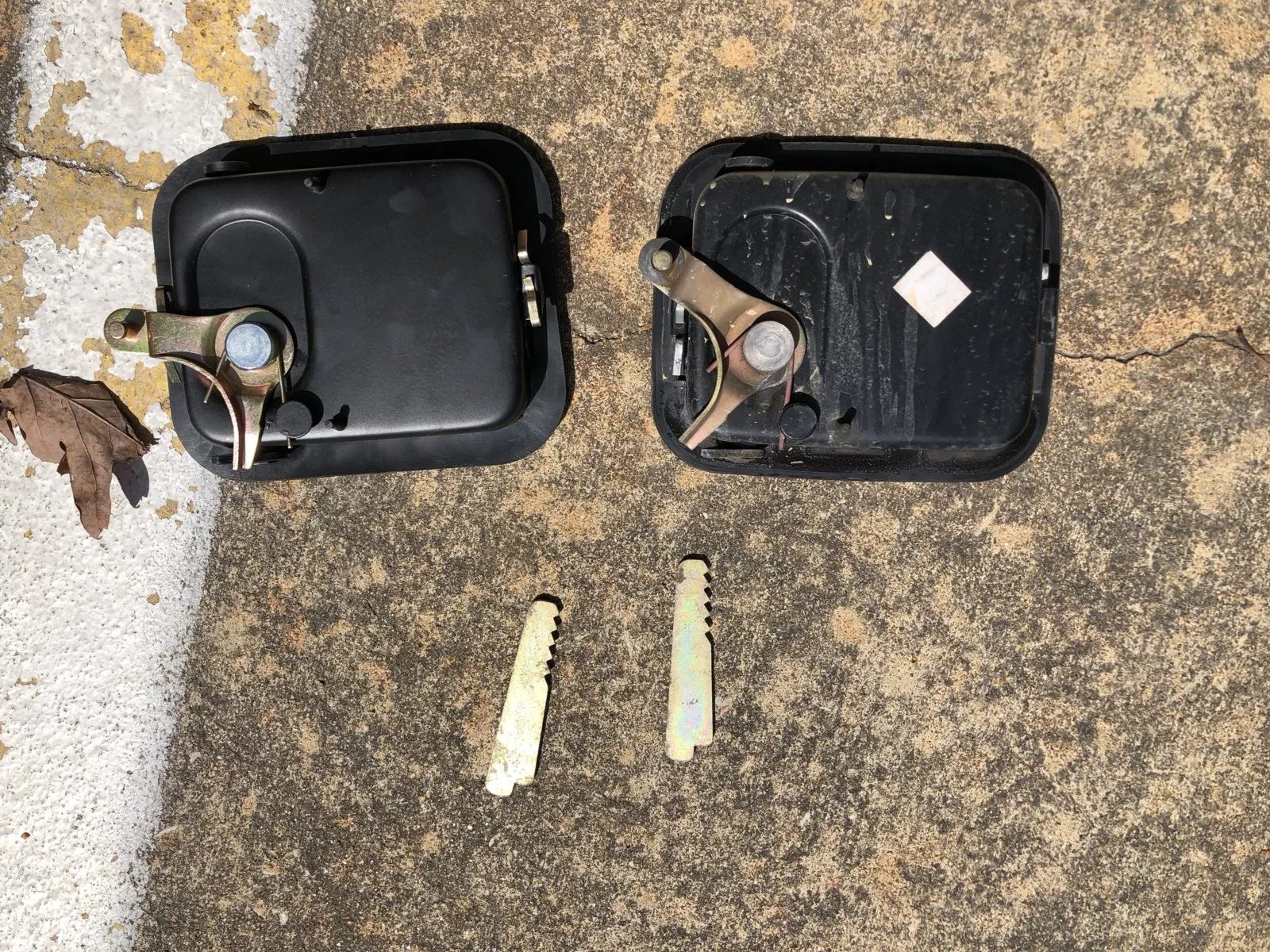

Today started with me dropping the passenger handle unprotected down a flight of concrete stairs. Powdercoat held up great lol!

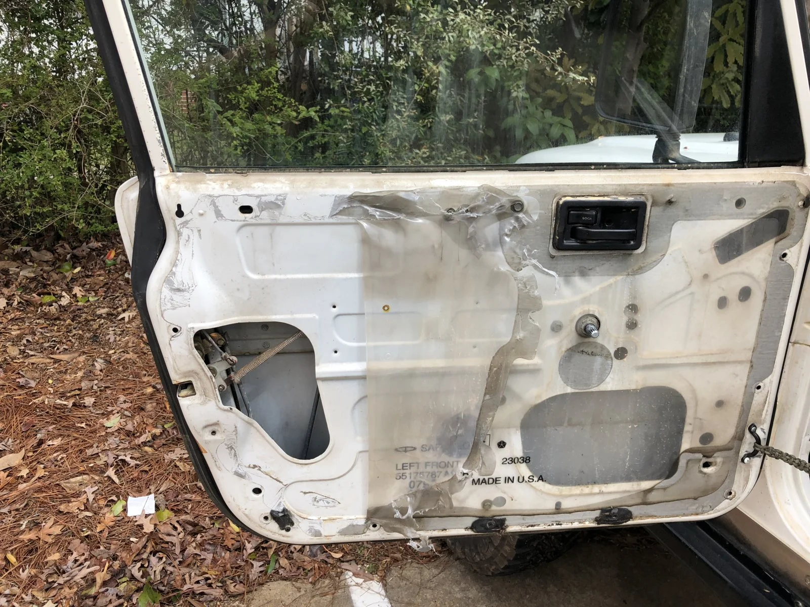

Door teardown:
I know this plastic serves a purpose but dang is it a pain:
Old vs new:

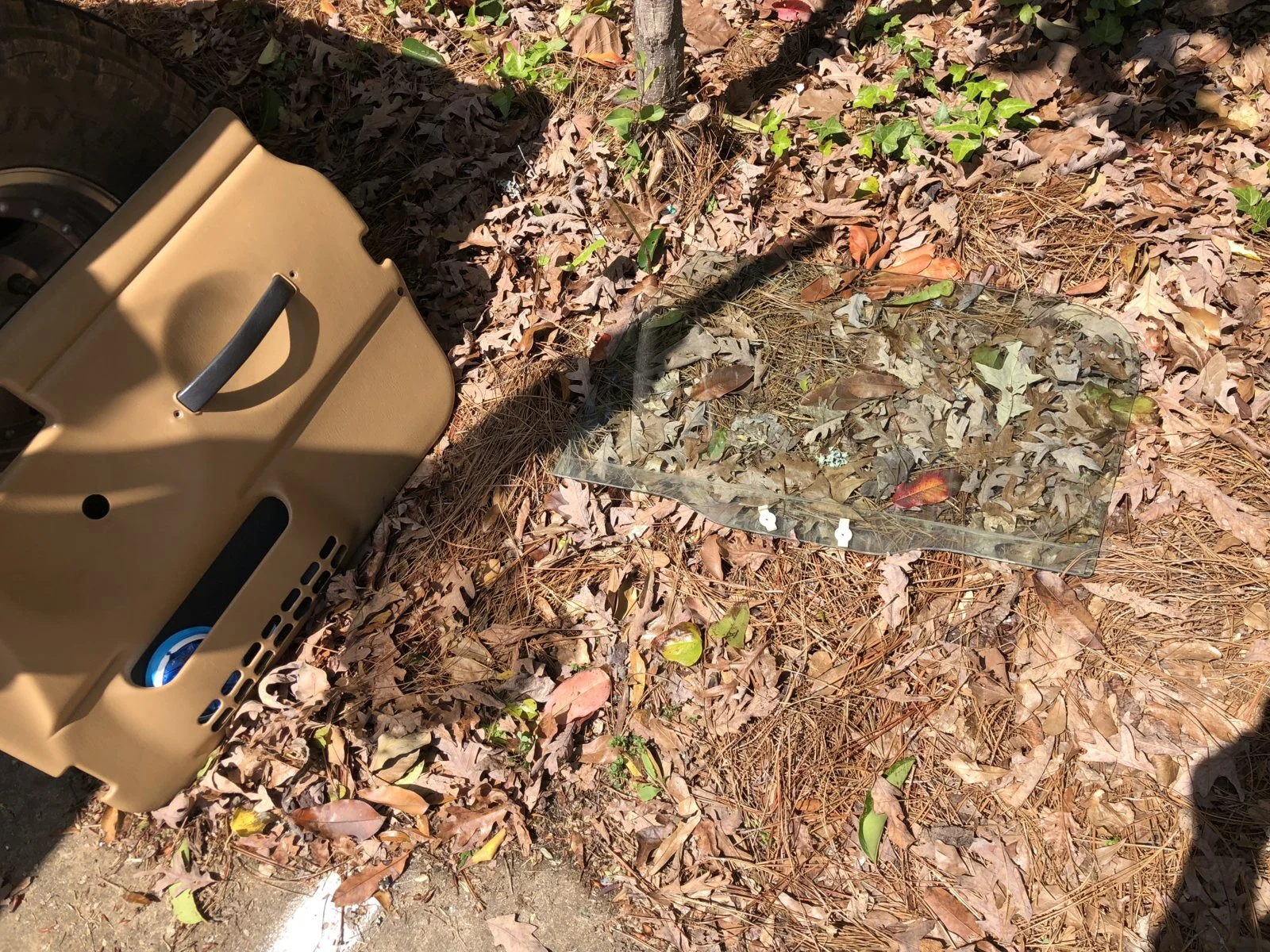

Definitely take the glass out, putting the slides back in with the glass in is impossible, ask me I tried!

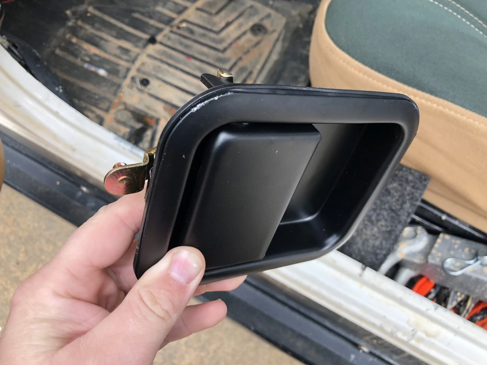

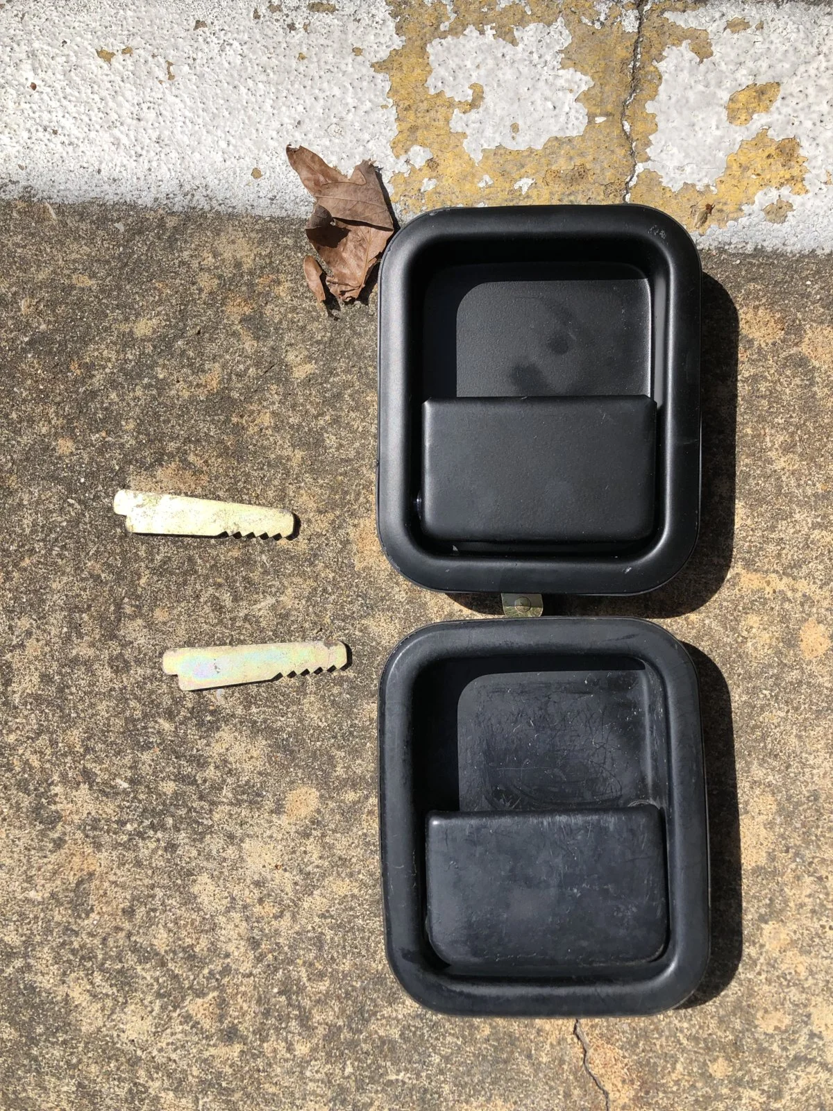

Fully installed driver’s side crown replacement handle, fits perfectly flush and works like a charm:
Time for the passenger side, you can see it has sprung:
Glass out. Pro tip, don’t lay the glass flat near your work space where a hammer can fly out of your hand and hit it. I am unbelievably fortunate to only receive a scratch from the impact vs it breaking:
Old vs new, passenger. You can really see a difference here:
Somehow I managed to break a new seating clip and had to reuse an old one. Works great!

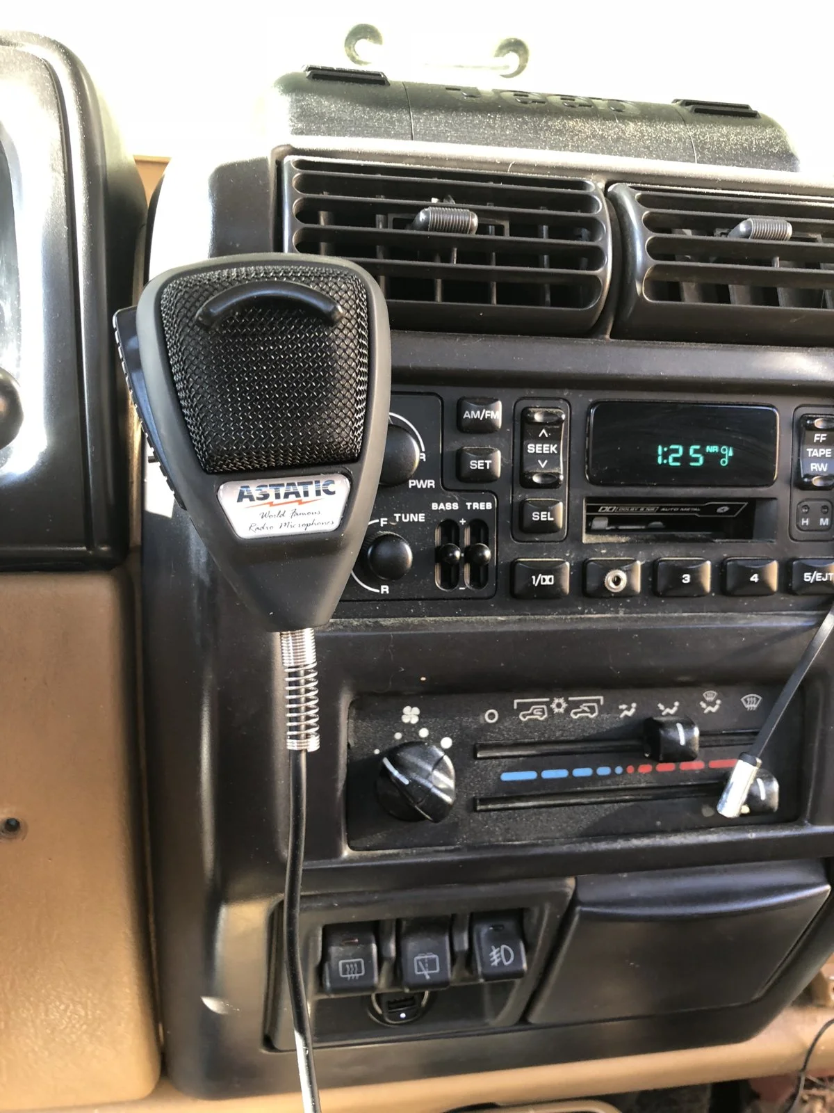

Skipping forward the new magnetic mount for the cb mic is unbelievably handy!

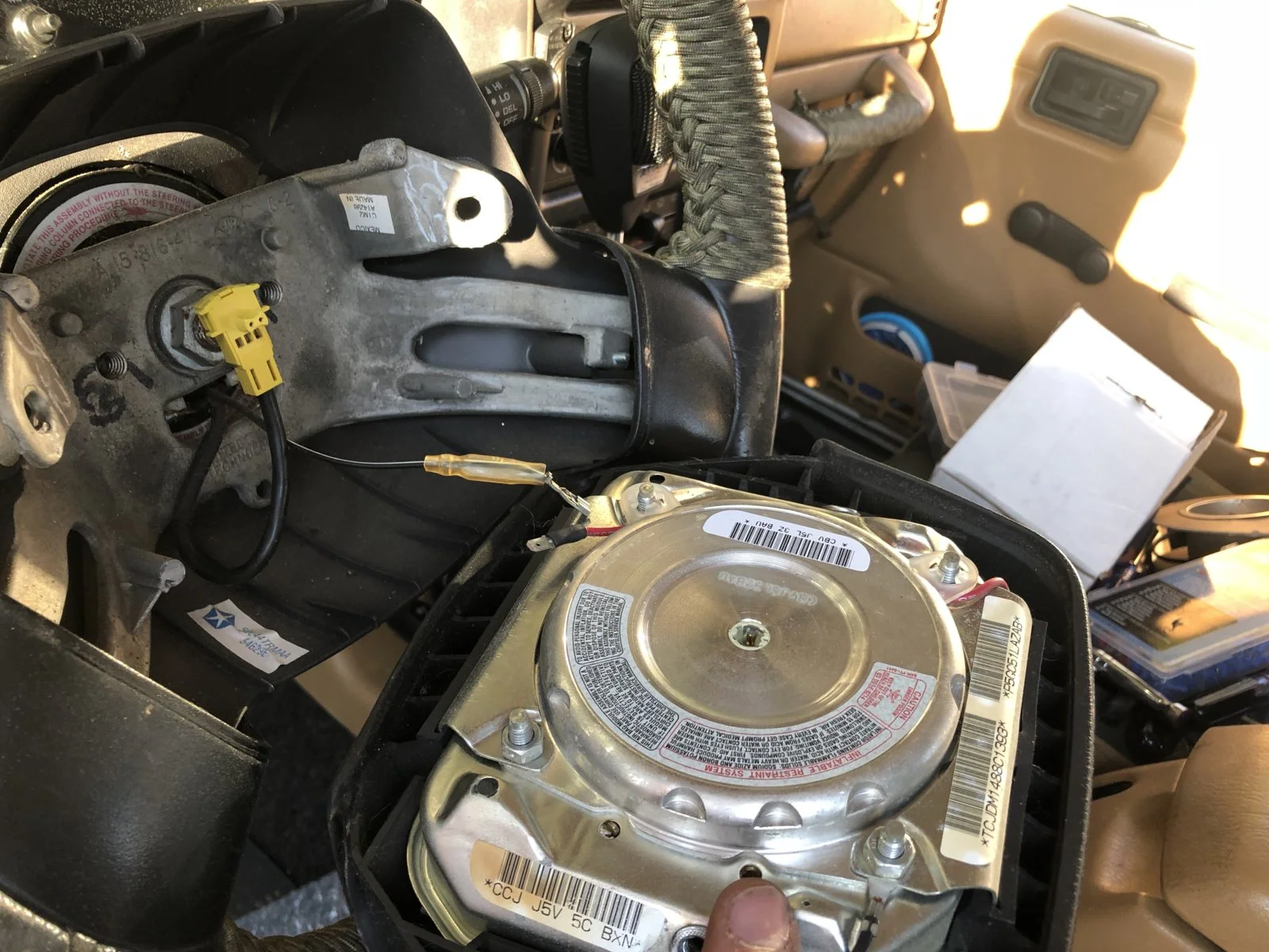

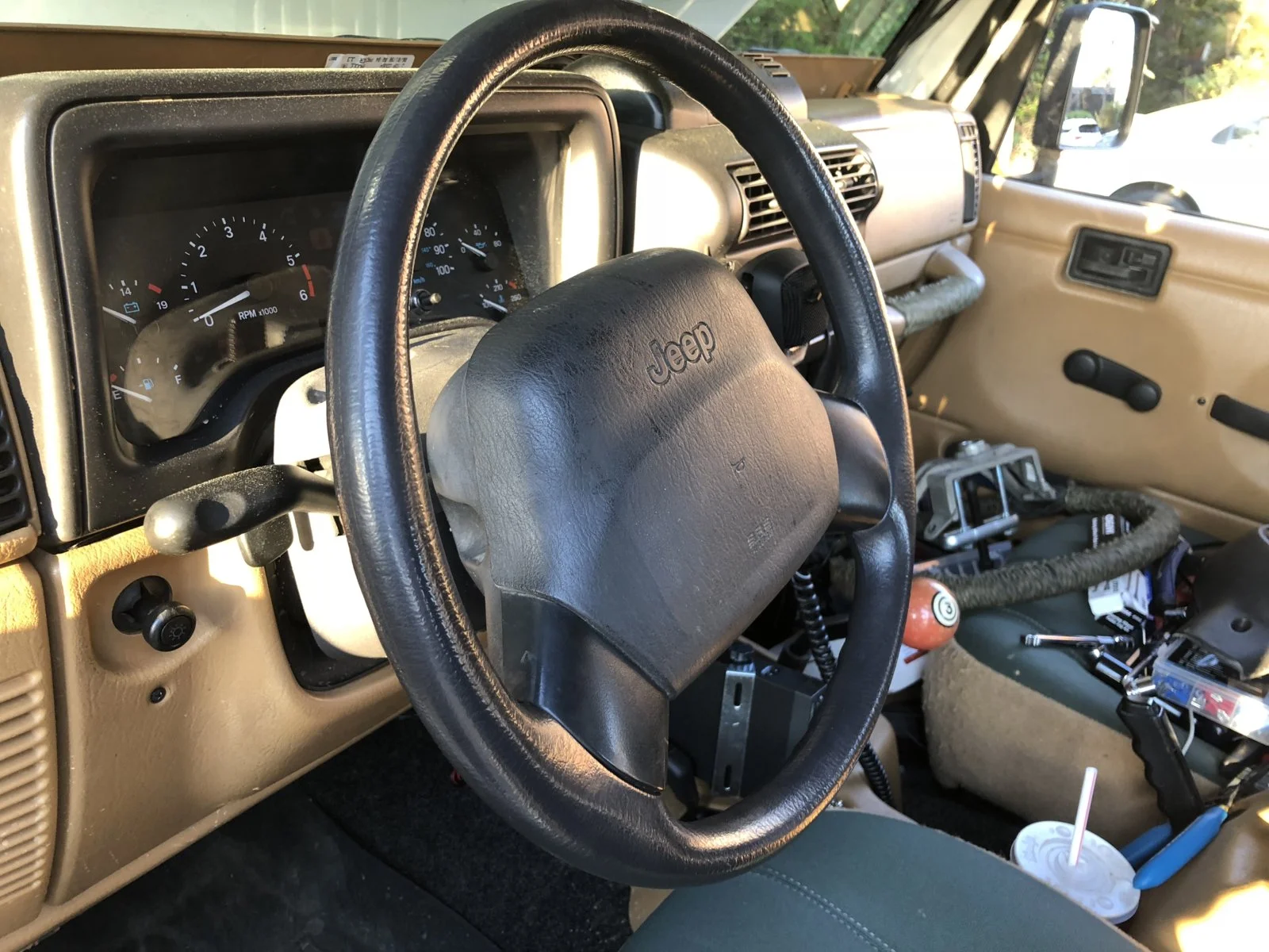

Airbag pulled:

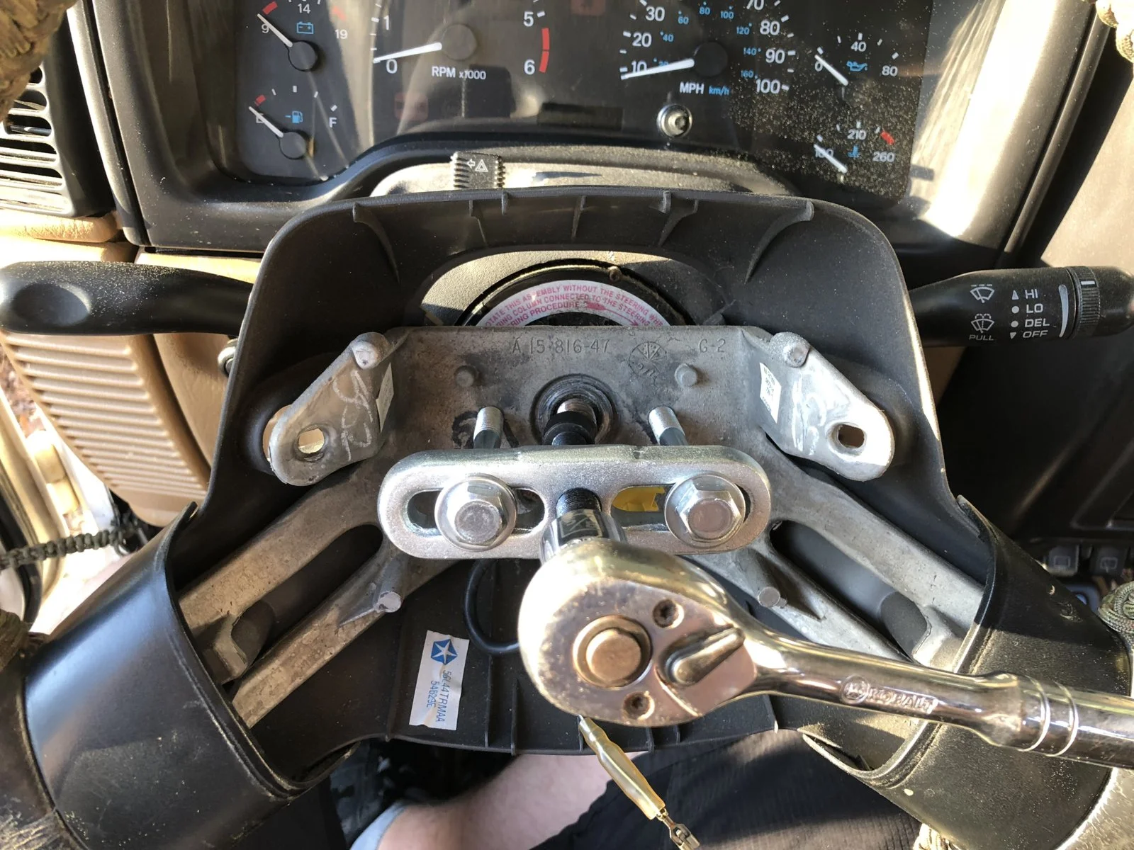

Pulling the steering wheel:

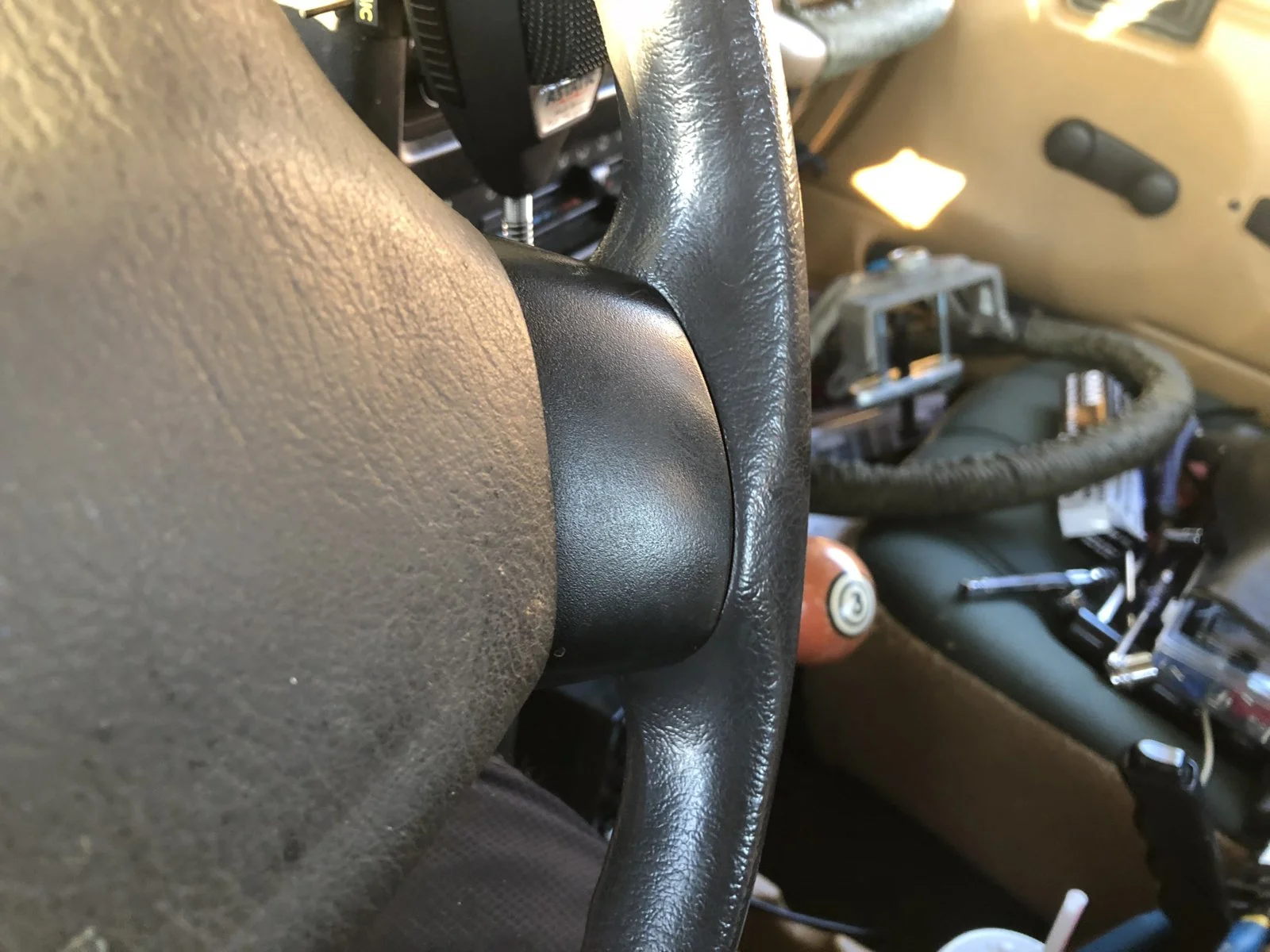

Seating new steering wheel:
Man that is 3 different vehicle donor parts, look at the color differences ahahaha.
Can honestly place this new $40 steering wheel in my top 5 interior mods for the TJ:

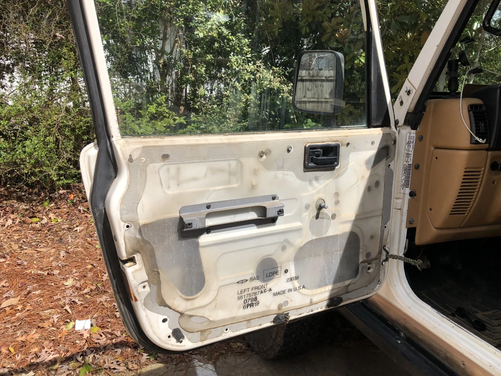

Okay, so what is that plastic under the door panel even for? I've never been sure what it's purpose is. I assume you didn't put it back on, did you?
Looks like I'll be getting some Crown handles then. Are the windows easy to remove?
Windows are easy to remove just be unbelievably careful of the white clips hanging up on the door cables. I kept the plastic, underneath the door. I think it is to keep out the elements but I really don’t know.
Having never done the job before, first door took an hour, second door took 30 minutes.
Nice! Looks pretty straight forward, and those Crown handles look good too. I think all the people complaining about them must have not installed them correctly, hence the "gap" they were speaking about.
That plastic is held on with glue or something?
Agreed. Yeah some type of adhesive that doesn’t set well a second time around ahaha.
Found the answer:
"The vapor barrier keeps the odd drip from the window from splashing on the window mechanism and wetting the speakers and other electronics in the door panel, but if you are getting enough water to wet the carpet, there must be a blocked drain hole.
The black goo that holds the vapor barrier is made by 3M."
In other words, we don't need it on our Wranglers, since we don't have power anything inside the doors! No speakers, power windows, etc.

It's also used to protect the unfinished backside of the door panel, as well as acting as a block against drafts. On our TJ's, the door panels are plastic, so no biggie. And drafts? Need I even ask? LOL Old cars used to run a hardboard material, and the plastic aided against warpage. Not as much of an issue these days...
Yeah... on a BMW or something I can see how it would serve a purpose. But on our TJs, it won't do much at all, as these things are hardly even sound proof as it is!

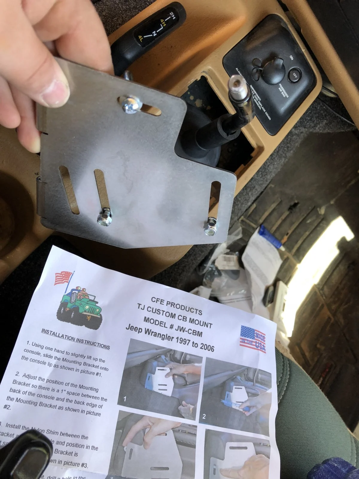

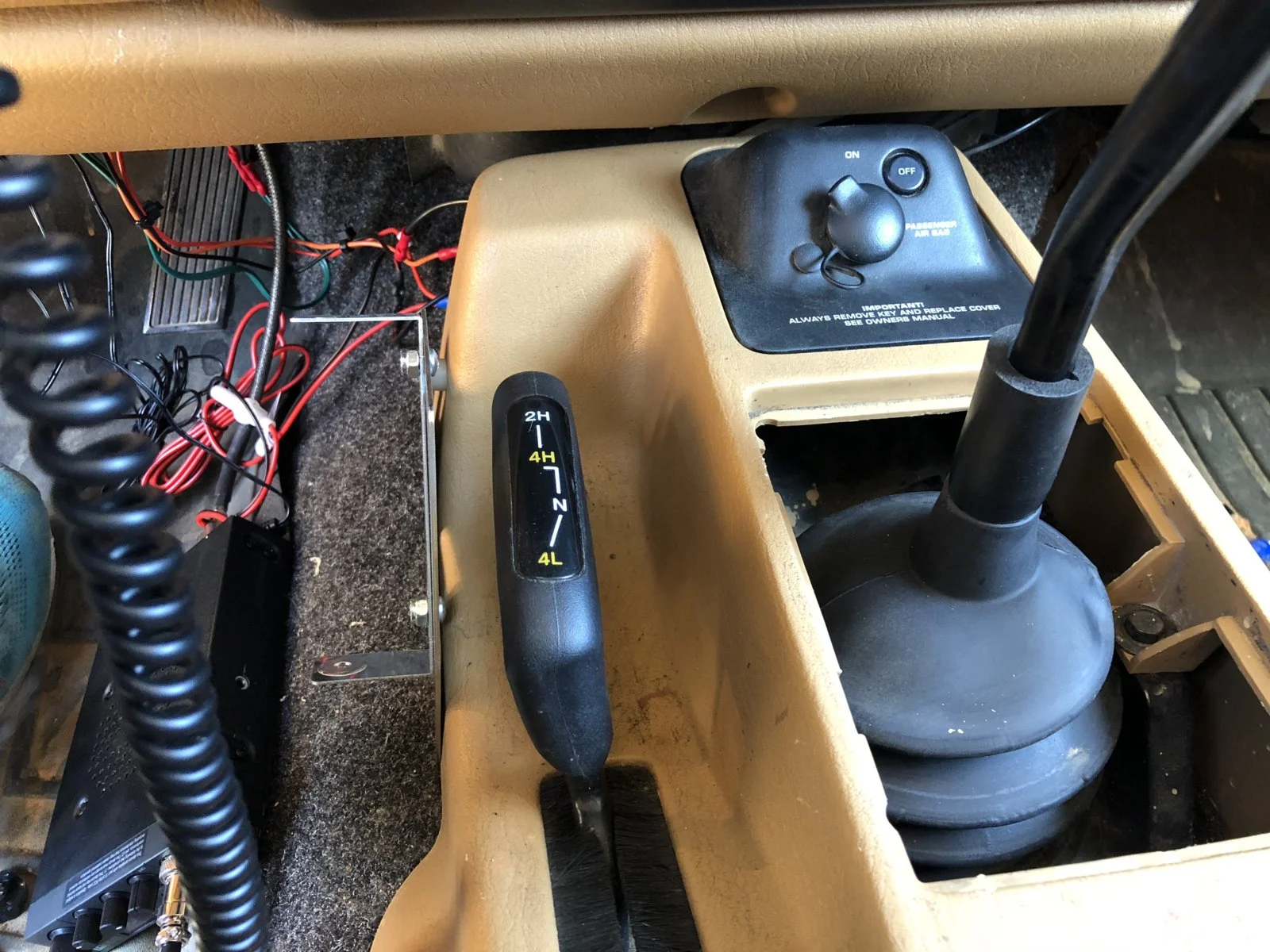

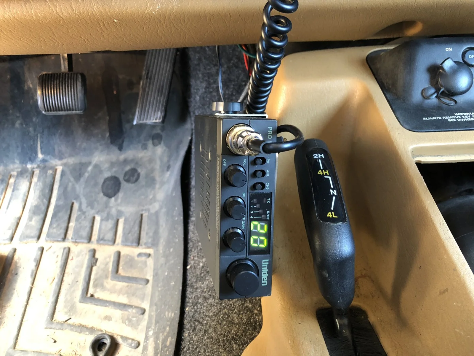

And wow, seriously one of the best cheapo brackets for a cb I’ve ever used it. It pinches the console and bolts through to secure it. You can angle the CB in any manner, for me this was the preferred placement:

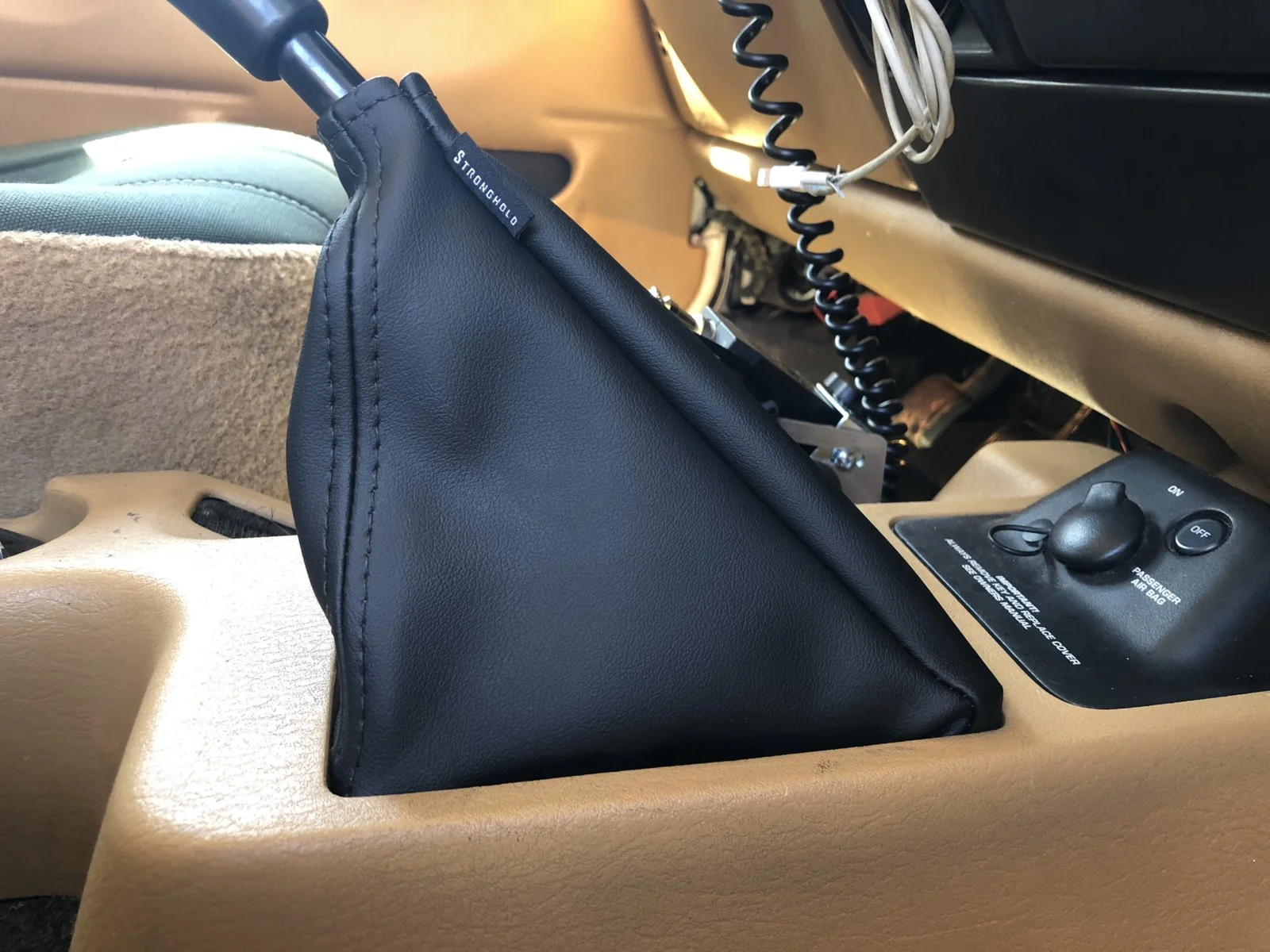

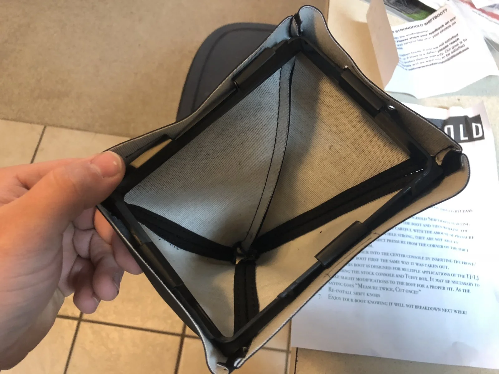

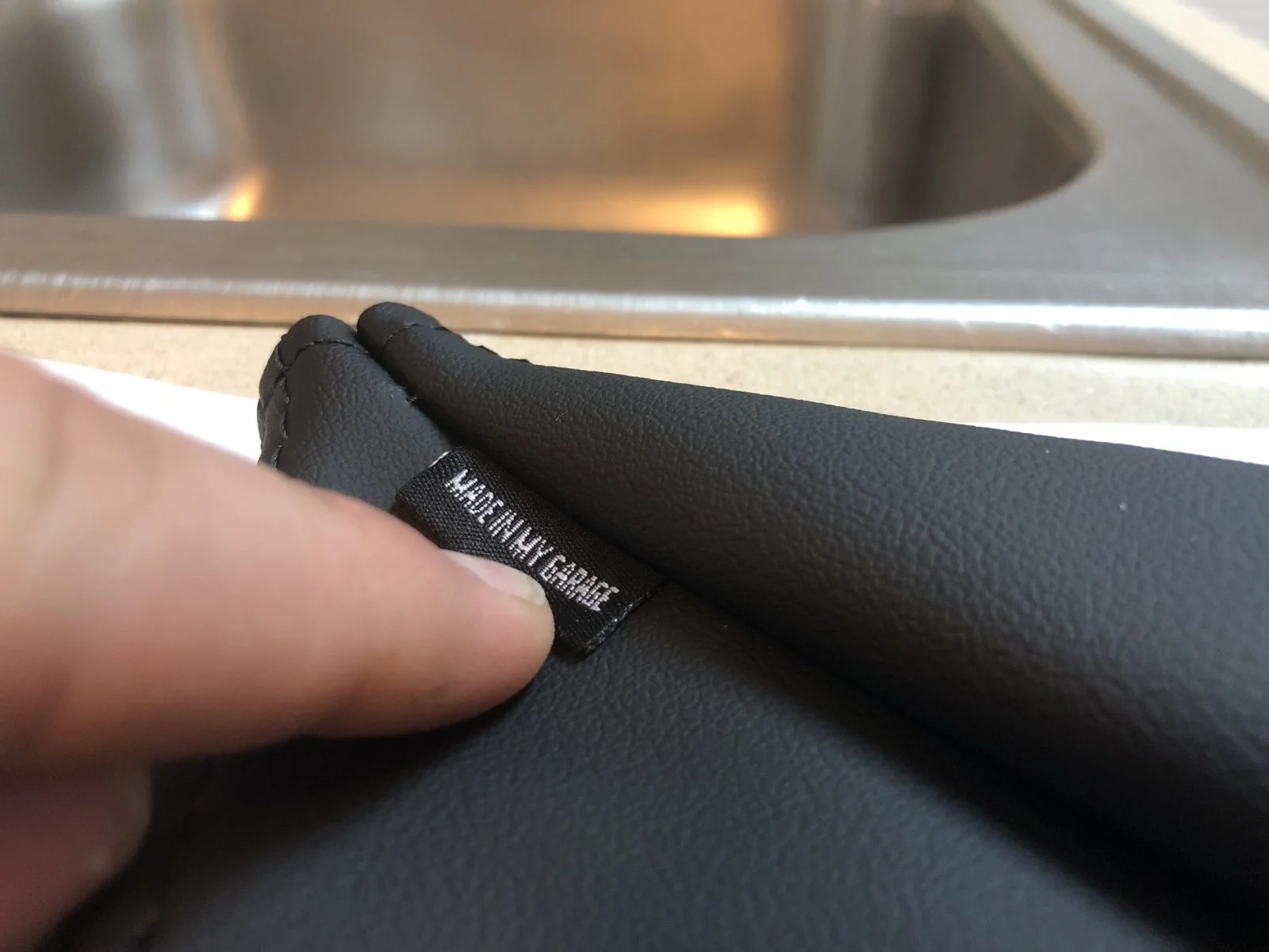

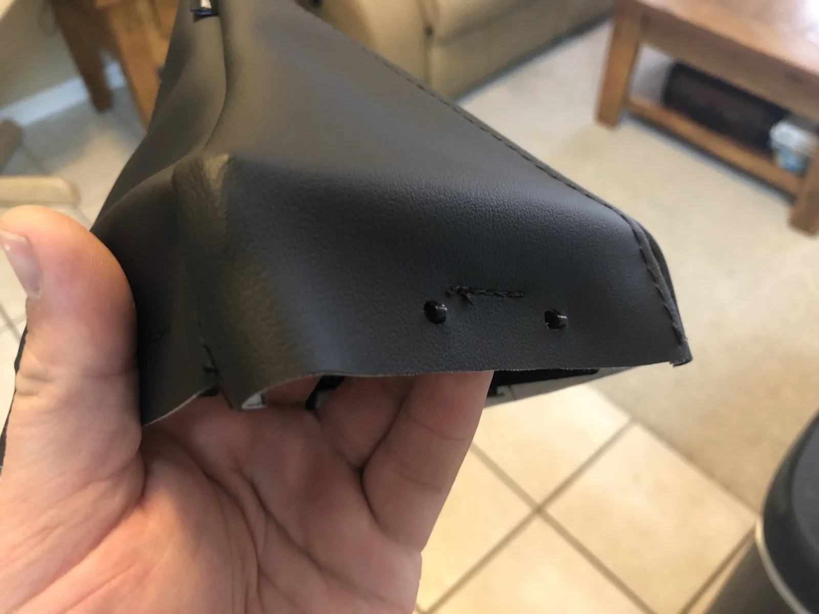

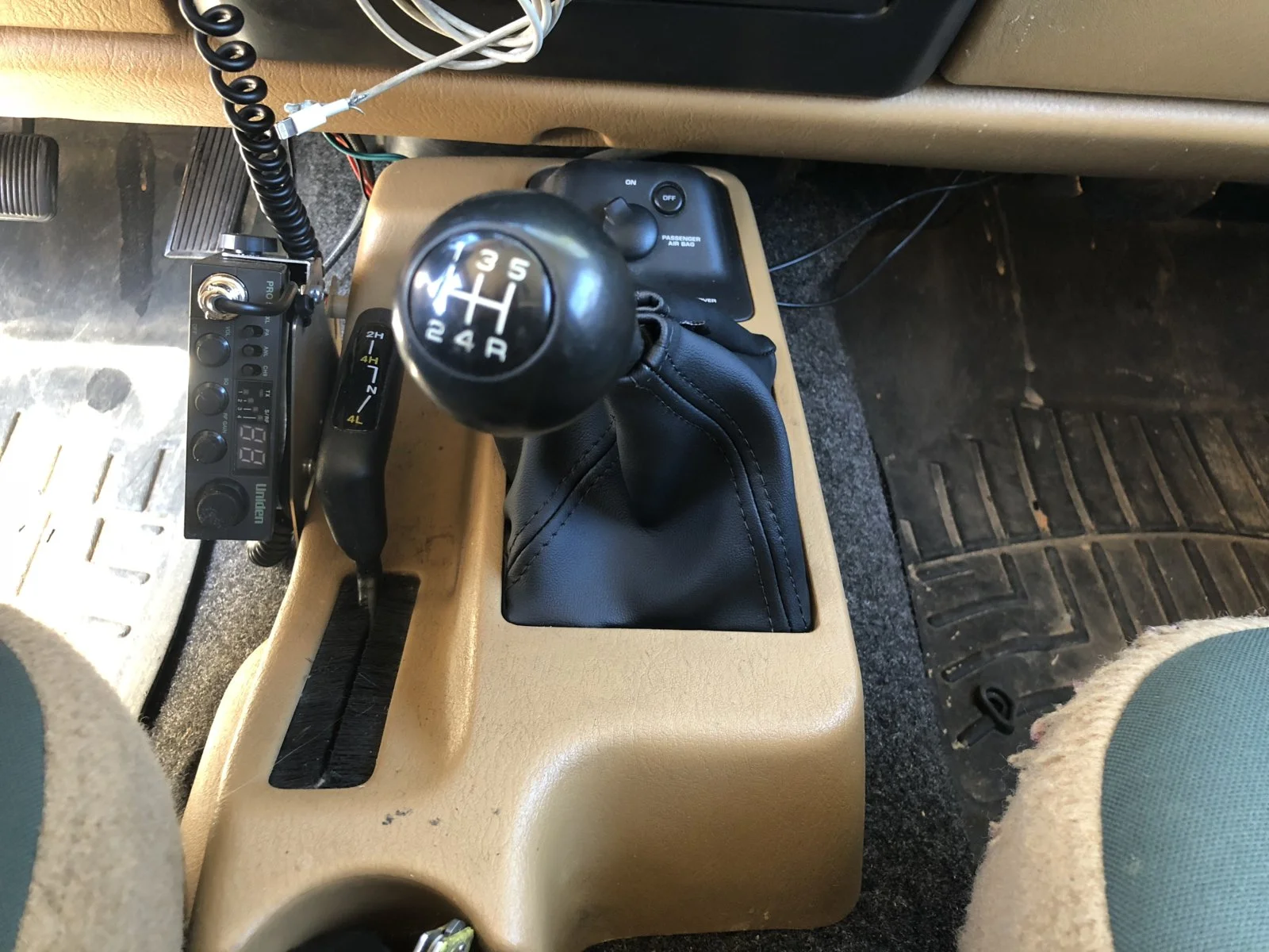

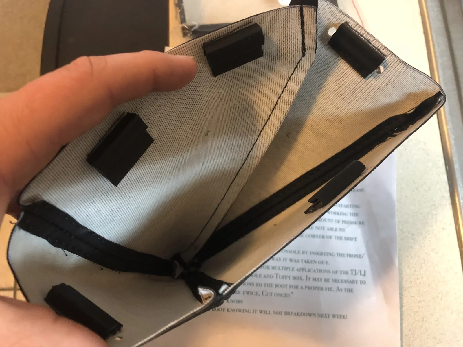

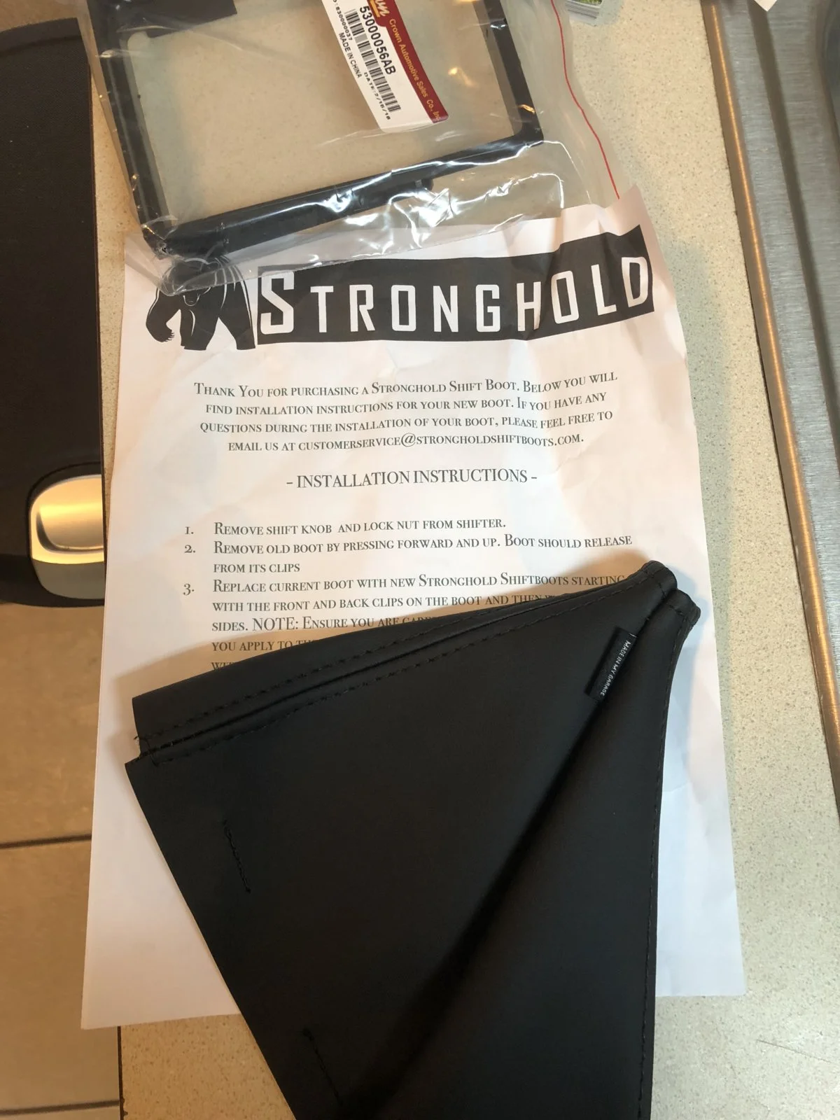

Well on my hunt for a shift boot last friday and found Stronghold Shift boots. A guy in his garage handmaking a bunch of vinyl shift boots. Purchased one on friday, got it today. I can only say that this thing is remarkably thought out. The corners/stitching/mounting tabs make it so simple to install. Finally starting to look like I have a finished Jeep.
I really enjoy supporting products like this and am comfortable reccomending this $30 shift boot above all others. Comes in any vinyl/stitch combo you want.
