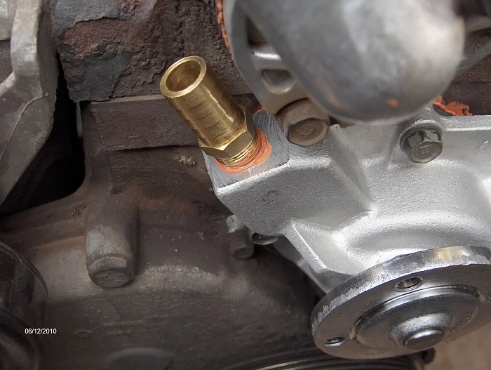

Before taking the pump off, consider this. move not done it put seen pictures.
Replace the tube on the pump with an appropriate sized fitting with a barbed end on on end, then but the proper length of hose you need and join the two hoses together with a double barbed fitting and clamps.

That's a REALLY good idea. Do you know if that's a kit that someone sells?
About over-tightening; that may have occurred. Based on where (I think) the tube is leaking, I may have kinked it when the WP was already on the front of the motor and I was getting the tube lined up with the hose. All other tightening I did was in a bench vise with an appropriate-sized box wrench on that nut.
It’s not a kit that I know of. A hardware store would have both fittings and then you’d have to go to a parts store and find a hose that is the diameter you’d need. If you could find one that has a bend molded into it would be even better.
