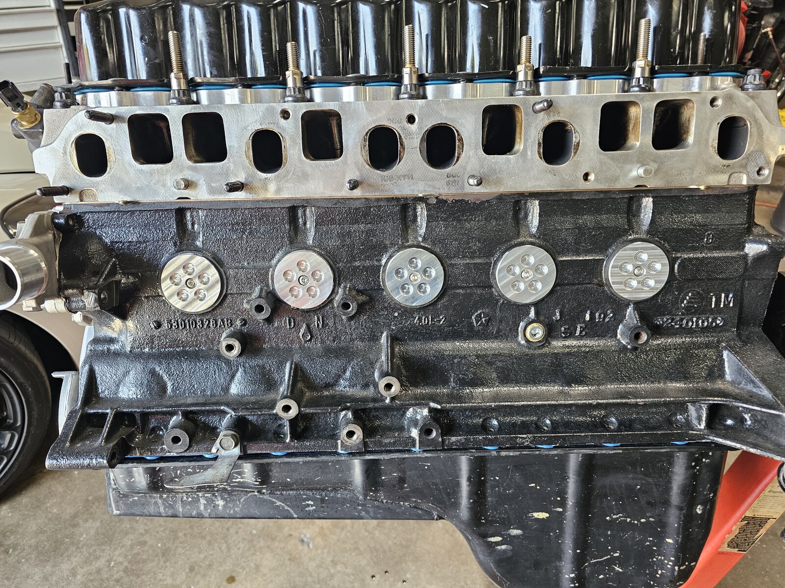

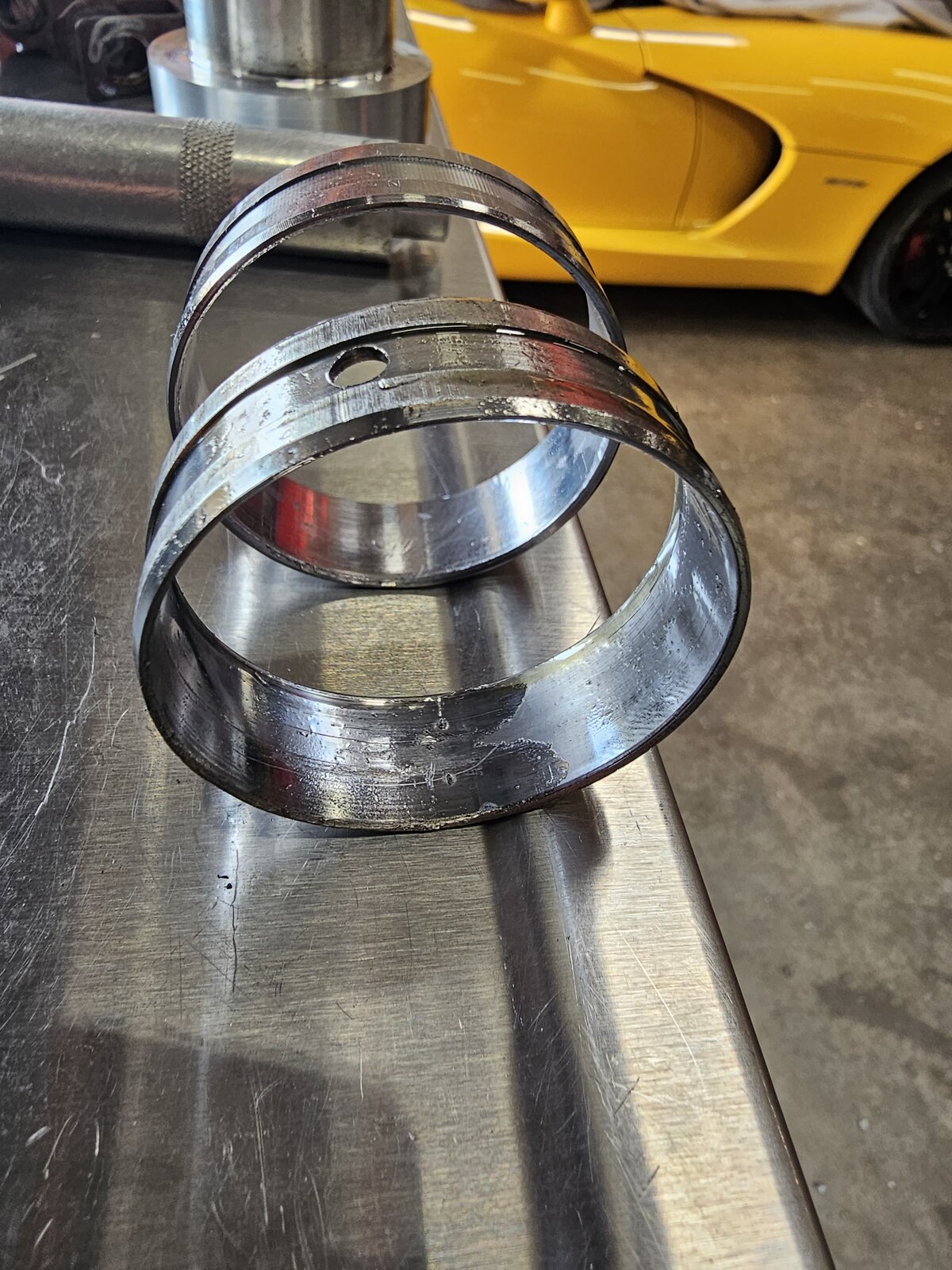

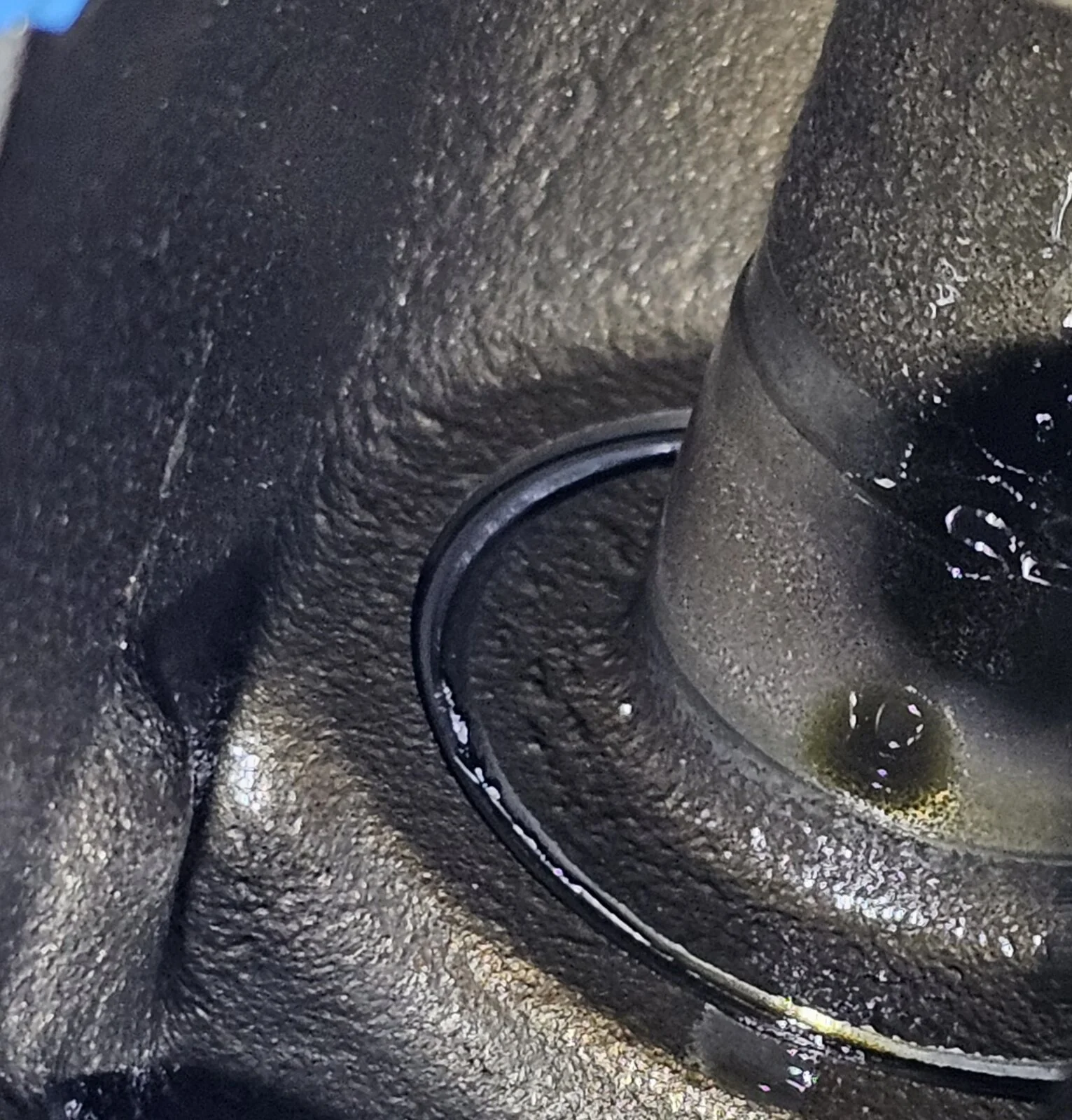

No, I was still getting small flakes of glitter in the oil filter after 3 oil changes. Nothing was knocking, so I had a hunch it may be cam bearings. I was right. I used a borescope through the OPDA hole and saw the bearings were squished out at the bottom. So, I pulled it to replace the cam bearings and put a lighter valve spring in. I also polished the cam journals and replaced the expansion plugs. It looked to me as if the machine shop installed the cam bearings incorrectly. The front two were installed at 2 o'clock with the oil feed holes lined up with the block. The rear two however were clocked at 12 and the feed holes were blocked.

Yup. That would certainly do it. That’s a pretty rookie mistake for a machine shop.

I hereby bestow upon you the coolest freeze plugs on a Jeep I6 award. Keep the speech short and don't mention Will Smith's wife please.

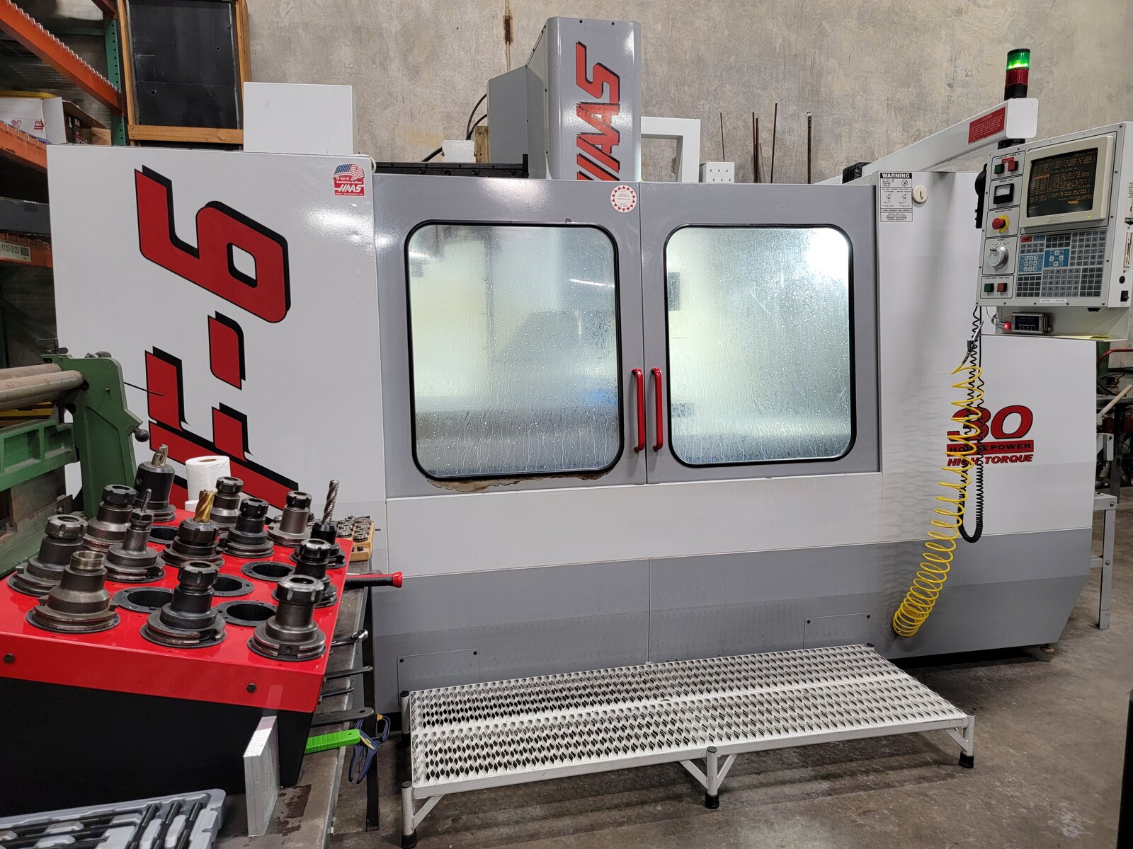

I bought this machine earlier this year for that exact purpose. I keep looking at auctions for more stuff. I would like to get a wash cabinet, crankshaft balancer and cylinder honing machine. I think with all that stuff I should be able to do quite a bit of engine work in house.

That’s a nice one. I have a VF5 with a 5th axis. It’s amazing what these machines can hold for the price you pay. Very good value.

I agree this is the 9th or so Haas I've bought. They have all been decent for the price. I have a little TM1 that I prototype stuff on most of the time.

I had a hunch there was a problem after the 3rd oil change with glitter. I was able to diagnose it through the distributor hole with a borescope at a tight 90 degree to see the bottom edge of the center two cam bearings. I could clearly see they were smashed out at the bottom, then off with the pan for further inspection, and ultimately out with the engine for cleaning and repair.

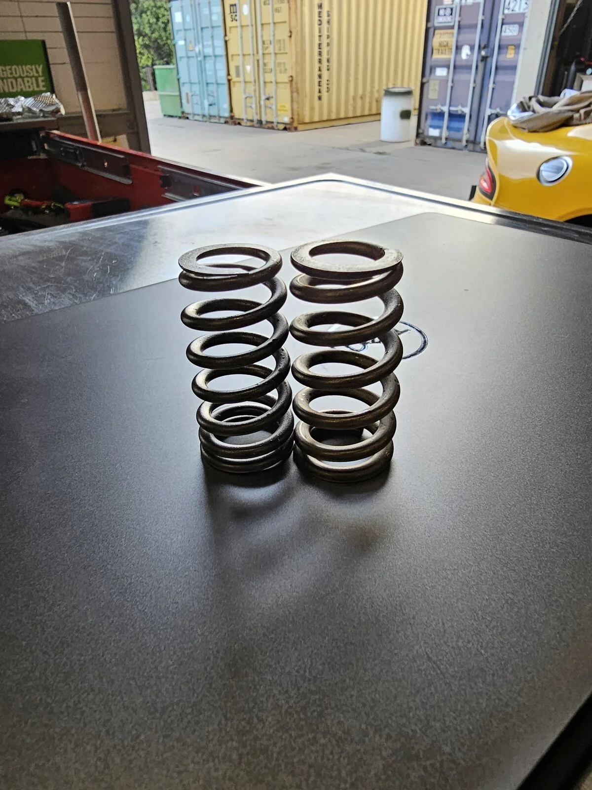

Also fwiw I found out the valve springs I have are 120+ on the seat with a 250 rate. The OE springs are 70 or so seat with a 200 rate. I found another comp spring that has the same dimensions with a 90 seat and 190 rate that's good for 550 lift. From reading what others have posted it seems like heavy springs cause cam bearing issues as well.

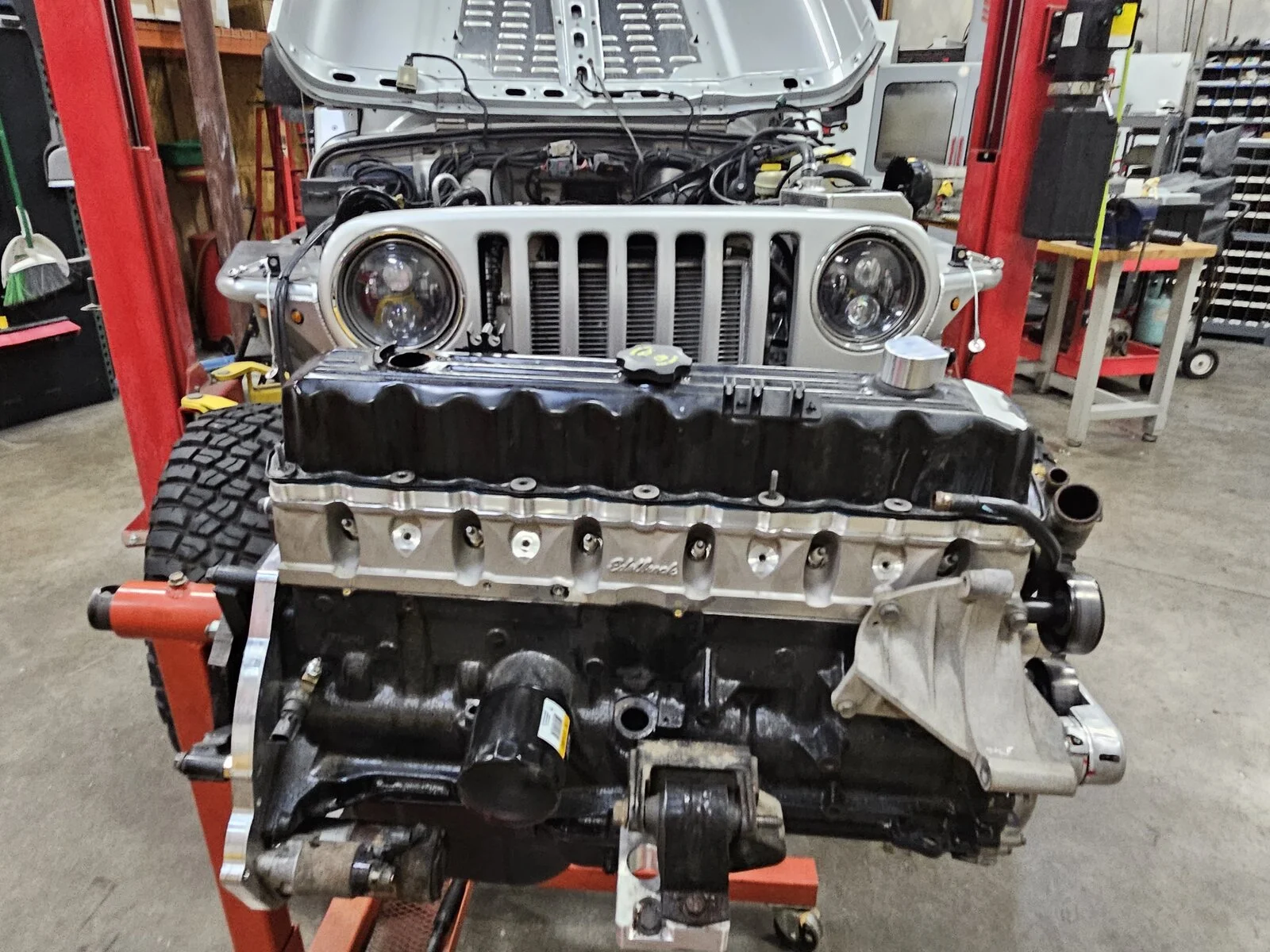

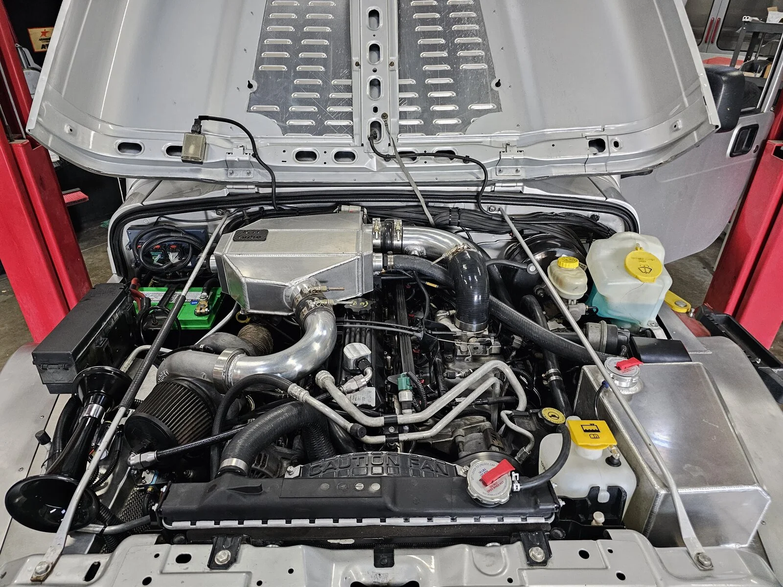

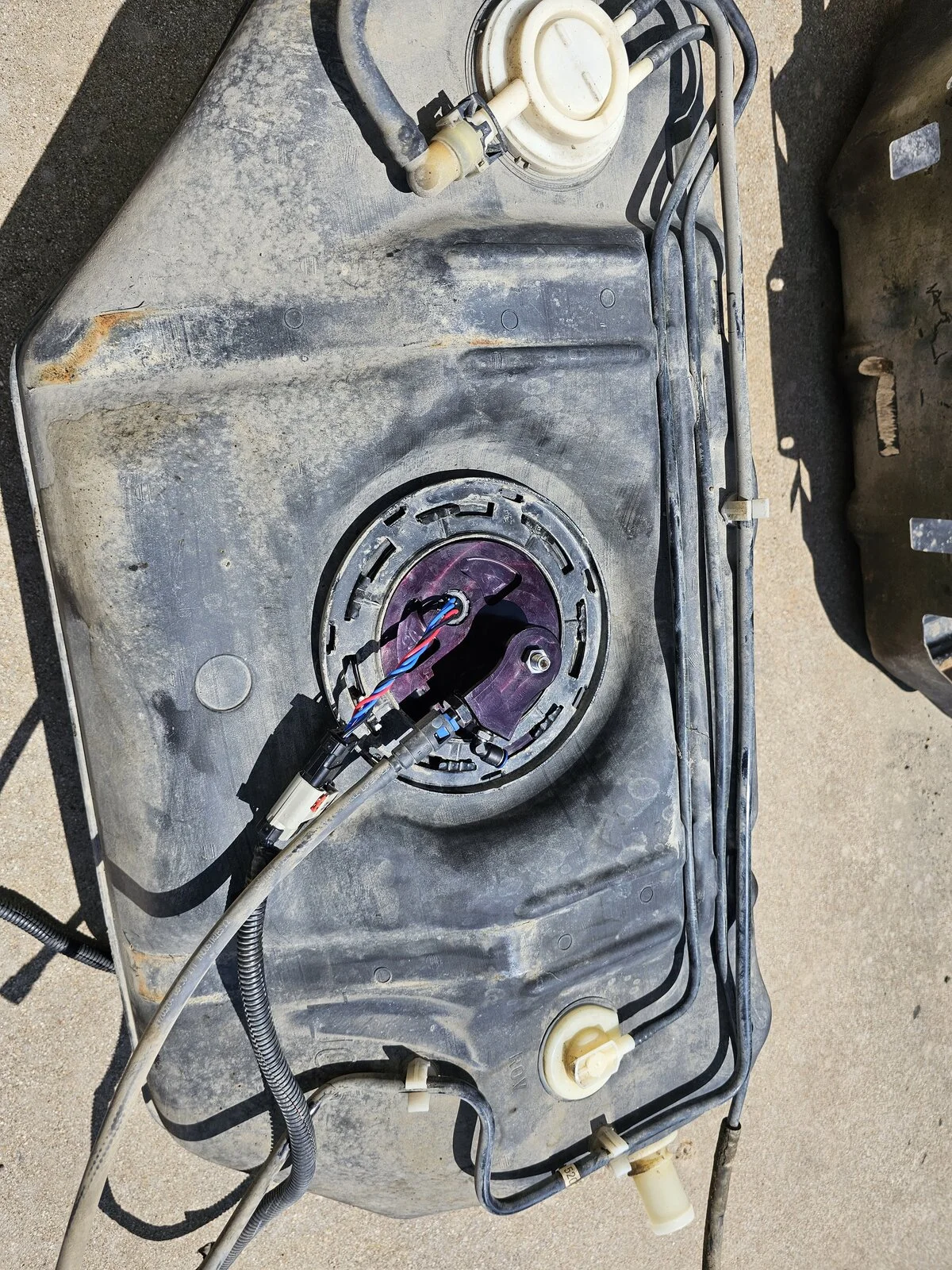

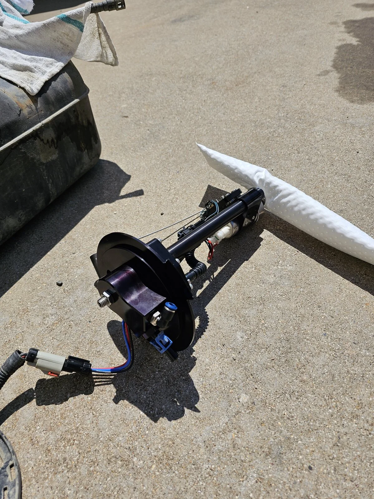

Well it lives again. The valvetrain sounds a lot quieter. The valve springs are quite a bit different looking. Definitely softer on the seat. I also installed the fuel pump and moved the tank back to the TJ position to give the diff a bit more space.
