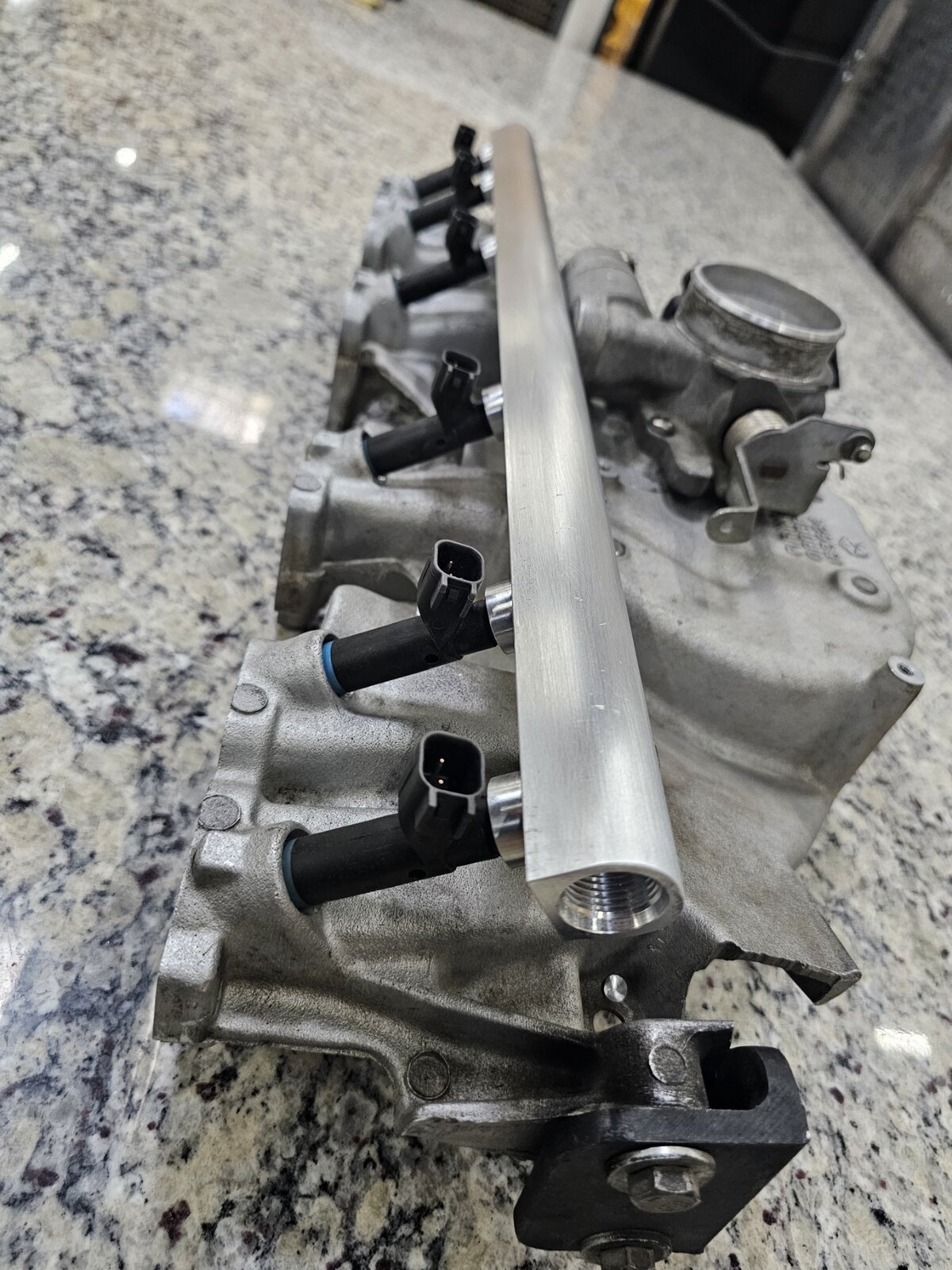

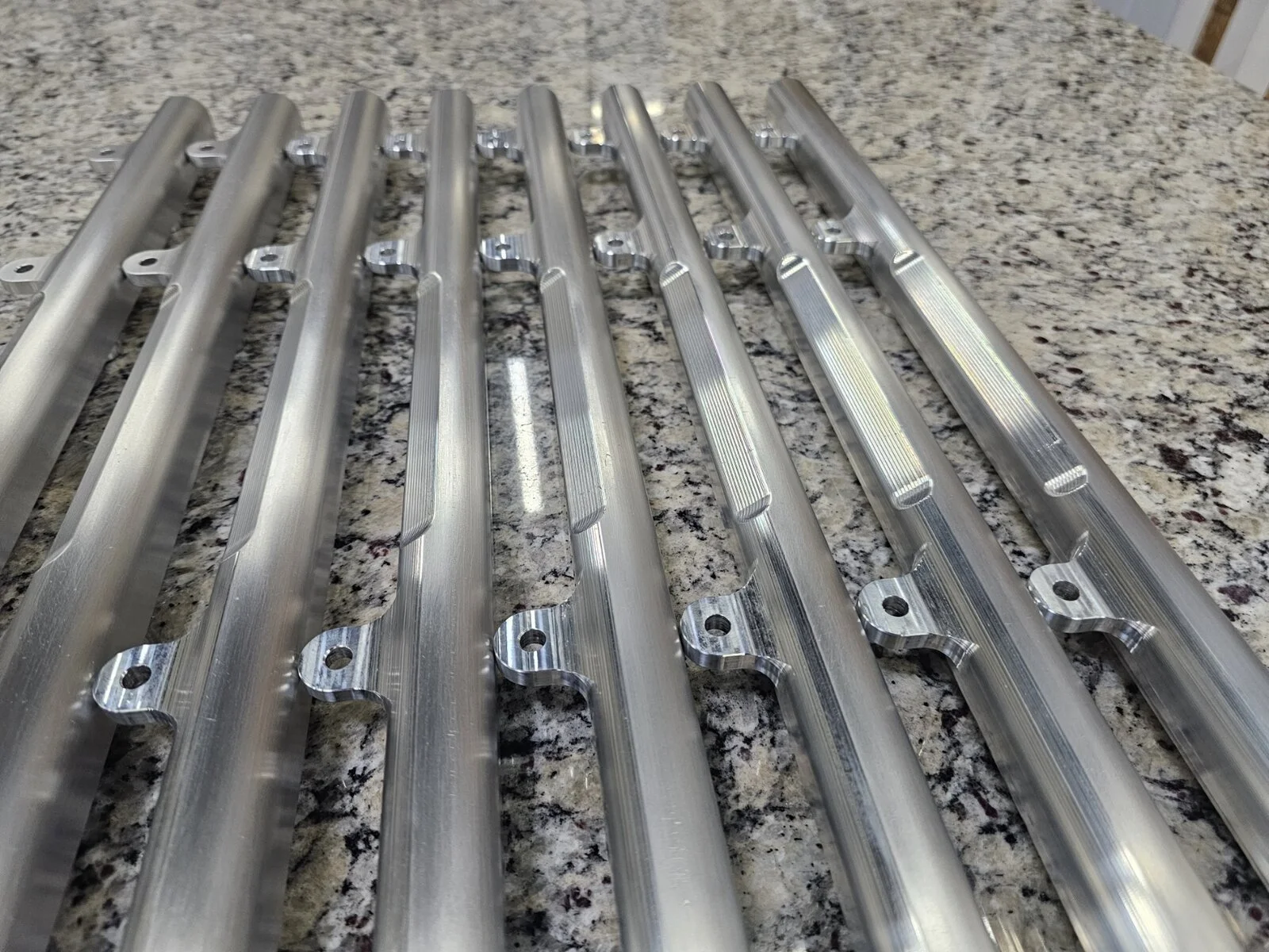

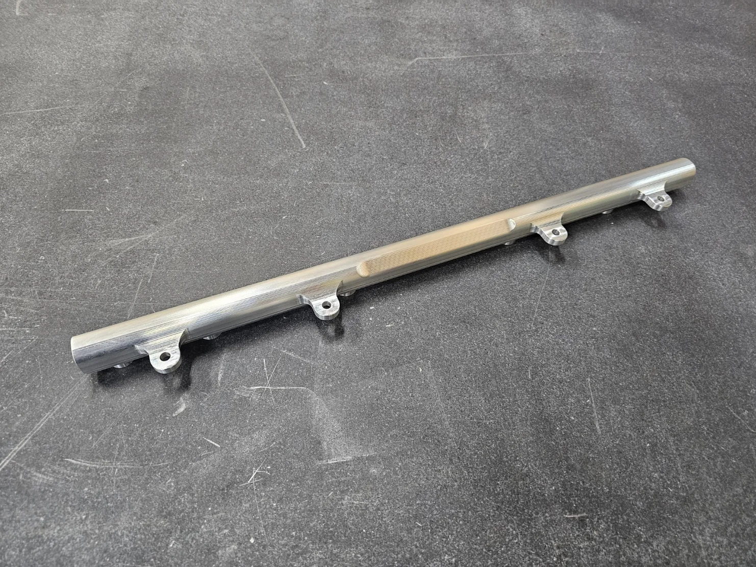

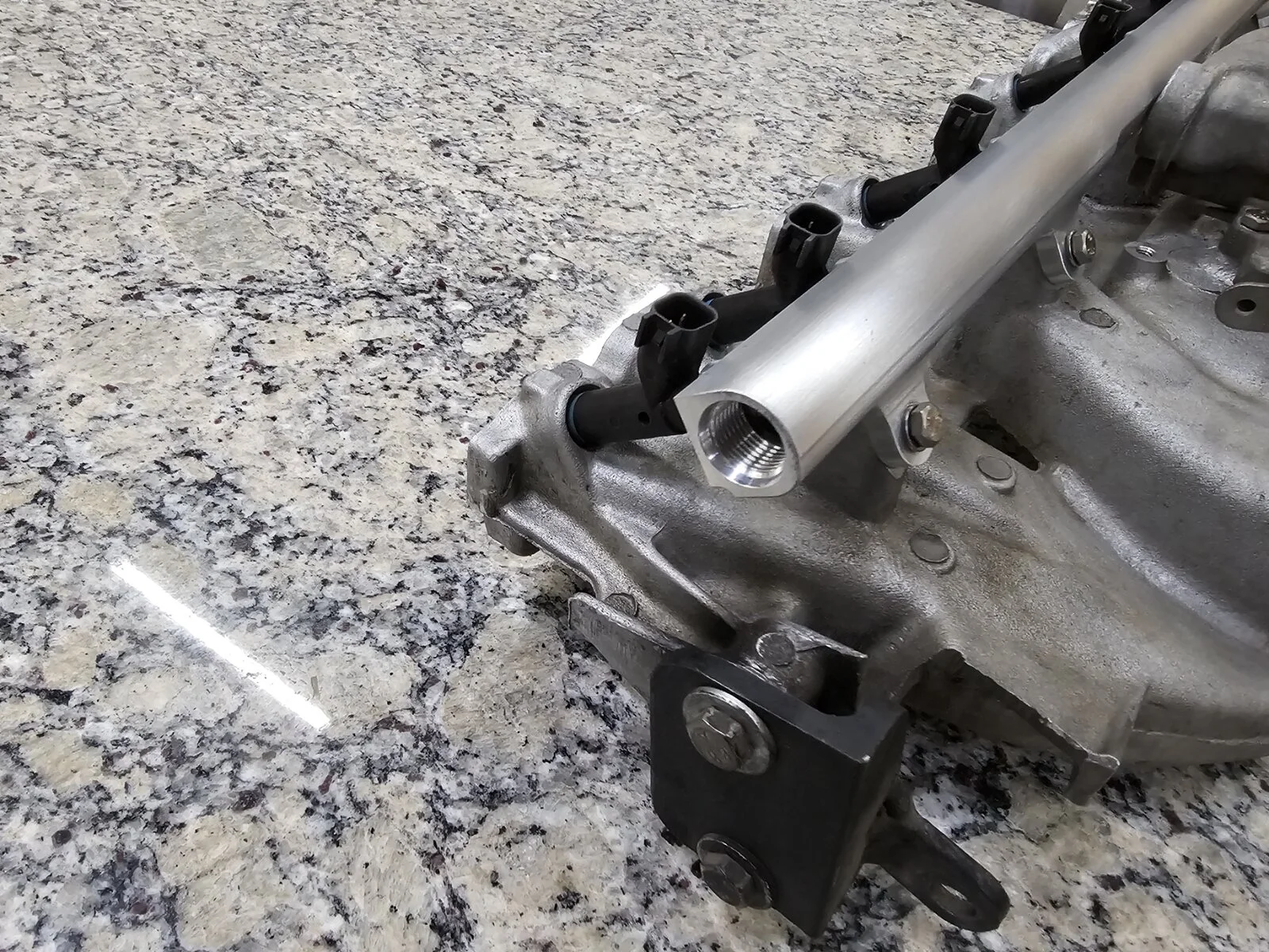

I made myself a new fuel rail for the 4.7. -8 all the way through with ORB ends and machined threads. All one piece and extra thick. I also made a few for some friends.
