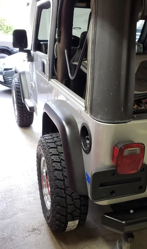

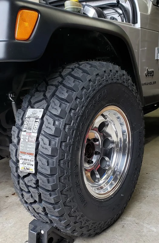

I had 31's on the stock suspension for 2-3 months before I put my lift on. I also had aftermarket wheels with 3.75 inches of backspacing, so they stick out a little further. And I had the slightly wider Rubicon flares. I didn't take it off road during that time, but I did have a couple situations where the tires would rub the underside lip of the rear flares on road. I don't know what you call it, but the road had a long stretch of high and low spots. They kind where when you drive over it at speed, the whole vehicle bobs up and down, like going over waves on the water.

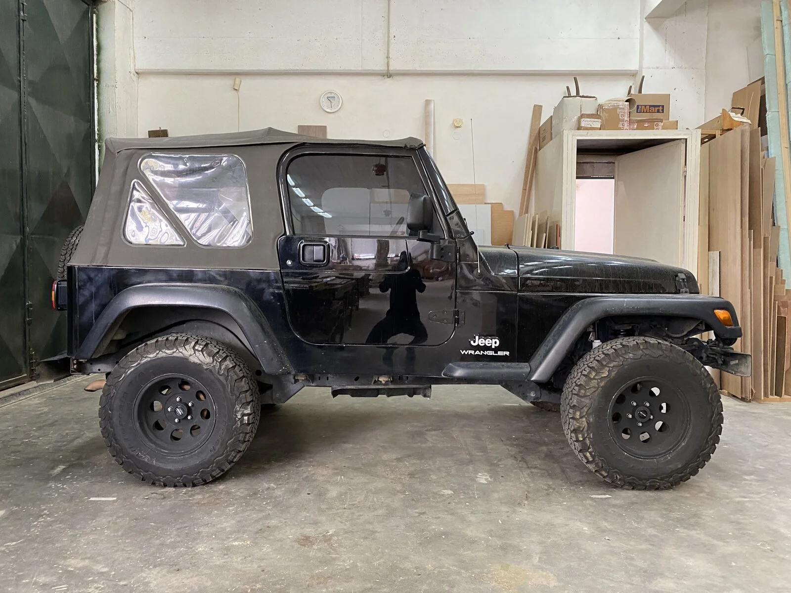

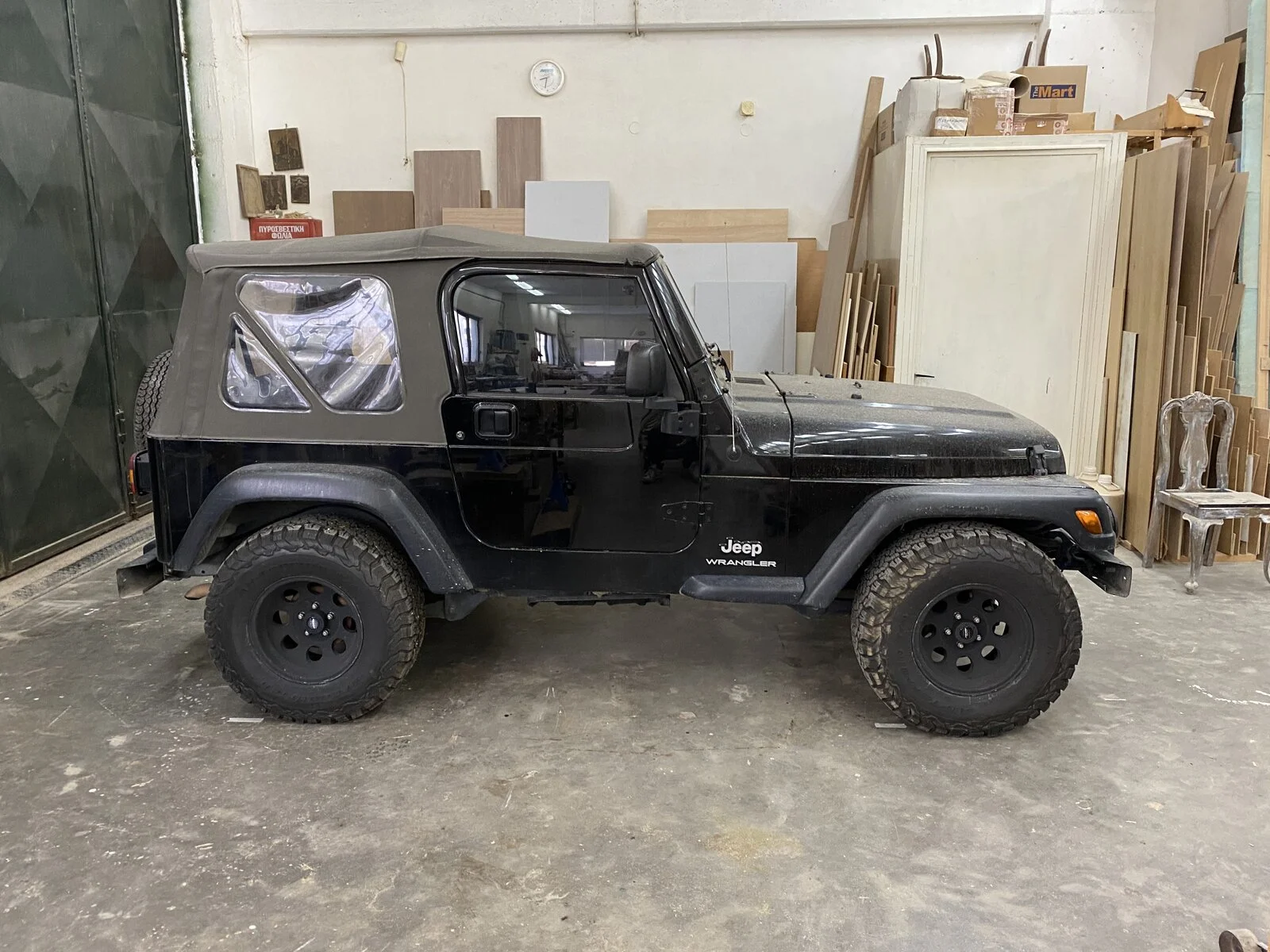

IMHO yes. For me, 31" tires with stock suspension was not the right build. I repeat! FOR ME.
It's my daily driver, but my goal is to build it as off road capable as possible within a limited budget, and a very limited product availability.
I ran my TJ roughly for 2 years almost stock. 29" and stock suspension. I decided I wanted to start modifying so the next logical step for me was 31" (I knew from the beginning that I would need the 2" lift).
I am sure (and I've seen) people running 31", 33" and even 35" tires with stock suspension. I believe anyone should build his rig exactly how he wants, and don't care about what others think at all.
BUT... 31", 33" and 35" tires with stock suspension would need a big-huge amount of bump stop extensions. Which means small articulation, not enough up travel. (Check this thread about up travel, if you haven't already. It's Golden : https://wranglertjforum.com/threads/up-travel-whats-the-big-deal.16270/ )
My personal taste is to be off road capable, so I chose some springs that would give me 2"-3". (I got front 3", rear 2.5"), which I think is the right amount of lift to have enough up travel.
If you don't care about off road though, run even 35" tires. Who cares? Just be a little bit careful over bumps etc.
Some photos for examples:
First photo is 31" with stock suspension, second one is 31" with the 2"-3" lift.
You can see clearly I believe how little space there is between tires and the fender flares in the first photo.
Just be honest with yourself about how you want to use your TJ, and build it accordingly. There is no right or wrong. Just personal taste. (Well, just don't put big tires without bump stop extensions and no lift, you are going to break it.)
