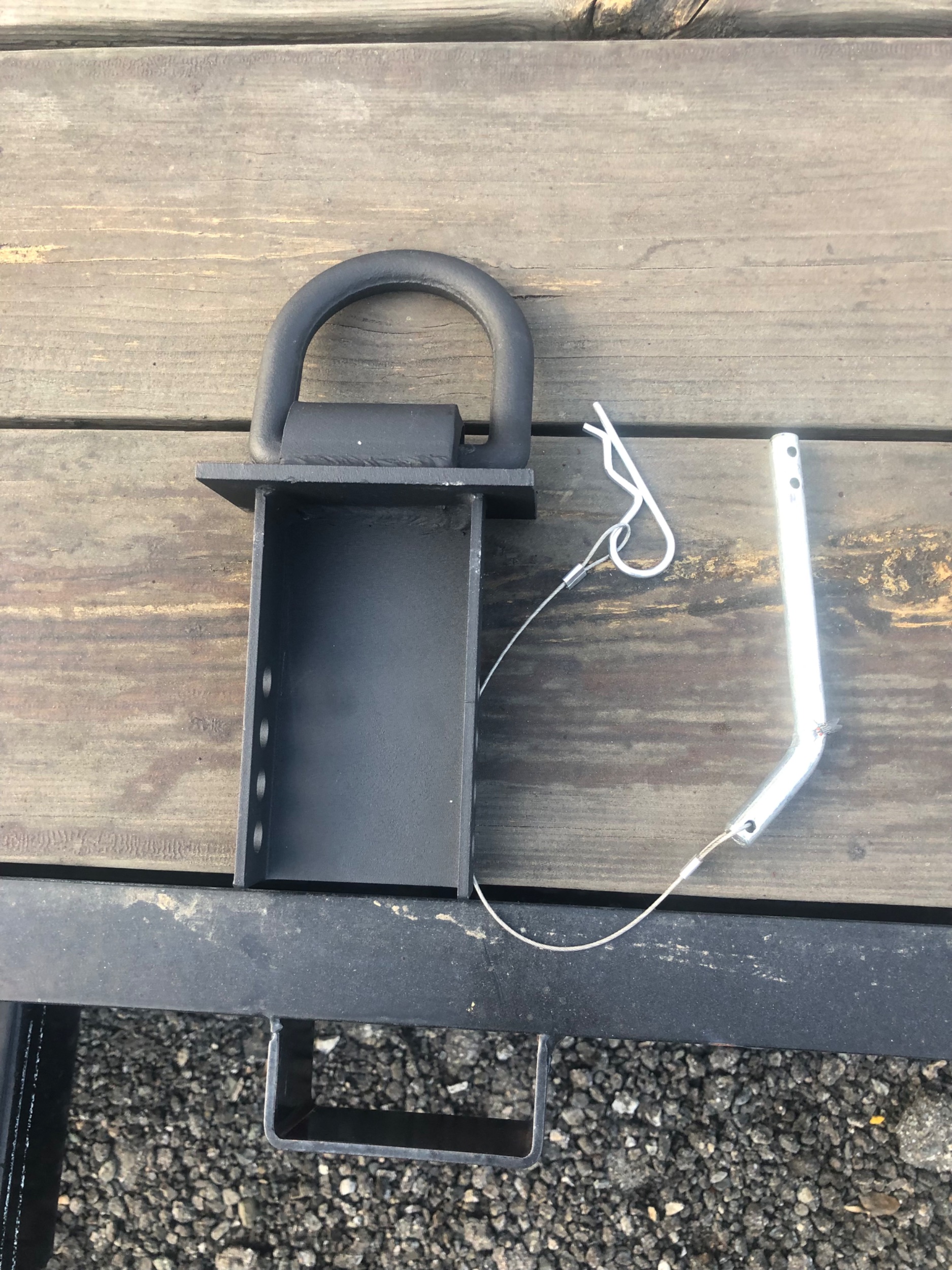

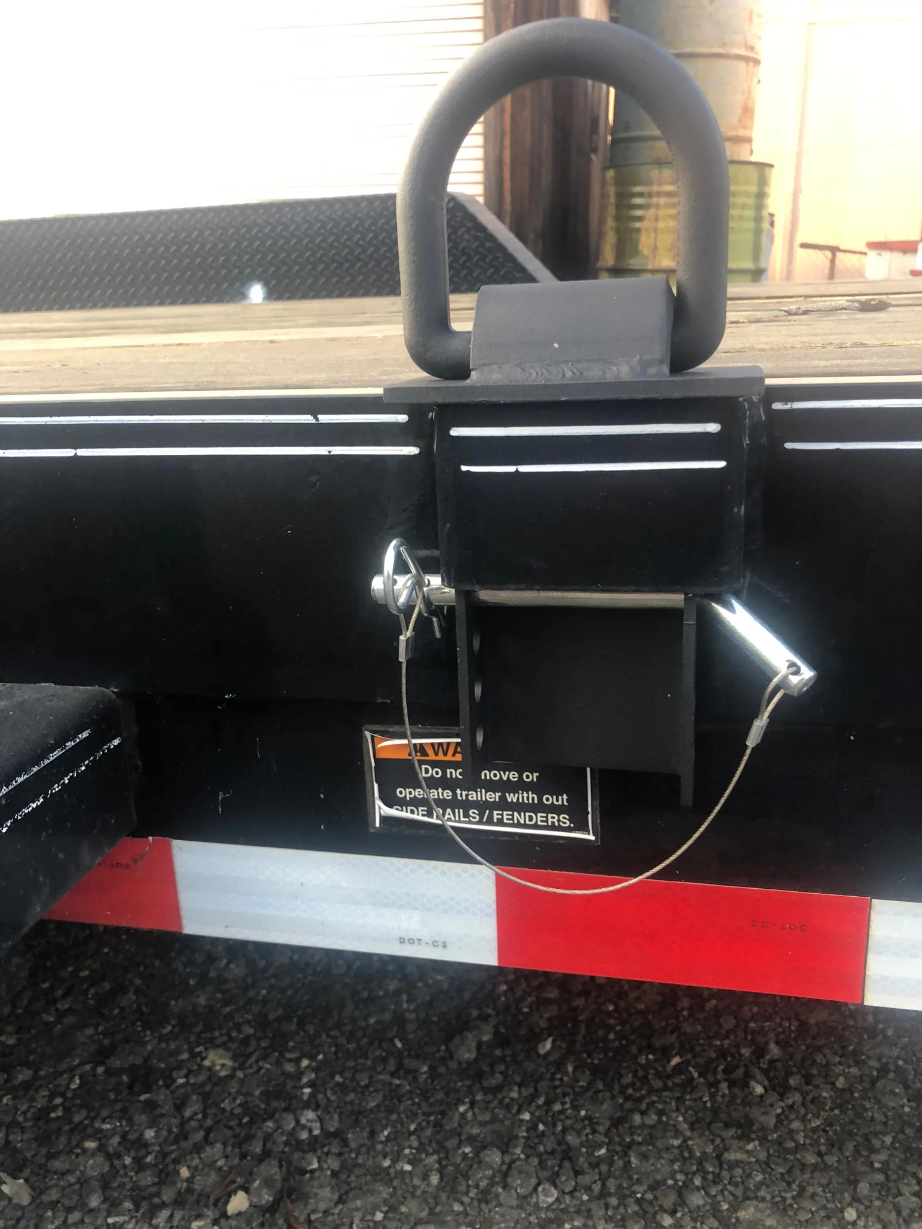

Well thanks to this post I learned about the existence of Stake Pocket D-rings. I picked up a set of 6 on Amazon for $11.70 a piece. Tractor Supply had them for $28. They seam to be well made and will give me more tie-down options on my various trailers. More money spent because of this Forum.

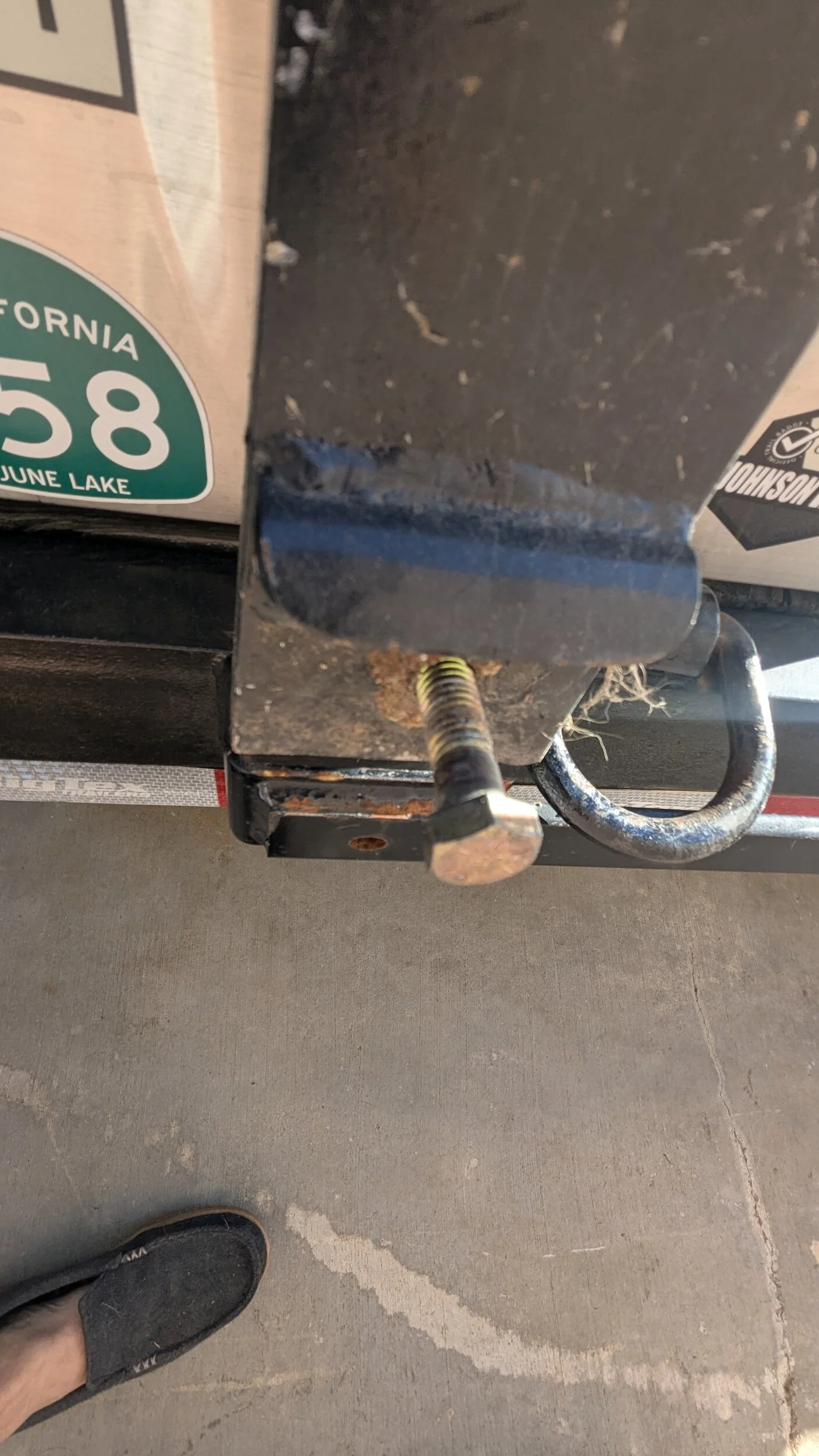

I wound up drilling a hole in the center of my stake pocket and the add-on d-ring and used a 5/16" grade 8 bolt. This will keep someone from walking off with them and the 5/16" Grade 8 bolt is stronger than the pin included.

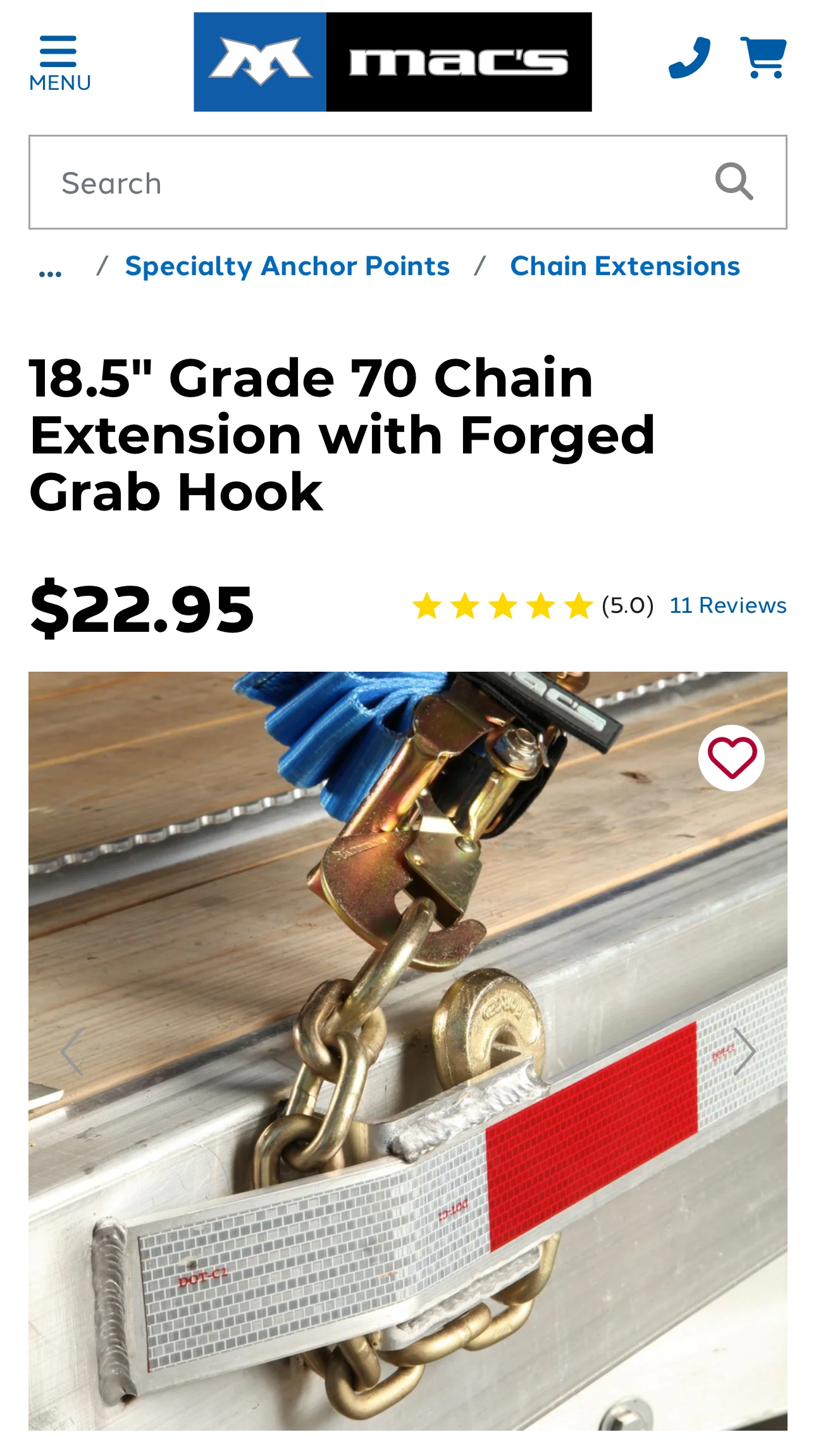

Just run the chain down through the center of the stake pocket and then secure the end the same way in the above photo. Been doing that for decades.

I should have specified that my strap setup is chain on one end, and then tire straps on the other end.

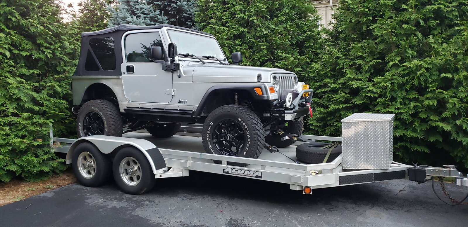

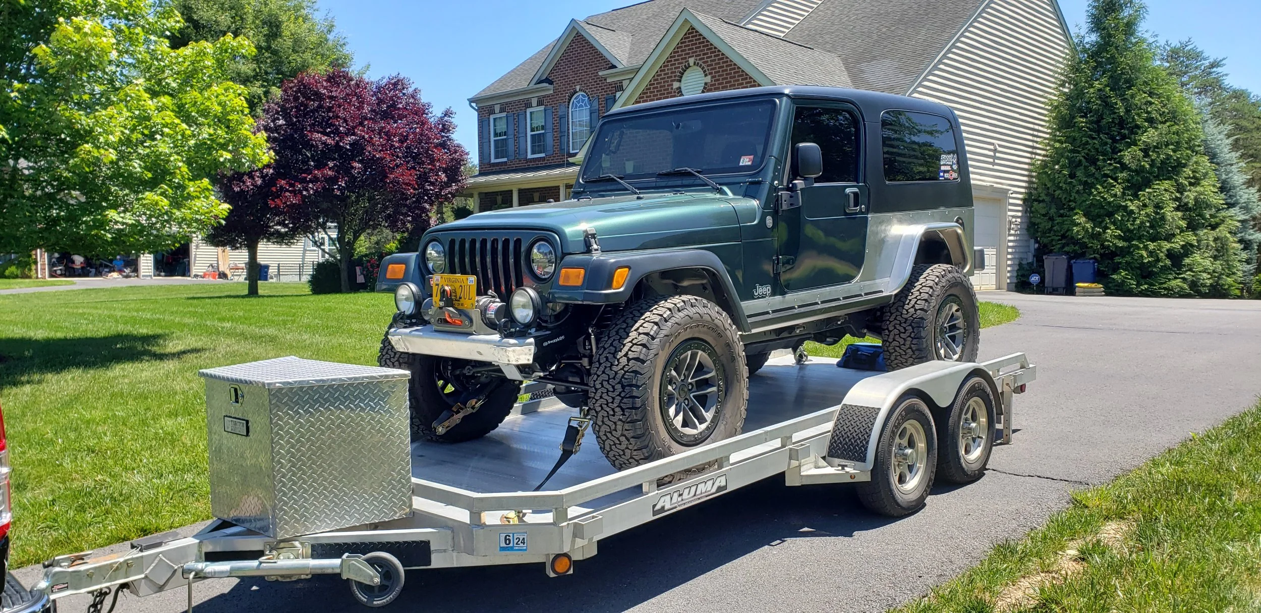

After owning a steel trailer, I bought an Aluma 7816 many years ago. It weighs in around 1100 pounds and easily pulls either my TJ or LJ. That said, it's not a trailer to buy if you abuse them. The aluminum deck is easily dented, so care has to be taken. On the plus side, my Ram 1500 easily pulls the trailer, LJ, and a bed loaded with gear, even in the mountains. The weight savings and not having to worry about rust are the biggest pros for me. Plus, this model, at 16 feet long, is incredibly easy to maneuver.
Where did you get it?

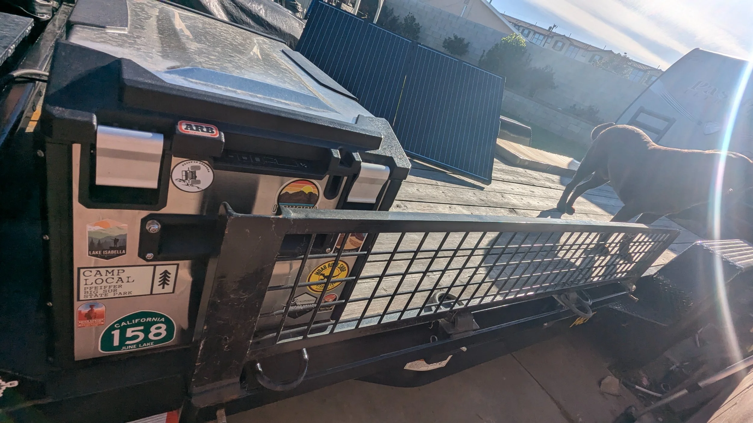

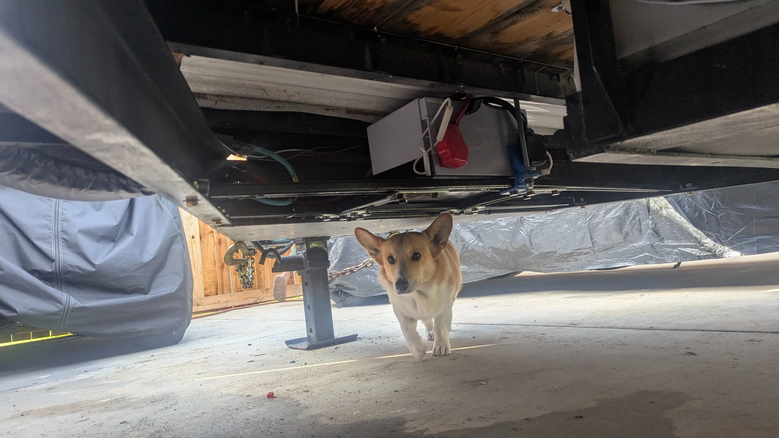

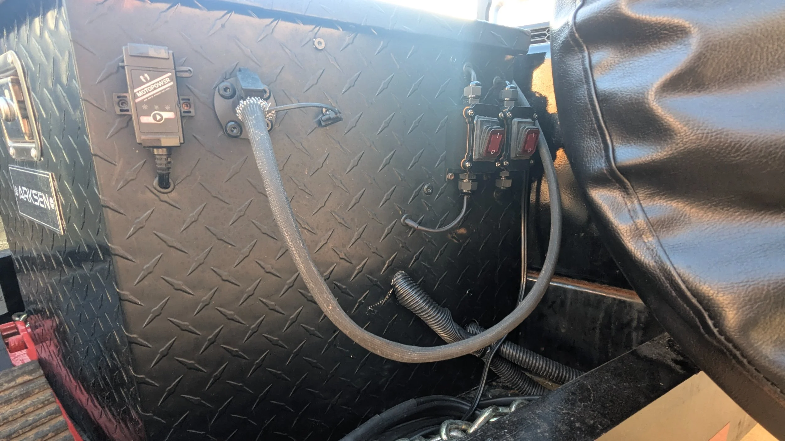

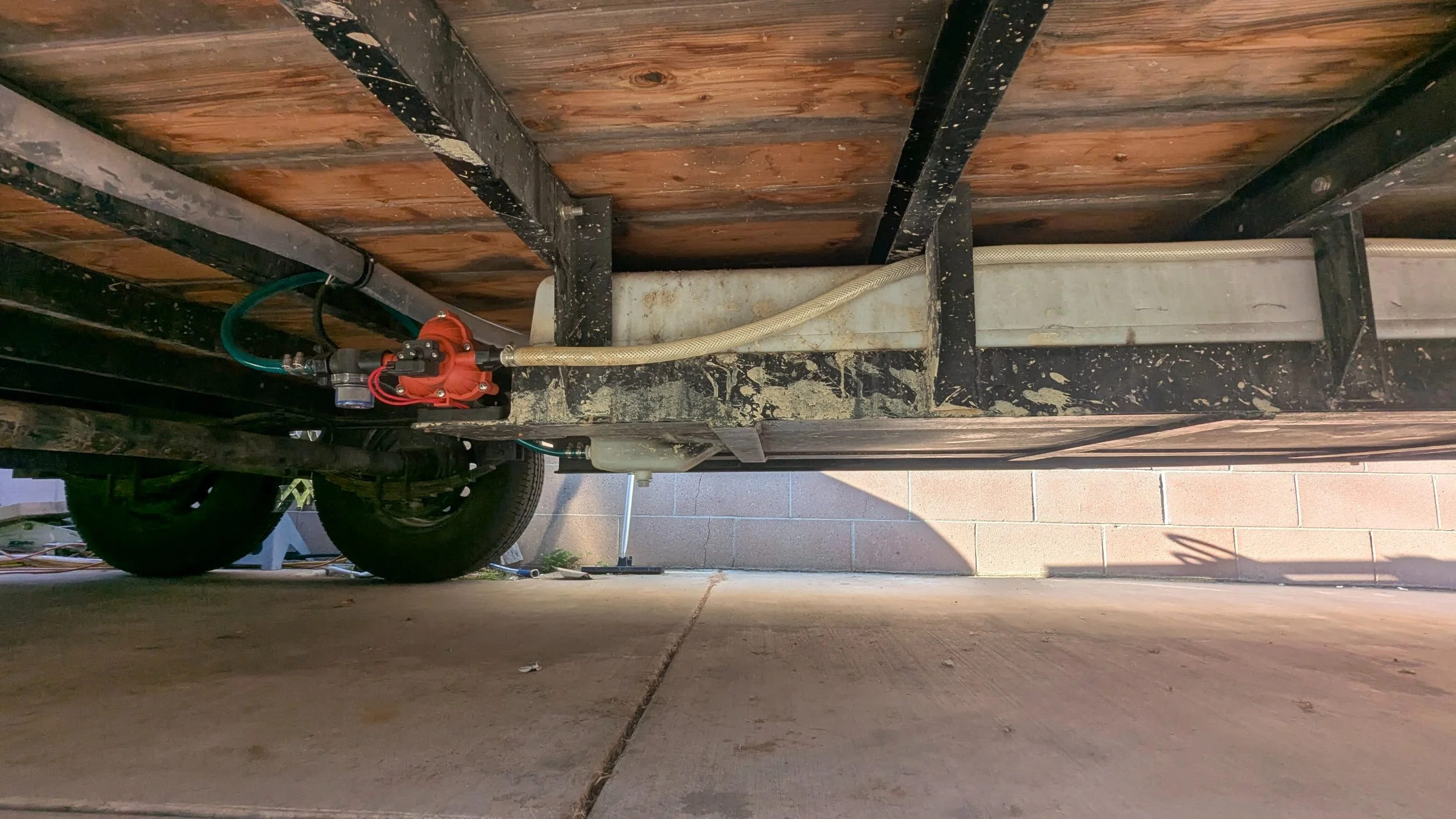

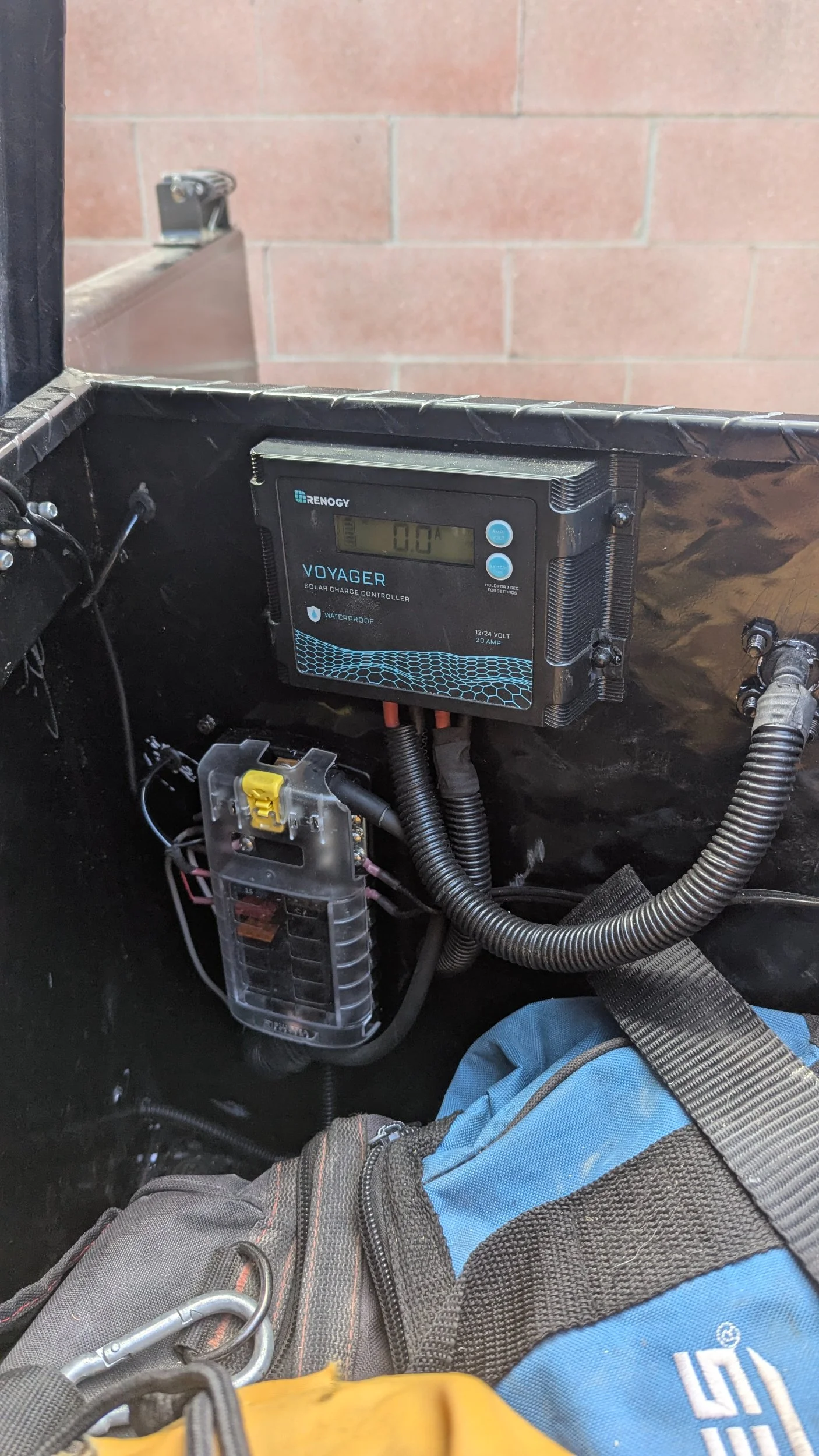

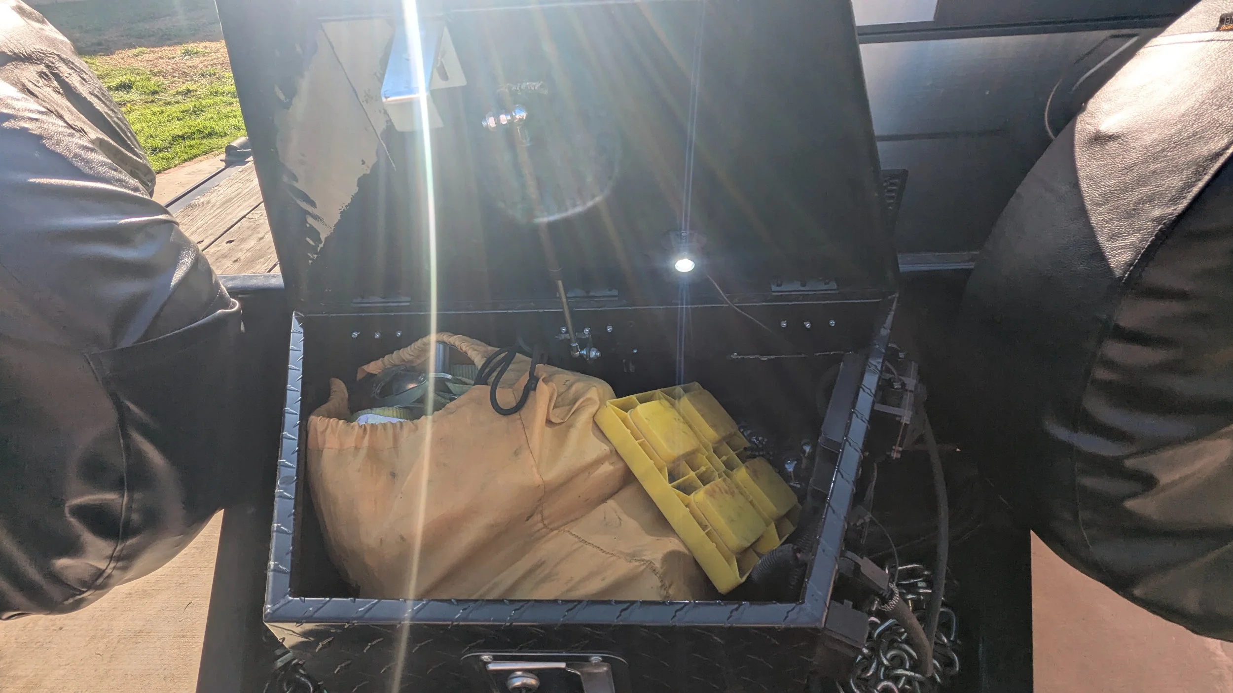

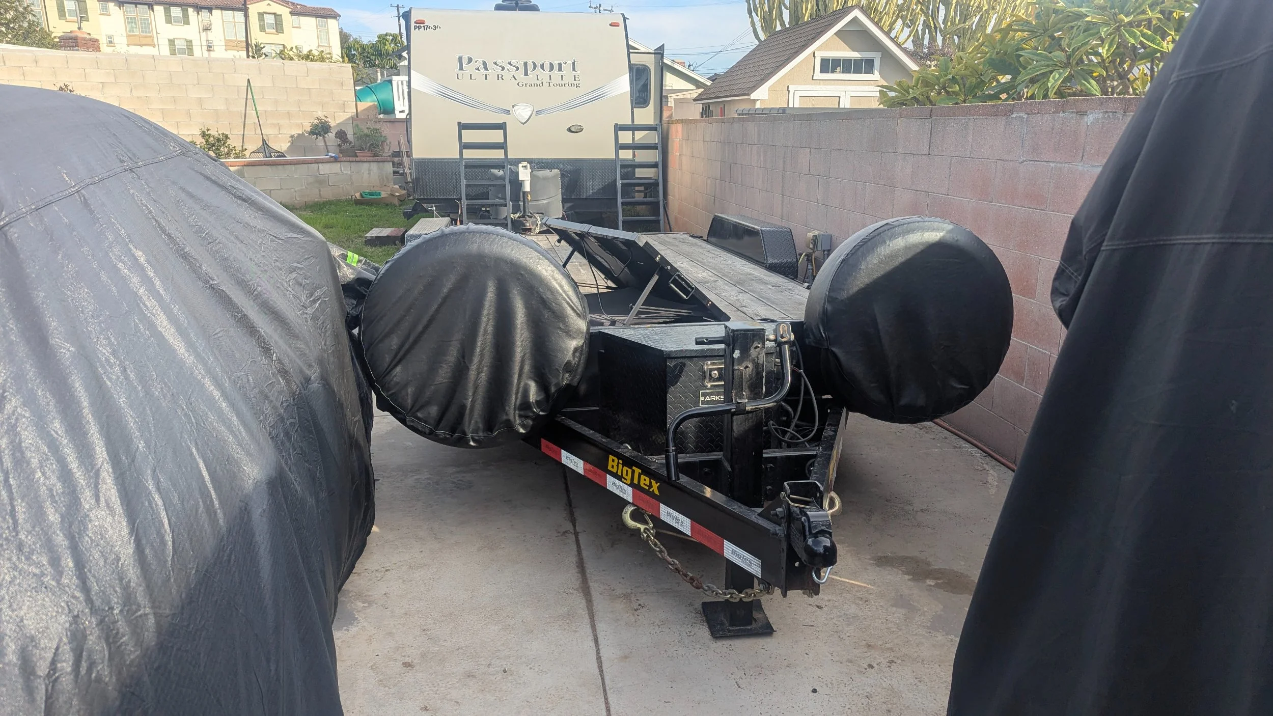

I added another spare tire to mine, put in a solar charger for the battery and changed out the water pump for one that hooks straight up to the batt. instead of running it off my truck. Wired the ARB and thew on some lights...not sure why, I'm still trying to figure out if I even want this thing. I'm taking it out this weekend.
View attachment 607099View attachment 607100View attachment 607101View attachment 607102View attachment 607103View attachment 607104View attachment 607107View attachment 607105
Big Tex makes some very nice stuff.
