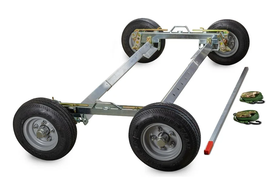

If you wanted to go as light and small as possible you could use a tow dolly and high speed dolly to get the rear tires off the road. Or use the high speed dollies front and rear and a tow bar. Theoretically, anyways. I've never seen anyone do that.

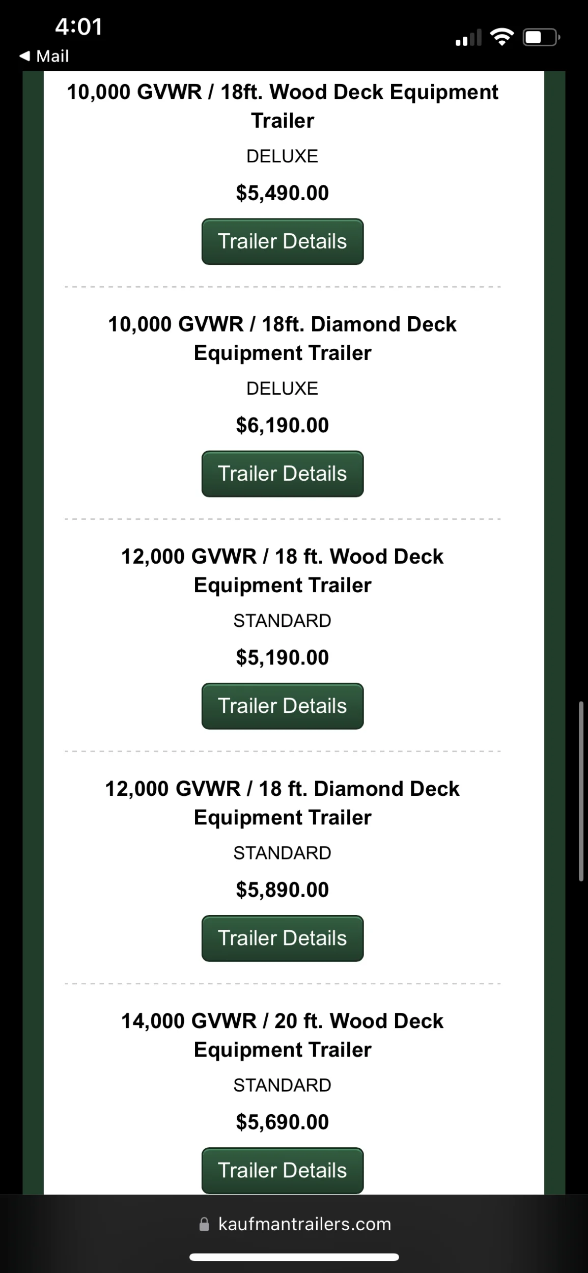

I’m going to call Kaufman tomorrow and see what’s available. I will go with an equipment trailer for the 2’ dove tail. All of their car haulers are metal and have a 4’ tail. I guess it’ll be a toss up between a 10k 18’ or a 14k 20’ equipment hauler. Have a trip planned to ivy branch at the end of the month so not sure how much customization I can get and the lead time for it.

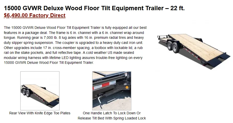

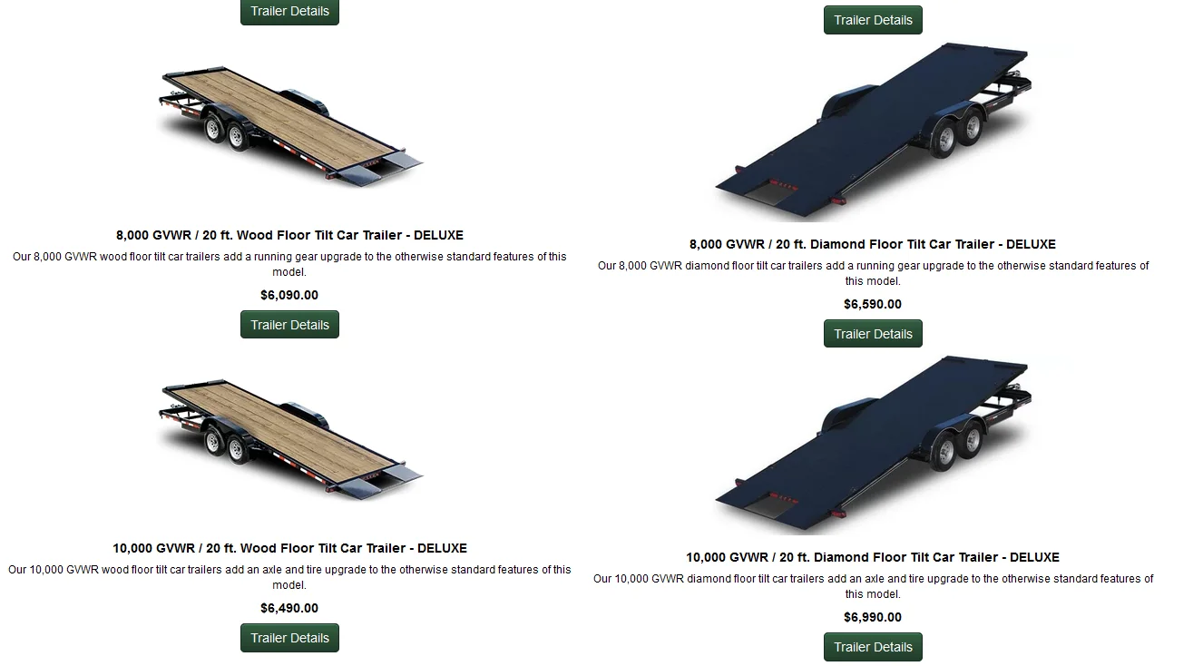

Did you look at Kaufmans tilt deck stuff? These are the ones I keep looking at, probably more the equipment one, even though it's heavier than I need, but I'm looking for one trailer to haul my lowered cars and my tractor. Jeff is right about dove tails being a barrier for low riding vehicles. Also, I highly suggest wood decking vs the steel.
https://www.kaufmantrailers.com/car-trailers/tilt-car-trailer/
https://www.kaufmantrailers.com/equ...vwr-deluxe-wood-floor-tilt-equipment-trailer/
