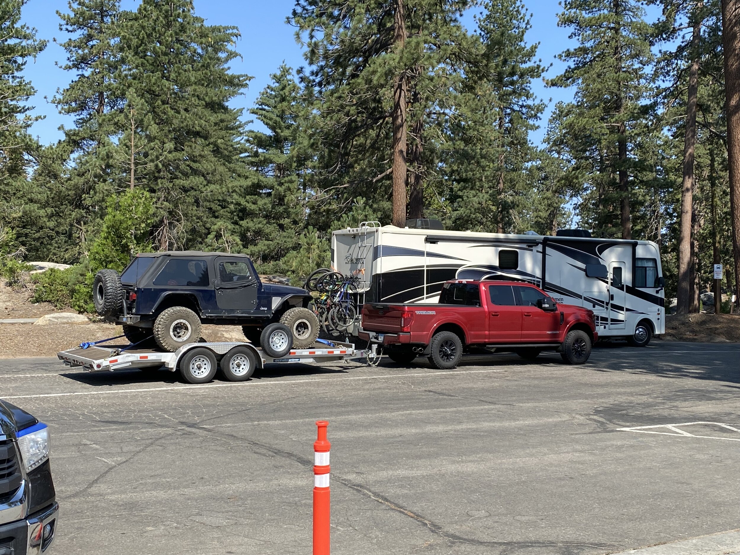

I have a 20' tilt deck trailer with carries my LJ plus a couple of motorcycles but have been considering a car dolly for pulling behind the motorhome. When I am not dry camping in the desert, the trailer becomes an issue in campsites. The car tow dolly would be much shorter to stow while not using it.
Never owned one, just trailers. Downsides to a Car Tow Dolly? Flat towing seems to cup my front tires.

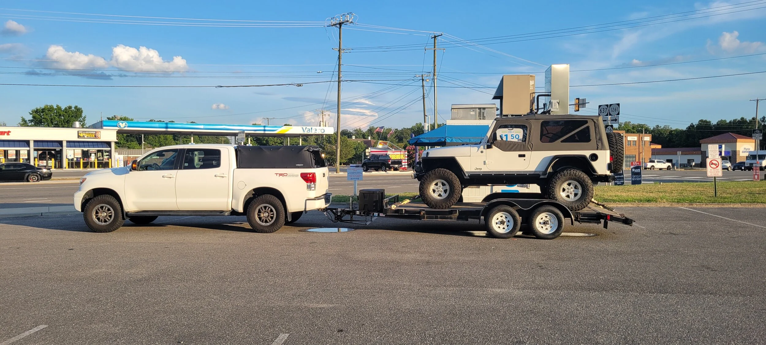

Thats a good length and it appears that even 16 footer would be ok. I have to assume you dont really need that beaver tail on the end unless you are able to skip ramps, that would be nice.
I could load the jeep with or without ramps. Took work to load my Mach 1 on there the ramps needed extensions.
