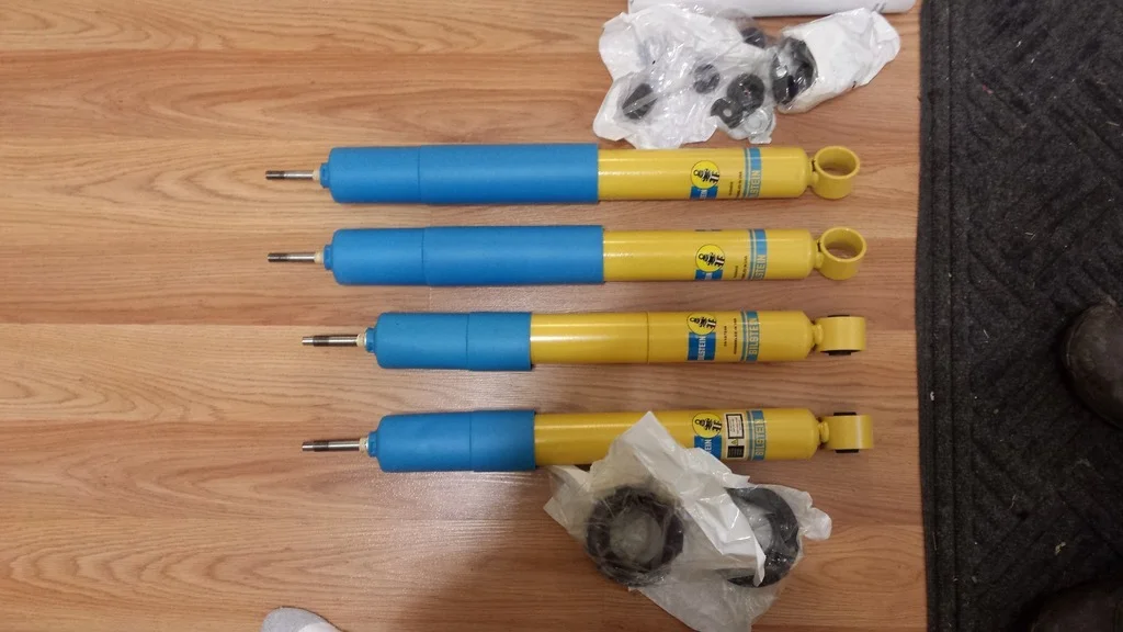

These showed up today...
It seems the rear shock installation is a royal PITA. Not looking forward to it.

So I ran into a problem. Every front strut shock sold on the market includes the two upper bushings and washers....except Bilstein 4600's. They only include a nut and expect you to reuse the factory bushings. Even the 5100's have the bushings and washers. Dealer only carries the bottom small bushing. And because every strut out there includes a bushing there are no aftermarket bushing kits available.
My bushings are trashed so I'm at a standstill till i figure this out.
Any particular reason why you chose 4600 vs. 5100? As in, can you return the 4600 for the 5100?
I prefer the 4600s for stock ride height and 5100's for lifts. I could swap em but I bought em from Kolak on Jeepforu$ so it would be more of a hassle to swap and wait another two weeks.
I found a set at the dealership. Four bushings, four washers, and two nuts: $75. No thanks.
