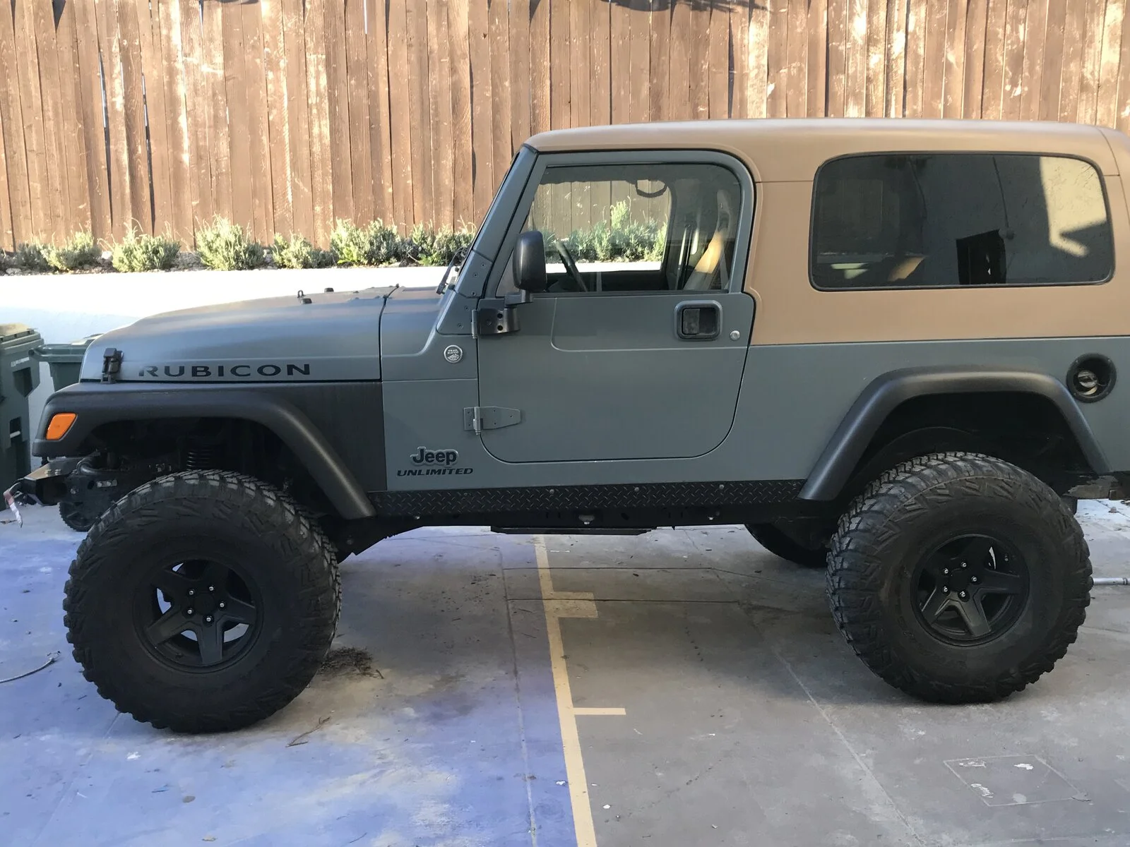

Misplaced the only set of keys to my 06 LJR. Finished the build two weeks ago but unfortunately the keys were in my other vehicle when it was burglarized two weeks ago in a community far from my residence.
Need help figuring out how to replace. Can the dealership use my VIN as a reference to cut a new set of keys and program the SKIM? Worried that these rigs are so old that I may have to replace the PCM and have non-SKIM keys made. Appreciate any insight.
