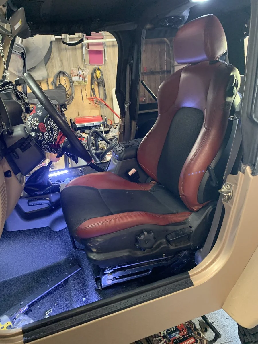

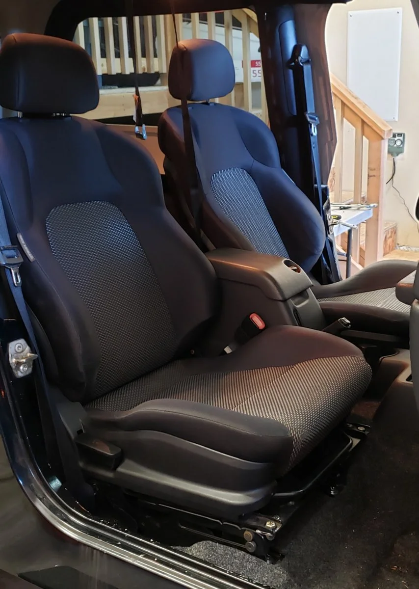

Stock seats break my ass. I looked for options for a while and finally settled on seats from a Hyundai Tiburon. They are very comfortable, supportive and have adjustable height and lumbar support. It was easy to make some quick brackets for the Jeeps seat tracks. There are some other good aftermarket seats but I didn't want to spend a lot of money. My total cost was around $175.
Plus they look really good.

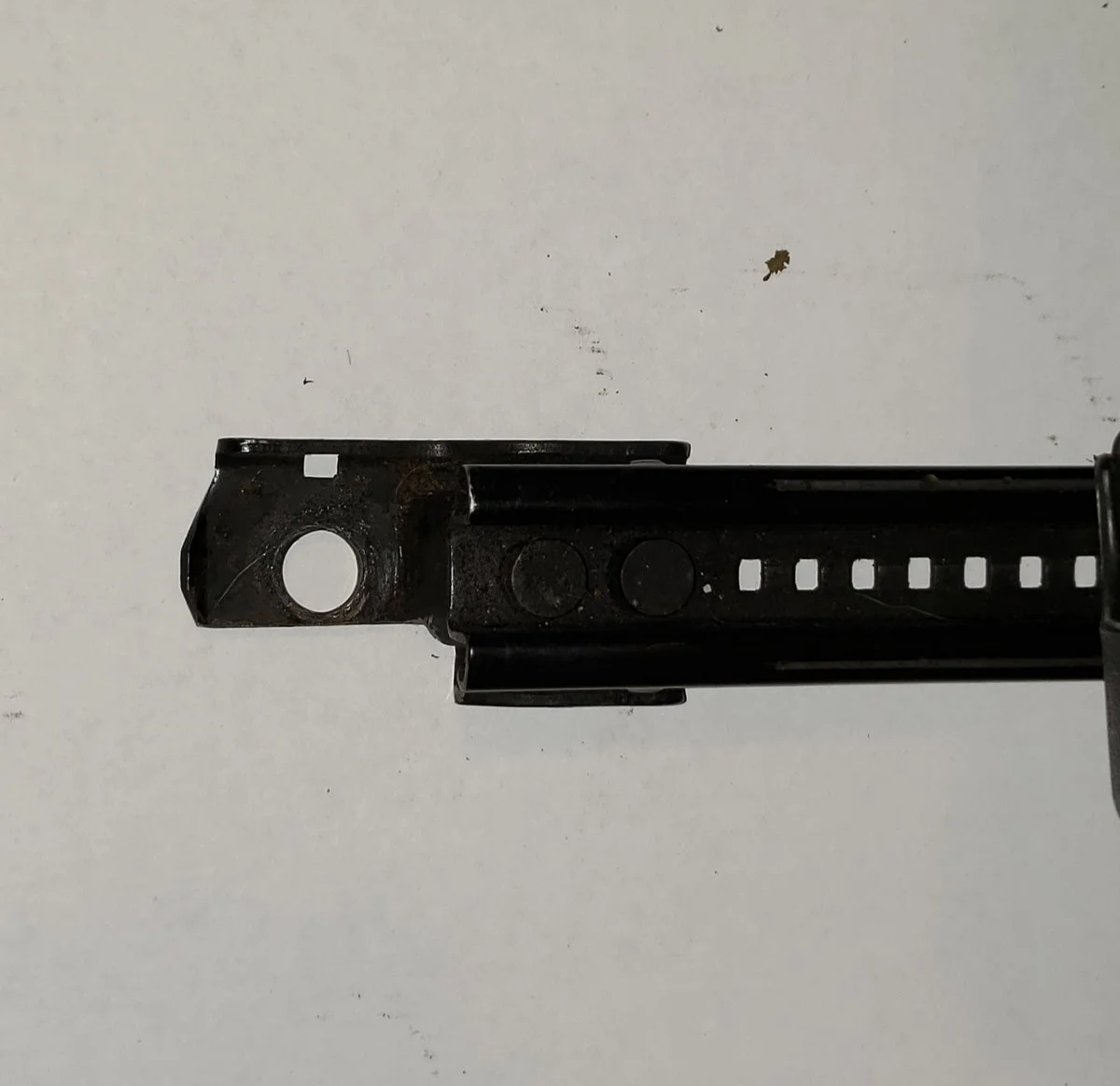

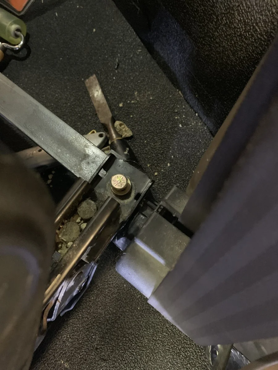

I’m running into an issue where the tib seat slides are hitting my seatbelt roll. Do you happen to remember how you got around this?
I had the same issue. I had to cut a notch in the seat rail to clear the seat belt mechanism on the passengers side. The drivers side has a different mechanism and didn't require any extra clearance. It did take a little trail and error to find the sweet spot. Unfortunately the mechanisms are not interchangeable. The other option is a set of seat risers. I put a set I had lying around in but it felt a little high for me.

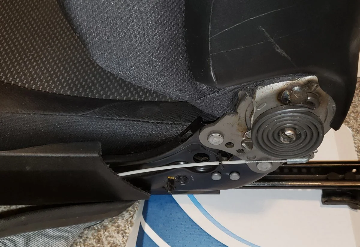

You will also need to cut off some of the plastic cover on the inside of the tiburon seats to clear the center console. Once bolted in you'll never notice.

I’ve actually already begun the same thing. The op messaged back pretty quickly but I’d already begun brainstorming 🤔
I took a look at look @PC06 update to the original thread. I like the solution they came up with. I guess I'm just to quick to look for an excuse to use a power tool.😁

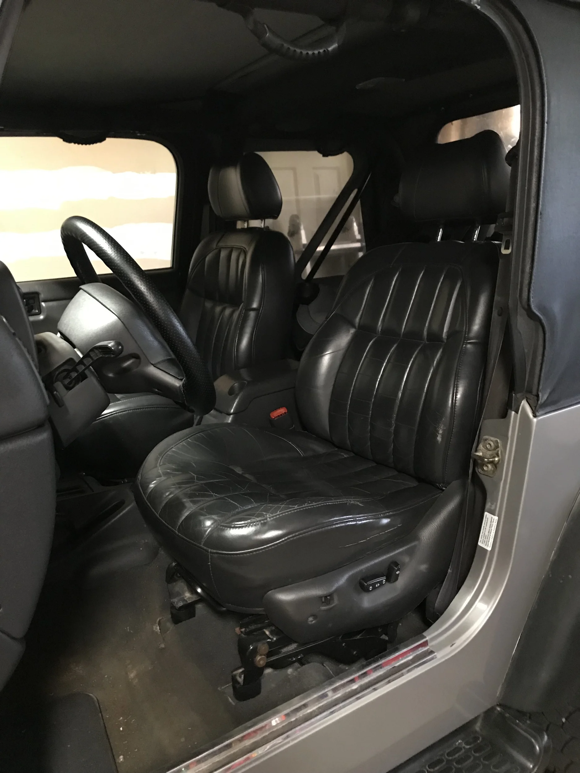

Nothing more comfy than heated, power, leather WJ seats. I used to fall asleep while driving when I had them. Now I do that in my Tesla. 🤫
Wow, those are like a mile off the floor... I love where the factory 2005 seats sit, I'm looking straight out the middle of the windshield. In my JT, the seats sit too high, and I look out at about the 3/4 up mark... would be level with where the TJ rearview mounts to the windshield...
My Army buddy had a WJ I had to sell for him while he was deployed to Trashcanistan.
I do remember those seats being some of the most coosh I had ever sat in, which surprised the hell outta me
