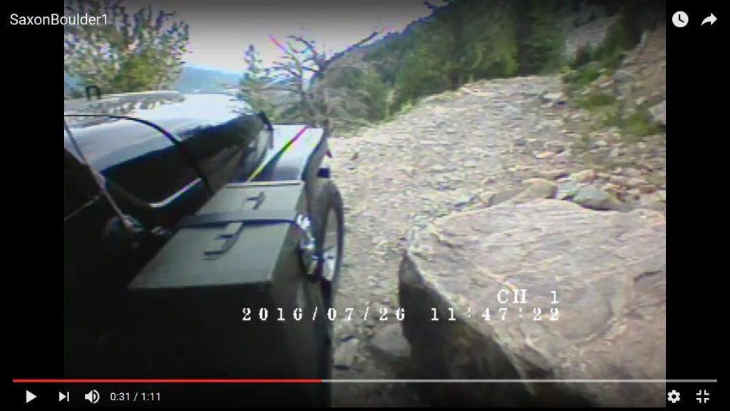

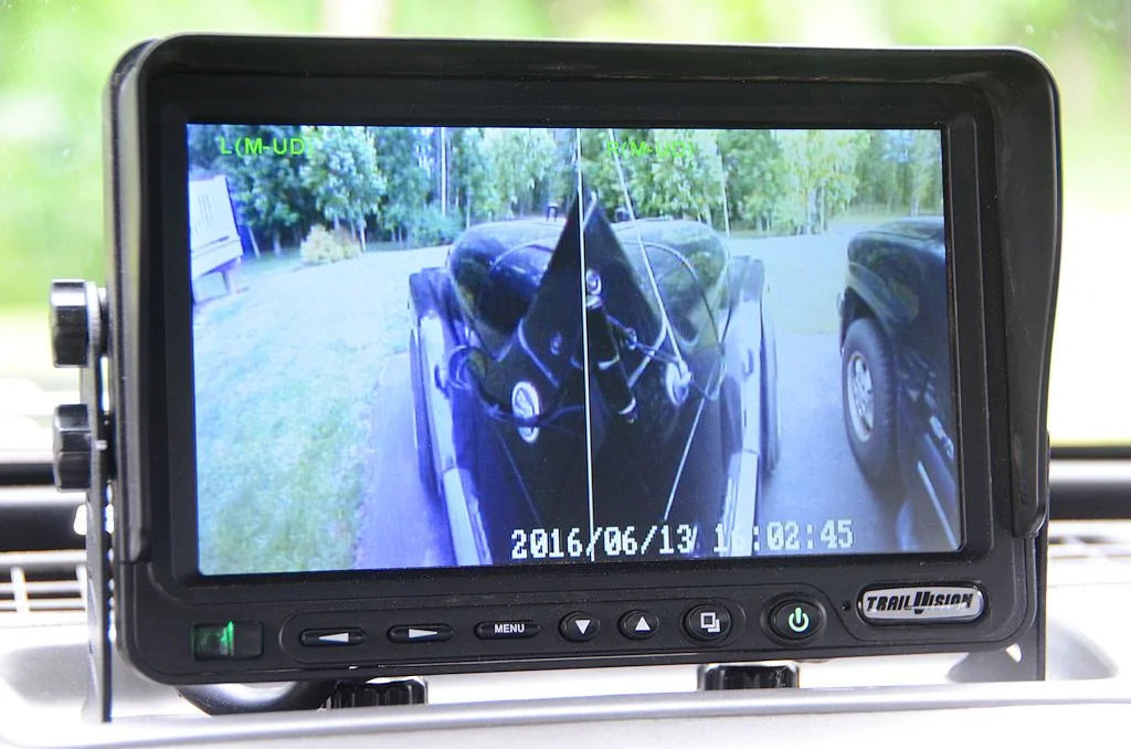

An example: back in 2016 I got interested in having cameras on my Jeep to help my navigate around trail obstacles. I looked at the systems on the market at the time and they were crazy expensive, especially considering how reasonably priced the basic components were (kind of like this project). So I sourced the components, some from a company that did camera systems for busses and RVs and built a system I called TrailVision. It supported 4 cameras, split screen viewing and had DVR capabilities. It really worked well and helped a lot on tight trails. Retrofit Offroad picked it up and brought it to market at about half the price of the systems that were on the market at the time.
It especially worked well when you were between a rock and a hard place (or perhaps a high place, in this next photo there's a steep drop-off a few inches off the driver's side tires).
I still use that system on tight trails in the LJ, I did turn out to be very useful.

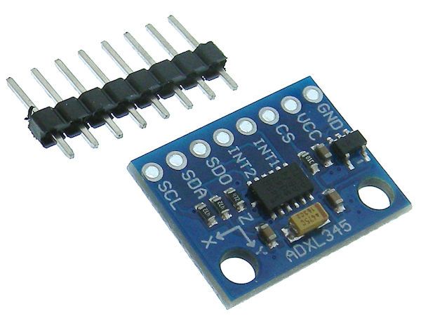

I was near a Micro Center the other day so I stopped in to pick up some additional components for further microprocessor experiments, but their stock was so disorganized I didn't buy anything. Afterwards I placed an order with one of my favorite electronics places and among the things I ordered was a 3-axis Gravity/Acceleration Sensor.
It's a less than $3 part and it can tell the microprocessor about its angular orientation in three dimensions, and it can also report on how fast the orientation is changing. There are several interesting things I could do with this.
1. With different air bags (see below for more about types of air bags), it could be used to automatically level the Jeep. I should say "automatically level the Jeep to some degree" because sometimes we get our Jeeps in crazy orientations on the trail that no air bags expand far enough to compensate for, but within the limits of airbag travel the Jeep could be leveled. And by also reading the acceleration of the change, the microprocessor could determine how fast the Jeep was changing attitude and perhaps could adjust the speed of leveling accordingly.
2. As a first test, I'll prototype a simple inclinometer, which with an appropriate display, could show you the current angles of the Jeep and perhaps let you know when you're too far off-camber for your particular Jeep to remain stable. How about a warning light or sound when you get close to the off-camber angle you've set as a danger level?

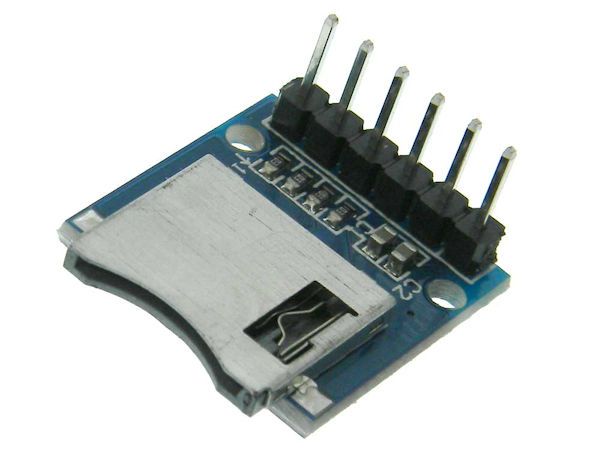

I also ordered a MicroSD card R/W module (a $1.95 component), so as a second phase of the inclinometer prototype maybe I'll log the angles and vertical acceleration of the Jeep on the trail so the data can be reviewed later if desired. It's way bigger than real life in this photo (as is the photo above):

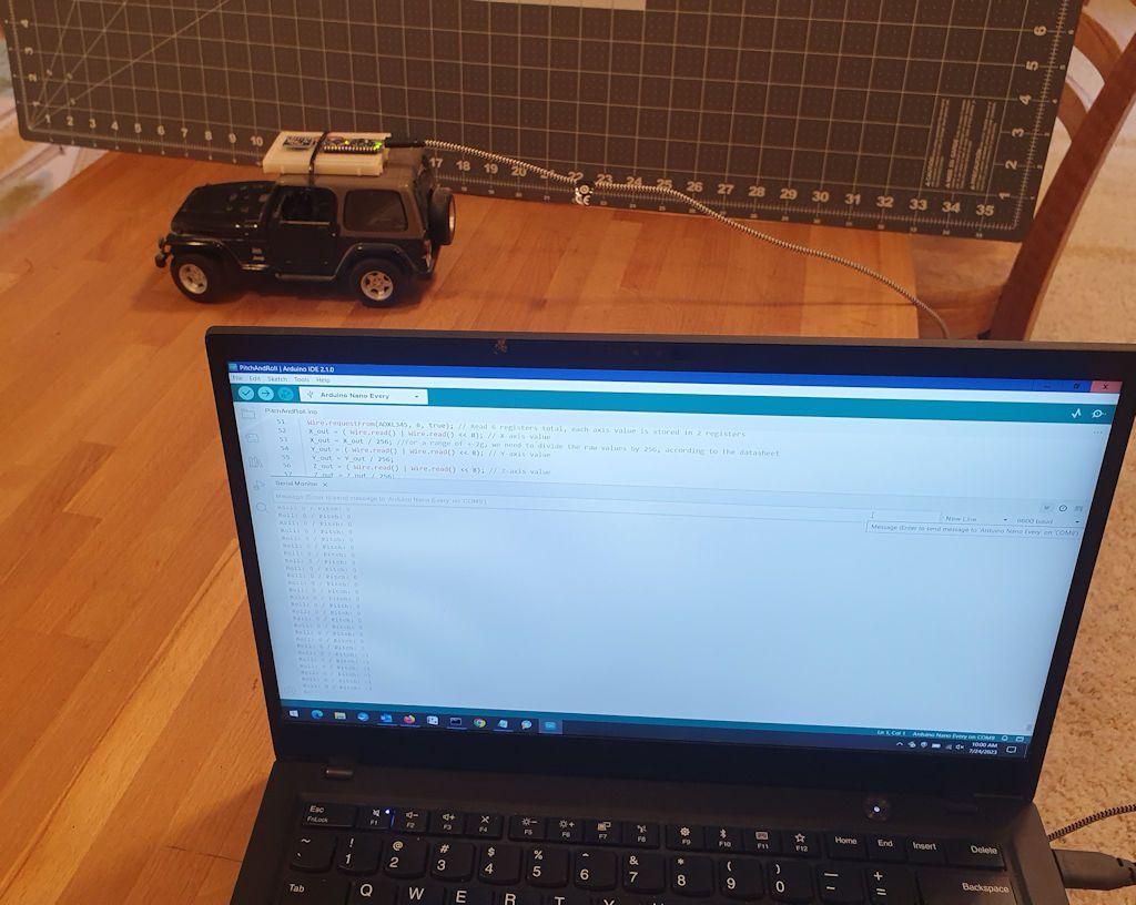

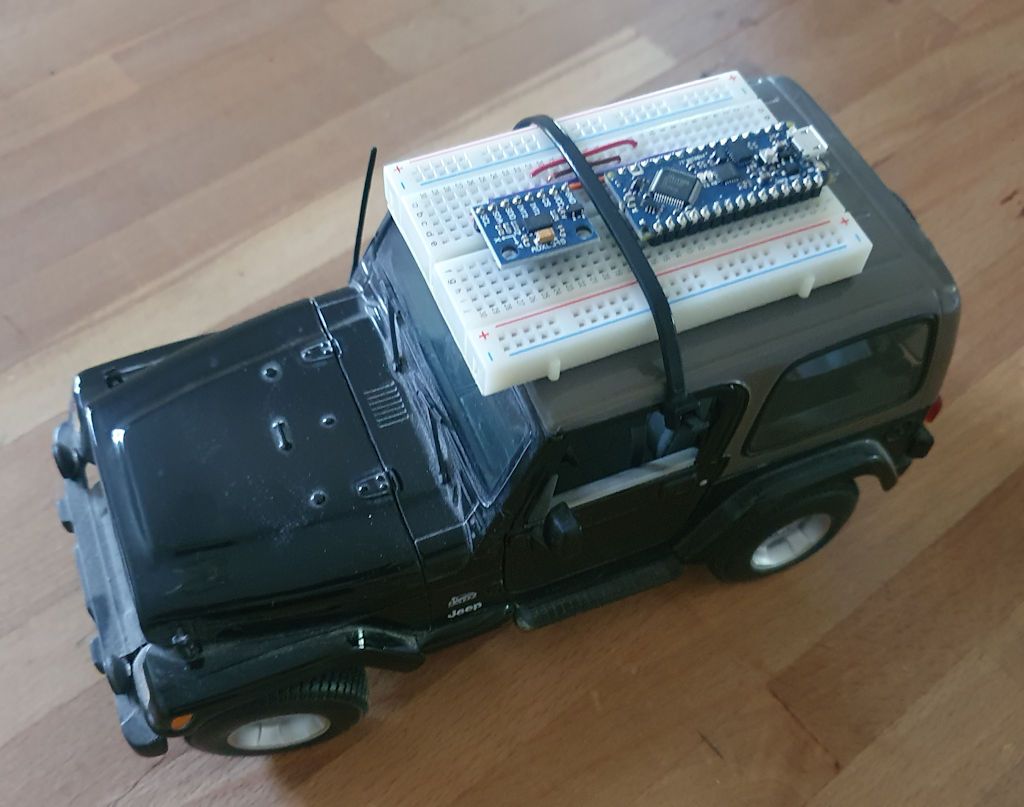

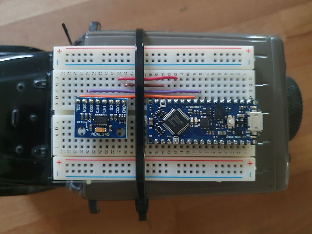

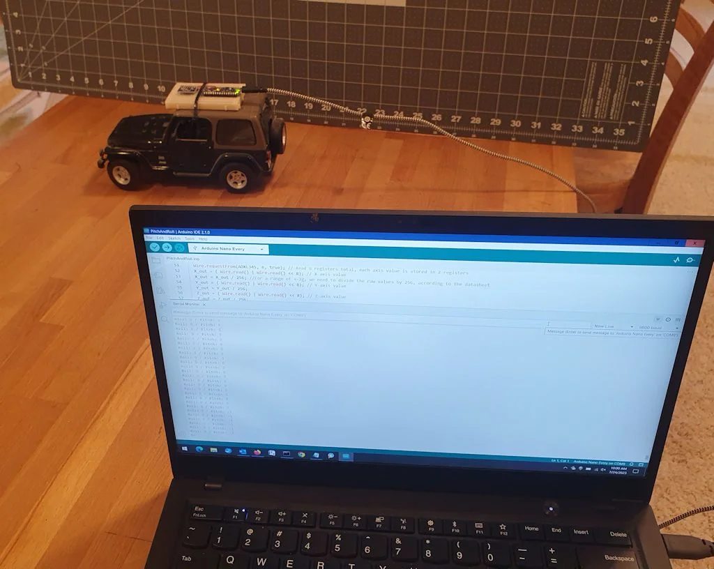

The next microprocessor experiment: pitch & roll detection. There are several applications for this - the simplest of which is a dash display that shows the current angles of pitch and roll of the Jeep. Maybe with some warnings when the Jeep gets far enough off-camber to be dangerous. Another application would be self-leveling air springs which would keep the Jeep as level as possible on the trail.
The components for this experiment are very simple - a 3-axis accelerometer and a microprocessor. The accelerometer was less than $3. I'm using a smaller microprocessor this time - last time I used an Arduino UNO and this time I'm using a Adruino Nano Every. The Nano has almost the same capabilities as the UNO in a much smaller package. There are only 4 wires required to connect the two. I zip-tied the electronics on top of a 1:18 scale Jeep:
To dislay the current pitch and roll, for this test I'm just going to use the computer screen - the Adruino will communicate with the computer through a USB connection (which also supplies the power to the electronics) and the data will be scrolled in a window on the Arduino development environment on the computer.
Check it out in action in this next video. I've tried to focus the camera on the scrolling display on the screen to show the pitch and roll readings, so please excuse the poor focus on the model Jeep, the important part of the video is the serial output on the computer showing the pitch and roll. The next step is to replace the computer monitor with a small display. You might need to view this on a computer display, not sure the output on my laptop screen will be easily visible on a smart phone.
