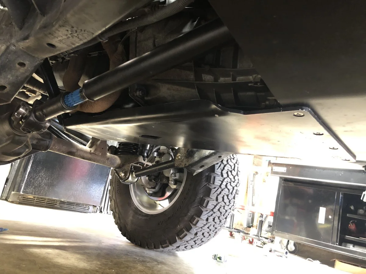

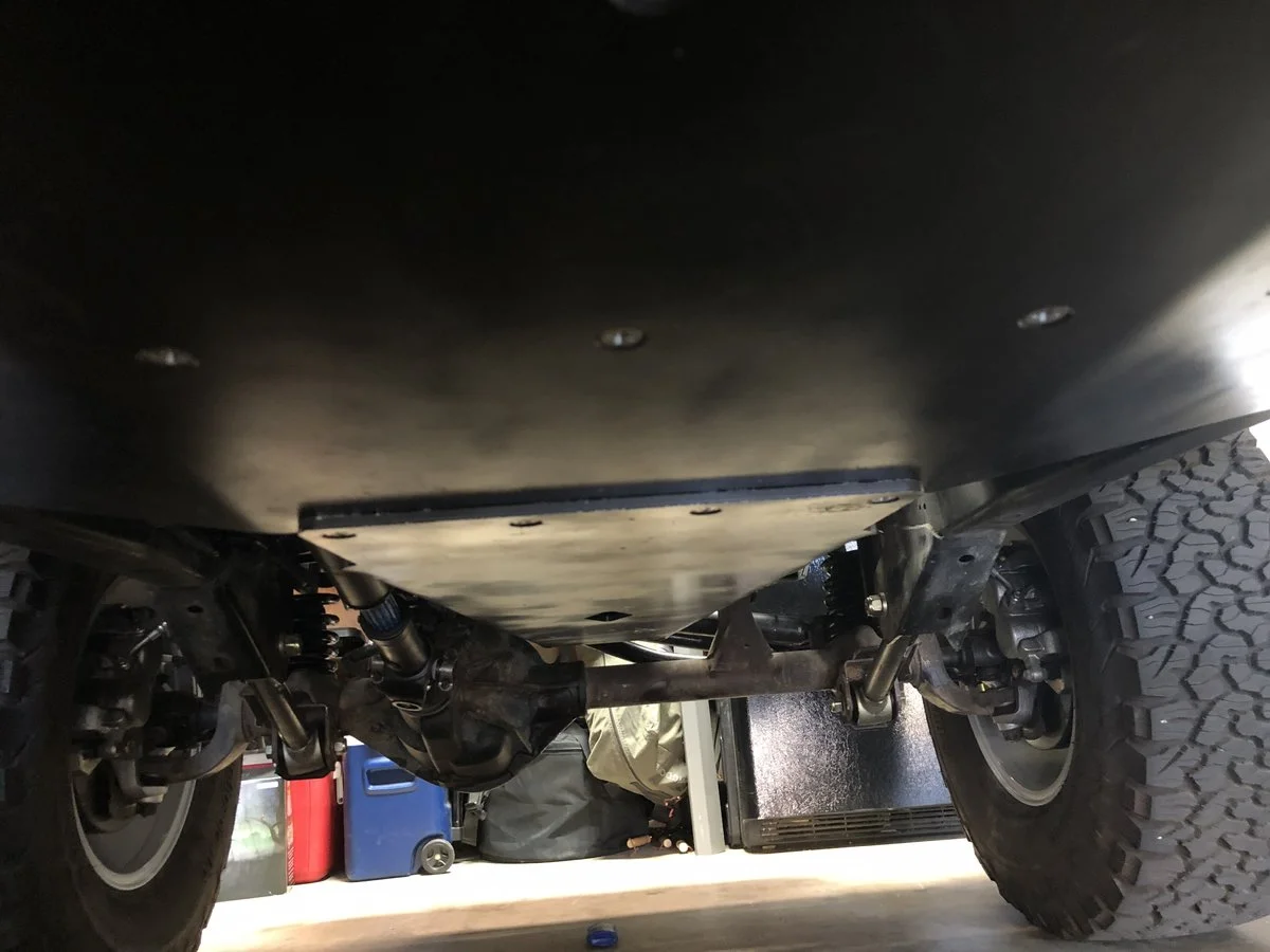

Had a productive afternoon. Oil change, engine skid installed and chose a location for one of two fire extinguishers I am going to install. I am going to install the second one within reach of the driver seat. I really like these Element fire extinguishers they weigh almost nothing, so are not near as scary as having a regular one in the vehicle.

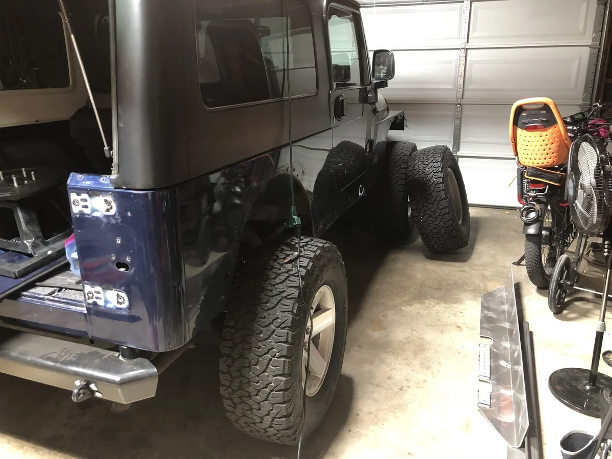

i painted the stock flares since I had them off and the OEM paint was a wreck. We will see how it turns out or if I need to buy new ones.

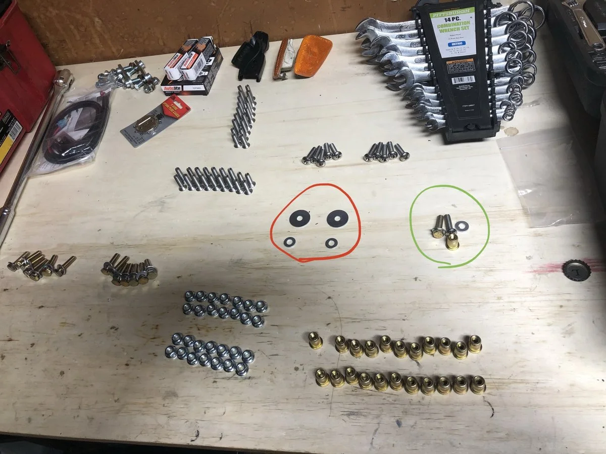

This is all the bolts and rivnuts laid out for the Sliders, I believe the green circled parts are extra and am not sure what the ones in red are for?
The OEM rivnuts were not going to allow the slider to sit flat. I tried drilling them out and it was being quite the challenge so I went ahead and just used a hammer to lightly tap them down flat. That seemed to work well.
I actually just drilled mine out today in prep for the same sliders which should be here on Wednesday. I'll definitely double check the hardware after reading this. Luckily my rivnuts drilled out ok (I used 1/4" bit), one tried to spin but i just put painters tape over the whole ordeal and grabbed it with come channel locks, seemed to work out. did end up doing some pounding as the tub sheet metal was pulled out for some reason. Glad to see you didn't have any irreversible dilemma's.
I might have to drill a couple out for the backer plate Iā€™ll have to look at it. It was the ones that I could not reach the back I was worried about. Didnā€™t want it to fall into the tub at rattle for eternity.
