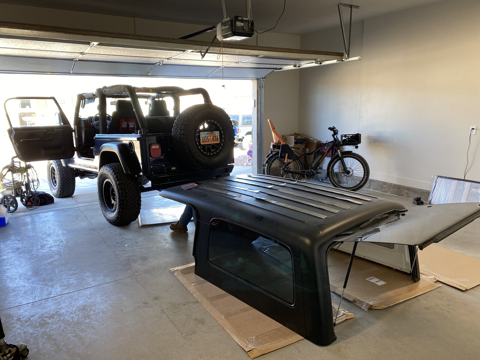

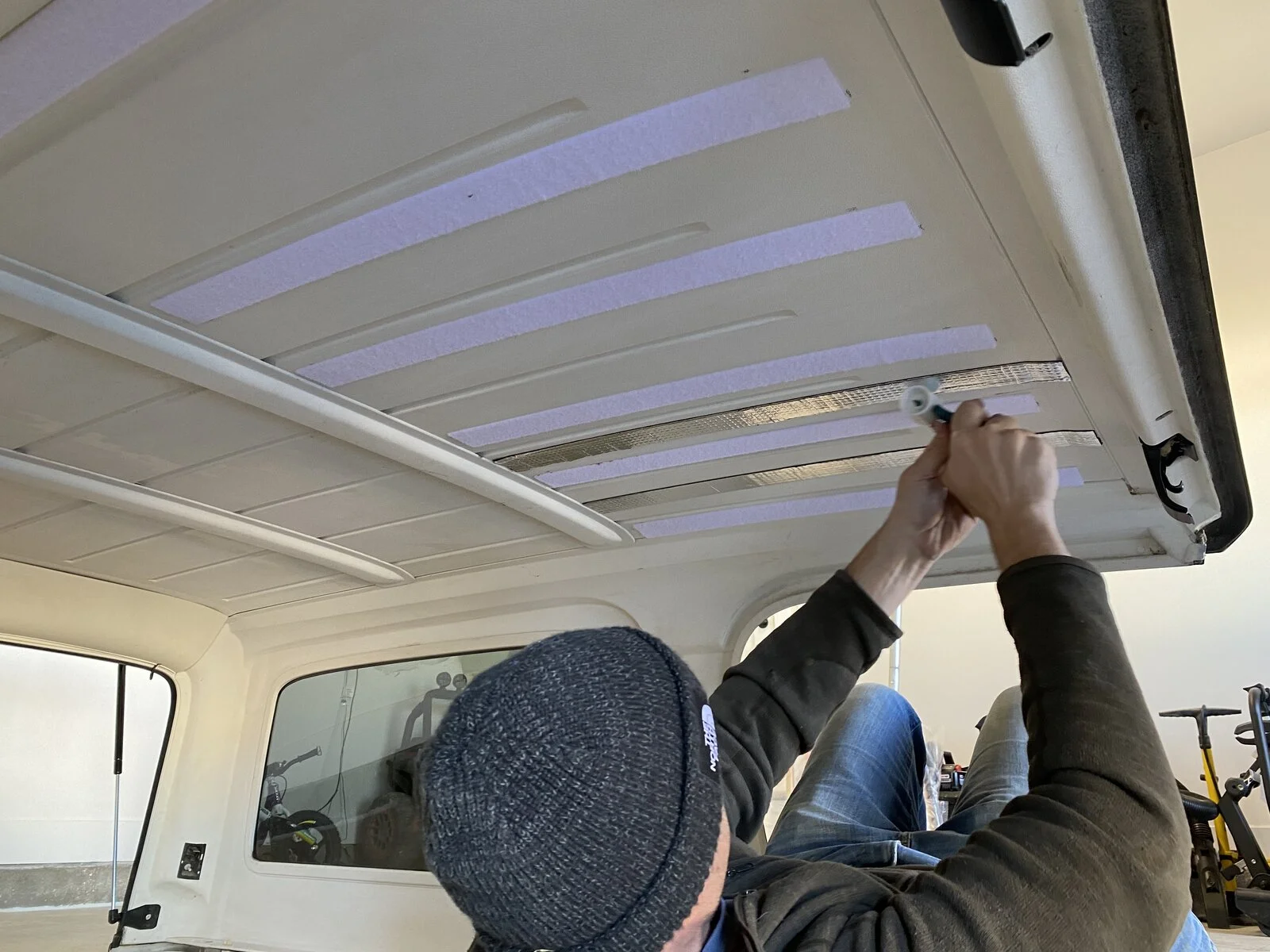

If the TJs top is anything like the JL's I vote for removing the hard top first. The sound assassin strips, and the velcro I believe, requires you to sand the top a bit to get it to stick better. It created a ton of dust.
@Midnight LJR listen to this man! You have to take the top off abd lightly sand. Have a shop vac nearby for sure.

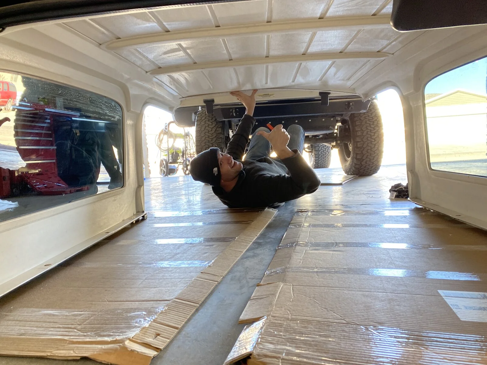

So since I am getting the liner for the top I decided I would go ahead and add a little to the body of the Jeep.
I won’t be doing a 100% cover job, probably not even close since I don’t want to make it so the floorboards cannot get wet without a bunch of rust concerns. Just going to add some to the transmission tunnel and other obvious areas. Don’t want to add a ton of weight but figure it will be fun to do a few areas and cut back on some echo and vibration noise.

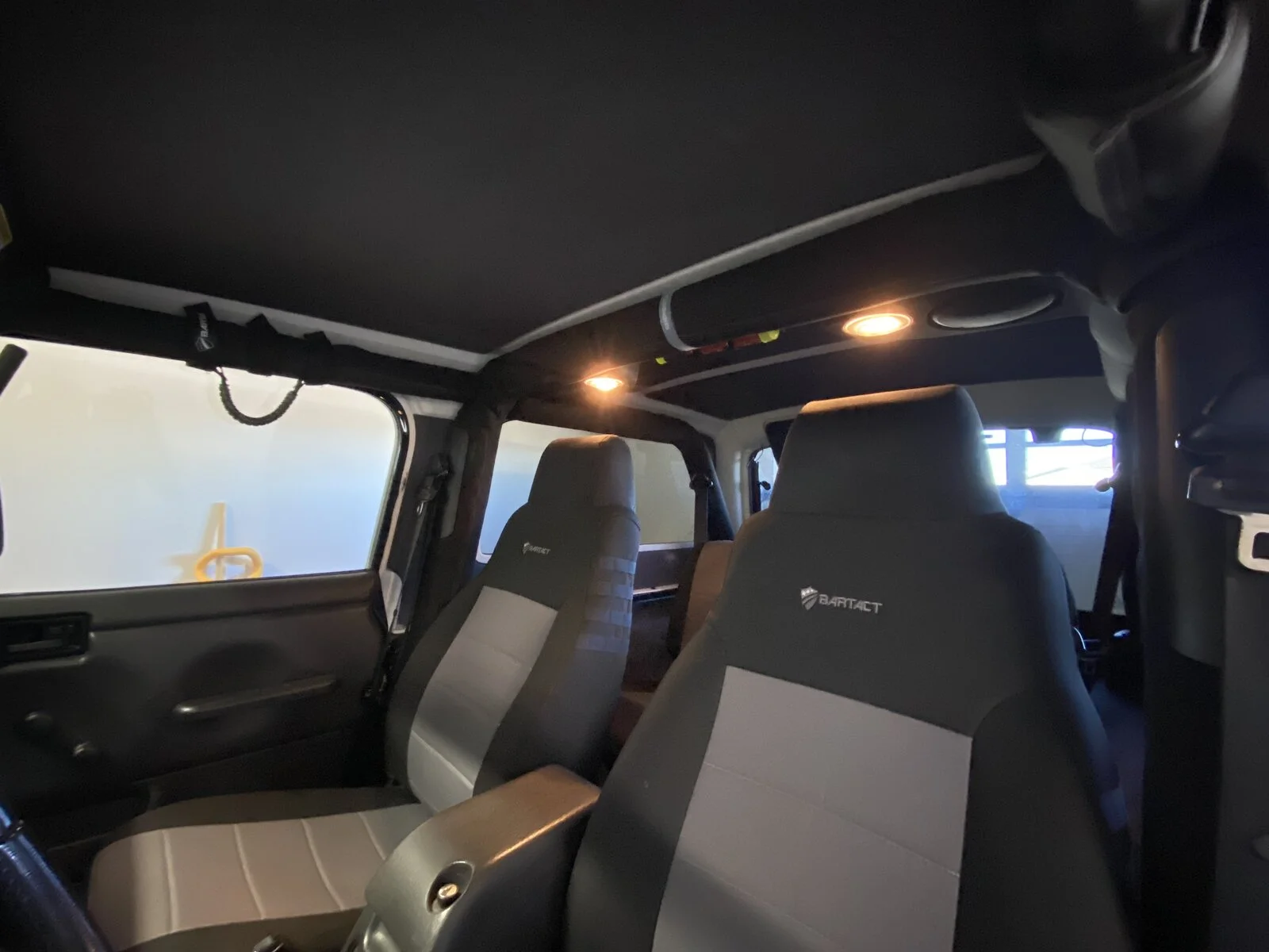

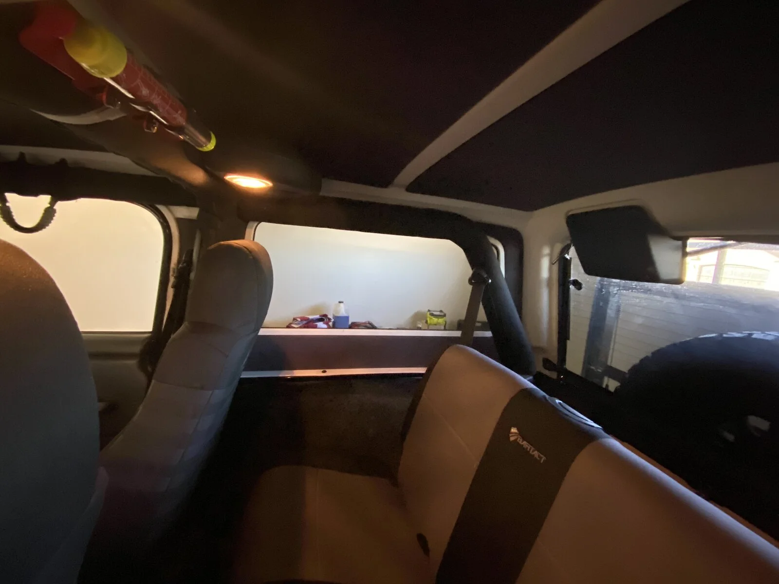

Installed HotHead Headliners today. Turns out @Alex01 even makes out of state house calls!
Have not got a chance to take it on the freeway and see if it does anything for noise. But it sure looks fancy.
