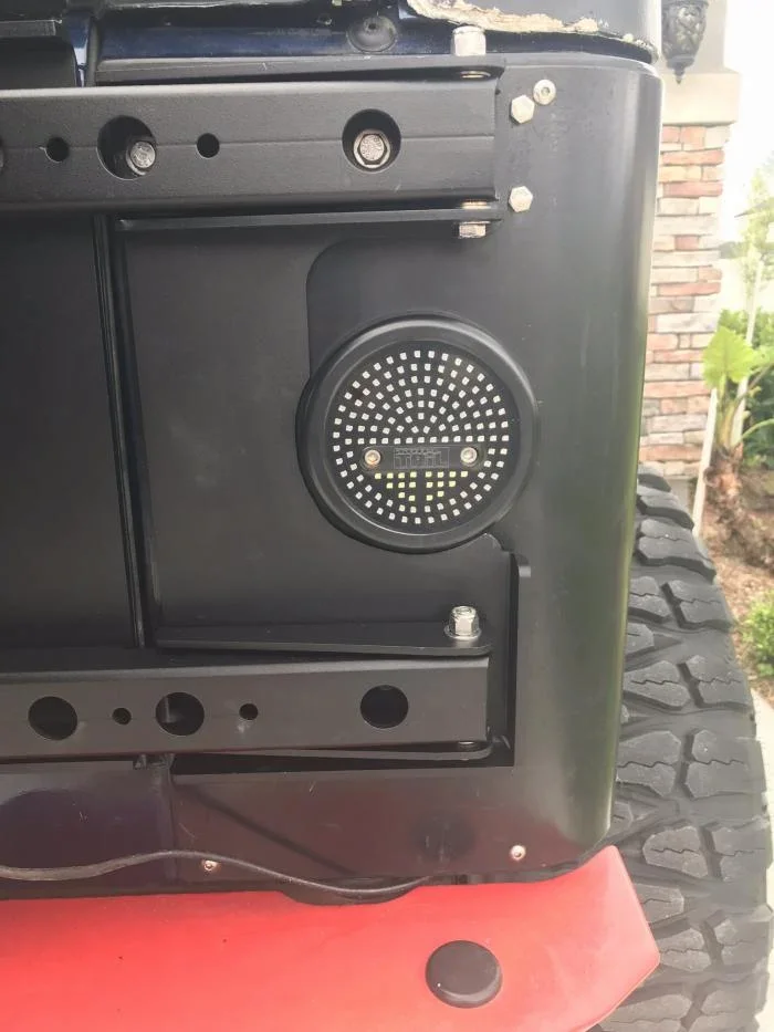

What are your thoughts removing some of the metal on the tub bracket to fit my round taillights?

Here are the lights I am running, not my Jeep, just the same lights.

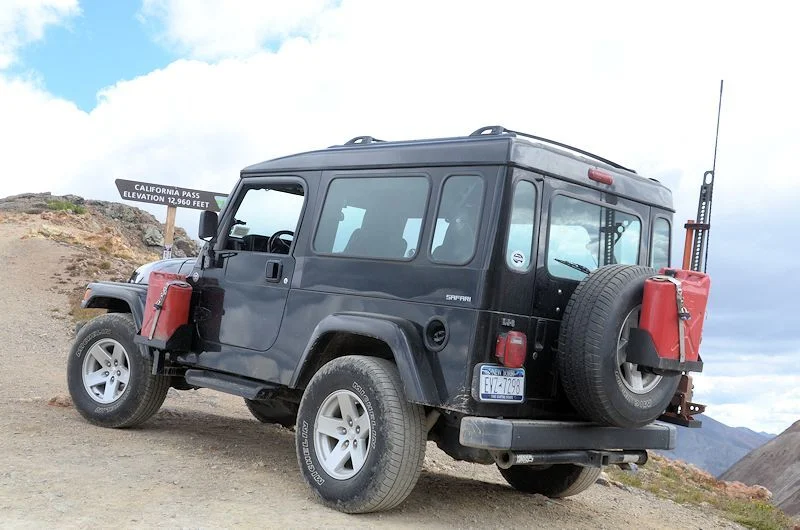

I believe both MORryde and Gr8Tops recommend it for up to 35" tires.
For daily driving I carry about 85 lbs. on mine (spare plus Safari Cab barn door upper), and on the trail I often carry a HiLift and/or a 5-gallon jerry can...

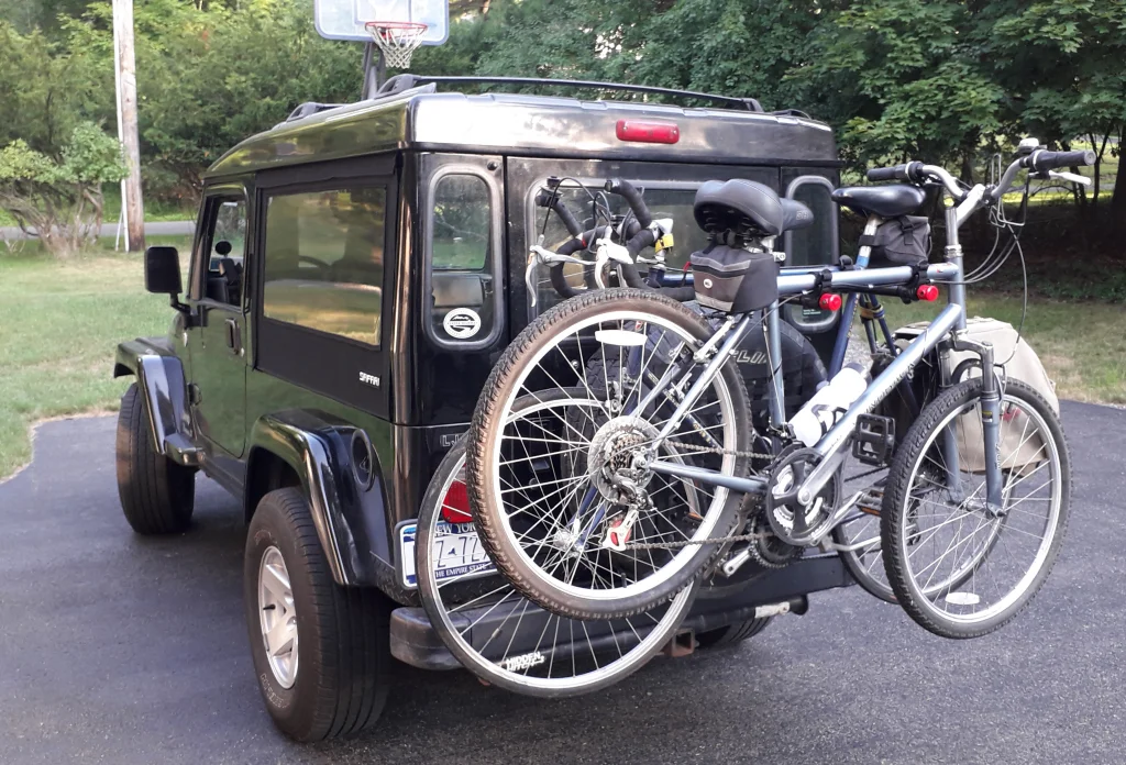

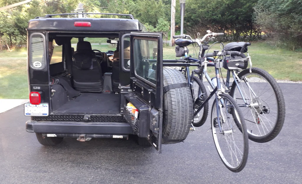

And often on the road I carry two bicycles on a prototype Exogate Cargo System bike rack...
