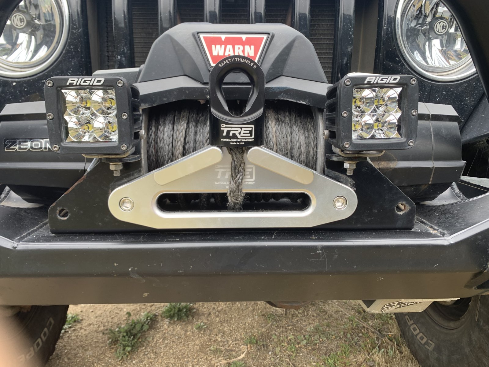

I also rec'd in the mail and installed the TRE safety thimble and hawse fairlead today:
for the last several years all I have had was the winch line and soft shackle attached to the winch guard of the bumper. Safety first they say, thus the change. While I was at it, I un-spooled my winch line, cleaned it and the drum and spooled it back nice and neat up a slight incline for tension. I also ditched the heavy shackles since I have really only used soft shackles for the last bunch of years. Lastly, I removed my Hi-Lift jack and replaced with a bottle jack I had in my shop. Just need to fab up some kind of mount for it.

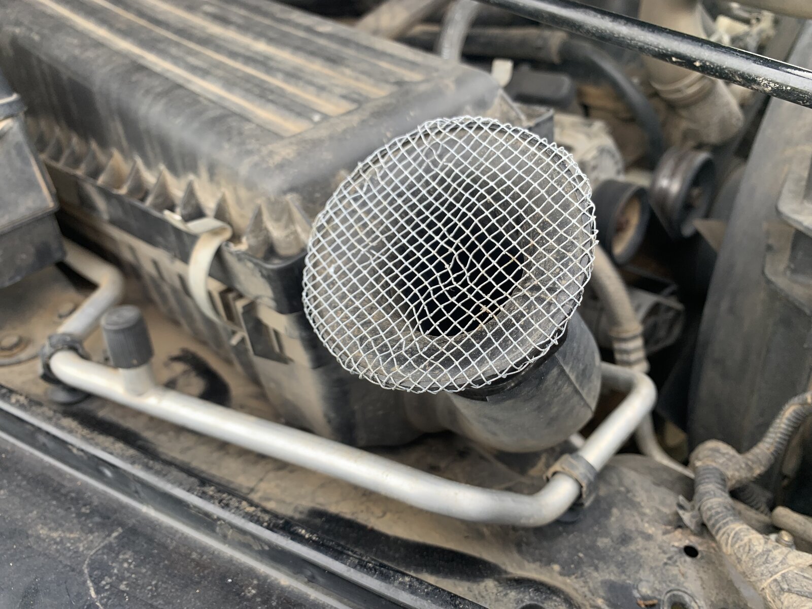

I am in the process of prepping my Jeep for summertime wheeling, re-greasing johnny joints, suspension parts, u-joints, replacing fan belt, oil and filter change, and a few other maintenance type items. The one problem I have is I don't have a garage and my vehicles are parked outside with all the critters running around, especially the mice. When replacing my Rubicon's air filter, I noticed the damn mice crawled in through the horn, chewed up the underside of the air filter and began nesting. Fortunately, I caught it early, and they haven't gotten to any wiring harnesses that I can see. My solution for the air filter is this:
...just a piece of 1/8th" hardware cloth I had lying around. My question to any of you who are in the same predicament is what have you used successfully to combat mice invading your vehicles? and we do have a couple cats roaming the property (apparently they are lazy cats)...

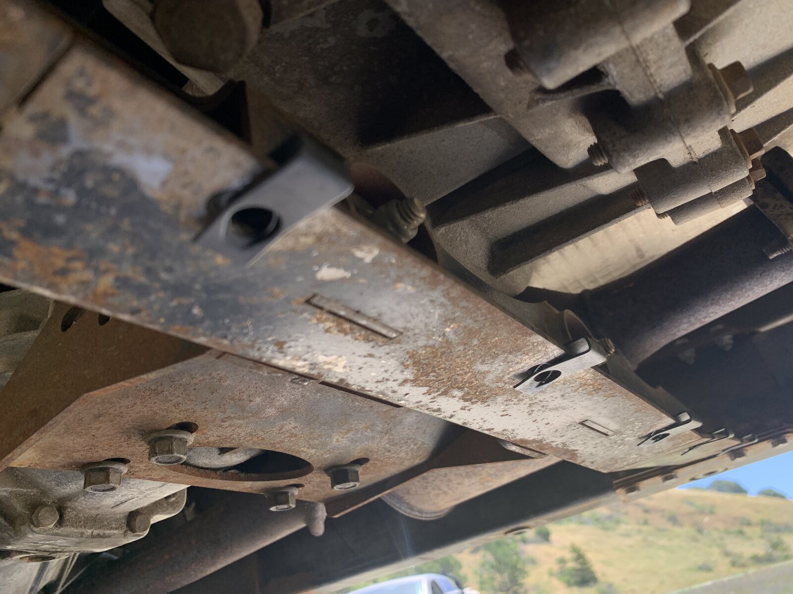

I finished greasing the rear johnny joints and suspension, cleaned everything up and put back together, and thanks for the tip @jjvw via @mrblaine, so much easier now to take off/put on Savvy skid plate...hopefully, soon, I will mod the Savvy crossmember so that I can weld in new raised body mounts and fix my right rear wheel well so that I can install my corner armor...
extruded u-nuts:

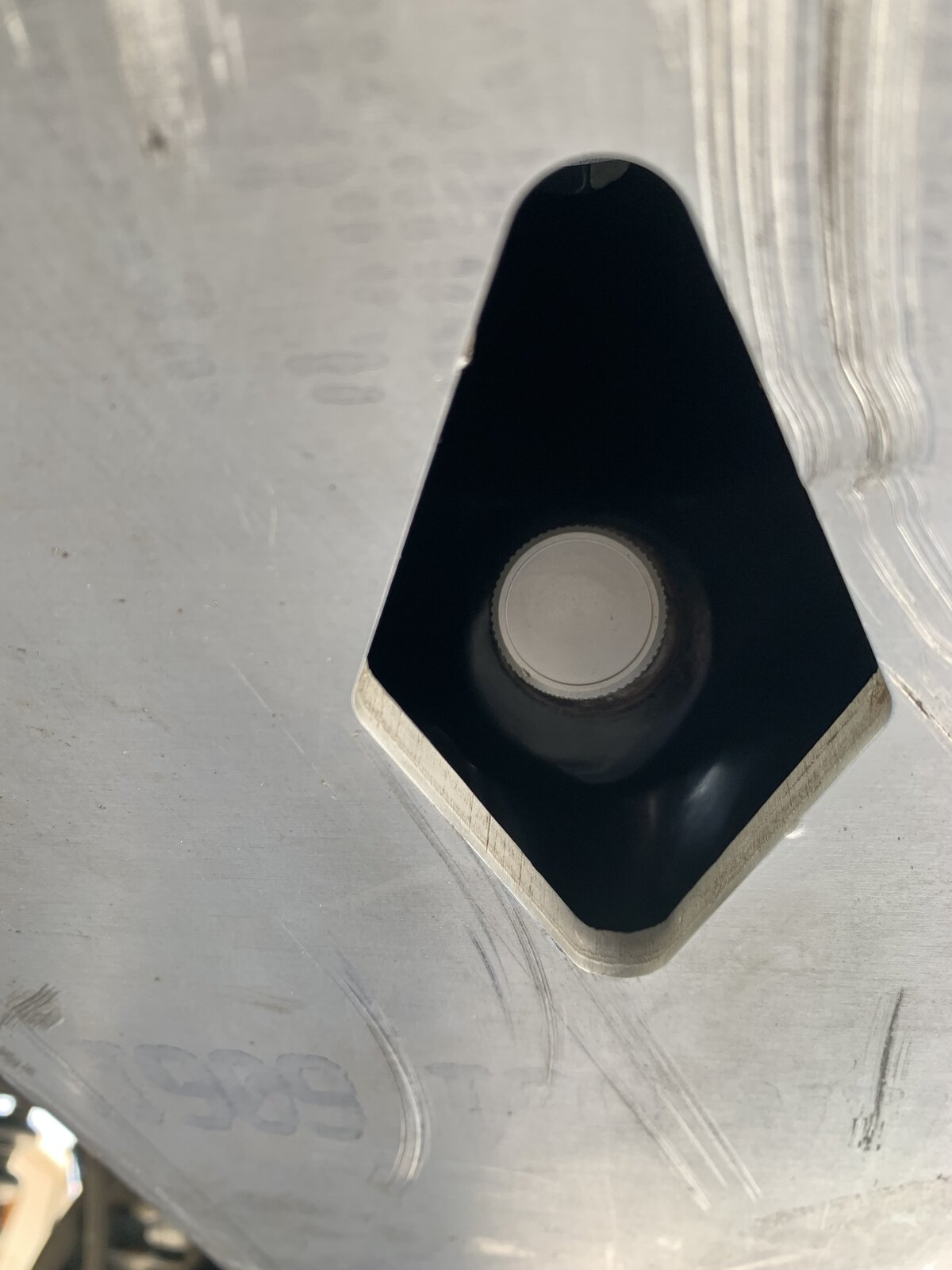

and a few weeks ago I installed the Stahlbus oil pan plug...
extruded u-nuts:
I need to do the stahbus valve next oil change. I bought the Fumoto and it doesn't swivel down correctly with the Savvy under armour. I made a GIANT mess in my driveway pulling the valve to change oil.
