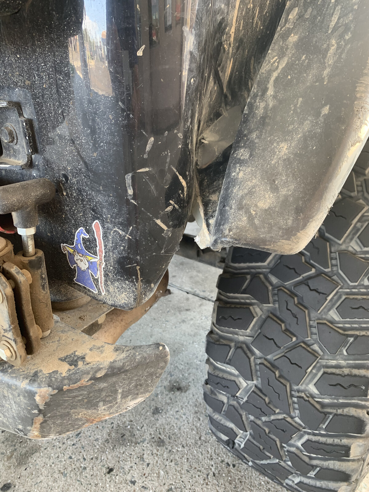

Enjoyed another great time on the Rubicon Trail. This time around, I went from Tahoe side in, wheeled/camped at AJC property at Loon Lake for a few days, then met @Apparition Sunday AM at Loon staging area and wheeled with him back to Tahoe. I didn't get a ton of pics and I had a mostly flawless run. I say mostly because I did experience the "dreaded rock run up into wheel well" on back rear tire and tear the shit out of the back quarter panel and bent the AntiRock arm:
so, I now have a problem I need a solution to and will be looking into corner armor. Since I have Savvy sliders, I am assuming I stick with Savvy corner armor. Anyone mix and match? say Savvy sliders and GenRight corner armor?

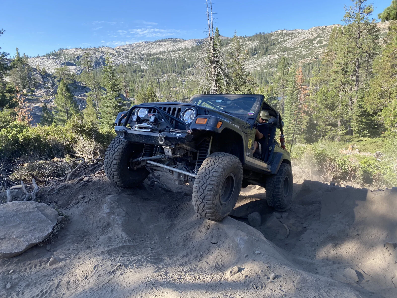

just up from Buck Island Lake:

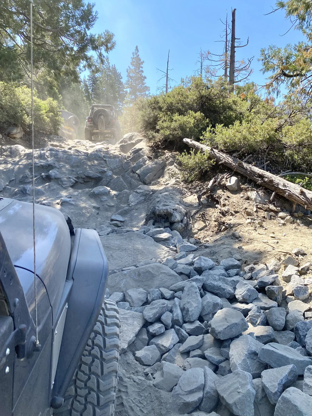

going up Cadillac Hill:

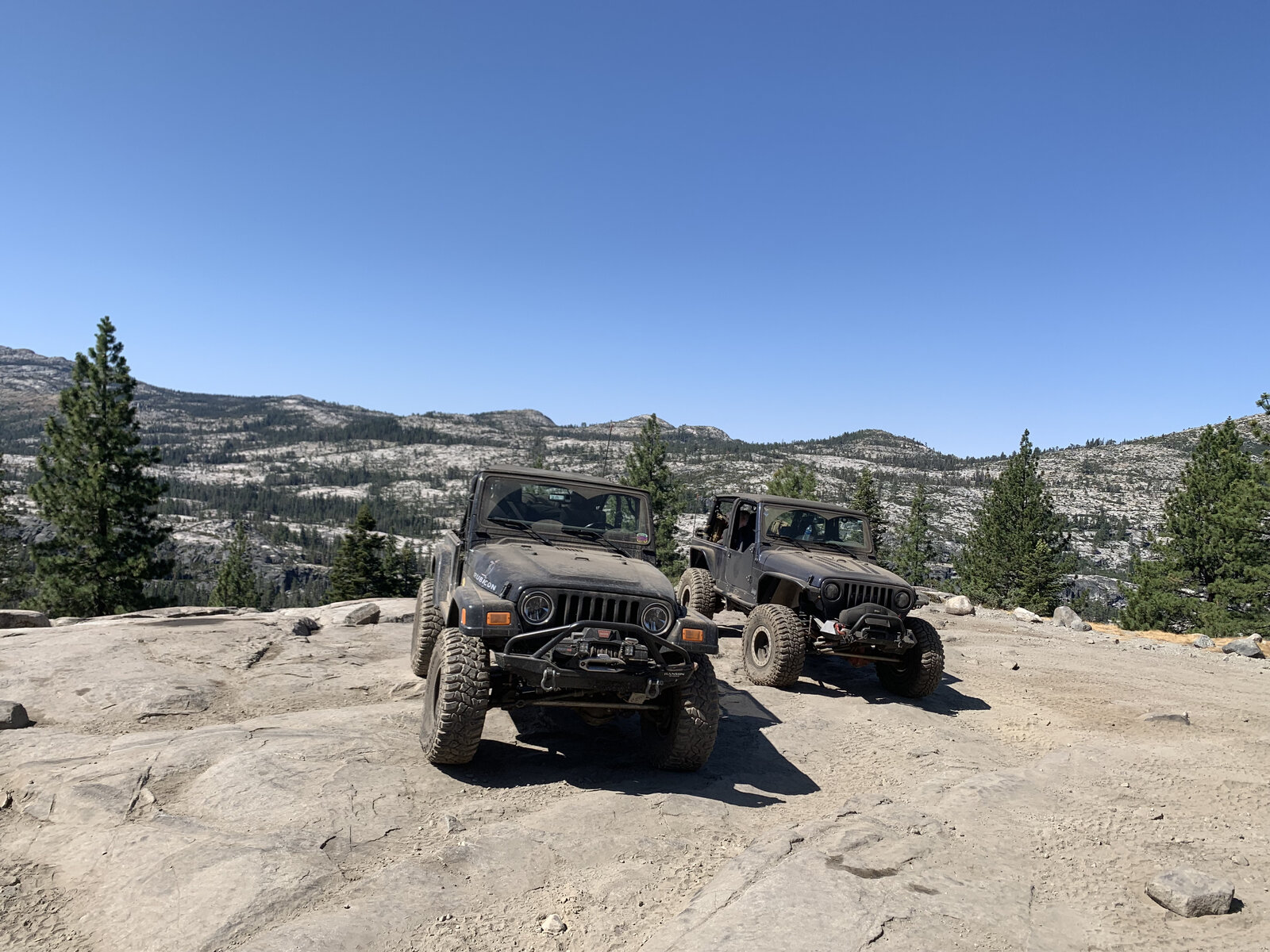

@Apparition and I at Observation Point:

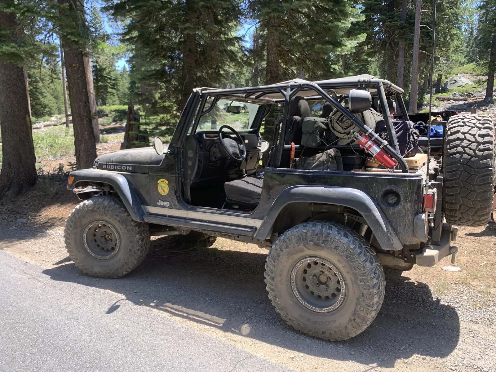

4 nights/5 days on the trail, perhaps @Midnight LJR can detail my TJ:

Ouch. Looks like it's time to bust out the hammer and slap some corners on.
I think you can use the GenRight armor with savvy sliders but you’d need to trim the armor a little since the backing of the savvy sliders sits taller. That’s not really a bad thing though since my armor doesn’t sit flush with the rocker - something you could overcome with that extra working space. My GenRights have about 3/4” between the door frame and the top of the slider, whereas the savvy backer is even.
You can’t use the savvy armor with the GenRight sliders unless you’re okay with a gap - which you may have either way if you’re not as detailed as Blaine on his installs.
Time for some corner armor indeed!
