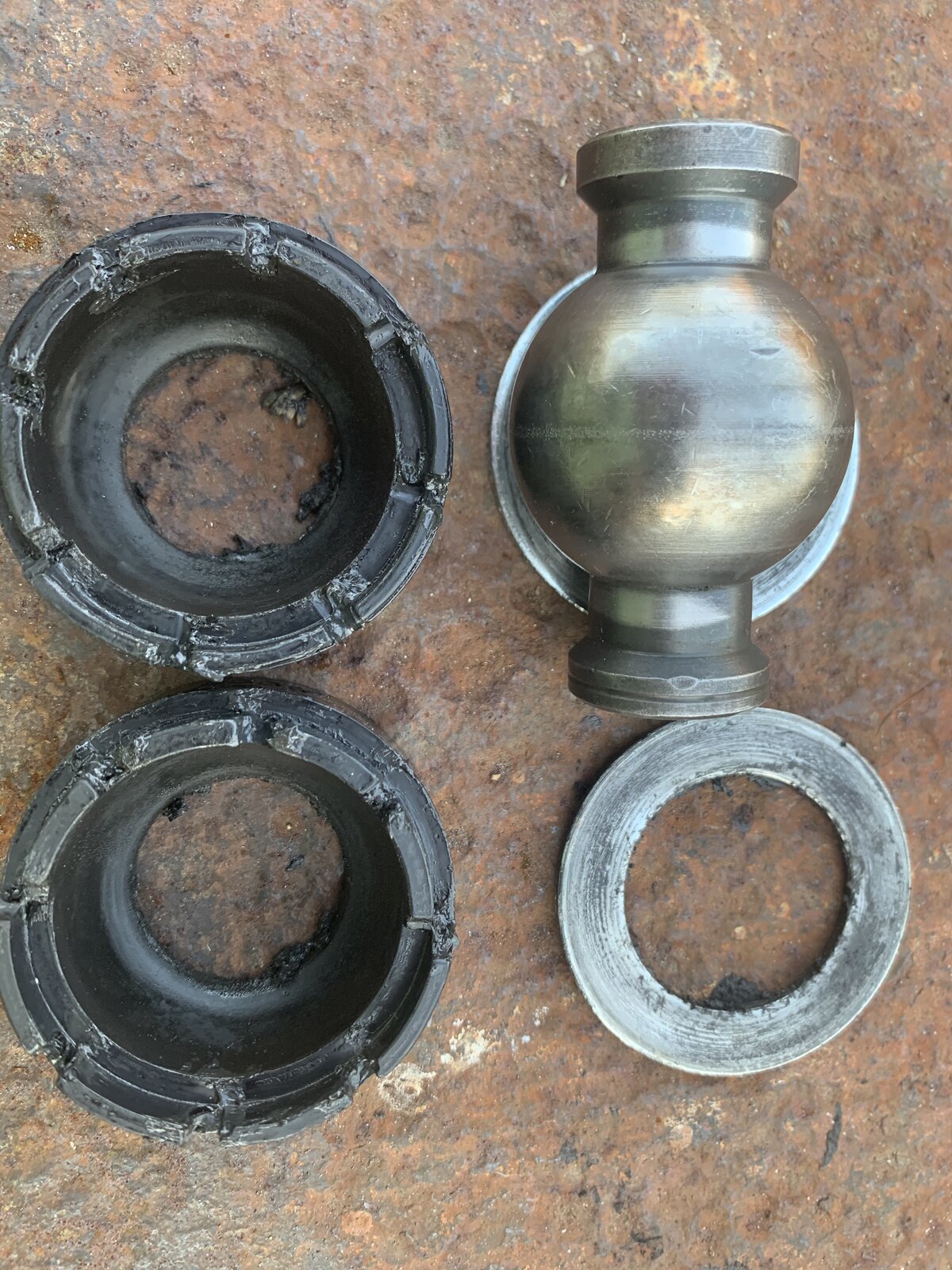

While @mrblaine performed the outboard of my shocks, he noticed and pointed out to me a few items that needed to be corrected as well as some deferred maintenance.. So, I spent the morning taking apart, cleaning up and re-greasing the johnny joints on the lower control arms and I had to rebuild 2 of them. I hope to get to the 3 uppers later this weekend. I hadn't lubed them since I installed the mid-arm 2 years ago.
These bushings were replaced:

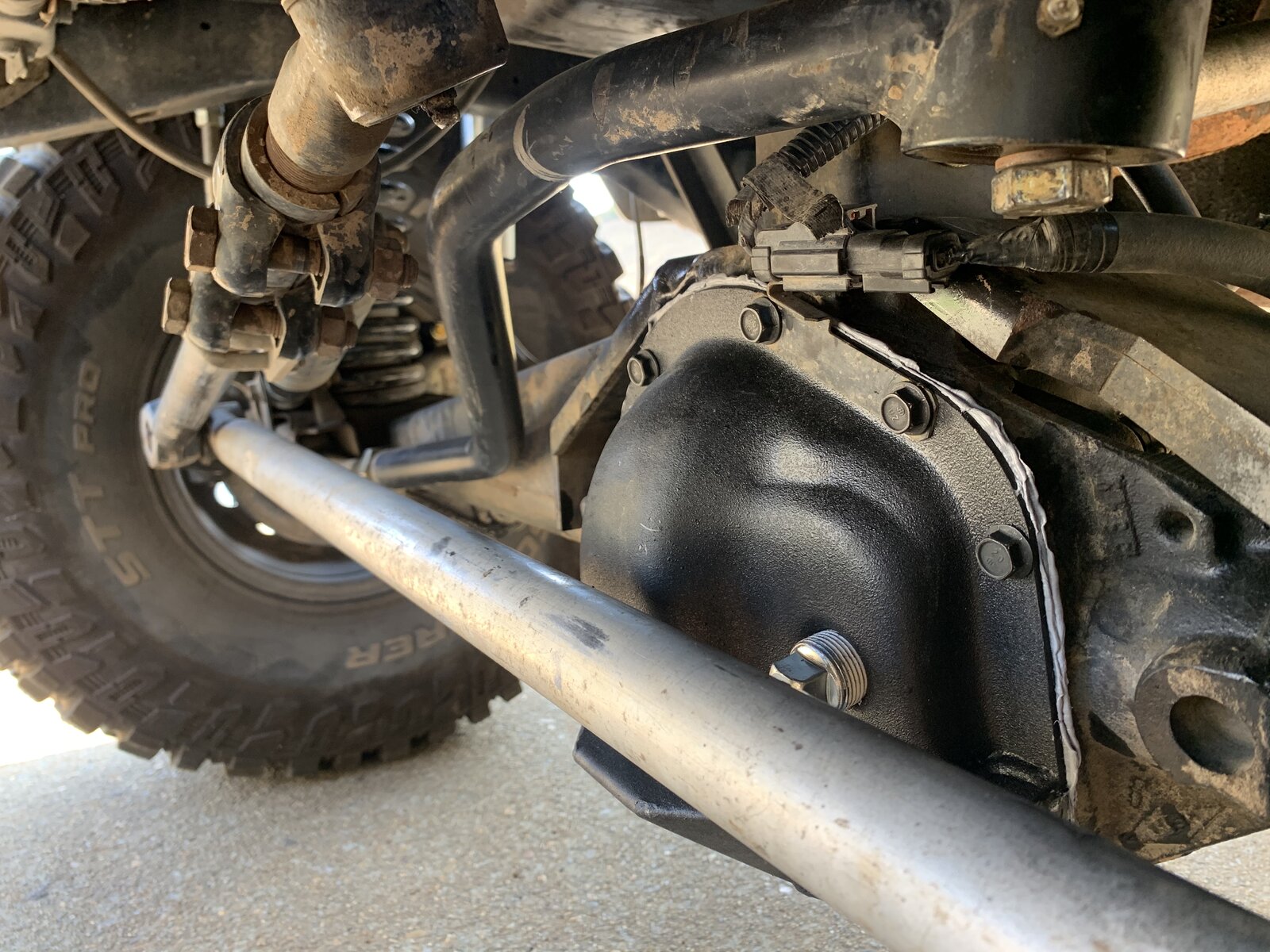

I also ordered a new Barnett diff cover for the front axle. My Riddler that I currently have installed is interfering with the track bar, as just about everyone knew but me! Lastly, I still need to weld up the corners of each truss on the axles that I didn't know I had to do when I installed the mid-arm. I will tackle that this weekend as well.
Just out of curiosity, how did you decide those bushings are bad? They don’t appear to be torn up or distorted. I’m getting ready to tear my JJ’s down also.
Something very odd that I've never seen before. The joint was loose and rattled on the ball. I've handled 100's and 100's of JJ ends and have never seen that.
I had the watchful eye of @mrblaine, he is the one who noticed it when working on my outboard a couple of weeks back. The only thing I can say is this bushing was much "drier" then the others that I took off. The others were easier to turn, although they are all smooth now after the maintenance. Not too hard but not too easy either. I will keep these in my trail bag just in case...
Maybe dirt getting in there from a lack of grease and wearing the two materials down. The uniball seems to have dings in it.

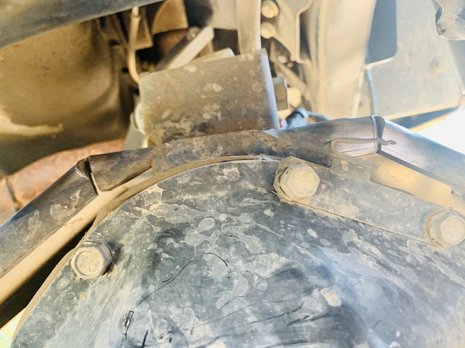

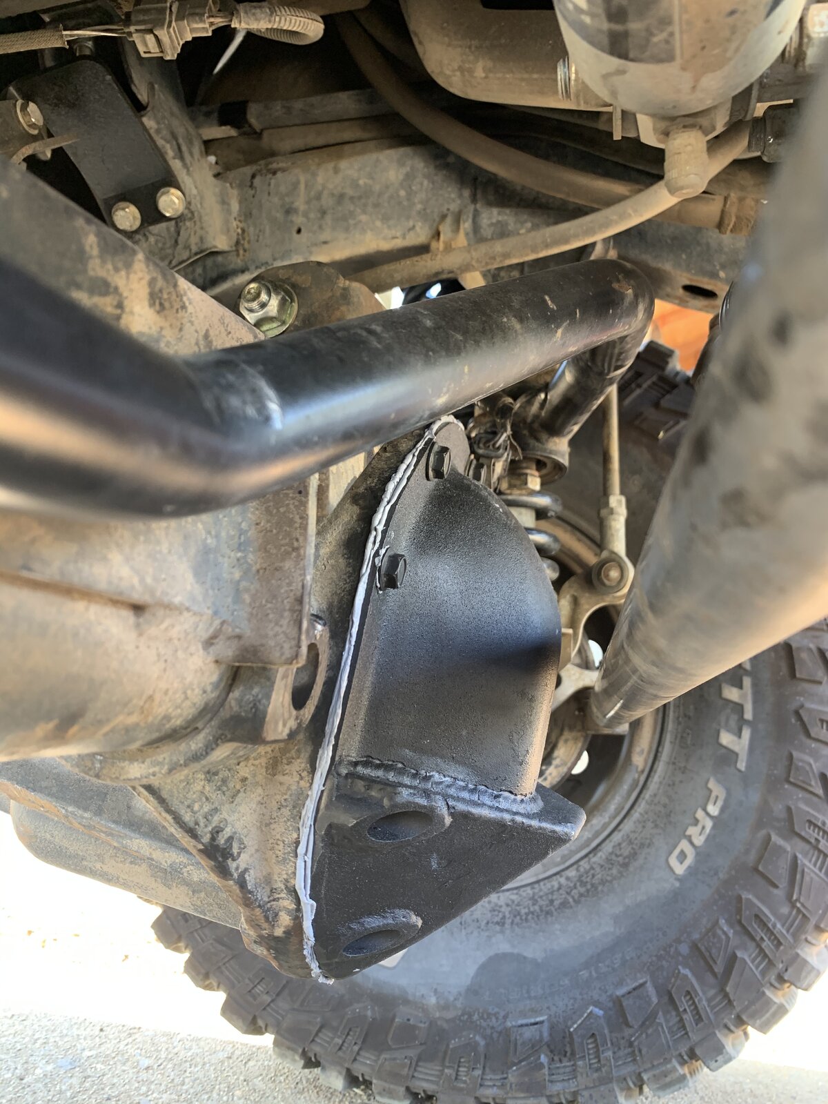

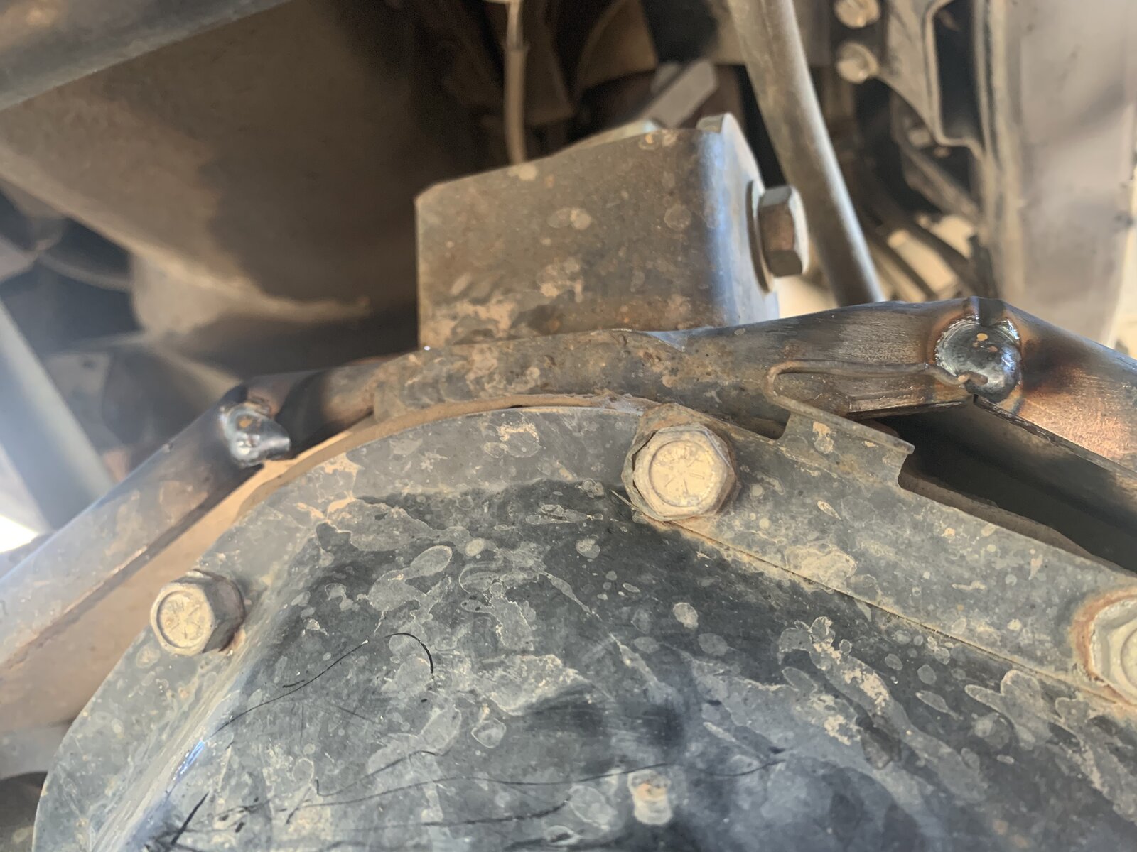

In the spirit of you don't know what you don't know, and continuing to knock off the small items on @mrblaine list he gave to complete, I welded the creases of the front/rear truss on the mid-arm that I didn't do when I installed it a couple years back. Many of you probably knew to do this, I did not. I hope this reminds or informs those that install the Savvy mid-arm themselves. In fact, I think I now know all the do's and don'ts of this mid-arm kit that I can't wait to do it again...
I wire brushed off the paint to prep for welding. There are 2 spots/creases in the front and 2 on the back of the front truss:
welded up:
Although no pics, there are 2 spots on the rear truss as well that are on the forward side of the axle. When welding, be mindful of any wiring or brake lines that might get in the way if you do this after the fact. Hope this helps anyone in the future...
In the spirit of you don't know what you don't know, and continuing to knock of the small items on @mrblaine list he gave to complete, I welded the creases of the front/rear truss on the mid-arm that I didn't do when I installed it a couple years back. Many of you probably knew to do this, I did not. I hope this reminds or informs those that install the Savvy mid-arm themselves. In fact, I think I now know all the do's and don'ts of this mid-arm kit that I can't wait to do it again...
welded up:

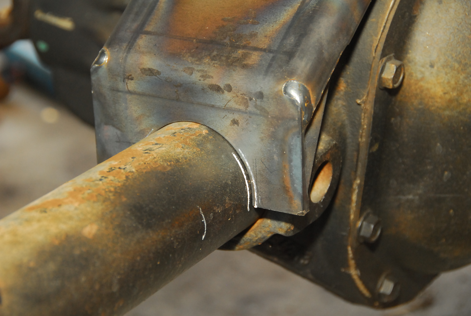

For reference in case others want to know, you should weld up the whole split from top to bottom and in your case, get in there with a cut off disc and open it up slightly to clean out all the paint. Something like this.
If anyone is wondering why they need to be welded afterward it is due to the width just fitting past the ends of the Dana 44 center section where the tubes press in. Welding up the corners first would close up that distance and make it hard to fit.

I replaced my Riddler diff cover on the front axle with a Barnett cover due to the track bar hitting the Riddler. I should be in good shape now.
