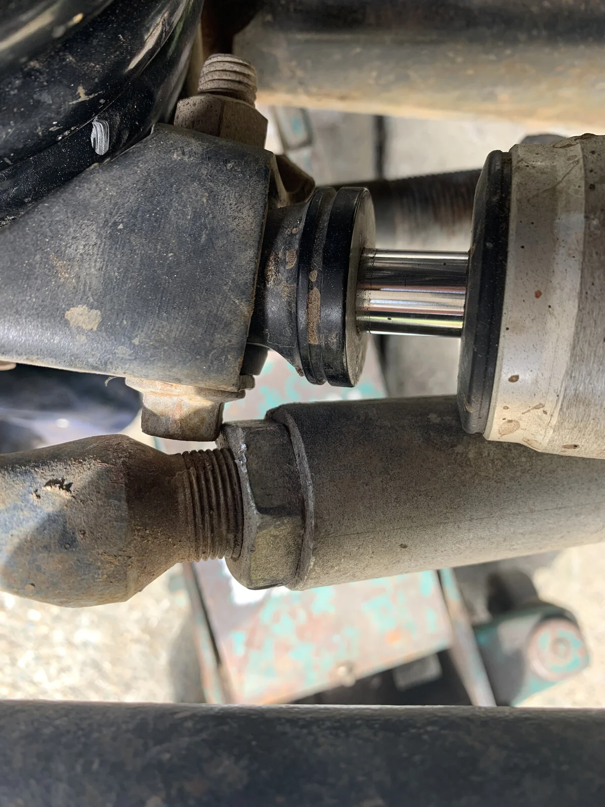

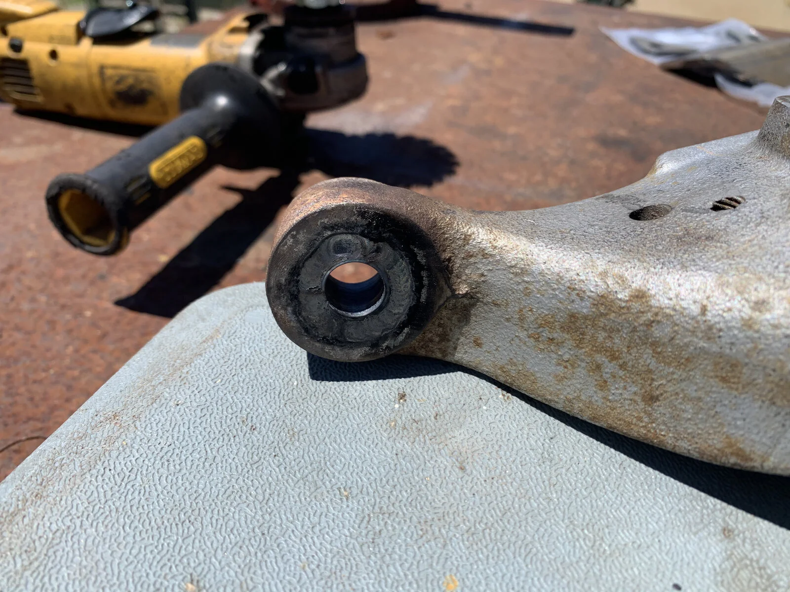

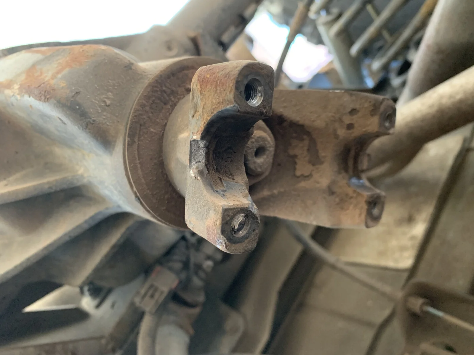

Once thru this section, there is a series of ledges to crawl up and I made the mistake of following my pal on 42" tires. Got the front tires up and over but the rear yoke tab that holds the u-joint in place got caught up on that ledge and sheared off, causing the strap bolt to shear off, with one bolt still left in the yoke. Stopped, took the rear driveline out completely and was towed out from there. Same thing happened to a pal last summer. I opted to replace that yoke with an upgraded version which has half circles on the yoke instead of a tab and went with u-bolt straps to hold in the u-joint. Parts Mike in Auburn overnighted me the yoke. I know there is much debate about straps vs. u-bolts but I like the fact that now the bolts are less likely to get ruined by rocks due to them now being behind the yoke and I was cognizant about torquing the bolts down carefully and using blue Loctite to hold them in place.
Wednesday I was the passenger, we ran Fins and Things and Hell's Revenge. At least I have run Hell's Gate a couple of years ago but I was looking forward to attempting the Escalator. Next time. The replacement yoke showed up Wednesday afternoon and after dinner I put the new yoke in to be back in business.

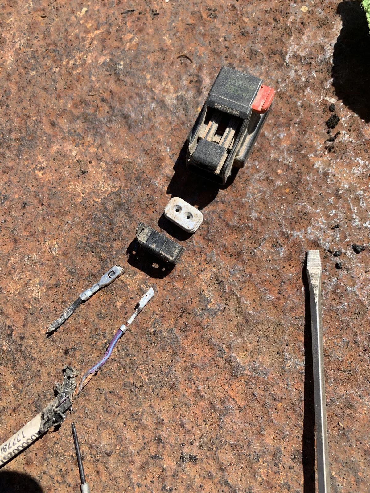

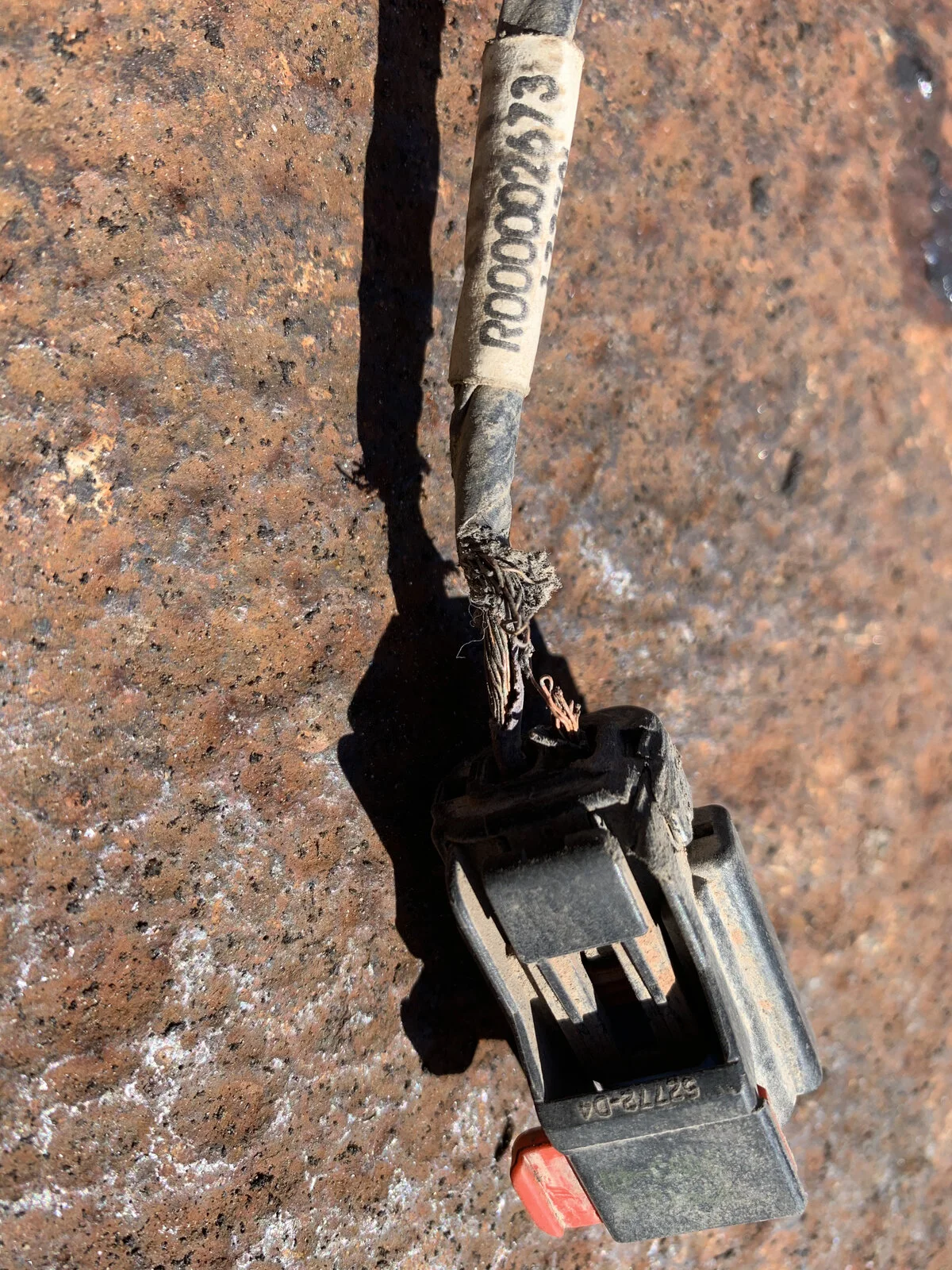

had some time to go over/under my TJ today after the epic road trip I had a couple of weeks ago now. Although my lockers worked, the dash indicator locker lights never went solid, I suspect this is the reason why:
the black wire in the rear locker harness at the diff was severed. This is what the connector looks like:
My question is, to rebuild it, is this the correct female connector?
locker harness connector?

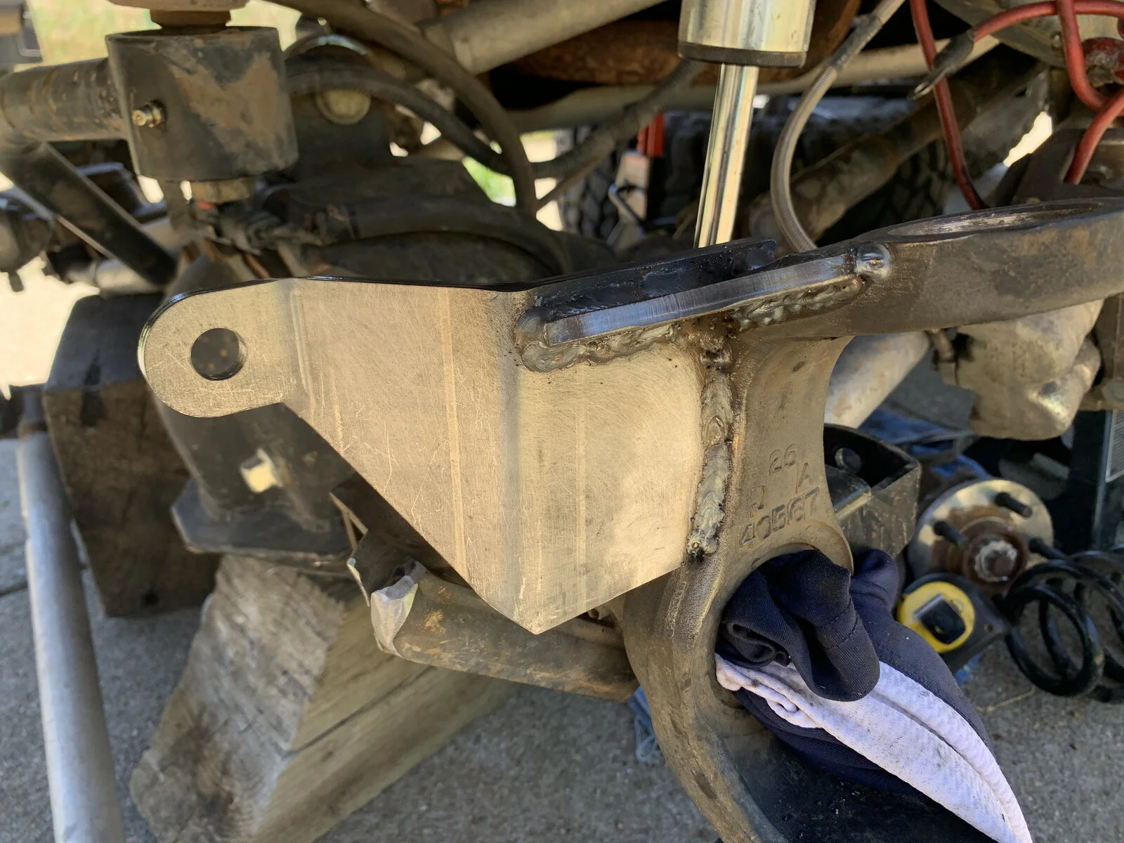

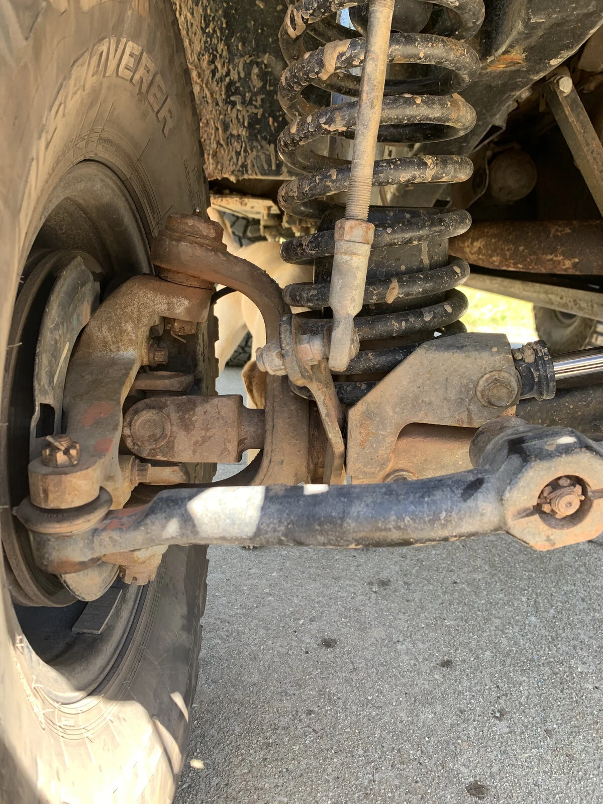

I'm in the process of flipping my tie rod and am almost finished. It has been documented plenty but I will add a few more notes. Since I had the time, I sent my steering knuckle to @mrblaine and had him press/tig fusion weld in the insert. Top side knuckle:
bottom side of knuckle:
I also purchased his sway bar relocation brackets. The installation is fairly easy, if you have any questions, @hosejockey61 did a nice video on the installation process in this thread: Tie Rod flip with BMB Sway Bar Link brackets
I elected to remove the upper ball joint in the knuckles to avoid damaging them from the heat when welding on the brackets.

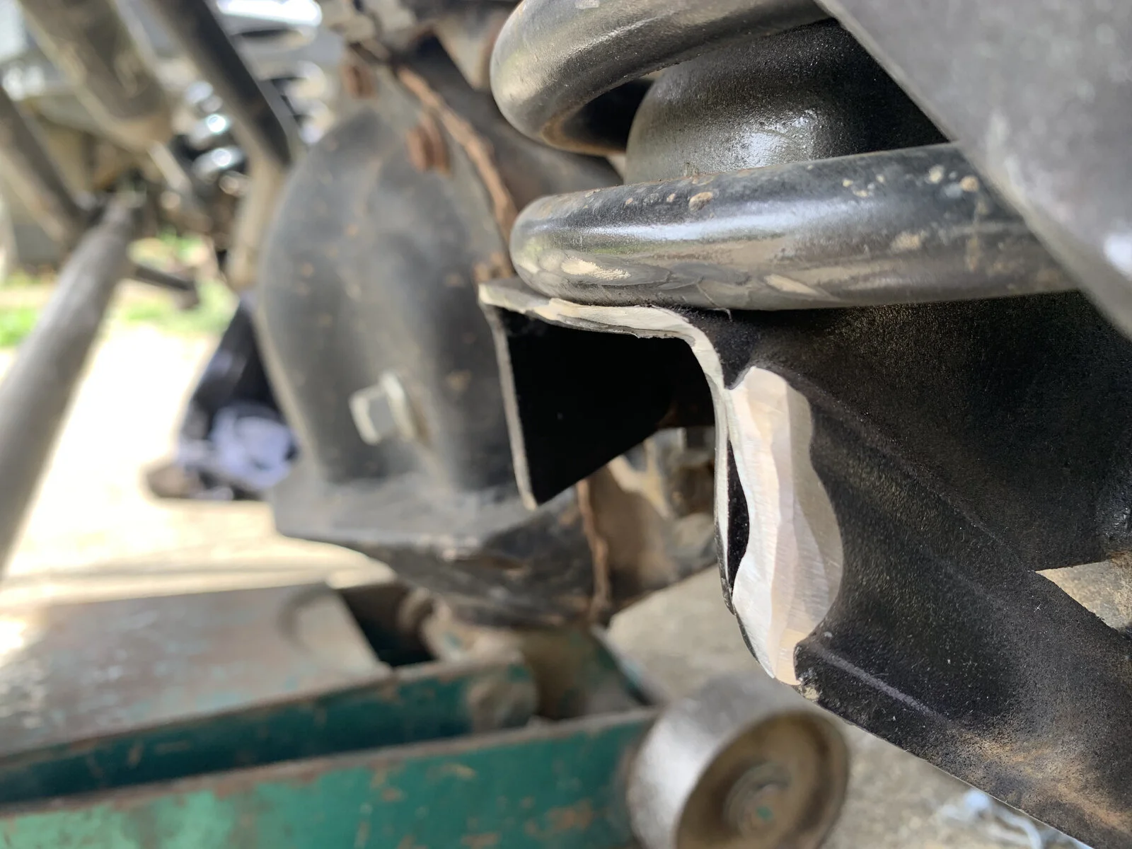

Once the relocation brackets were on, I started cycling the suspension to see if I had any components interfering with one another. I should say too, I run the Savvy Ultimate 1.5" aluminum tie rod. I had 2 places of interference. One, was in the driver side spring perch area which I knocked down with a cut off wheel and flap disk. Problem solved.

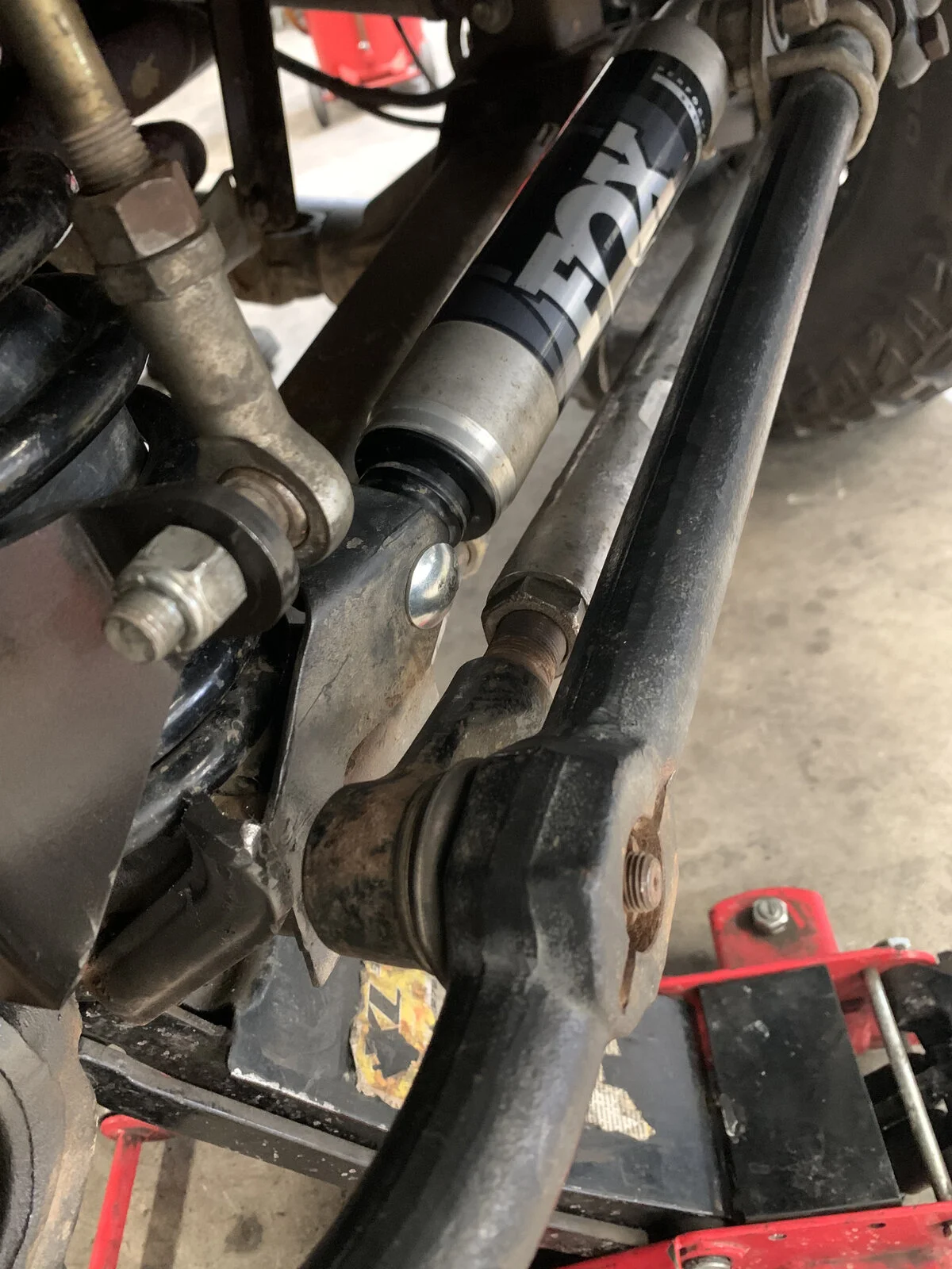

The 2nd area of interference happens when the passenger tire starts stuffing up into the wheel well and the steering wheel is turning to the right. The jam nut on the tie rod hits the bolt of the steering stabilizer on the axle side mount before I am fully cranked to the right:
A quick call to @mrblaine set me right, so today, I am off to a pal's place to take the drag link off and add more bend using his hydraulic press. I figure bending the drag link about 1/2-3/4" will take care of this problem. I also hope I am successful...

To clarify some, the fusion weld is just to make me happy. There is enough press fit interference on the reamed hole with the shoulder that it would likely never dislocate or work loose. Also with the shoulder being opposite the taper, the nut will keep it in the hole going that direction and the shoulder stops it the other direction.
I've had to reshape my drag link twice now to make stuff fit.
I know a few of us had to bend our drag links around a full 3" to get it to not interfere. Easy to do and well worth it.
Success! I ended up bending the drag link about 3/4". Before I messed around with that, I thought I might get lucky by replacing the steering stabilizer bolt with a 1/2" carriage bolt. Still no luck, so I did have to turn to the hydraulic press. I ended up leaving the carriage bolt in. All good now, and hope to hit the Rubicon trail this weekend. Any NorCal folks care to join me?

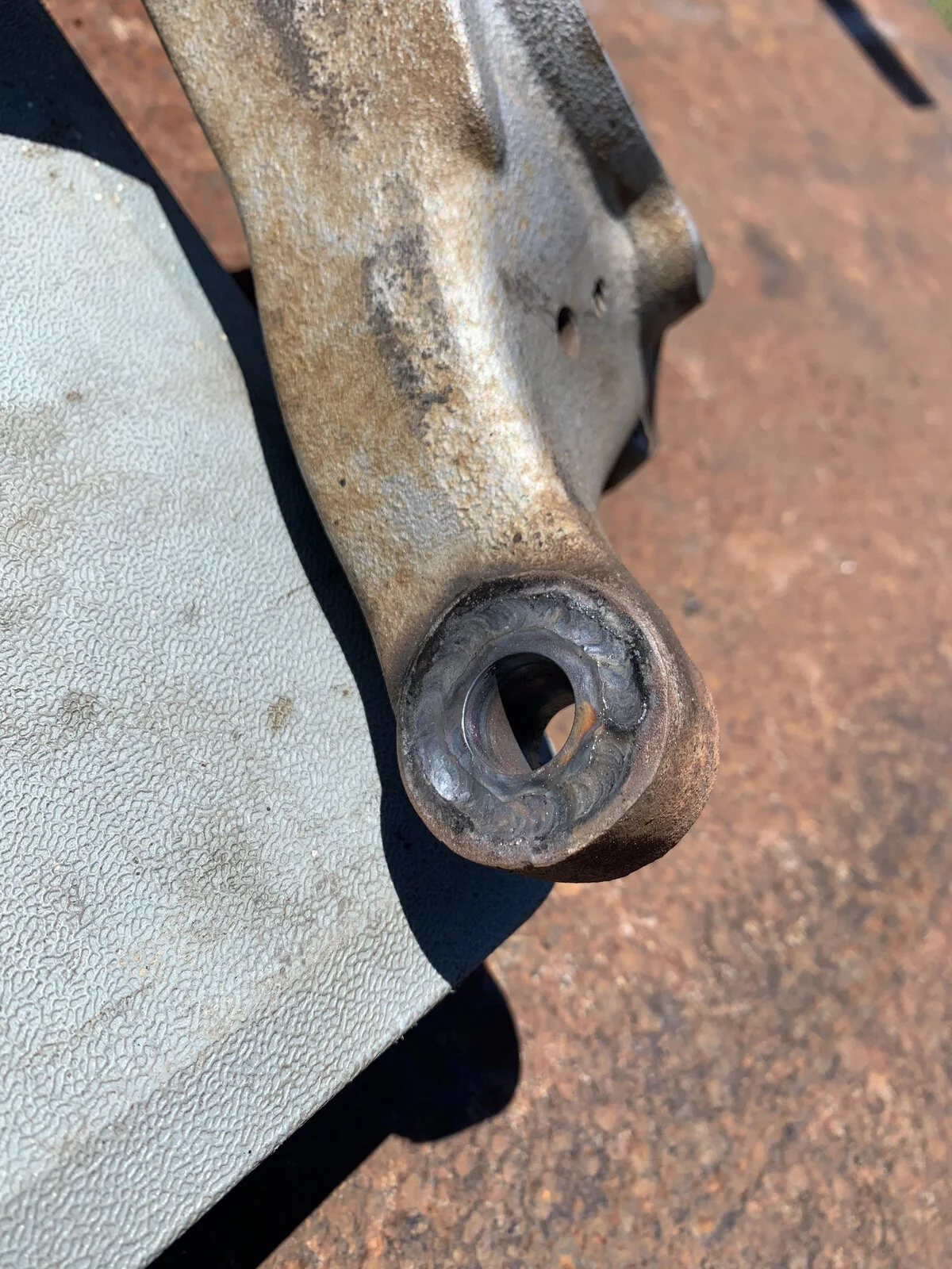

Just after Soup Bowl, I started hearing a clunk coming from the rear diff. Ugh. Drove easy the rest of the way, when trying to replicate clunk, it seemed to show up making turns, so I drove as straight as I could. Made it to Loon Lake staging area, aired up, shifted to 2WD and clunk, clunk, clunk trying to drive out. So, parked it in the shade under the dam, hopped in my buddies '04, he drove me home, and I drove back same day with my truck and trailer to pick it up. I dropped it off at my pal's shop in Auburn at 9:30pm Sunday night. I got home at 1am. I am guessing the LSD finally gave up. I will find out soon enough the damage incurred. Gears/lockers are not something I am equipped to change out currently. Hopefully, whatever parts are in need of replacing will be easy to source and not back ordered to the point that my summer trips are in jeapordy.

If the Rubicon LSD died, you are looking at a new rear diff. When mine started breaking apart, I drove 150 miles home and a week to/from work until the new ARB arrived.
It was mostly fine going straight. But during turns, the rear would lock up and make really loud cracking and snapping sounds. It was really unpleasant, but nothing that isn't already ruined is going to get ruined. Stick some big magnets to the diff cover to protect the ring and pinion if you need to drive it.
I was thinking of your story the whole time...I should know by mañana but early indications are LSD failure...
