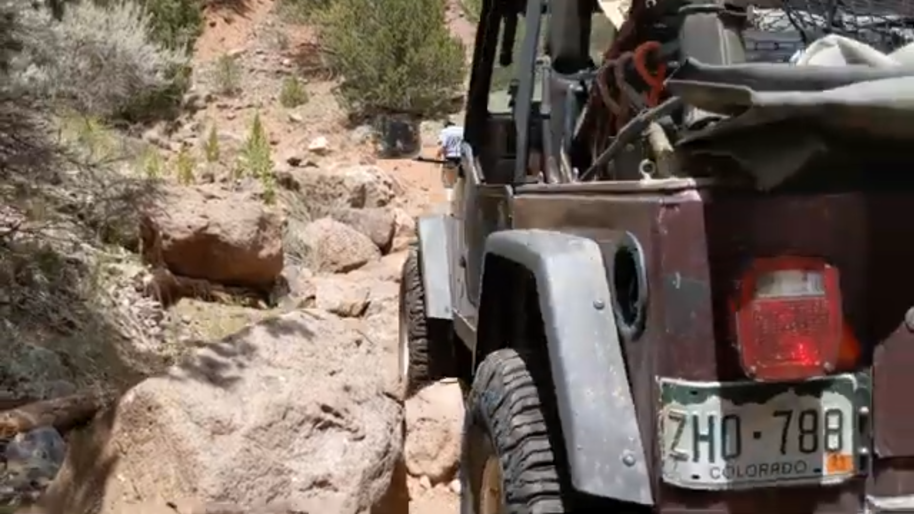

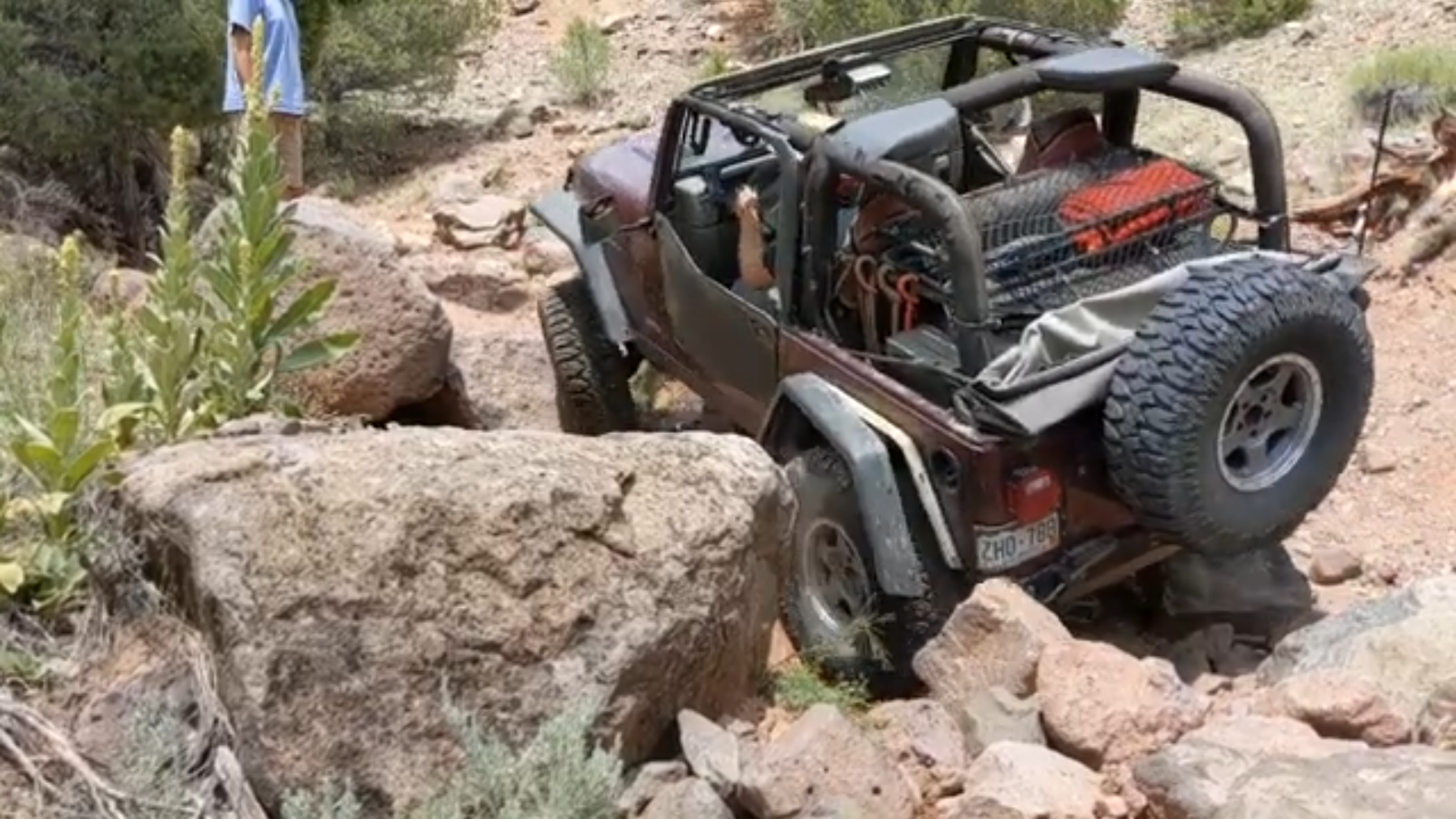

I had them for about 2-3 years. They served a very specific purpose of both replacing the increasingly torn up factory fenders with something more forgiving in the rocks and later providing about 3/8" of needed body clearance above hoodline from the front 12" shocks. Incidently, this is one of the reasons why I understand what Metalcloak fenders do, because they are functionally almost identical.
I knew the MCEs were likely a temporary fix and was quickly convinced of it after seeing how chewed up and distorted they were becoming in the rocks and trees.
I had the rear MCE flares as well, and got tired of them falling off.
Everything got replaced last year with highlines and no flares.

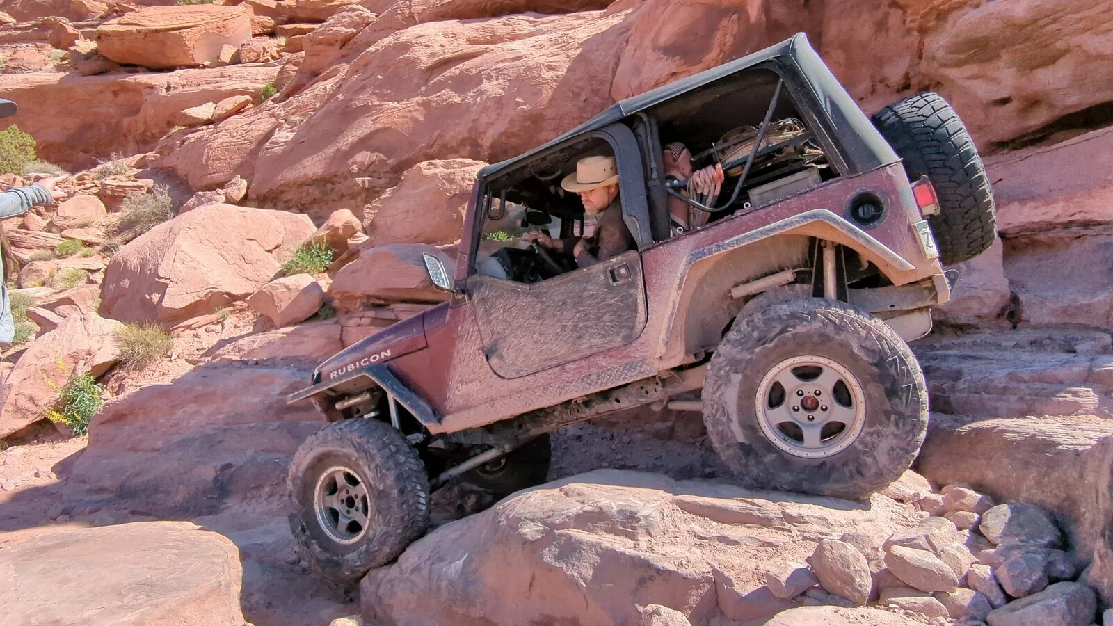

My experience with flat fenders was the old poison spider tube fenders. I flopped my TJ and damaged a stock fender and stupidly went with the PS solution because I thought they made sense. They were obviously strong and more rigid then factory and looked pretty cool and I figured the additional tube armor would be a plus in the JV rocks.
What I learned was that a good smack on those transmitted all the force up into the tub, door, window area of the TJ. It resulted in some issues getting my doors to close cleanly and did tweek the window frame. I had never run a hard top on that TJ so it didn't matter to me, but in hindsight I should have either left the dented stock fender, or replaced it with another stock fender. I'd rather have a fender tweak then the rest of the Jeep get battered "out of square".

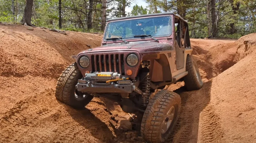

A big part of the refocus over the last few years is to reduce and minimize the physical bulk. I can't get hung up on or damage what isn't there. That was the major justification for the narrow highlines and no flares.
