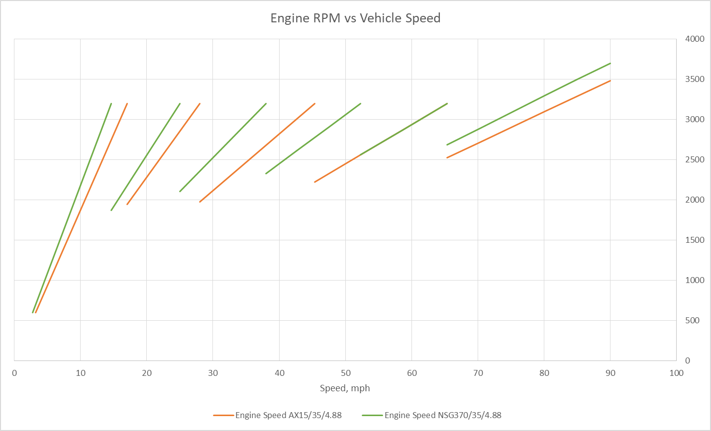

AX15 5th is .79 and NSG370 6th is .84. Should result in about 180rpm lower at 75mph.
Here's a chart I put together comparing the two sets of ratios in terms of vehicle vs engine speed. I set it up for 35/4.88 but should be almost identical for 33/4.56.

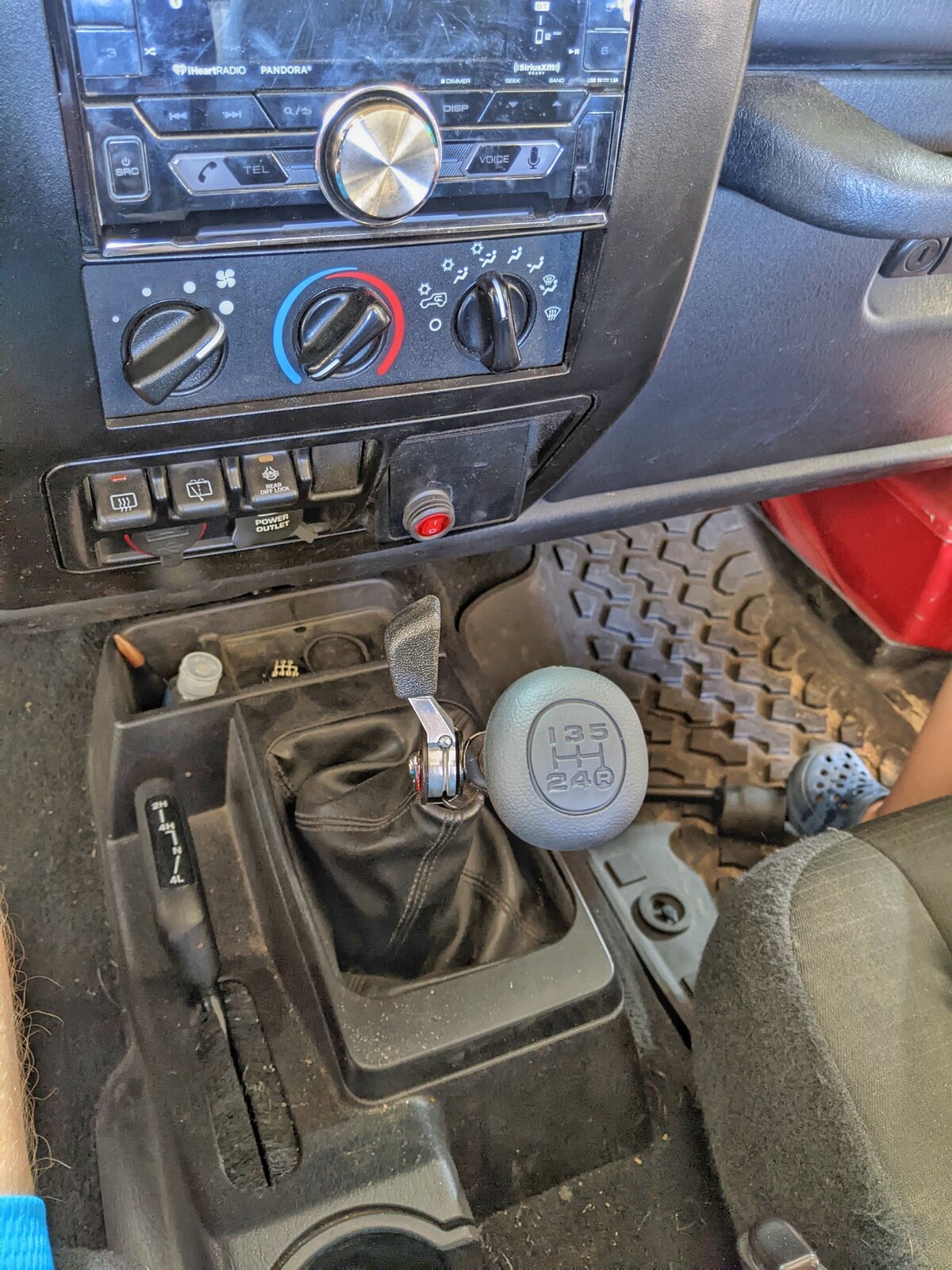

It was over a month ago but to top this project off I installed a shift knob from an 80s Toyota.
It's a little lighter gray than my interior but not nearly as light as this photo makes it appear, for some reason.
Toyota knobs are M12 so I found some threaded inserts to adapt it to the M10 threads for the Jeep knob (which in turn was welded on by yours truly because the shifter was 8" too long and came with 3/8" fine thread).

Heres some math for those those wondering how much gearing they'd lose going to the ax15 from a nsg370.
His 4.88 gear ratio x 4.46 nsg370 first= 21.76
4.88 ratio x 3.83 ax15 first = 18.69 new ratio
18.69 ratio÷ 4.46(nsg370 first gear)=4.19 equivalent gear ratio if you keep the nsg370
So before you swap out your nsg370,understand its a decent step higher. Like putting 4.19 gears in place of 4.88
Conversly my 4.10 geared ax15 jeep would get the equivalent of 4.77 axle ratios by putting in an nsg370.
Probably at a loss of strength and reliability though.
Adding 4:1 tcase to his ax15 combo gets a 74.76 crawl ratio.where he had 59.2 before with a nsg370/231.

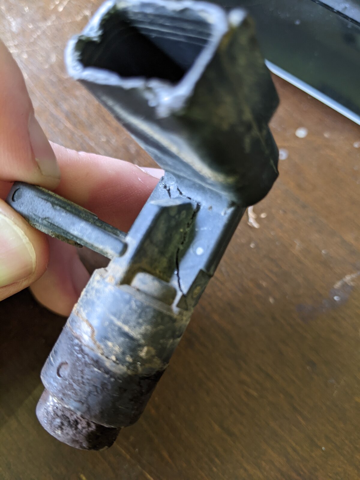

I'm about halfway through. No luck with the bread trick so I had to hitch a ride to the parts store to get the pilot bearing puller and lost a couple hours. It's out now, but silly me didn't think to put the new one in the freezer while I waited so now I'm waiting for that. I could mount the transfer case up to the AX15 but I think I'd rather not have the extra 70 pounds attached while I'm trying to stab the input shaft in. I'm using a transmission jack but one thing I don't like about it is it doesn't give me good control over the pitch of the transmission. Last clutch job I did, i actually rigged up a sling out of ratchet straps, across the frame and under the transmission, and laid underneath it using my hands and knees to position it while I watched the input shaft. I'm not as young as I was then though, so I'm not sure I'm up to that.

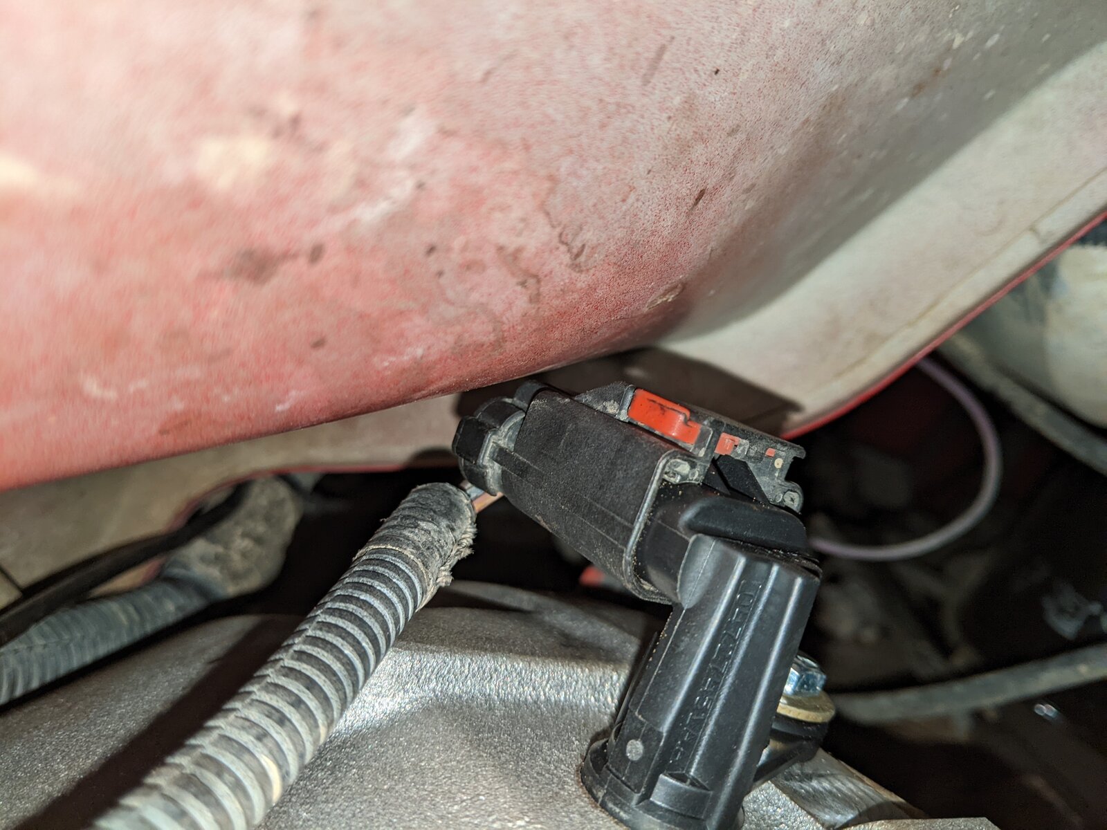

Another lesson learned, I thought I'd just swap the crank pos sensor over while both transmissions were out, but that ended up a stupid move on my part because while I was yanking the trans and tc assembly loose from the engine and clutch, the CKPS got caught on a heat shield and cracked. Glad the Mopar sensor is available and only about $40.
NOTE: The Advance Adapters bellhousing puts the CKPS in the correct location, but it is rotated about 90° from the factory orientation. This points the connector UP instead of REAR. I have a 1" MML and a UCF Extra clearance skid and had to plug in the CKPS before mounting it because there wasn't enough room, and once installed the harness plug is 1/8" or less from the tunnel.
This is too close for comfort in my opinion, and thinking about someone with a higher tuck, I don't know what you'd do about this. Take a hammer to the tunnel, I guess, but I don't know how I'd ever get a good whack there without pulling the whole works out again. I remember there being some wiggle room in the motor mounts when I installed my MML, and I centered the fan in the shroud. I might loosen those bolts back up and try to shift it over to the driver side to get some more room here. I know @mrblaine has done at least one of these swaps so I'm curious what his thoughts are on this. I don't know why, but I just assume every TJ he touches has a Savvy skid :ROFLMAO:

Just curious if you have had any issues with the crankshaft position sensor being turned 90 degrees like that?
Im looking to do this swap myself, but Im not sure if this will even be an issue without a motor mount lift?
What do you think?
I know this is an old thread, sorry!
What do you think?
I'm still not a fan of how close it is but I haven't had any problems. Probably won't be an issue without a MML and a tuck. If I ever have occasion to pull the transmission again I'll probably beat on that spot with the BFH to add some clearance.

hey @freedom_in_4low thanks for the response!
I have most everything ready to do this swap, I just haven't sourced a bellhousing.
I find it somewhat odd that Advance Adapters bellhousing orients the CKPS facing forward.
Reactions: freedom_in_4low
It's odd to me too. The only explanation I can think of is that theyre' just buying a casting and machining the sensor provision into it, and since the casting wasn't originally designed to account for that sensor, it doesn't allow for the typical sensor orientation. If you look at my photo, there's a reinforcement rib right about where the screw should have gone, and there's not material there to machine a flat mounting surface into.

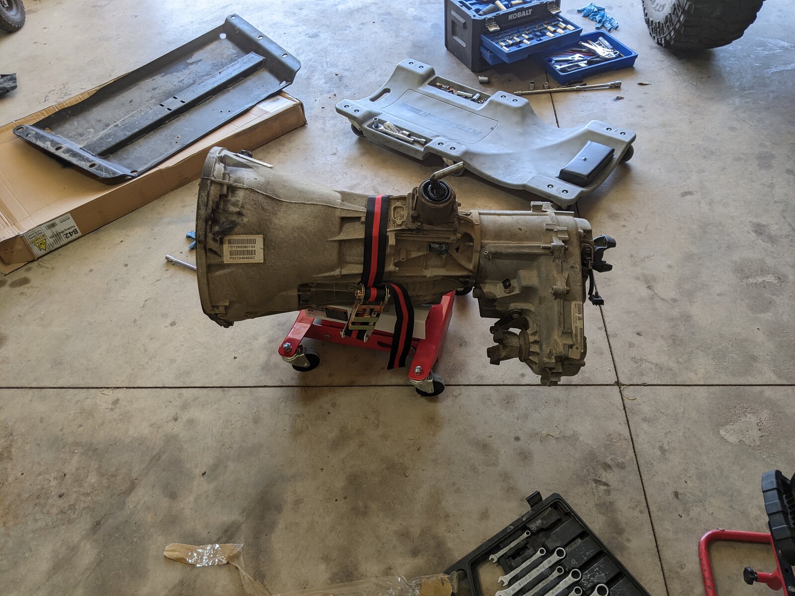

starting this thread to document my swap instead of doing it after the fact when my memory is fuzzy.
Background: my NSG370 pops out of reverse. In street use it's tolerable but it's exacerbated when backing against any resistance, such as uphill (like the 8% grade on my driveway) or if a tire has to climb a rock or a log on the trail. This is annoying at best, and at worst could be dangerous or life threatening if on a narrow mountain switchback in Colorado. I had an AX15 in my '99 TJ Sahara, I liked it better, and the cost of swapping is almost the same as a rebuilt NSG370. (this thread is not for the purpose of rehashing the relative merits or issues with either transmission or of changing from one to the other)
