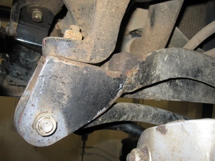

Thanks for the quick reply guys. The custom jeep shop I took it to for them to look over wanted to use a rubicon express bar. I don't think they know they need use a WJ bar. I will let them know about the rough country forged WJ bar, and replacing the stock bushings.
I figured this one I had was special since I could not find any info about it. It looks strong as hell. I will probably replace it but keep the piece and maybe use again some day.
They also wanted to replace the front steering setup to what he called a "T" style. Online it looks like its called HD steering upgrade, where the tie rods connect to the knuckles, not the drag link. I noticed in the nth degree install instructions for the trackbar brace they said as long as the drag link angle is not altered it should work. Looking at the HD setup it seems the drag link hooks up to the top of the knuckle instead of the bottom. I figure that should be fine.

rubicon express is junk, and you already have the upgraded steering compared to the "T" link bologna. The currie currectlync you currently have is the best you can get especially with the 7075 aluminum tie rod thats on it already

I think you need to find a better shop. You already have Currie upgraded steering and inverted "T" on a TJ is stupid for many reasons. I would know as I tried it 20 years ago and figured out pretty quick how crappy it was.

They Don't NEED the wj bar. They could/will remove the NTH Degree frame brace and install the rubicon express track bar.
Ah I had not realized it was the Currie HD draglink. I will have them just do the WJ bar and bushes. It's got a bad tie rod end, and the steering stabilizer is shot. Other then that this Jeep seems to be in great shape. 56k miles if you can believe that. I am pretty sure it got flat towed around for a good long while. IIRC the ODO won't tick over with the Tcase in neutral, can't quite remember.
I don't want to get rid of the nth degree brace. Its been working on this jeep for years, no reason to replace it. That's why I wanted to figure out WTF this custom track bar was before I just tossed it. ;)

the brace works until it doesn't work anymore.... lol pics from my 2003 rubicon in 2009ish
the big reason that track bar was discontinued was because of the bushings. the updated replacement unit is a stock 99-04 grand cherokee track bar. a rough country forged or JKS 99-04 adjustable is the best fit for a replacement, of the two units, rough country fits the best both, the rc and the jks need the supplied bushings tossed in the trash and replaced with moog k7252 on the axle end and moog k201643 put in the frame end. It's been about 10 years since I've had an original flat bar in my hands, it got replaced instead of straightened so I never got a chance to figure out what bushings with today's technologies would fit in it.
