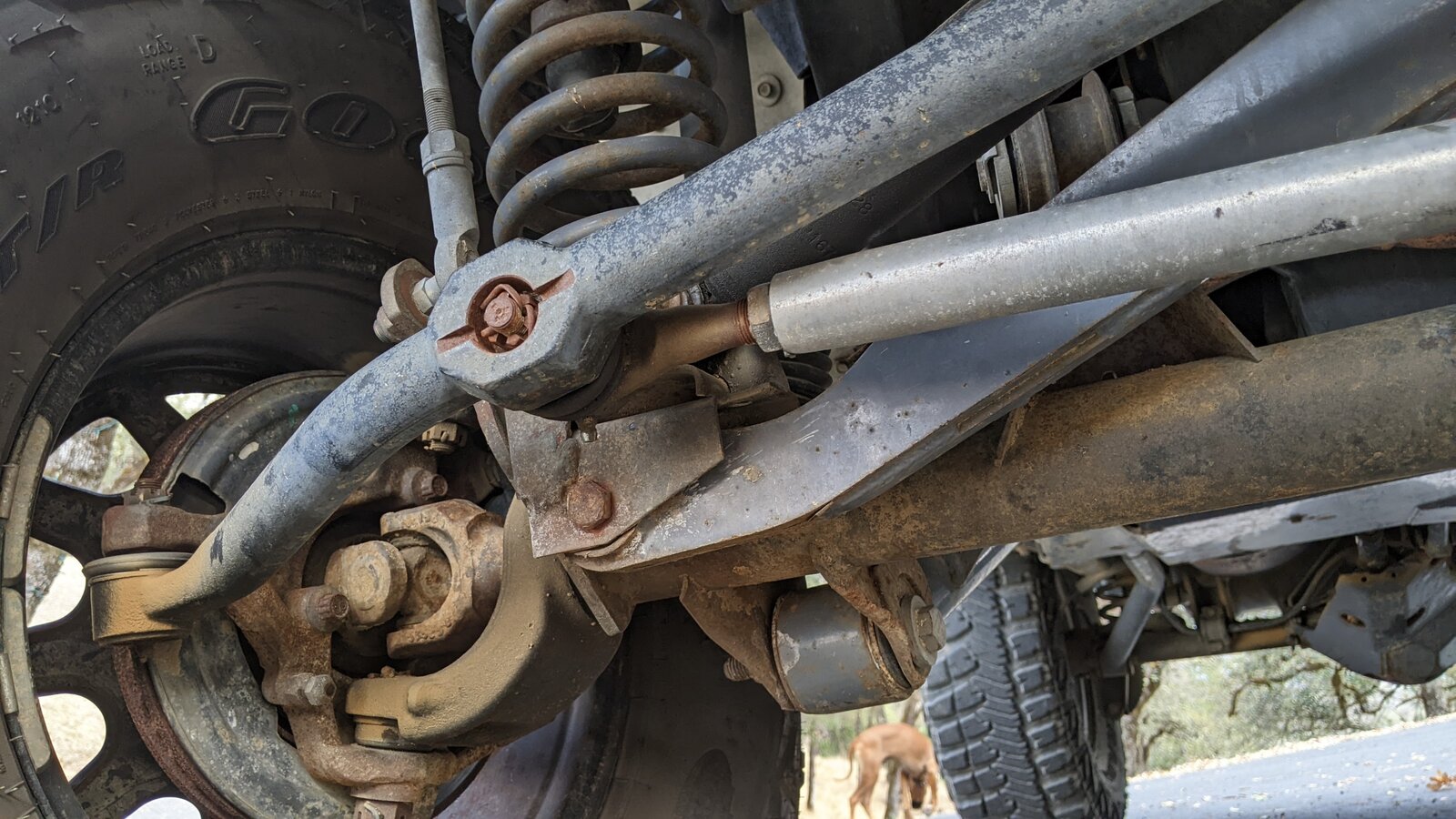

Hello All,
I recently bought a 2004 TJ with a bunch of Nth degree goodies. I've put myself on the list for 3 gyro join kits from Heather at All J Products, she needs a few more orders but thinks they may do a run mid December.
I wanted to show you guys my trackbar. Its clearly an Nth degree unit, but its not the tubular unit in the catalog and I can't find any info about it. Id like to replace the bushings but can't find any info. Short of taking it apart and measuring does anyone have any info on this trackbar?

Have not seen one of those in a long time. There was a shortage of the WJ track bar https://www.crownautomotive.net/Track-Bar-Front/52088305AB.html that Jim normally used so he had to produce his own. If you want to bush that one you will have to take it off and measure as I am not aware of any records of what bushing Jim used but let me know the dimensions and I can figure it out. Personally I would just order a WJ bar and swap it out.

the big reason that track bar was discontinued was because of the bushings. the updated replacement unit is a stock 99-04 grand cherokee track bar. a rough country forged or JKS 99-04 adjustable is the best fit for a replacement, of the two units, rough country fits the best both, the rc and the jks need the supplied bushings tossed in the trash and replaced with moog k7252 on the axle end and moog k201643 put in the frame end. It's been about 10 years since I've had an original flat bar in my hands, it got replaced instead of straightened so I never got a chance to figure out what bushings with today's technologies would fit in it.

Dave what bushings are you using in the factory WJ bar?
