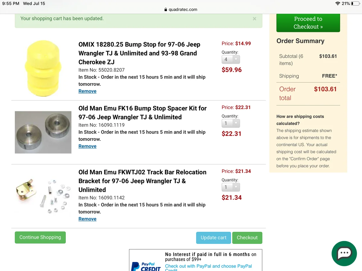

Thanks for the offer, I do travel up to Englewood every so often for work. I did though change up my order through quadratec and ended up with a $58 total (decided to go with only replacing the one bump stop rubber, the other three actually aren’t that bad). I’ll take it off your hands if you find the missing small bolt, but if not I may just pass so I can score the free shipping haha

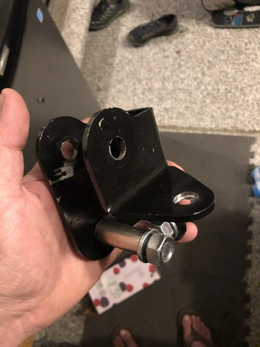

Let me pull it out of the garage and I’ll post a pic, make sure it’s the correct one you need. I think they make 2, one angled and one straight. It’s the one that came with my kit.

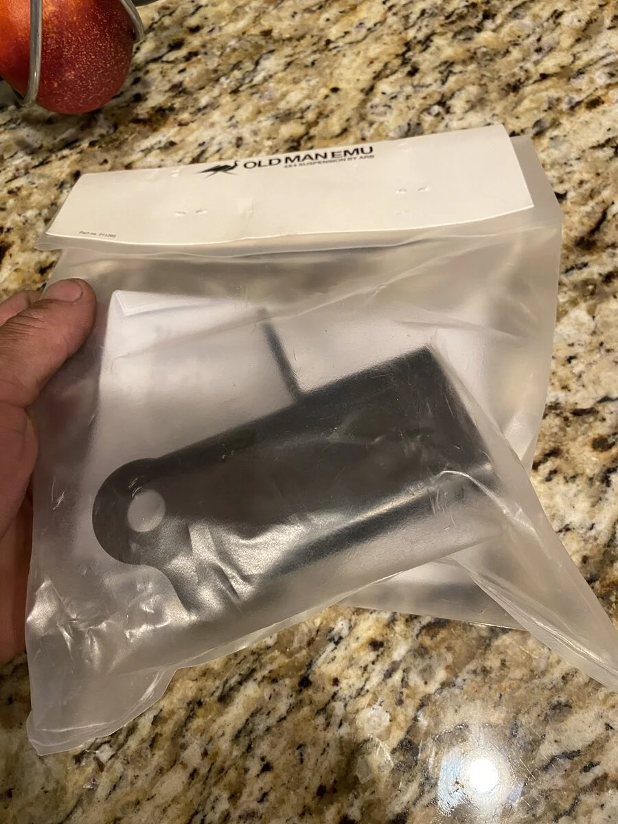

Also: The relocation bracket raises the rear TB mount by 2”. You’ll need either a 2” bump stop extension or 1” + a 1” body lift. You’ll be better off with JKS OGS151.
Not only can that relocation bracket hit the tub, it can also cut the wiring for the fuel pump.
